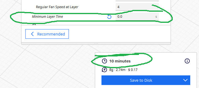

After reading some great updates from other community members, am curious about speed capability, and dimensional accuracy of my build…
Currently printing 25.4mm calibration cube using same settings used to print Kobalt Blue Core for my LR3 Idex upgrade:
  • 0.6mm nozzle, 0.32mm layer height, 3 walls, 4 top/bot layers, 45% infill.
  • Printed Core with 120mm/s. Changed to 500mm/s, 1st attempt with 125mm/s initial layer didn’t even stick, so overrided to 30mm/s.
  • This model is so tiny, and won’t save much time despite printer speed increase. I also won’t know/encounter failures that will likely happen when printing larger models, where the excessive speeds will become apparent.
Biggest bang for buck at this (or any) scale is using 0.6mm nozzle instead of 0.4mm.
Edit: 25mins displayed here is wrong. Cause is I didn’t override Minimum Layer Time to be smaller than the default (15s?). So, didn’t matter what Speed and Acceleration values I used here, the print speed ended up being throttled (slowed down) to satisfy the Minimum Layer Time constraint. Posted details in later 10/30 Post.

Ugh, bad tests on my part, Cubes came out great, but… :man_facepalming: I forgot to reduce/clear minimum layer time slicer setting. Didn’t matter how fast I set the speed and acceleration because minimum layer time was throttling the print speed.
Noticed during second print and was confused why everything seemed so slow.
Changing to minimum layer time to 0 is finally getting me some hectic frame shaking hot messes.
100% Fan doesn’t seem to be enough, so tinkering with misc settings, mostly for learning sake, am not expecting significant gains, or great quality…
Even though am using a 0.6 nozzle, configuring Top/Bottom Line Width to be 0.45mm instead of 0.6mm seems to result in neater finish.
Ugh, am questioning all the initial bridging/tower tests I did now… They were probably throttled as well.

I can not get under a 12 second minimum time or I just get s squishy blob. A minimum is needed with pla I am sure so either bigger prints or multiples. It would take pretty ridiculous cooling I would think to be able to print PLA well with no slowdown.
