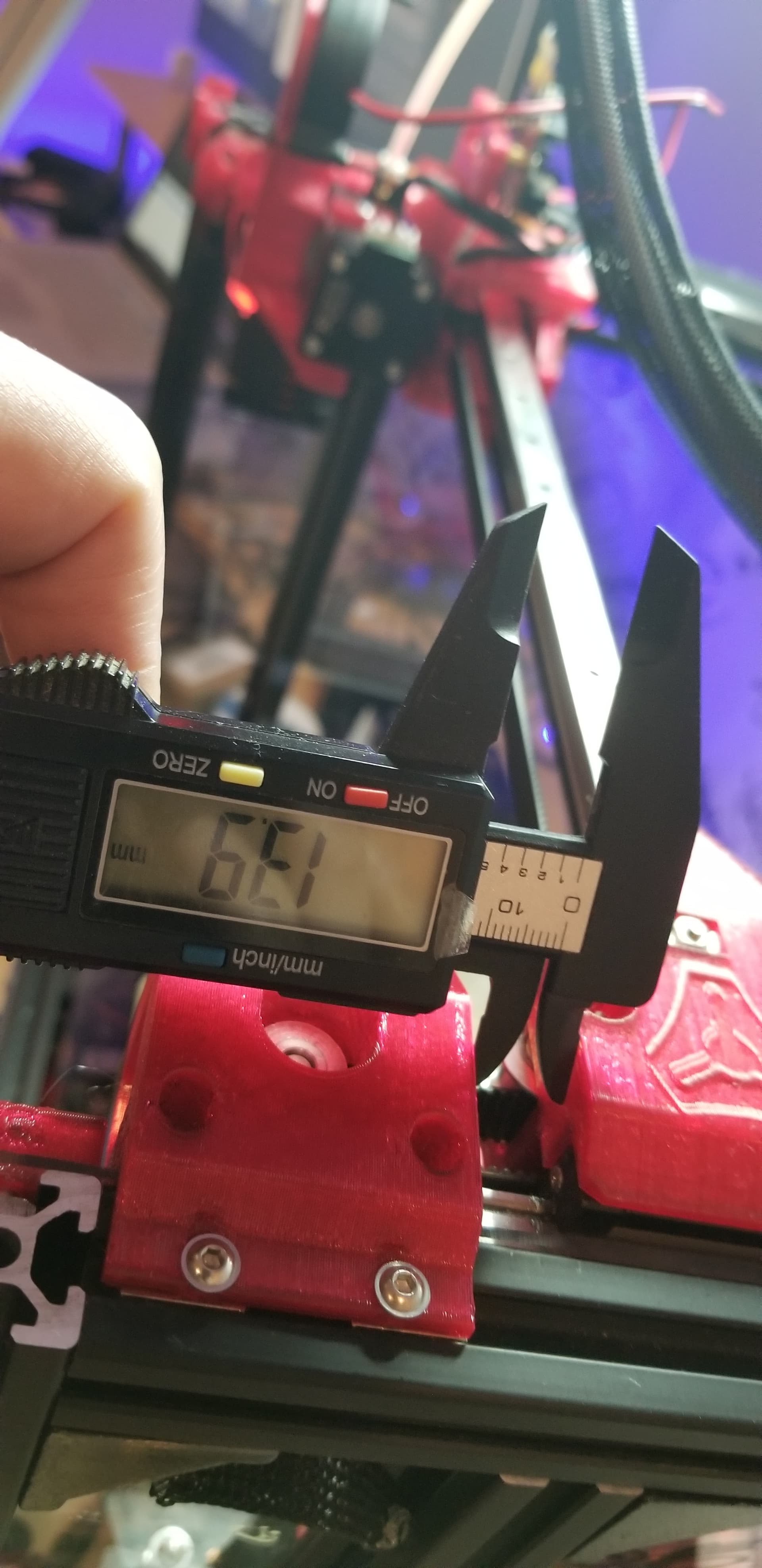

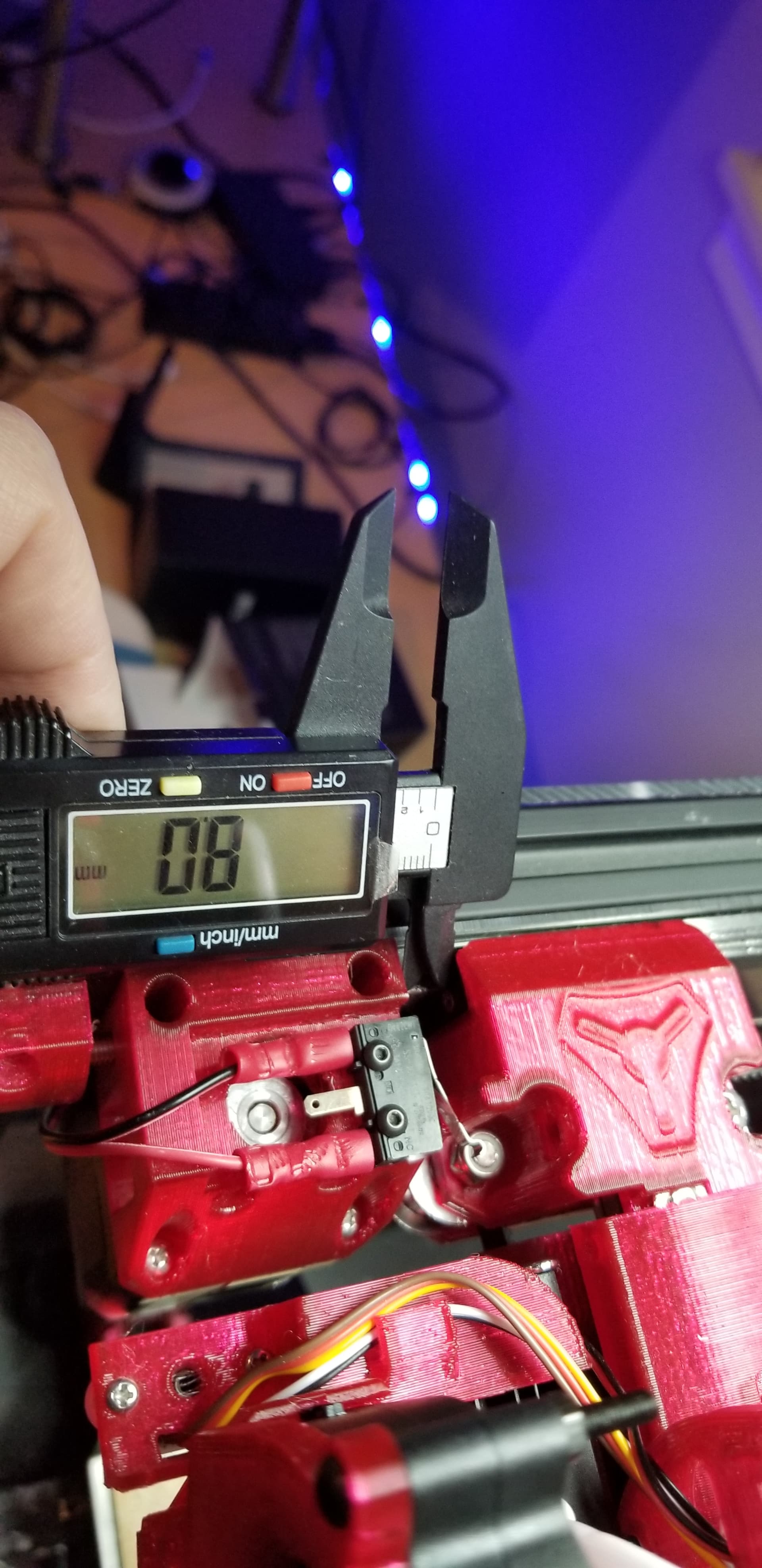

My X rail is ~0.805 degrees off from where I expected. Not 100% if my expectations are correct though, so included pics to clarify what I’m measuring. Note this is with the Right pulley incorrectly orientated.
Left
Right
move the rail all the way to the back and measure from there. The point you are measuring from looks like the motors and those move as you tension the belts. If you have one belt just a touch longer than the other it will make a difference. If you go all the way to the back against the idler mounts it should be touching on both sides equally
I wouldn’t measure from the motor unless they are both in the exact same location. With the ability to tension, that can change. I measured from a cross beam I installed on the front and from the back beam. Need to run the cal test to see just how far off it is, but now that it is in pieces, it will be different.

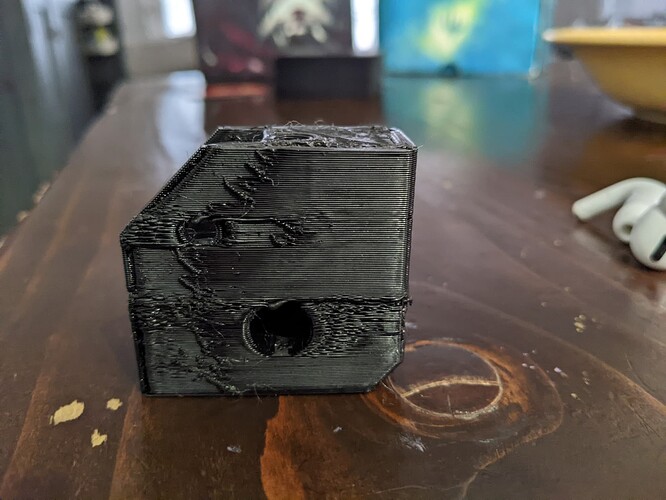

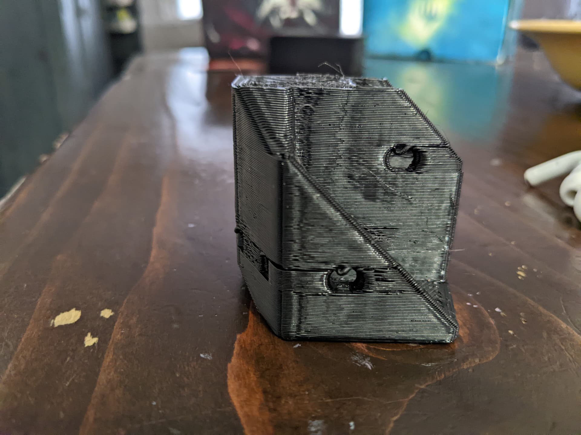

Pulley isn’t leaning, but I’m wondering if it wasn’t that twisted extrusion and the pulley bolt squeezing that oat together. I discovered a missing bolt that explains how the y rails twisted. The nut on the back corner was there but no bolt. The new part went on without issue. Lubed up the y rails and x rail, then tried to reprint a corner bracket and I probably changed too many things:
Because the next print turned out less than ideal. The holes are still squished in z and there is some ringing and corner artifacts around these holes. Changes to pressure advance and square corner velocity maybe need to be made. I loosened the belts and made sure it was still square, so perhaps some skew correction is needed. There will be some more adjustments and a few cubes printed hopefully before the petg runs out and it has to switch to another color of pla.

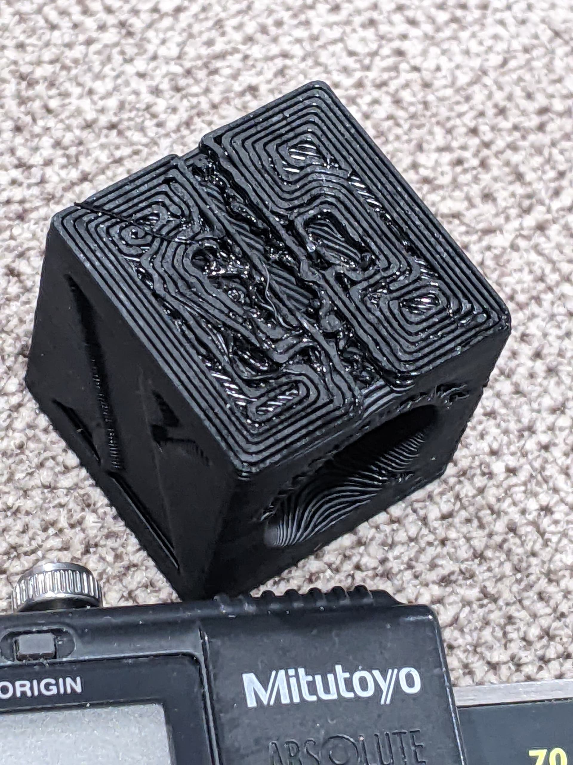

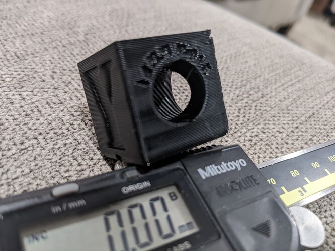

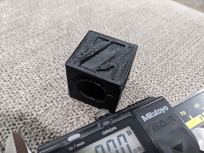

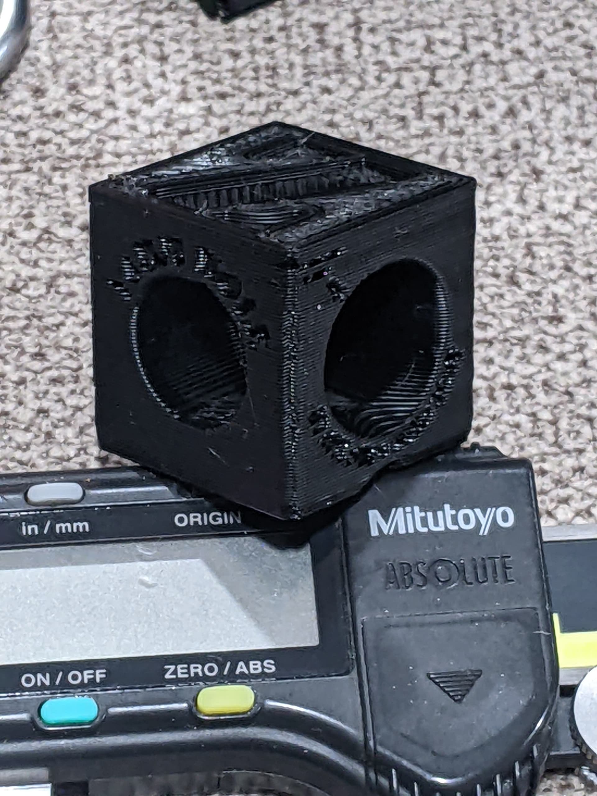

Cube 1: 20 min print just to see.
top is a bit rough and cant read the small inset
Dimesions in slicer → 25.4 mm on all sides
measured:
X: 25.49
Y: 25.65
Z: 25.89
This cube I searched up klipper config on this forum and basically “reset to stock” to get a baseline. That is where the 10k accel came from.
The worst side of the cube is the back corner at the top shown here:
I’d really like to get print speeds up around 150, but the first layer is the key here and it is pretty terrible:
I’m going to run a temp tower with these settings and then print the accel test. Not sure what to do about the top layer smoothness, but the sidewall waviness appears to be gone, but a longer run will be required to see if that is just from the scale and short sections.
