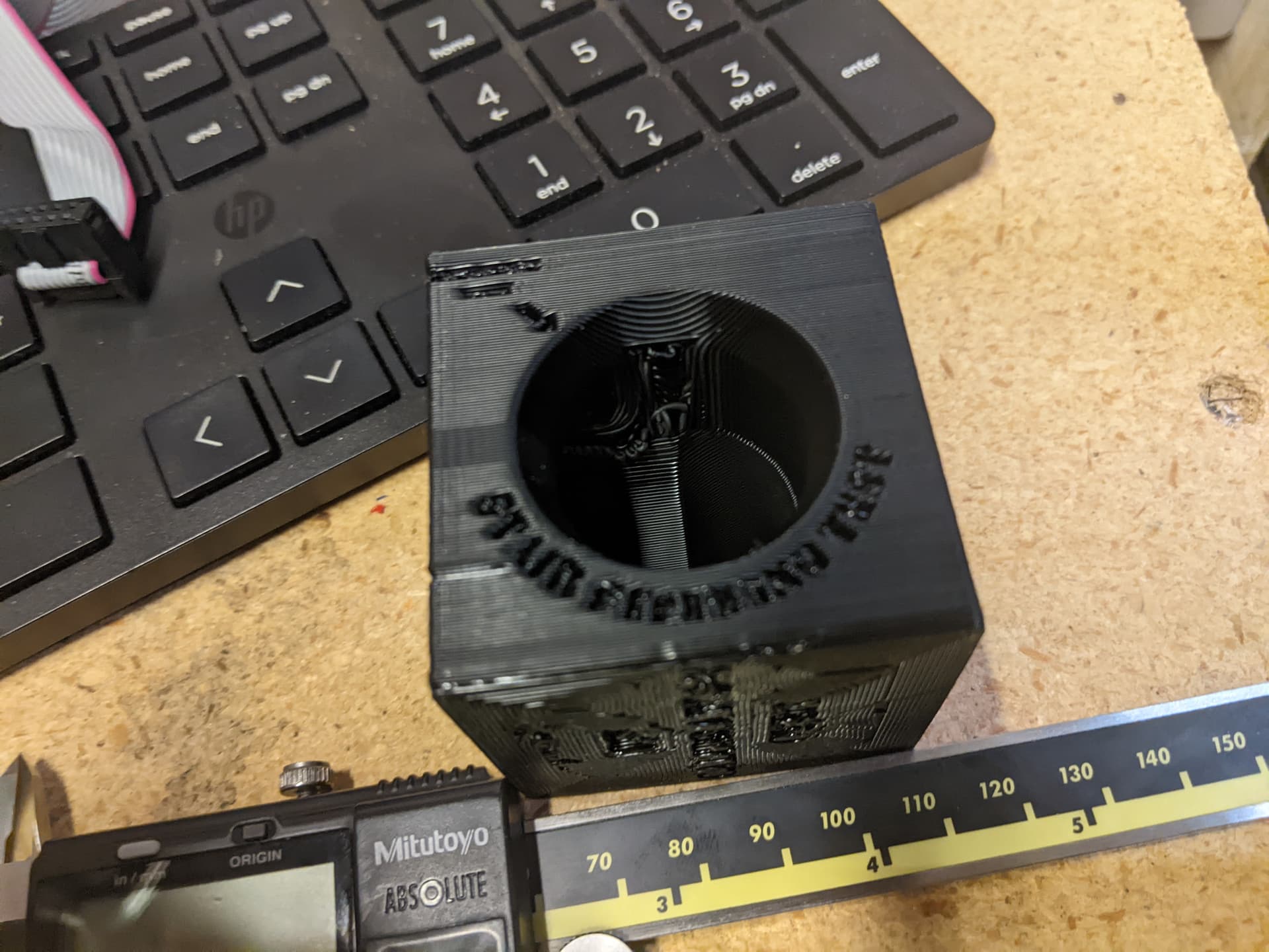

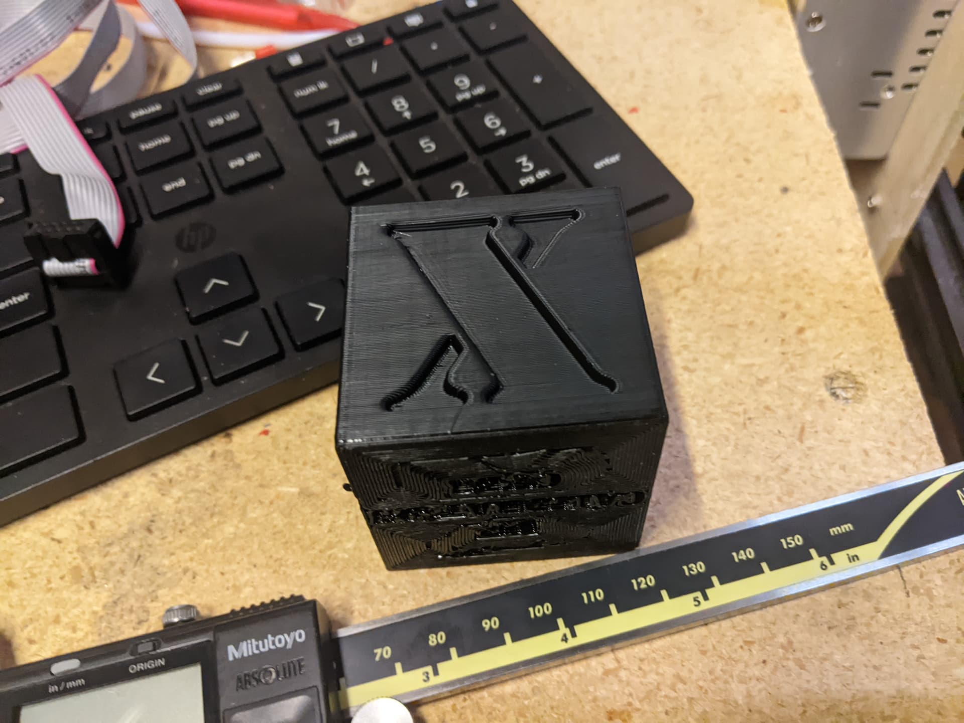

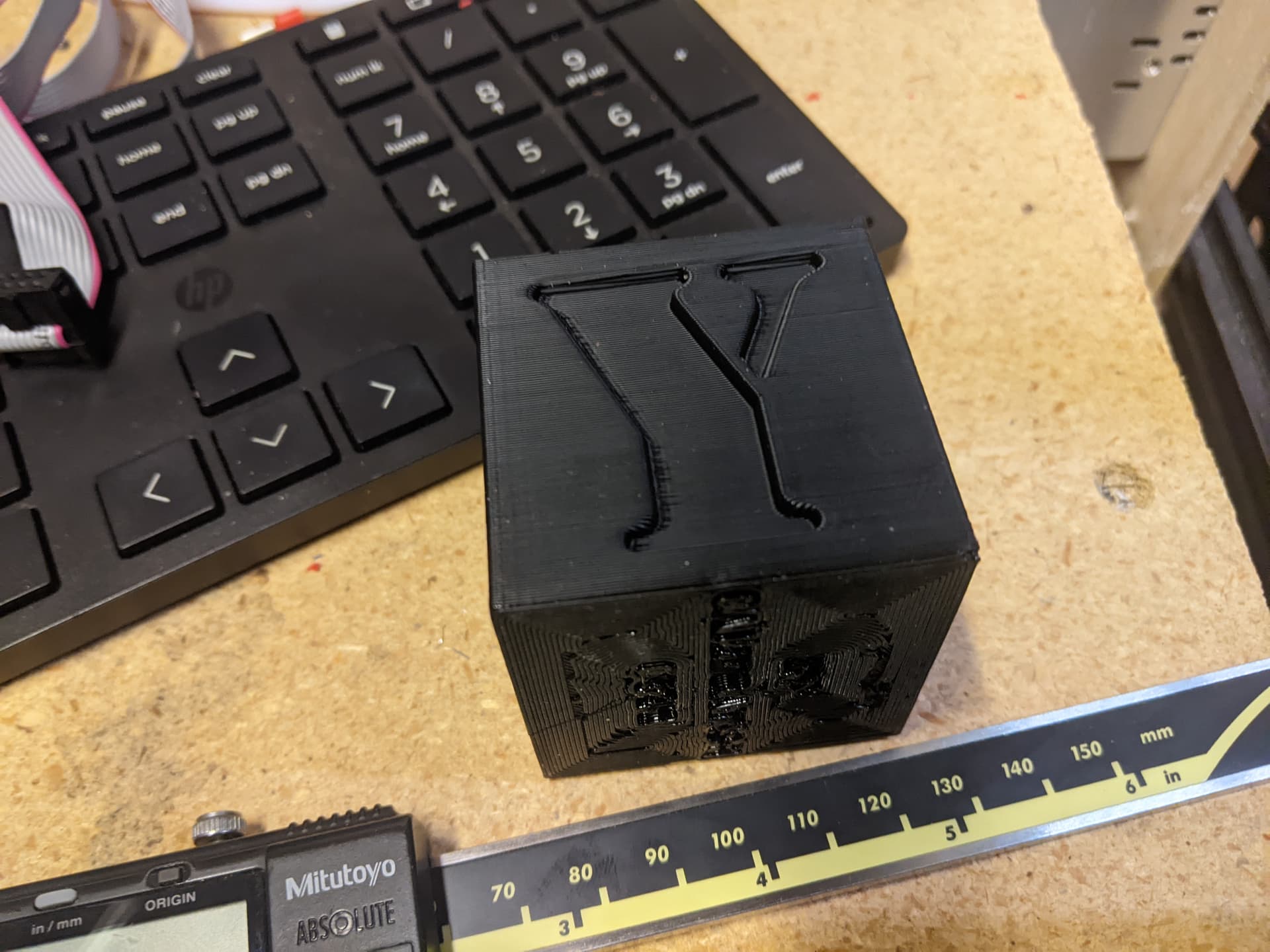

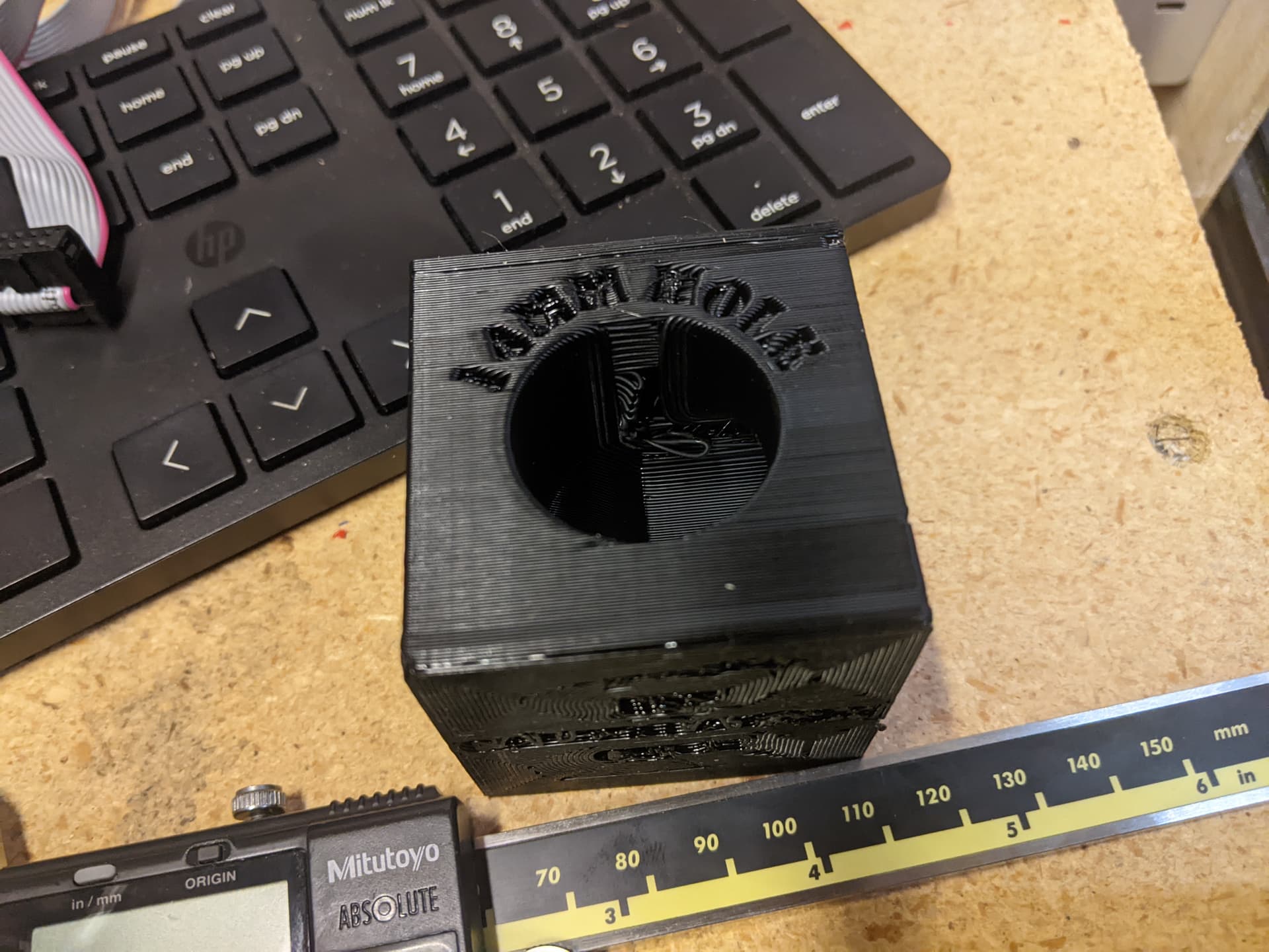

Ok, ran another one at 50 mm (double the size of the other) just to see if the lines were showing anything interesting.
Quick takeaways:
→ a temperature tower should help, the bridging sucks on this roll right now.
→ there aren’t as pronounced of wavy lines in X, none in y so either the pully tilt fixed it or the lube helped with bearing noise
→ layer height should likely be reduced for better feature fidelity
→ there is some skew
→ bottom layer needs more squish
X: 49.75
Y: 49.93
Z: 49.97 at smoothest, 50.26 at roughest
X0Y0 → X1Y1: 69.28
X1Y0 → X0Y1: 69.88

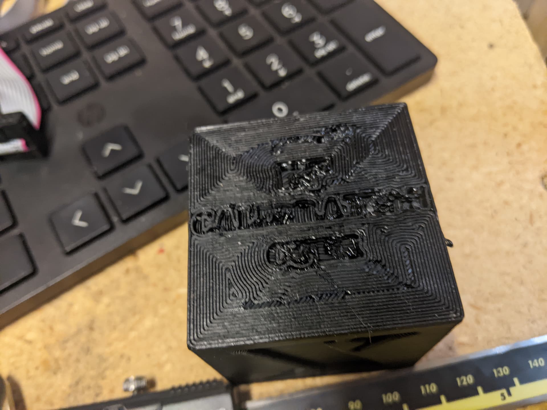

quality photos:
Bottom and top need some work.
  • Top needs temperature bridge tower
  • Bottom is base layer height adjustment

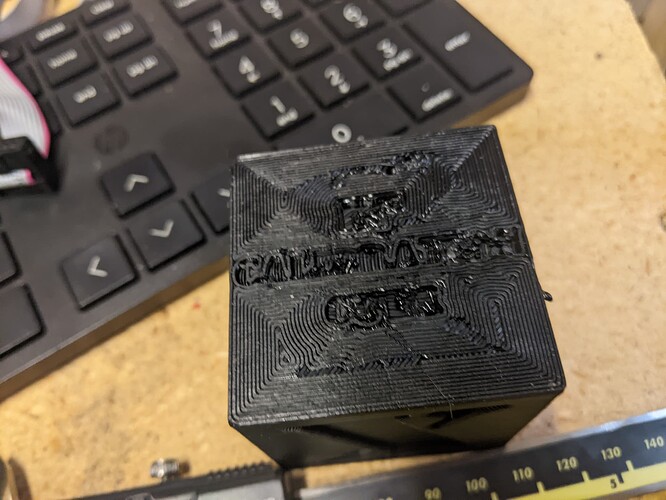

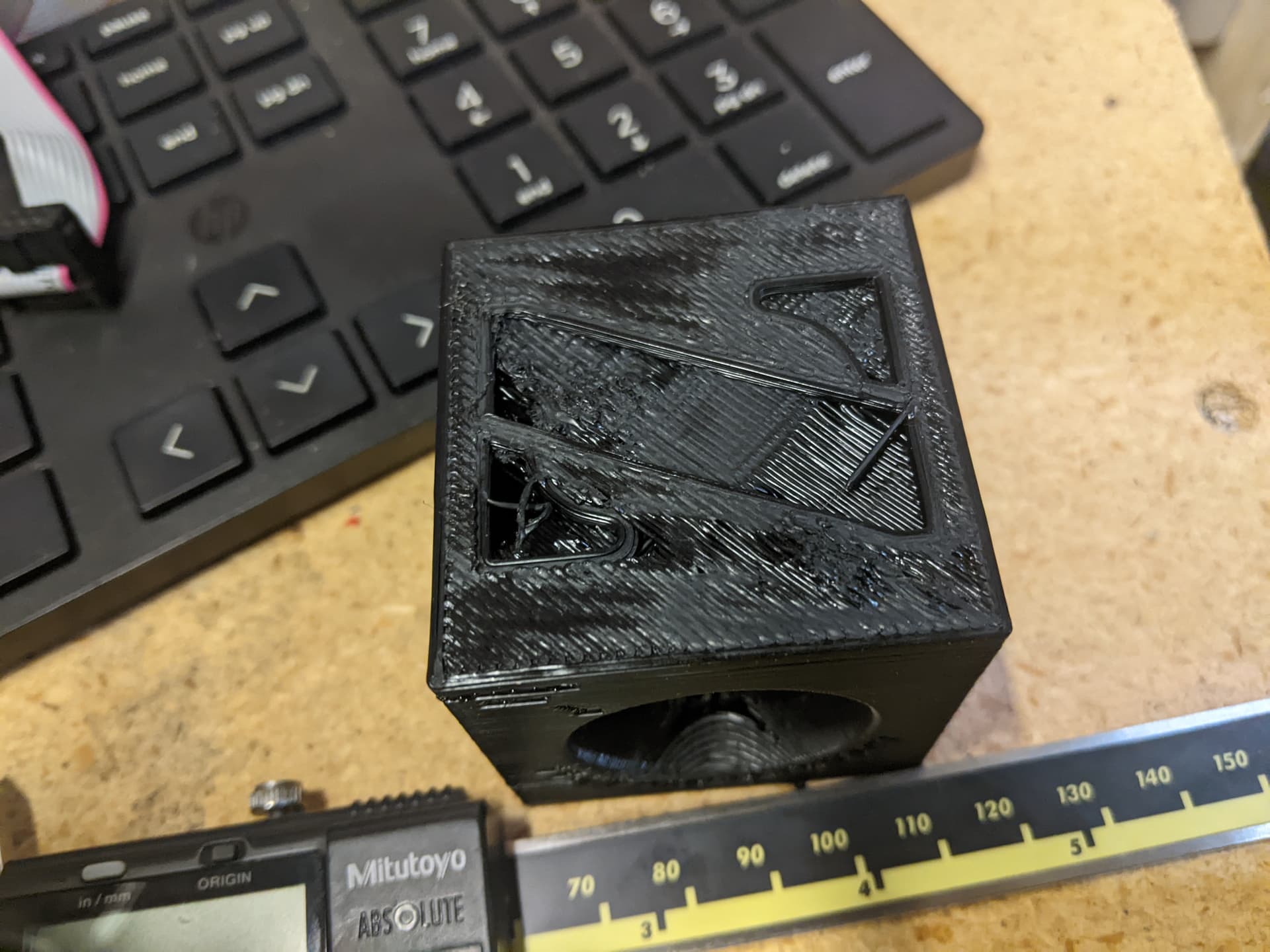

This picture is concerning, do you know what happened here?
That is the top layer and I think it means the temperature is wrong for effective bridging, which is why it needs a temperature tower.

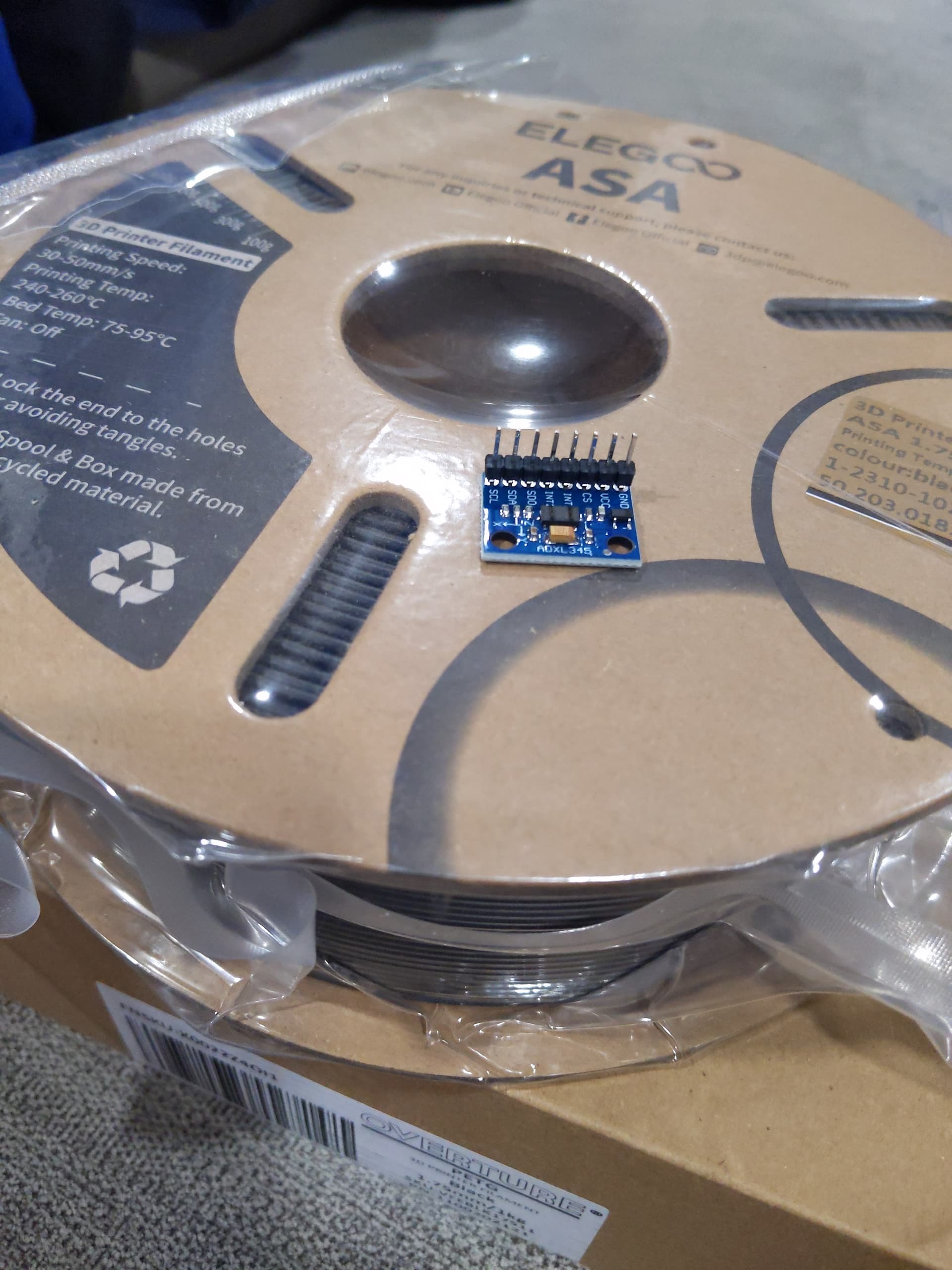

Look what came today!
Asa, more petg, and an adxl345 for shaping.
Those graphs from the shaping really are a cool thing! I cant wait to see what the difference is after I change a few parts out and run it again. Hopefully the belt shaper part wont tell me I have a mechanical problem anymore LOL

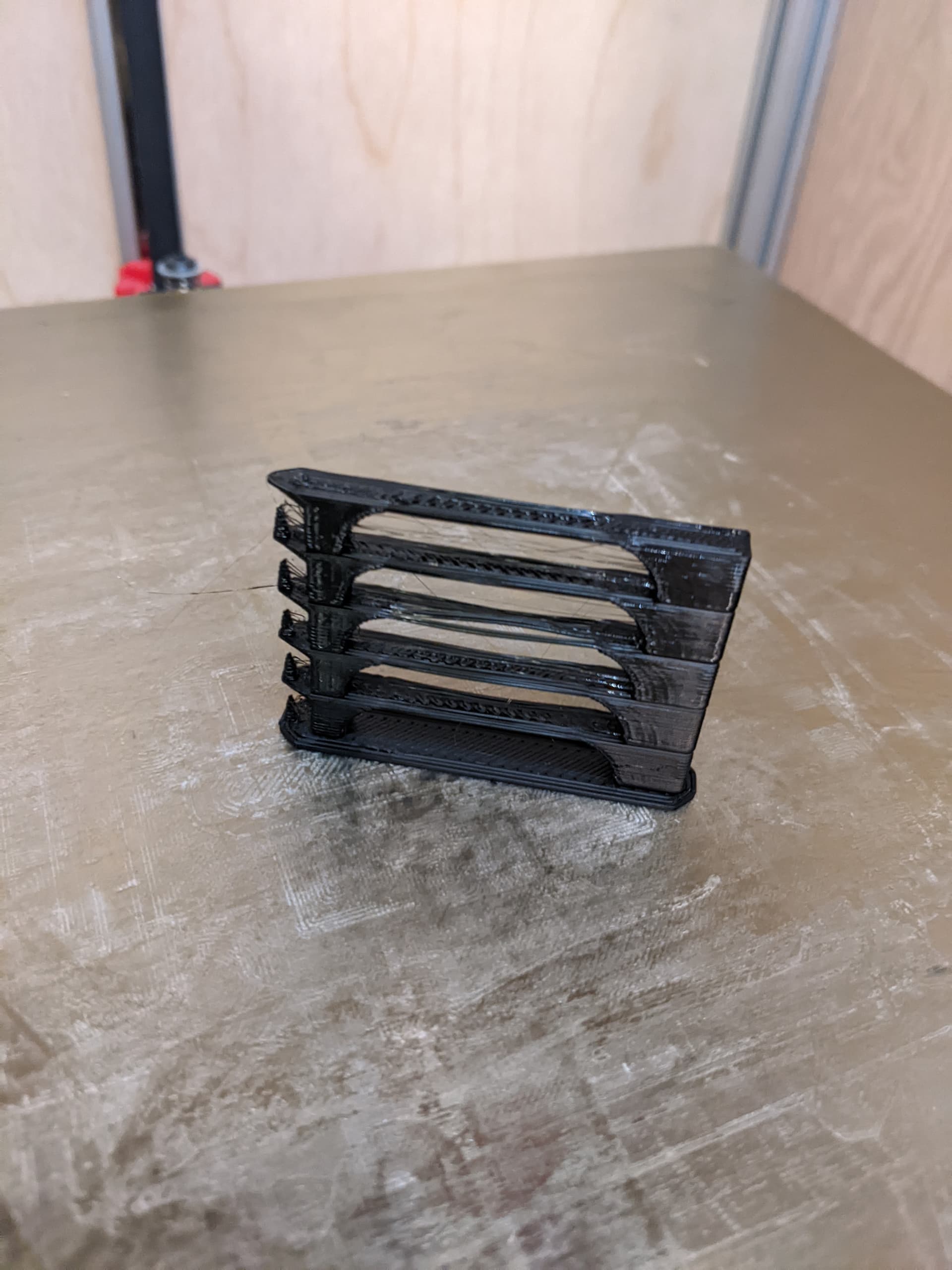

Got the 345 strapped on, printed a temp tower:
Picked the second bridge which was 235 (down from 240)
Made the adjustment and printed another 50 mm cube… sort of:

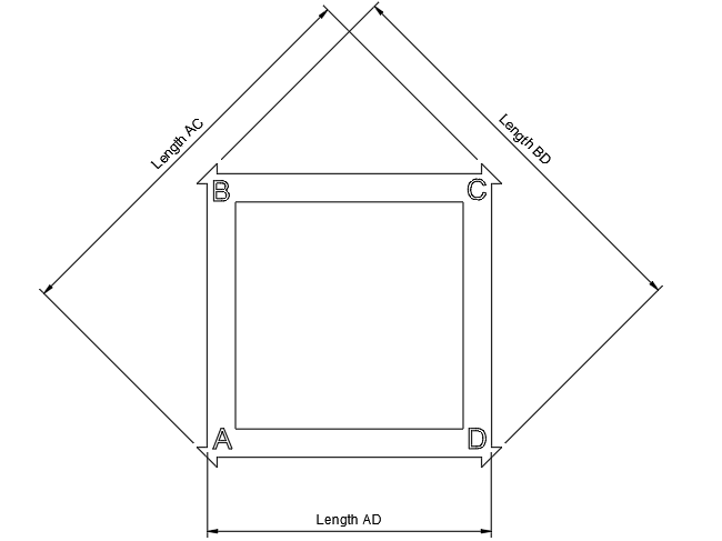

Tuning update. I read the docs again and again on skew and kept getting a parse error for the skew xy command. Added the = in there and it rejected it. Apparently you cannot set skew in the printer.cfg, you must do it via the terminal as a separate, one-time addition, then save the profile. Once you have a saved profile, then you can load it and use it in your .cfg file. My notes are below in case anyone wants to try it:
  1. to enable skew correction, add the following section to your printer.cfg file
    [skew_correction]
    There will be no other lines in that section. it could go at the very top or at the very end.
  2. Print a cube or square for an axis of interest
    i printed a flat-walled cal square box with 2 base and 0 top layers and 1 side layer in vase mode 20 mm high and measured XY plane
    if adding YZ or XZ plane, the cube should be the same height as the width and depth
  3. measure the printed cube. Laying flat it will look like this
(image credit: Skew correction - Klipper documentation)
where AB is Y print axis and AD is X print axis when in the printing position still stuck to the plate (label it)
could print with AB as Z and AD as Y or X so a total of 3 prints or do it as one print…
  1. record the lengths like below for a 100 mm open cube
Length AC = 139.23
Length BD = 140.49
Length AD = 99.3
  1. in the console enter the following commands one by one but use your measured values for AC, BD, AD
   SET_SKEW XY=139.23,140.49,99.3
   CALC_MEASURED_SKEW AC=139.23 BD=140.49 AD=99.3
the second one is optional, just gives an idea of how far off it is
response from system: Calculated Skew: -0.009009 radians, -0.52 degrees

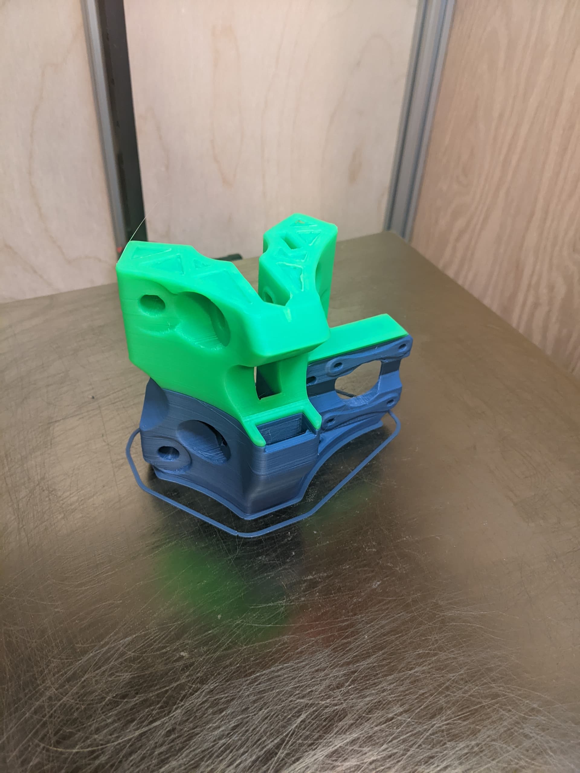

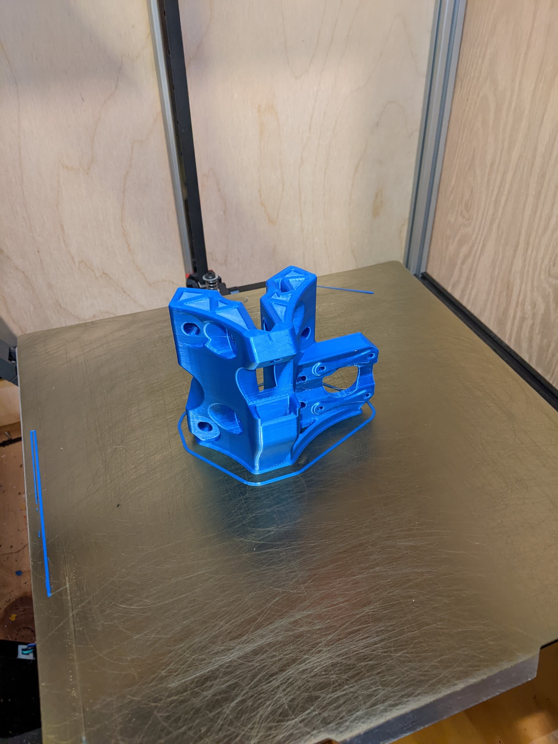

Latest tuning efforts have yielded the following:
The color is close enough?
Print settings
50% infill
0.28 mm layer height
4 walls
0.65 mm width
First layer 0.3mm
First layer speed 30 mm/s
First layer temp 215
Print speed 60 mm/s
Print temp 208
Print time 6 hrs
Now this is the best printer I’ve ever used, but I believe it can go head to head with my boys new Bambu with continued improvements.

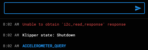

I have an adxl345
It is mounted above the hot end on the core and the X arrow and y arrow match the machine directions.
added
import adxl345.cfg
to printer.cfg.
adxl345.cfg is:
[mcu adxl]
# Change <mySerial> to whatever you found above. For example,
# usb-Klipper_rp2040_E661640843545B2E-if00
serial: /dev/serial/by-id/usb-Klipper_rp2040_E66038B713615530-if00
[adxl345]
cs_pin: adxl:gpio1
spi_bus: spi0a
#i2c_mcu: pico
#i2c_bus: i2c0a
axes_map: x,z,y
[resonance_tester]
accel_chip: adxl345
probe_points:
    # Somewhere slightly above the middle of your print bed
    150, 150, 390
[output_pin power_mode] # Improve power stability
pin: adxl:gpio23

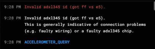

It is wired to a raspberry pi pico, which is connected to the klipper raspberry pi via USB. Not using rpi gpio because display is in the way. The 345 in klipper is set to communicate via spi:

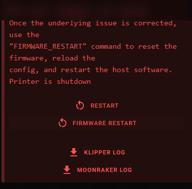

klipper reports:
which means something is wired wrong. The sensor is good because it streamed data on a different pico with circuitpython minutes before connecting it to Ernest, but it was communicating via i2c. It is possible that this chip has the SDO line pulled low to force it to communicate I2C. Need to get a meter on that line to see. The klipper error messages are not very helpful. The config file has been adjusted and the wiring verified… not sure what else to do here.
Another available option is an mpu6050 that communicates I2C (now “supported” by klipper), but the cfg syntax is wanting and the only example is the mpu9250, though they are all family chips in the mpu line, so it is implied that they communicate the same, but that is not explicitly stated. There is no valid [mpu6050] section allowed in klipper. [mpu9250] is allowed, but when running the ACCLEROMETER_QUERY, the system halts:

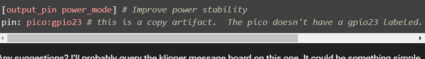

pin: pico:gpio23 # this is a copy artifact.  The pico doesn't have a gpio23 labeled.
Any suggestions? I’ll probably query the klipper message board on this one. It could be something simple as is often the case. As I was typing this, one thing on the preview to the right stuck out:
so I tried it by commenting that line out:

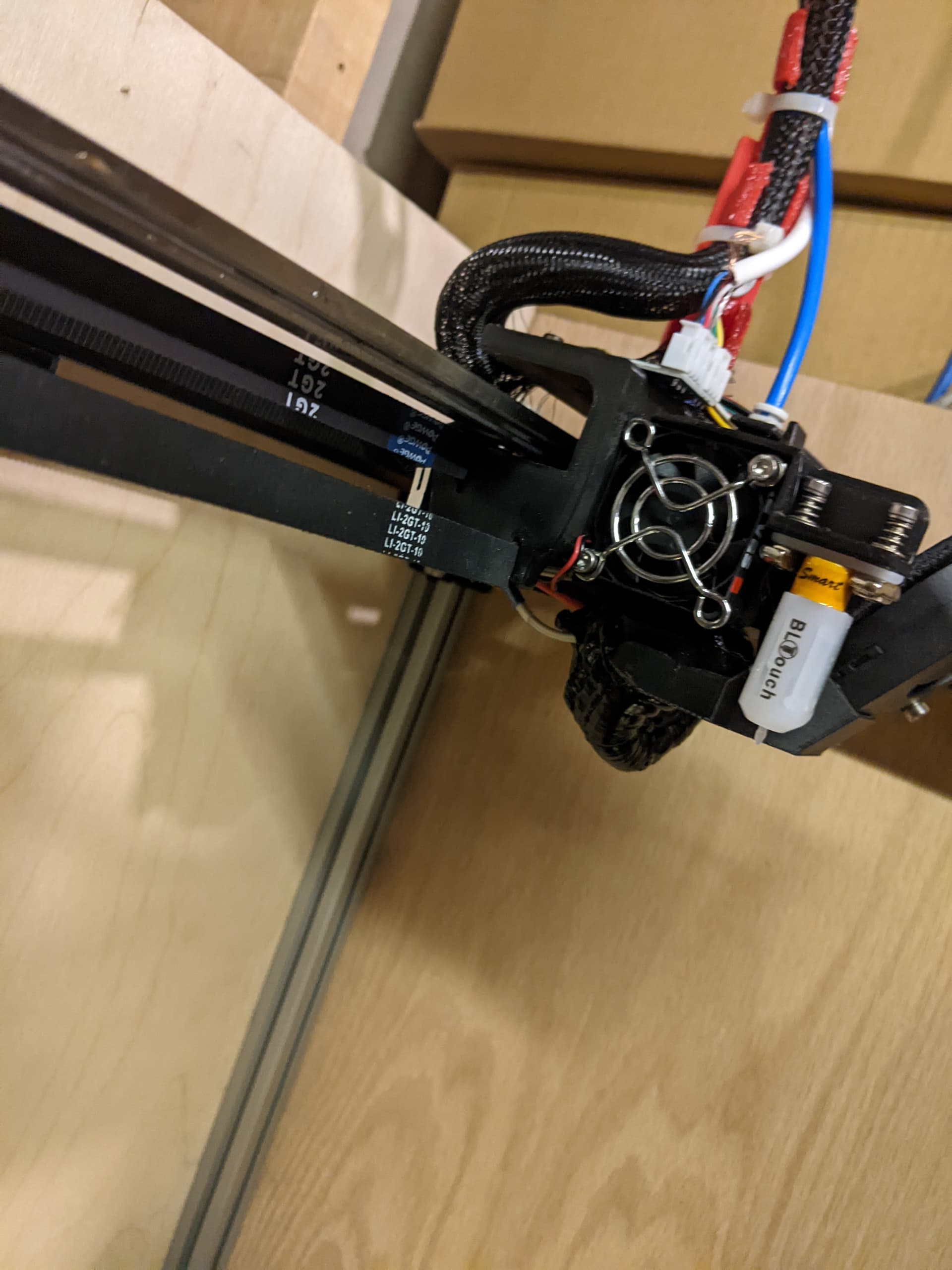

Ran the shake tune belt vibration test last night… First test ever. I’ll post the plot in a later edit. What stood out was the belt flapping when that resonance hit and then the filament lever went nuts shaking. Not sure what to make of that. Sounded cool though.
Did you do the belt tune with the gates motorcycle tuner first?
I put a rubber band on mine. I could hear it clicking all day and that test really shook it. Poor design choice on that part for sure.
This one test was the first tune test I have ever run on anything other than like a temp or retraction tower. This is a whole new world. Printers to me have been like toasters… push the button and go. Not so anymore.
