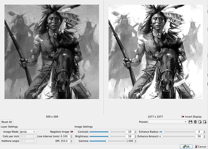

I’m just starting to explore this, NWT, and am having some issues which I believe is the photo I’m using. I’m using lightburn and xtool d1. When I’ve imported the photo into lightburn and done my image adjustments, the preview looks almost entirely black. I havent tried actually engraving one yet. Your method is well documented doing the engraving, what about some advice in prepping the photo?
any help is apprecaited.
Are you by chance trying to use grayscale? That will preview as all black unless you check the “shade according to power” setting. But that still probably won’t look very good on a tile…
My “layman’s explanation”… look at any single row (constant speed) on these test tiles from three different lasers and you probably won’t see a linear white-to-black gradient of blocks on any of them. But that’s what grayscale is doing… it scans across at a constant speed, varying the power, but the paint and tile won’t’ react the way you’d hope. Dithering OTOH simulates shades of gray by varying the density of dots/dashes… so the laser is switching on and off at varying rates and constant power. So all you have to do is pick the nicest blackest-black block on the test tile to determine the best speed and power for your choice of paint and laser. Doing a test tile is crucial IMHO to get predictable results.
All my ceramic tile images are dithered. From the “Adjust Image” window in LB…
I usually set the mode to Jarvis or Stucki and then adjust the DPI… usually 254 or 300 dpi. Then eyeball the contrast, brightness, and gamma to what looks good to you. The enhance radius and amount work together to add “pop” to the image, if desired.
This is pretty much the recipe I follow most times. Hope this helps.

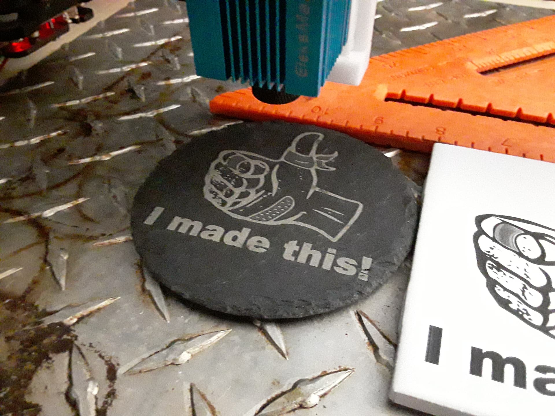

After playing around with samo-same 2.3W laser and NWT process… and fun graphic on ceramic tile

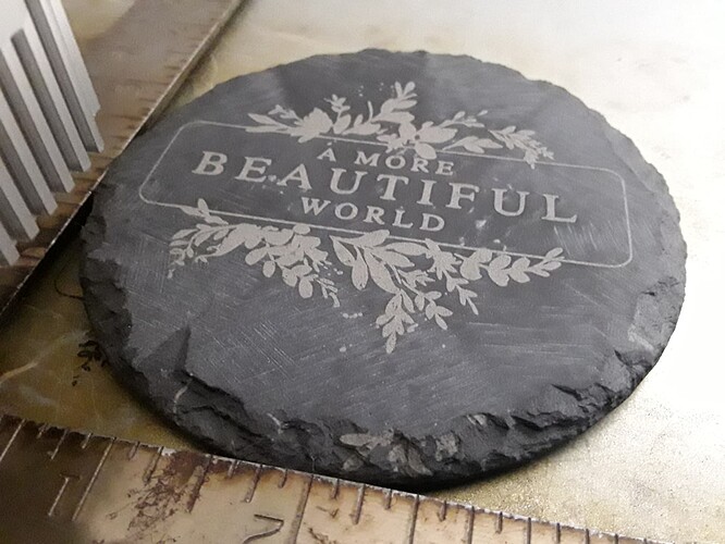

I tried slate for the first time. First, a tiny NWT test pattern with my trusty 2.3W laser on bottom of first victim… yields a surprising range of usable speed and power
So, picking 2500 mm/minn and 80% power, got a fairly decent result first time…
Note that lasered areas turn lighter on slate… will probably need to use a “negative” image for photos…
Super easy process for slate. I"m hoping – in my best “Elon-think” – “the best finish will be no finish at all” :wink:
