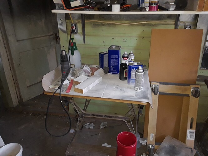

I’ve read in several places (and seen in a couple of videos) of paint removal/scrubbing being a PITA. What are you using?
I use acetone almost exclusively and it usually does very well… especially on flat surfaces, like a ceramic tile. I just pour just enough to “flood” the entire surface and within seconds the paint bubbles up and often comes off in “sheets”, wiped and lightly scrubbed with steel wool. It evaporates rapidly so I usually follow up with a paper towel, wetted with acetone. It usually comes pretty clean pretty quickly. I then go scrub it with dish soap and water.
Coffee cups/handles and odd surface are a bit more time consuming (can’t “flood” the surface) but still not that terrible. Then again, I’m usually doing small pieces… and just onsies and twosies at that. :wink:
I don’t get nearly so good results using paint thinner… and it smells worse IMO. Some videos I’ve seen, folks are using denatured alcohol or other cleaners and having a dickens of a time removing paint. I’ve never had that kind of trouble with acetone. YMMV of course… :wink:
– David
“acetone”… “flood”… :man_facepalming:
Well, at least you aren’t tossing in “1:1 bleach to ammonia blend” or “submerge in xylene and apply heat”…
And you have mentioned in the past that the weatherproofing in your house is… sub-optimal. So I assume that means you have reasonable ventilation.
Yes, it’s acetone, i just didn’t have an appropriate container to flood and didn’t want to use any more than I had to. I soaked a small rag and got scrubbing. Honestly, it wasn’t HORRIBLE, just tedious.
Dang! Maybe I’ve been playing with this stuff too casually. Shoulda made the wif go outside to do her nails all those years ago… :wink:
Actually, I have a little breeze-way station set up… where I do all the painting and paint removal.
And the “flood” isn’t much more than a couple of tablespoons of acetone per tile. No container needed… any excess simply soaks into the cardboard work surface and evaporates almost instantly.
