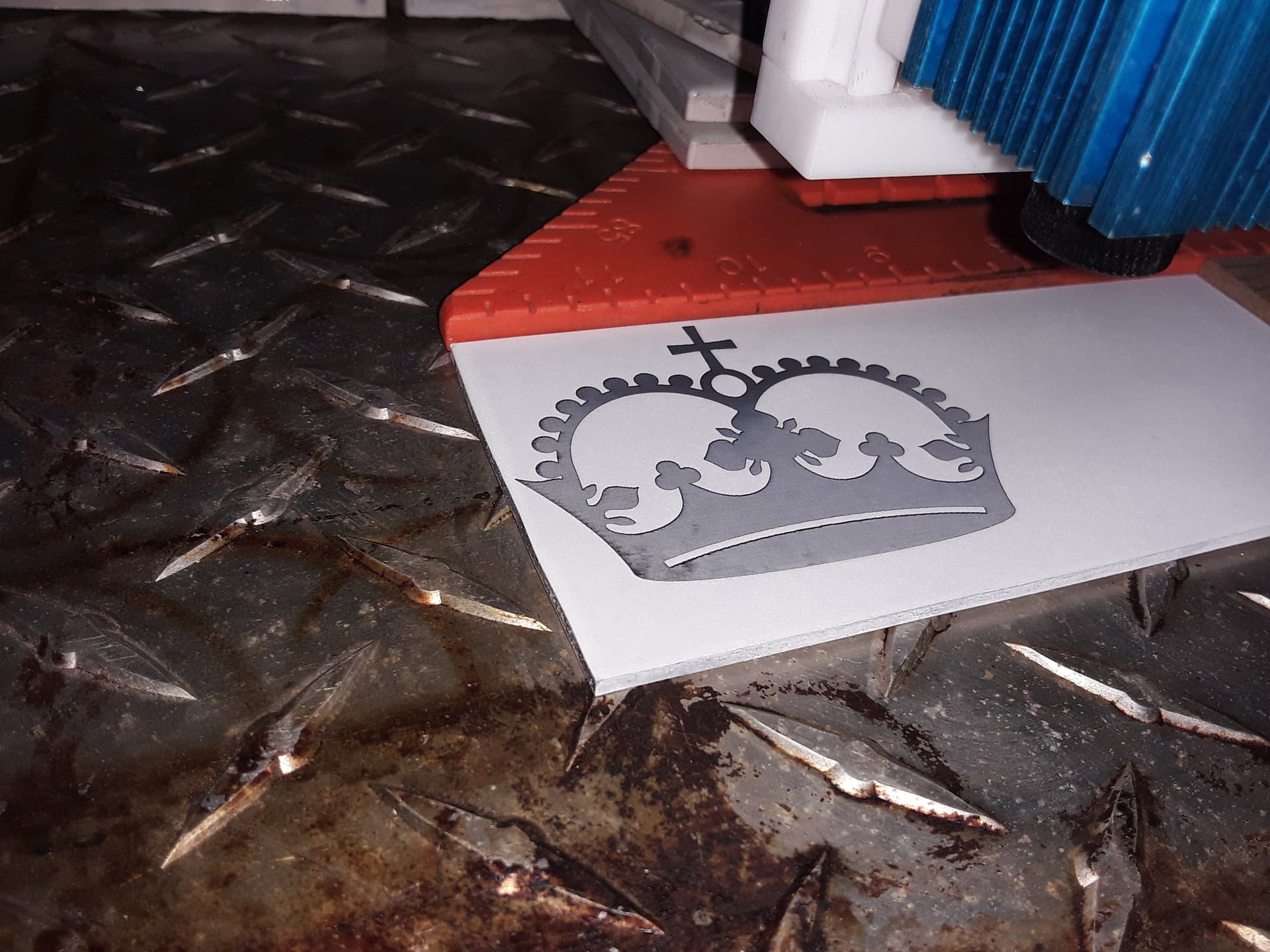

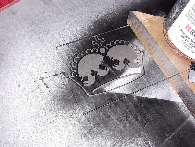

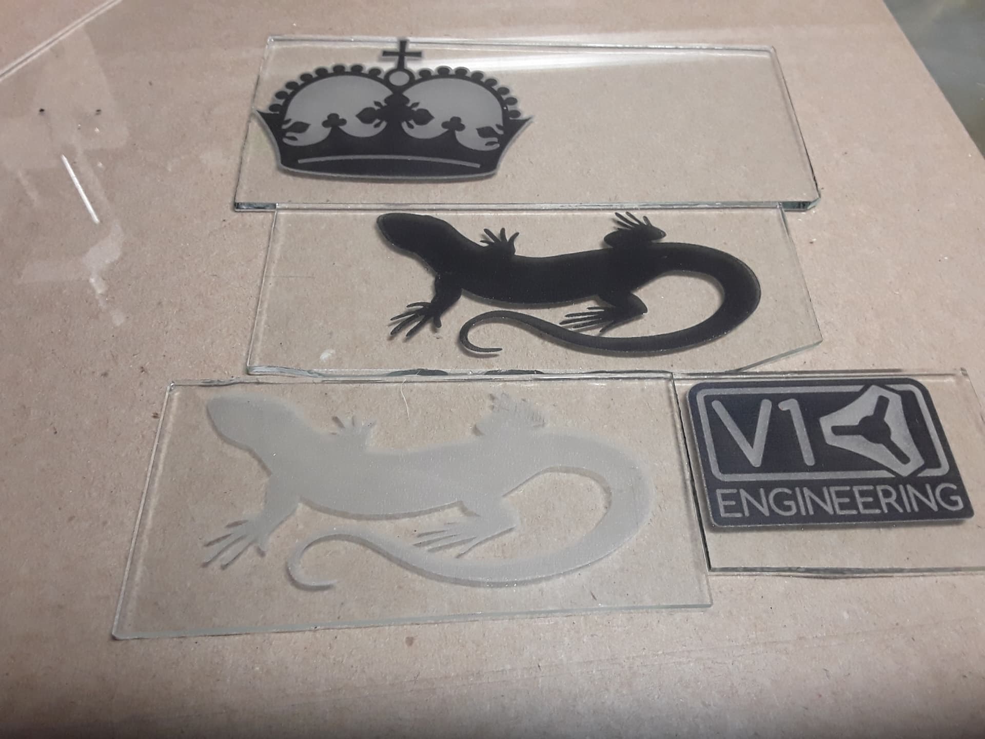

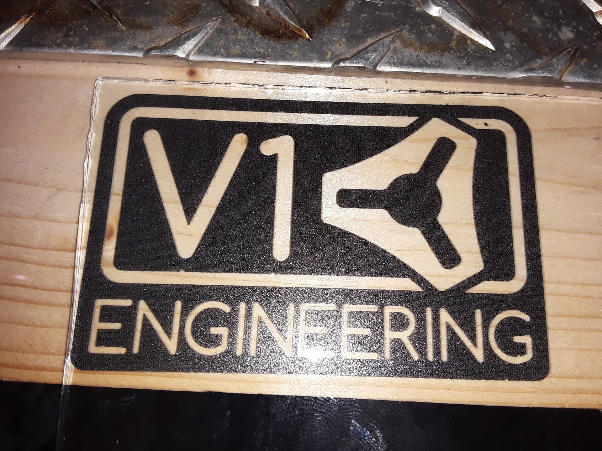

Black painted and lasered for the lighter, frosted areas…
Paint removed and before repainting with flat-white paint…
Painted white and lasered for the darker, black areas…
Pics to prove it happened… see?
Hope this is good enough to get me into the club… :roll_eyes:

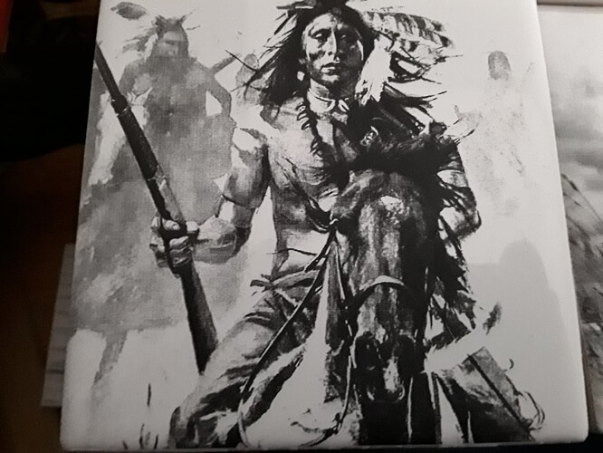

TBH I don’t do much grayscale… it’s too time-consuming IMHO to figure the max/min power for the range of grayshades for a given picture on a given material with a given laser.

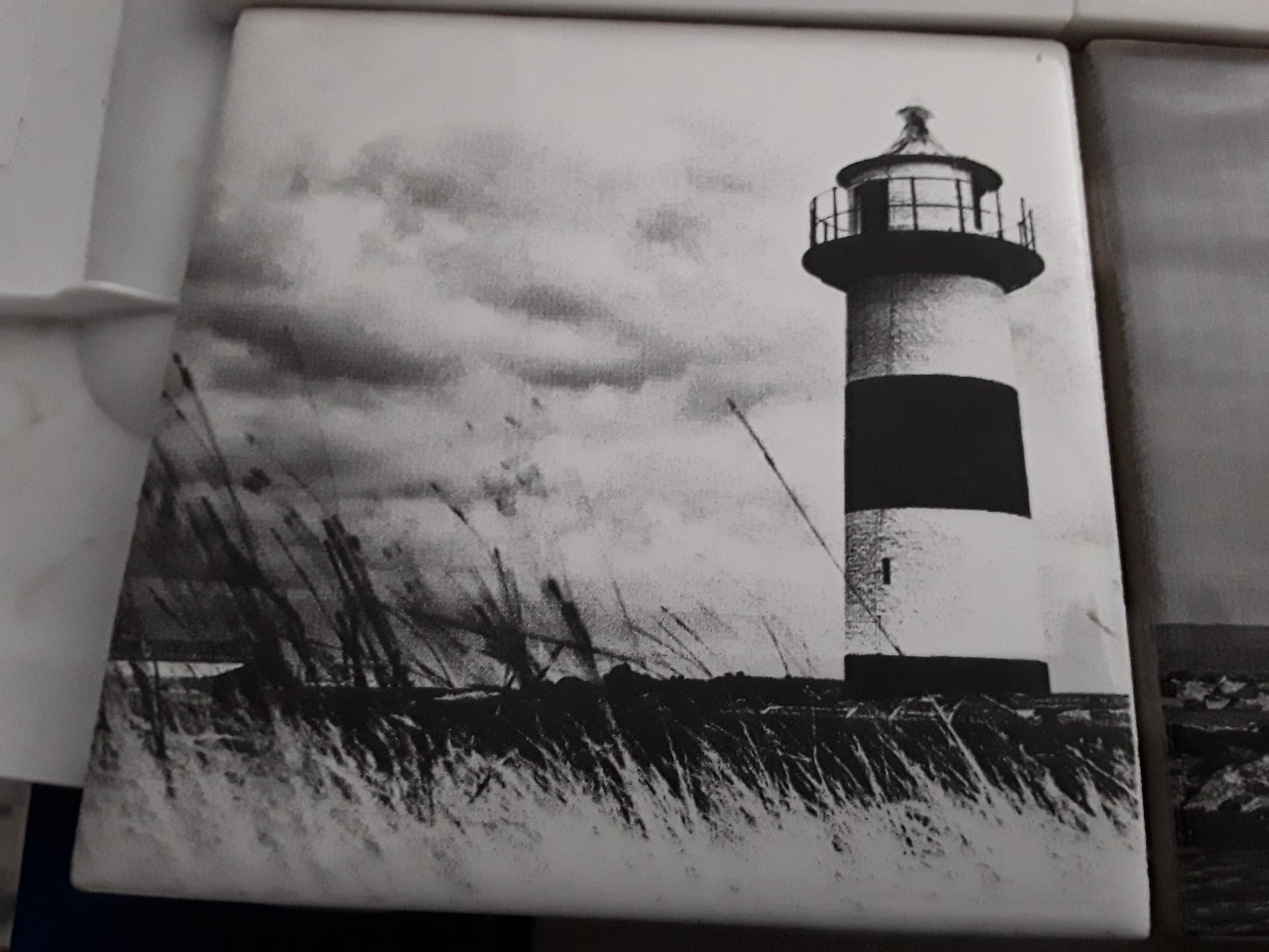

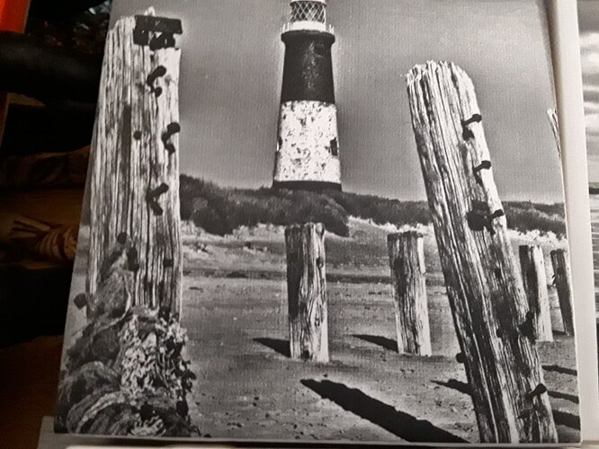

Dithering an image seems far easier and approximates the shading well enough for the less-than-photo-perfect images I get on odd or organic materials. This image is the exact same NWT process above but using just the flat-white paint step… turns out black & white, with many shades of gray…
It’s easy and I’m pretty happy with it.

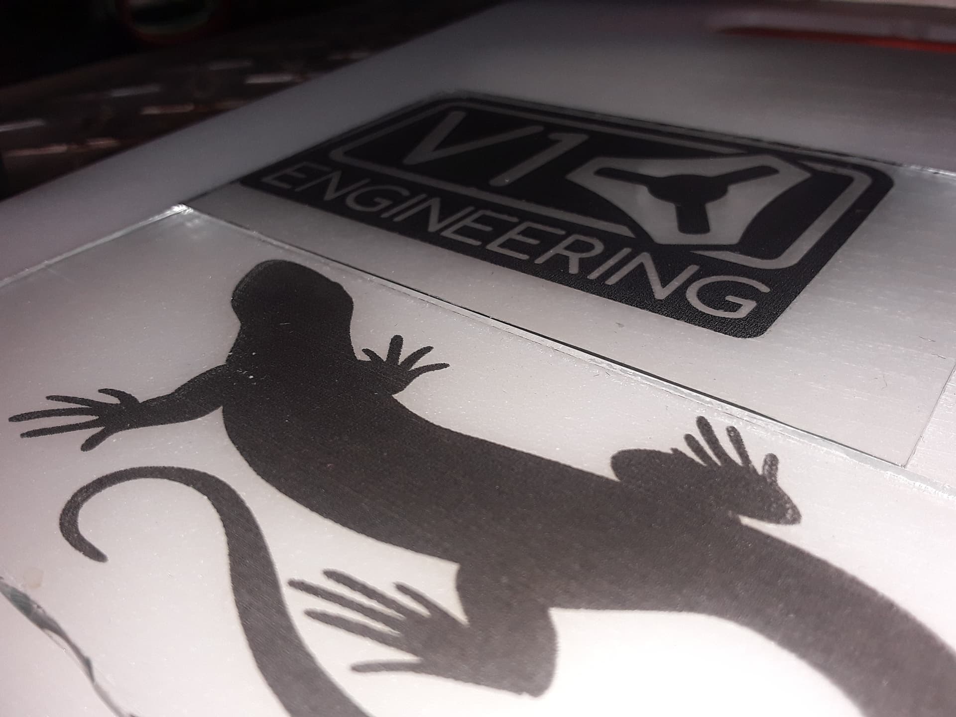

Jamie, I’m using Lightburn to create 2 complementary (opposite blacks/whites) gcode files from just one image… so , in the gcode, “registration” and the origin is the same in both files. And, because they are complementary, each file and process step is only acting on “virgin” glass and doesn’t effect glass previously etched. All that remains then, is to insure mechanical registration is as good as I can make it; i.e. top edge against the square and top-right corner against mechanical stop… and make sure not to bump the laser out of position.

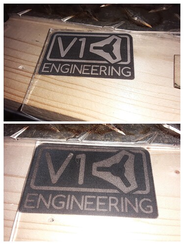

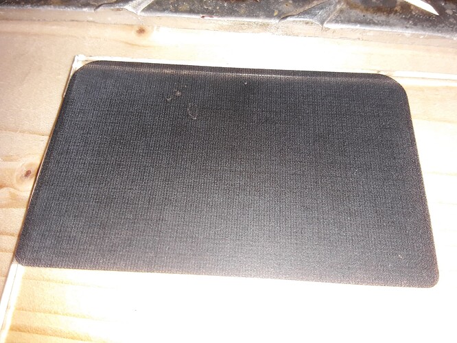

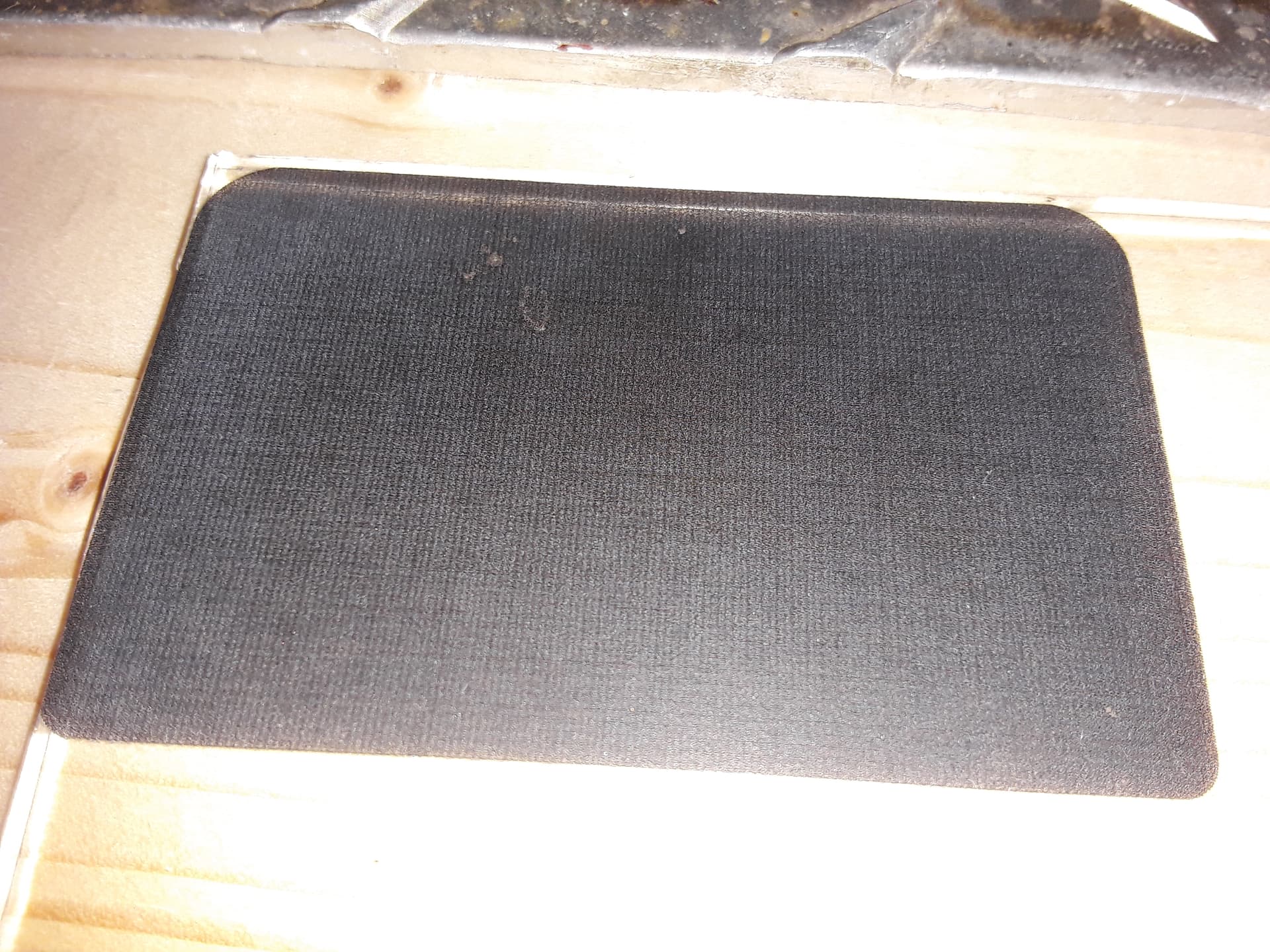

Before realizing I had to have complementary files, I tried “positive/negative” image files, and managed to put “black over white” on one test. The result is a “textured black”…
as opposed to a smooth black…
I haven’t tried “white over black” yet, though I have thought about it. I’ve wondered if I might skip a paint step by putting down a solid black background (a blackened “fused”/smooth surface) normally… and then try to “ablate away” the white foreground image. It is a test I want to try…

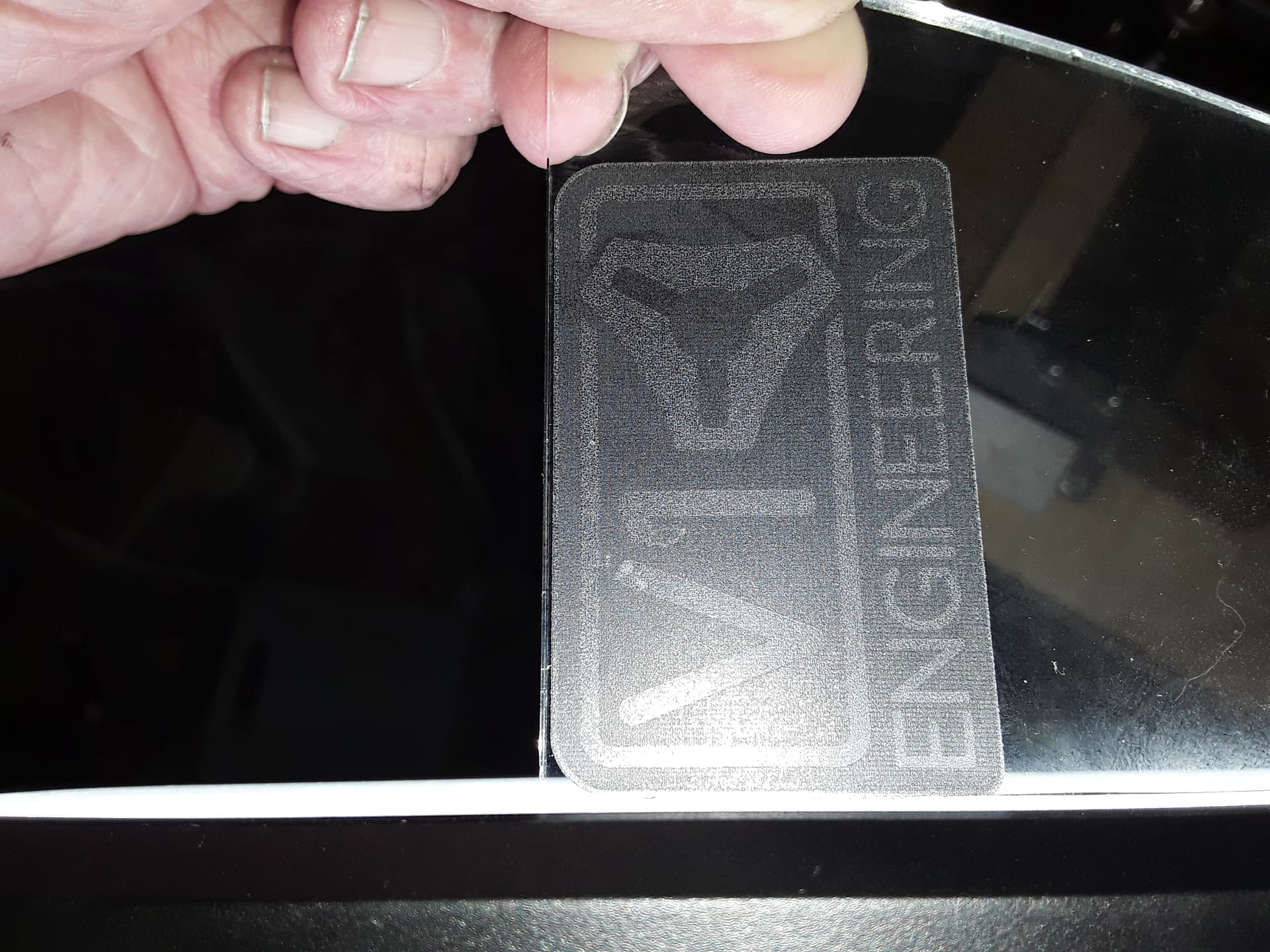

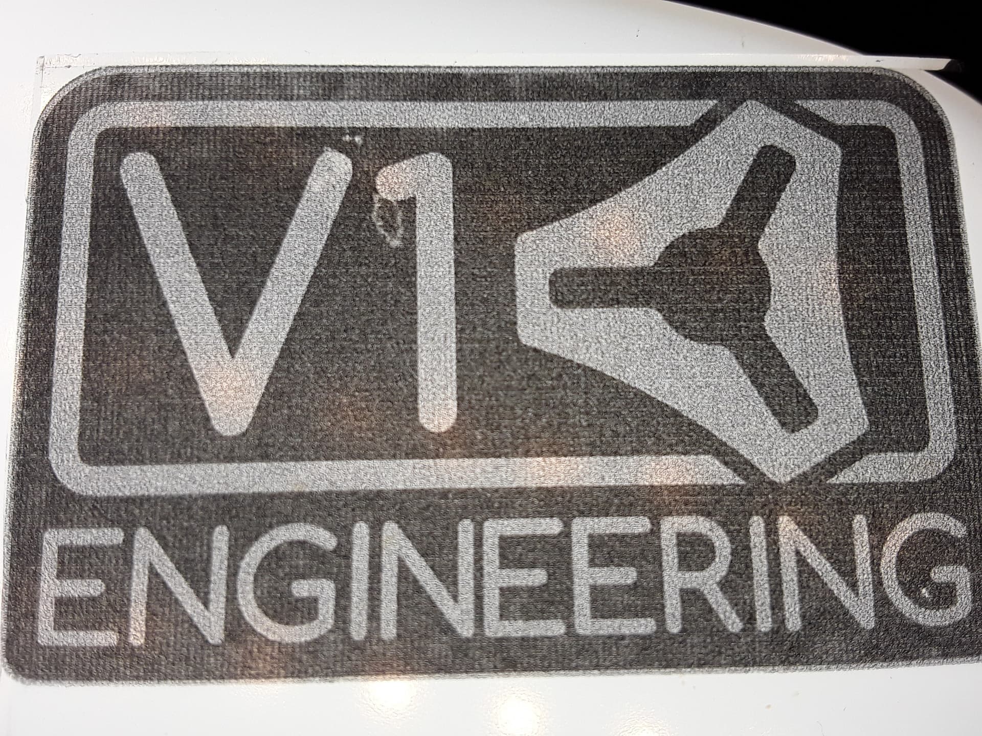

Interesting, somewhat surprising, results from our “white over black” test…
Created a solid black background using normal NWT white-paint process and then cleaned up…
Without painting black, then simply lasered the light/ablated image onto the solid background…
Far better than I expected… slight imperfections near top of “1” was also on the solid background…
Doesn’t edge-light worth a flip… not nearly as well as “normal” two-step paint-on processed image does…
I suspect it’s because the ablated material comes from the raised solid background layer rather than the glass body proper underneath, as it does with two-step, paint-on, processing.
Image (bottom) also seems “dimmer”/“duller” than one done normally (top)…
A bit surprised that it worked at all, this doesn’t really yield as nice a result IMO. Though the initial solid black background might have been better and “blacker”, the final image just doesn’t seem as bright and sharp to my eyes. And this would be a “show-stopper”, I suspect, for those who are looking to edge-light the image.
There are probably lots more things that could be done to test this process but I’m pretty satisfied I know why I’m seeing what I’m seeing. So I will probably do further tests only if the “spirit” moves me… the rest, I’ll leave as “an exercise for the reader”… :wink:
– David

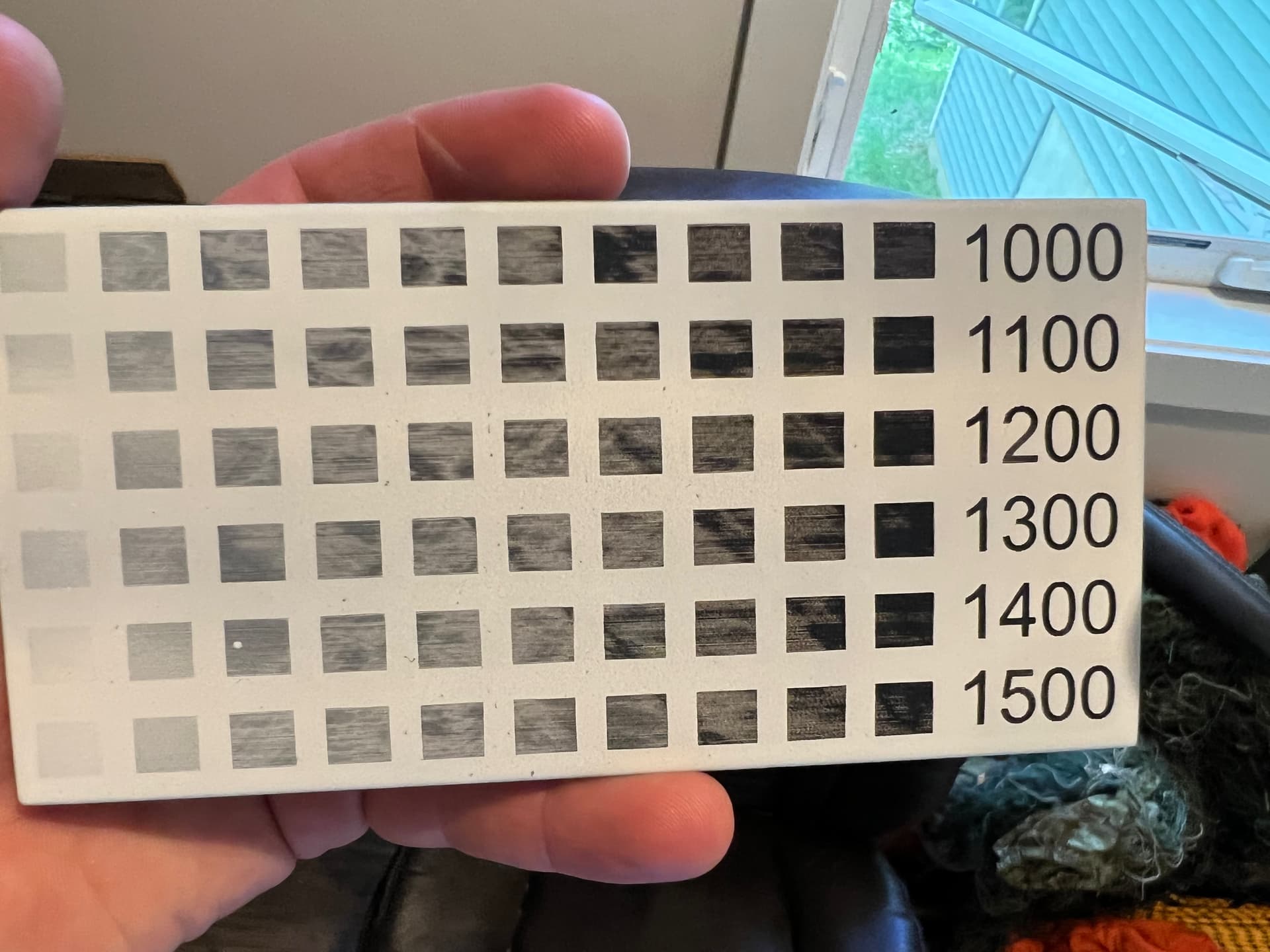

Ok here’s a strange one. I did some tests with glass tiles I had left over from a project. The difference is that the glass is already frosted.
Here’s my power/speed test using it. Btw, the blue is just blue paint on the back side, it’s not blue glass.
It’s interesting that some of them are extra frosted and others are black.
I think I’m looking at frosted glass with painted blue back? Then you painted with flat-white paint and lasered a speed/power matrix, ranging 1000-1500 mm/min and 10-100% power.
If so, it does make sense, I think. Consider this tile, painted flat white, lasered with a matrix, and then cleaned…
Flipped left to right to match the speed range of your matrix, and ignoring the absolute speed range (different lasers), the darker blocks are generally toward the higher-power range and the lighter blocks are in the lower power range. Also, oddly, there are some blocks in the lower power range that appear to simply be ablated, i.e. the glaze has been blasted away, leaving raw ceramic exposed. No real patterns here… but note there is a pretty extreme sensitivity to the power and speed used in closely-spaced blocks, especially near the lower-power end of the matrix.
Normally, this is not a big deal, if you are simply looking for the best and blackest black [remember, we’ve used flat-white paint (with TiO2) to get black] to use with dithered images. On this tile and with this laser, I’d pick maybe 1250-1500 mm/min and 90-100% power… and the rest of the matrix is of no interest; i.e. I was just looking for blackest black.
On your test piece and given the paint/laser/range you’ve used, I’d suspect you might pick 1200-1300 mm/min and 100% power to put the blackest dithered images on your frosted glass… and ignore all the other settings; i.e. your test piece has served its purpose. OTOH if you are looking for lighter images against the blue background I would use flat-black paint.
Note also, this might well explain why it’s near impossible to get a good grayscale image… there’s not a single speed line/row where a linear change in power results in a nice gradient from white to black.
I could be wrong but that’s the way I would interpret what your are seeing… :thinking: :stuck_out_tongue_winking_eye:
– David

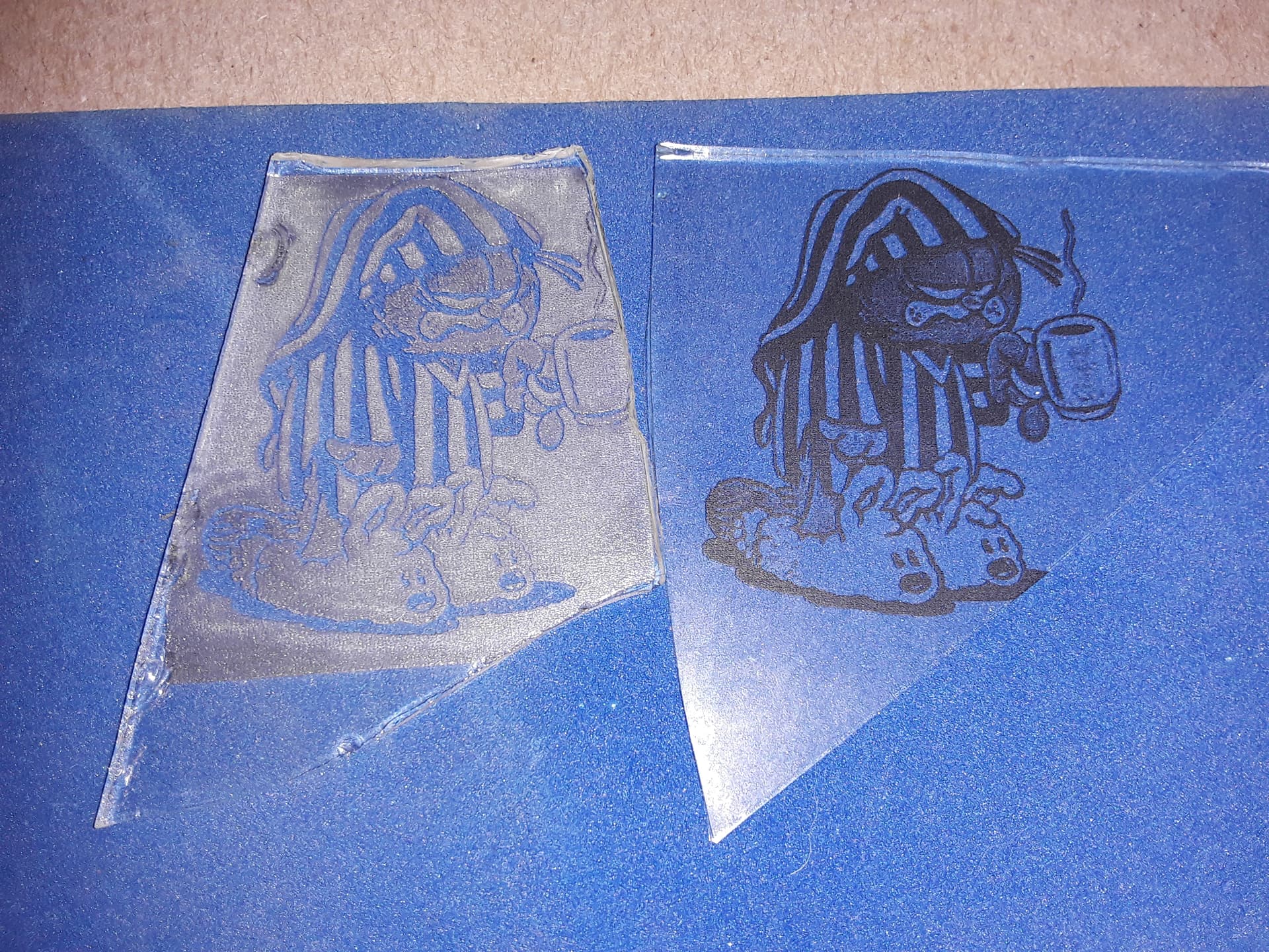

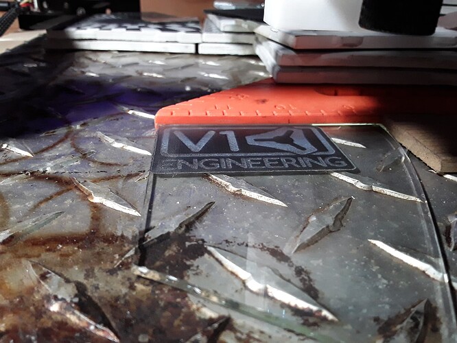

Transitioning to transparent glass was pretty painless once I had ceramic tile down… maybe just luck, I simply slowed down a bit to 1000 mm/min (from 1500 mm/min). Here, I’ve demonstrated the use of different paint/methods to get either black or white/frosted images… or even a combination of both. It actually worked quite nicely…
These pieces of glass are scraps from broken window panes taken from my great-grandmother’s little house from the 1940’s. No idea it’s composition… it’s just what they were using “way back when” in rural East Texas ! :wink:

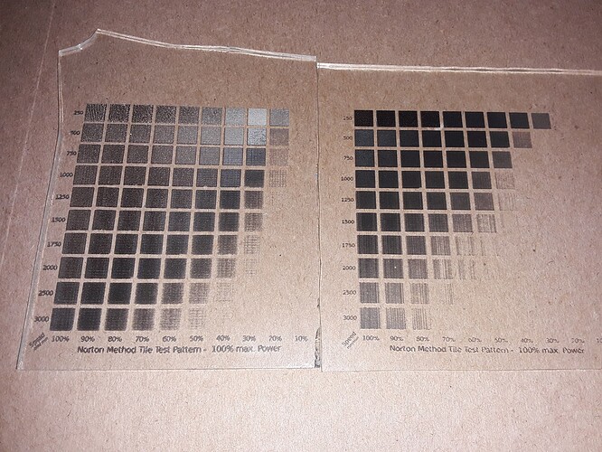

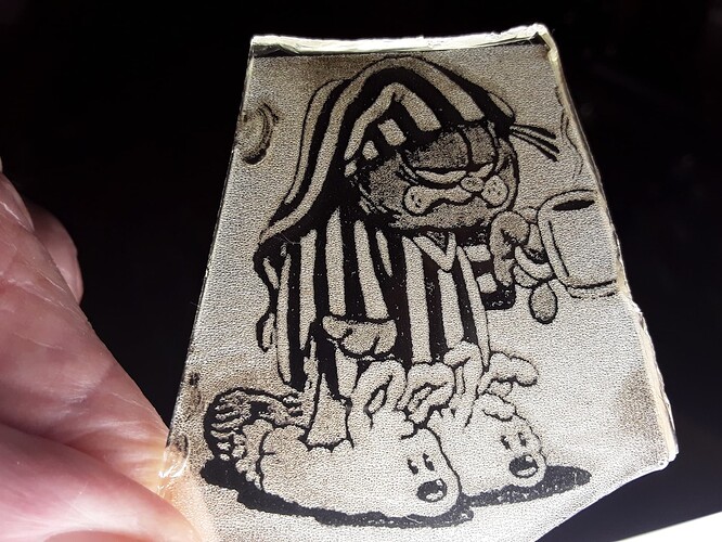

I finally got around to doing the power/speed matrix on transparent glass using two different lasers… left is Neje A40640 (~10W) dual-diode laser and right is my trusty Eleksmaker 2.3W unit. Both runs used the exact same gcode file and, given the power is specified in percentage, the 10W laser is putting out roughly 4X the power of the little 2.3W laser. Note the quality of the best blacks is IMO worse for the more powerful laser than for the lower-powered unit… and explains why I choose to use my little 2.3W laser for this kind of work
So, picking 1000 mm/min and 90% from the matrix, I engraved my buddy Garfield on a flat- white painted piece of scrap… and the result is a reasonably nice black image
Contrasting the frosted- white image (using black -painted glass) to the black image (using white -painted glass)… note the blue foam background shows through opposite parts of the images…
My take-away from this is that getting a good black image on transparent glass is not likely to happen by accident or hit-or-miss. Taking the time to engrave the power/speed matrix is almost a necessity to identify the speed and power to get the best image from your laser and the paint selected.
Good luck!
– David

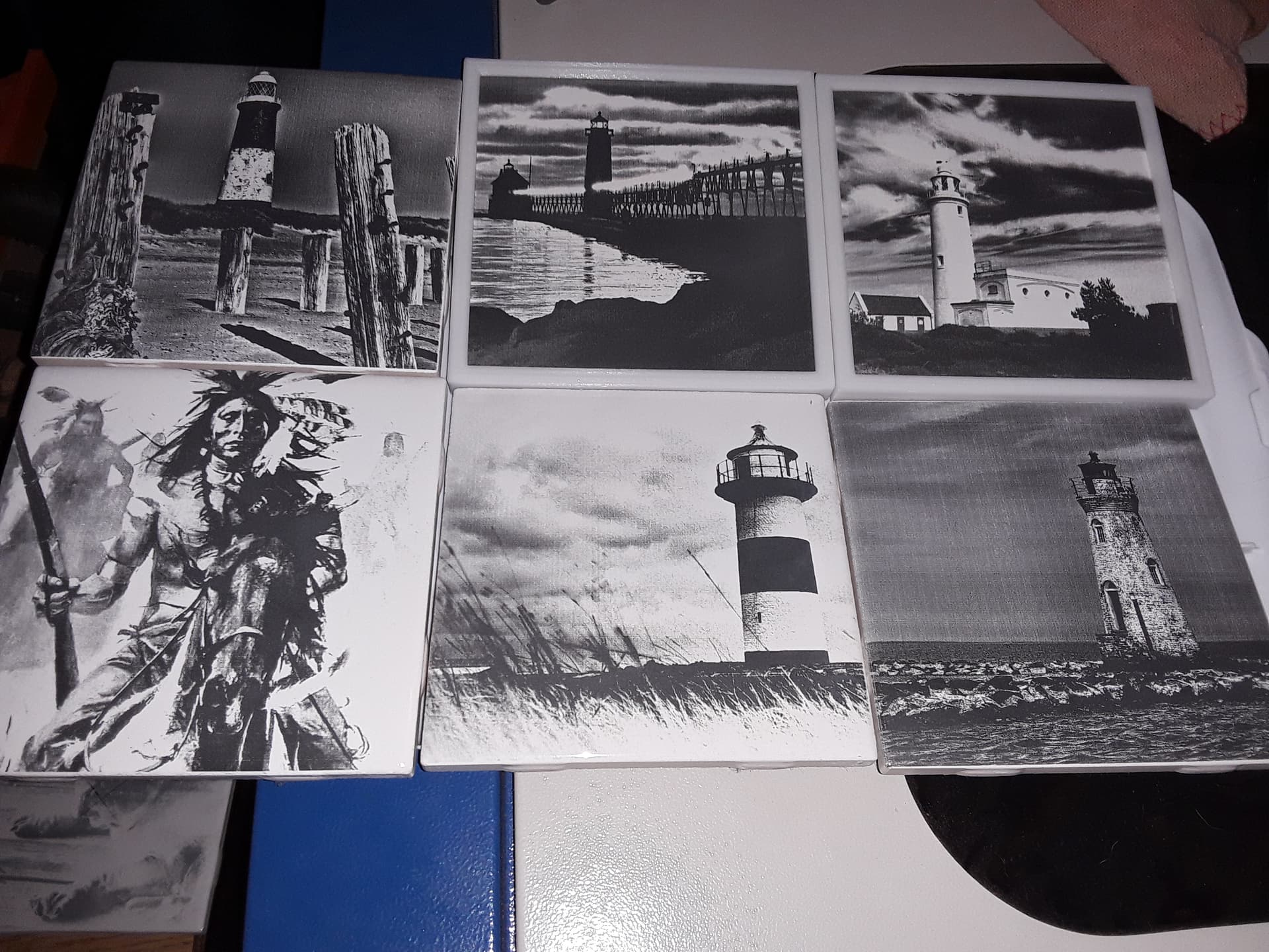

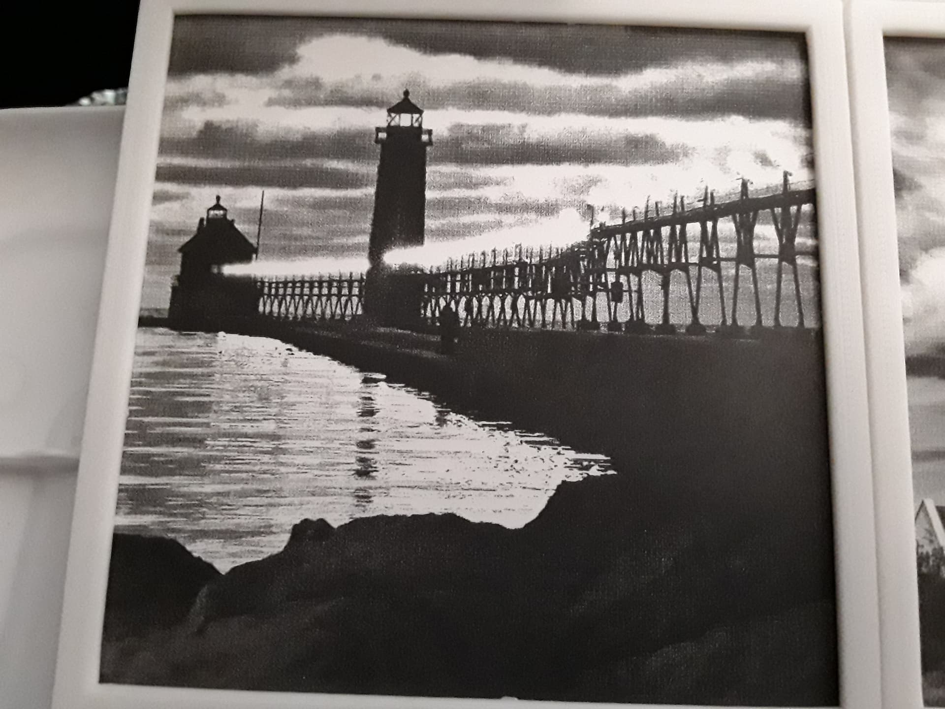

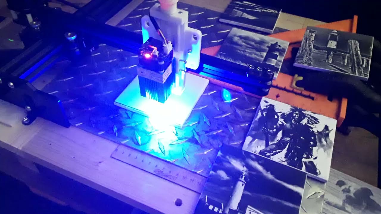

WODB… Which One(s) Doesn’t Belong?

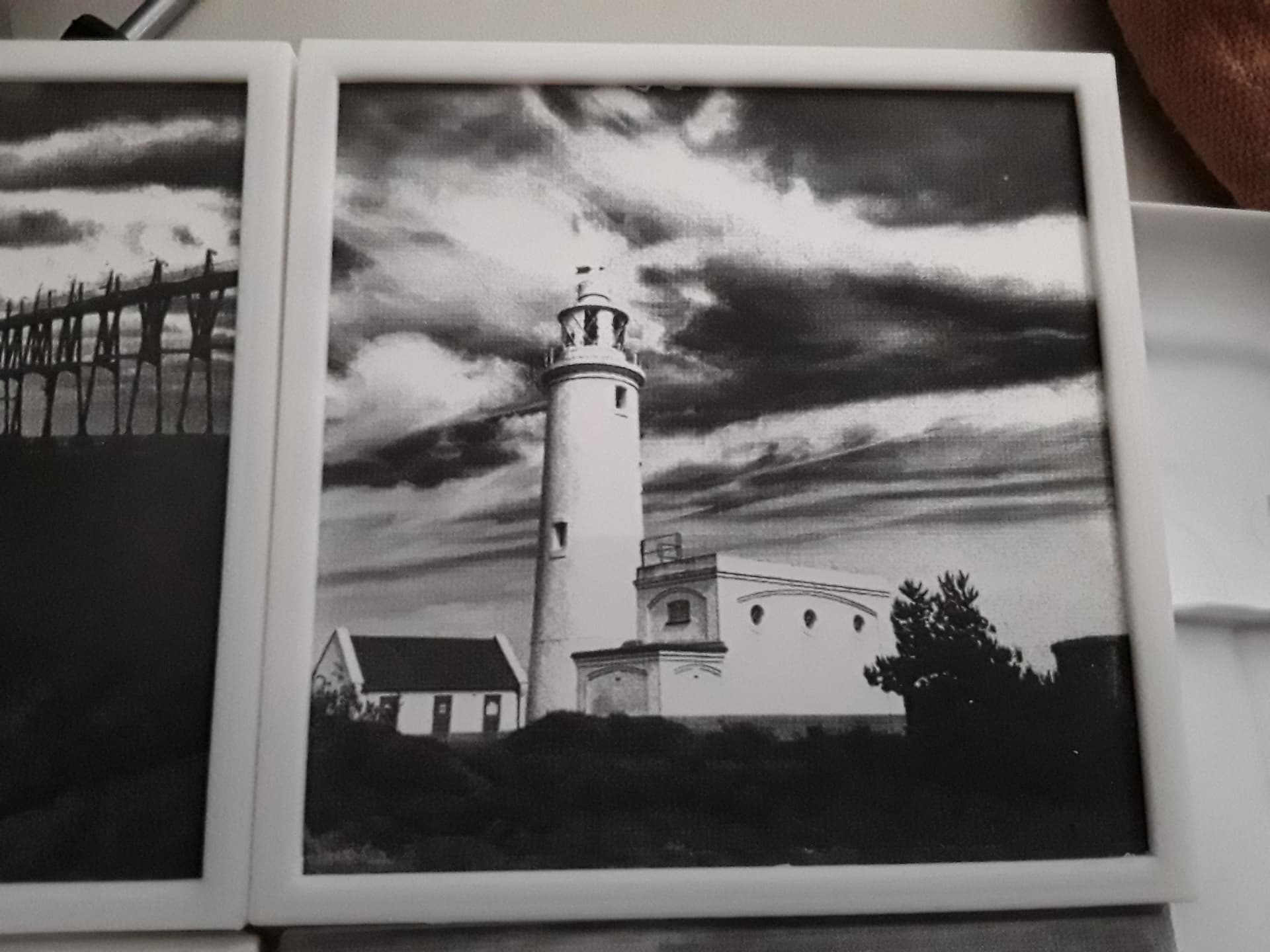

Nothing new really… friend is into lighthouses. Coasters? Stand-up photos?

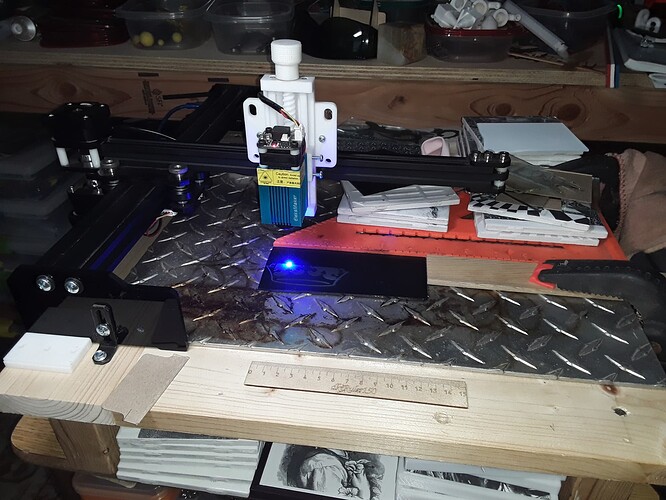

Samo-same Eleksmaker 2.3W laser setup and LightBurn… 1500 mm/min, 90% power, 338 dpi, and Jarvis dither. NWT method with Krylon Colormaxx flat-white paint and acetone for cleanup. Little personal fan gently blowing across the worksurface to keep smoke from fouling the lens.
Just piddin’ around, trying to stay cool in the triple-digit Texas heat… what else we gonna do?
Stay cool, y’all!
– David
