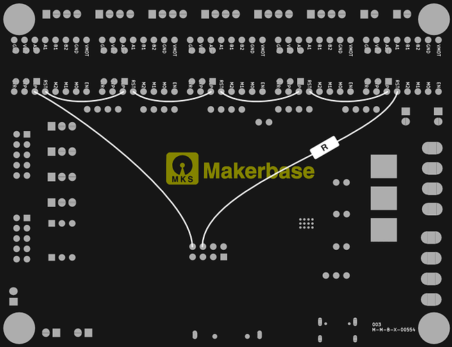

TinyBee is incapable of using UARTs on the TMC drivers without making jumper setups manually. If you’re comfortable soldering and modifying your board it can be done, but otherwise you have to run your TMC drivers in standalone mode.
Edit to add:
The modification needed is shown here:
There are also example configs, but those will need to be modified if you go through with getting UARTs working on your board. You’d also have to modify the examples for the Primo setup.
