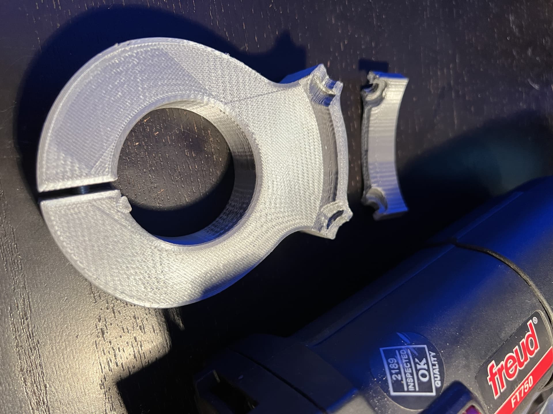

got out the pwncnc tramming device and a dial indicator…
WOW it was really out of true
proceeded to do something I knew would be stupid…but I did it anyway
I got a small hammer and "tapped on the router mount to try to adjust it.
OOPS! Plastic parts don’t like to be “tapped” with a hammer.
Well now I get to re-design the Freud Router mount to make it adjustable for tramming (without) “tapping” it with a hammer.

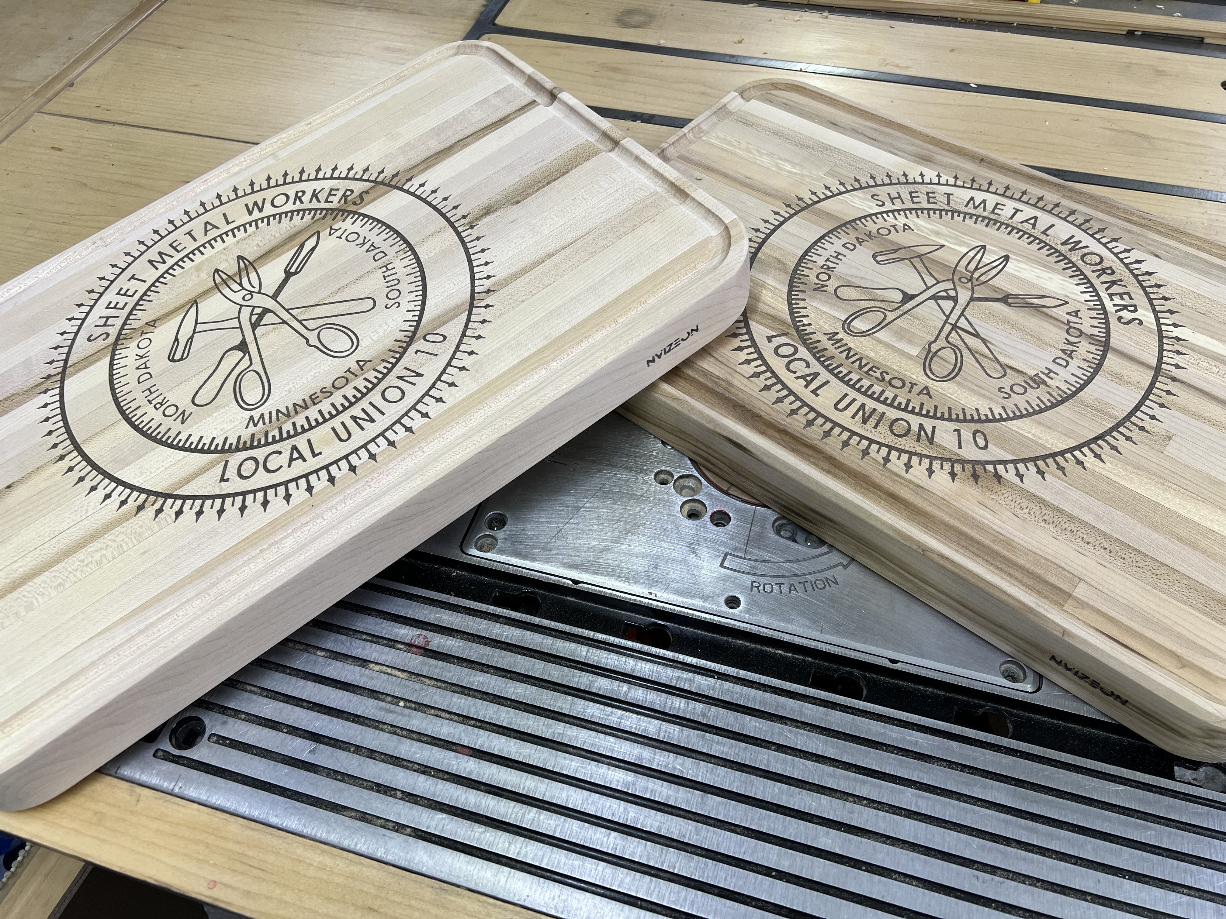

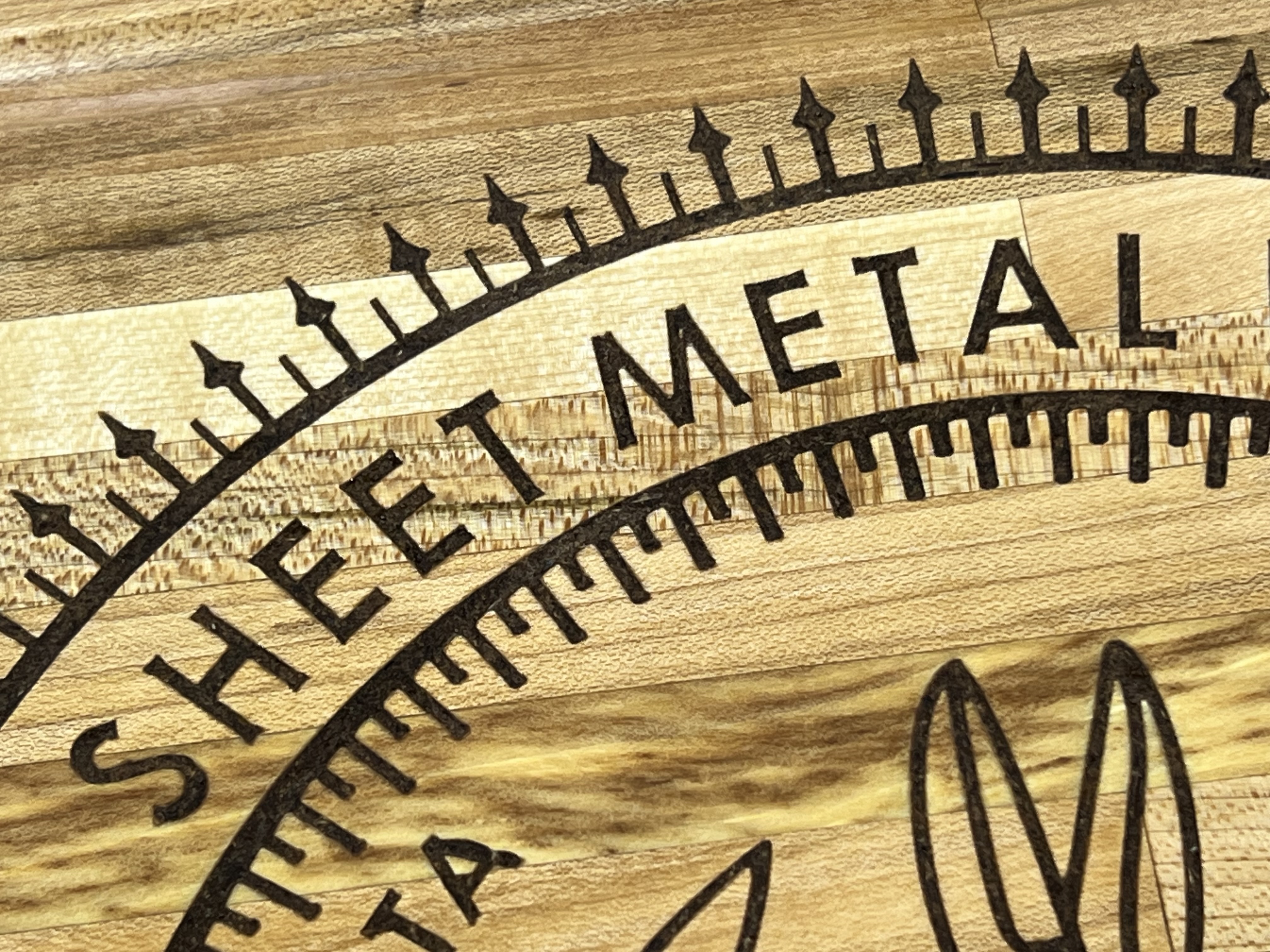

First product coming out of the robot!
Maple edge grain cutting boards with Suriname Ironwood inlay. Ironwood to symbolize the Sheet Metal Workers Union!
Wow, dude. Your first project looks better than my last ones after three years with the CNC. Those inlays are spot on, really. :exploding_head: :tada:

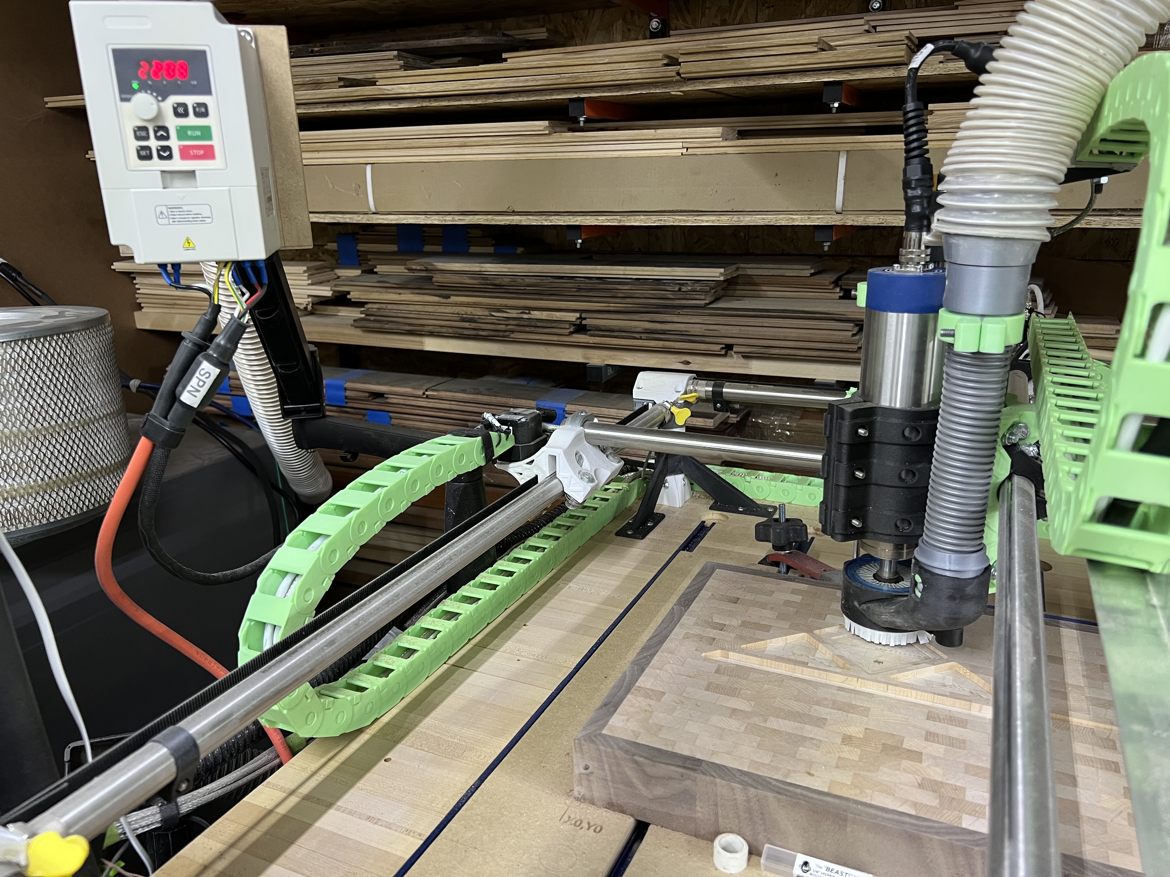

Well I bit a the bullet and upgraded to a 1.5kw air cooled spindle.
Also got my first customer order so it’s justified:
Customer_order

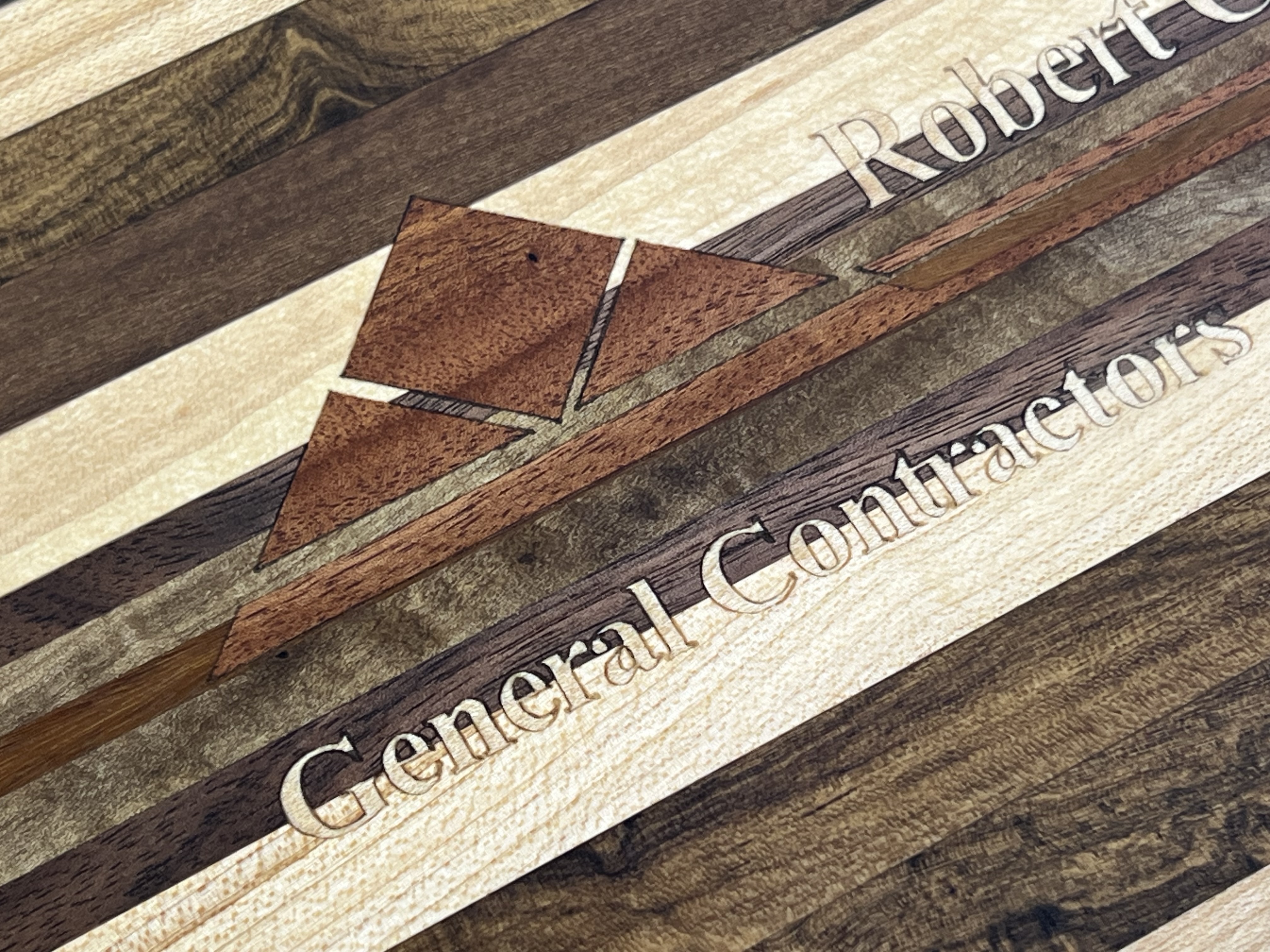

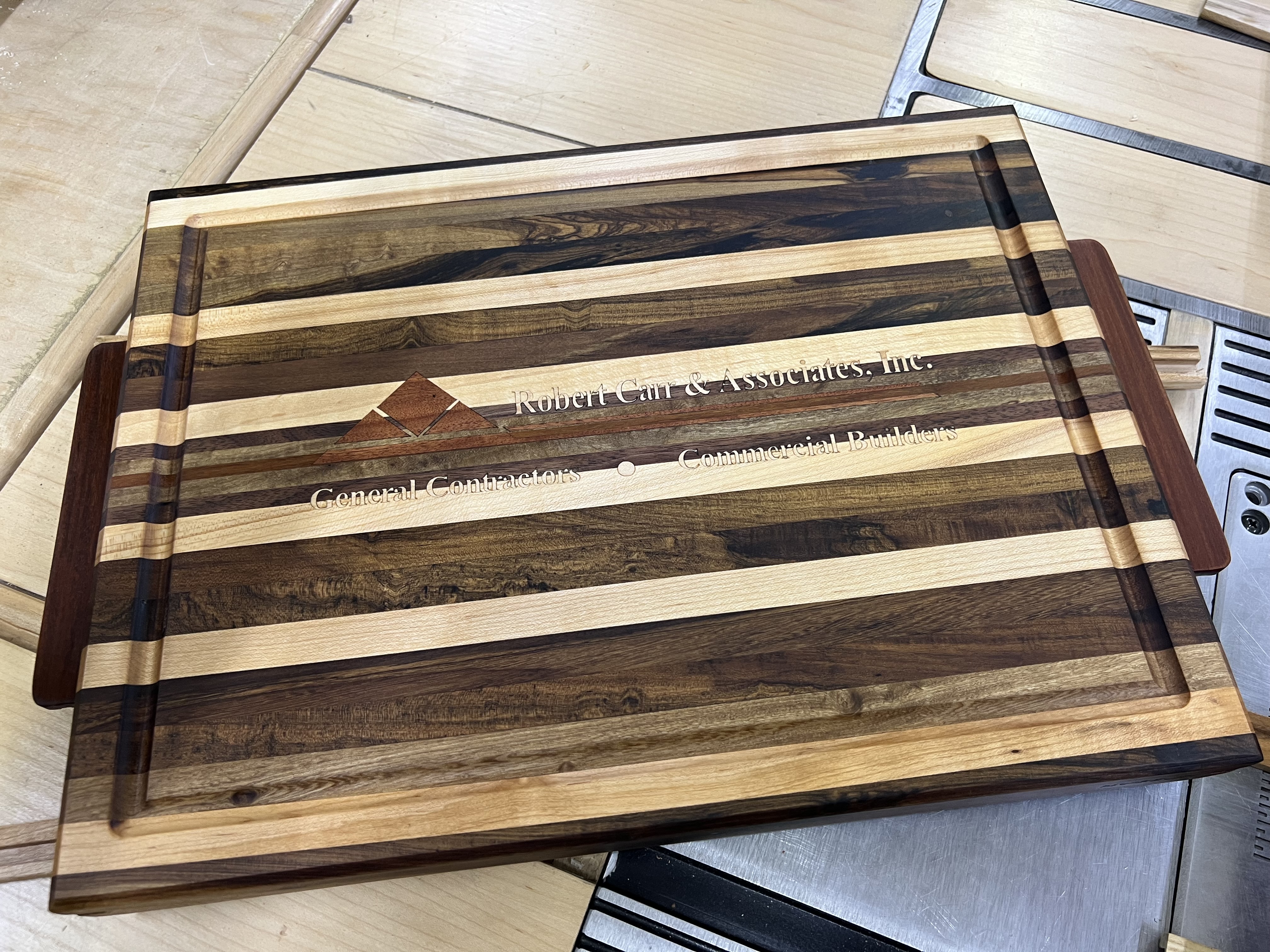

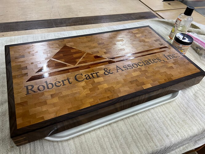

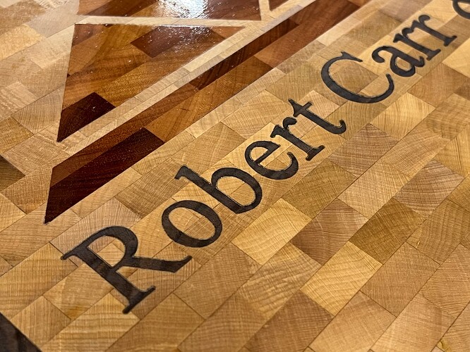

The first customer order is nearly finished. Here is the board with its first coat of mineral oil.
Old Growth Maple (Flooring from a 1920’s ish house)
Cumaru (Brazilian Teak) Logo
Walnut (Text and boarder)
Maple Miter Splines
That looks amazing! Inlay looks perfect.
