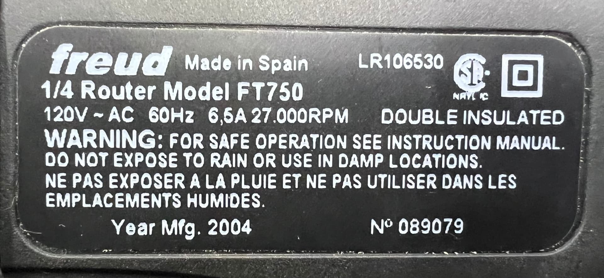

I trust your opinion here: I’m using a Powerstat l116c 0-140v 10 amp variable Autotransformer (variac) to control the RPM of the Frued FT750 Router (old non-variable speed with brushes 120v 60hz 6.5amp 27,000 rpm. Using a tachometer I determined the router RPM at given volts and made a dial for the variac to see that rather than the volts.
My question is do you have an opinion on this?
In general, all variable speed routers use some sort of voltage control or regulator to vary the speed (rpm) and this variac has got to be more robust than anything inside a new router. THe variac weighs about 20 pounds and most of that is the copper coils inside the thing.
I know I’ll lose torque at lower volts (rpms) but If I hear the router struggling I can just turn the dial and instantly increase the rpm’s.
Anyway, I’m not sure I’ve seen this on an MPCNC before so I was curious about your thoughts.
For the first two (real) cuts I ran the bit at 20,000 +/- rpm (2 flute compression bit) for the hardboard and at 15,000 rpm (single flute Amana plexiglass bit) and it was super nice to have a big (speed) dial to adjust on the fly rather than the tiny dials on a router.
My guess is that you used things you had on hand to build your machine which included the Frued router and the variac. If that’s working well for you, then that’s great and keep using it.
I’d never go out and buy that combo, I’d rather put the money into a really good trim router or a spindle/VFD. There’s plusses and minuses to either of those, but overall is a much cleaner setup and probably less expensive and easier to use once installed.
