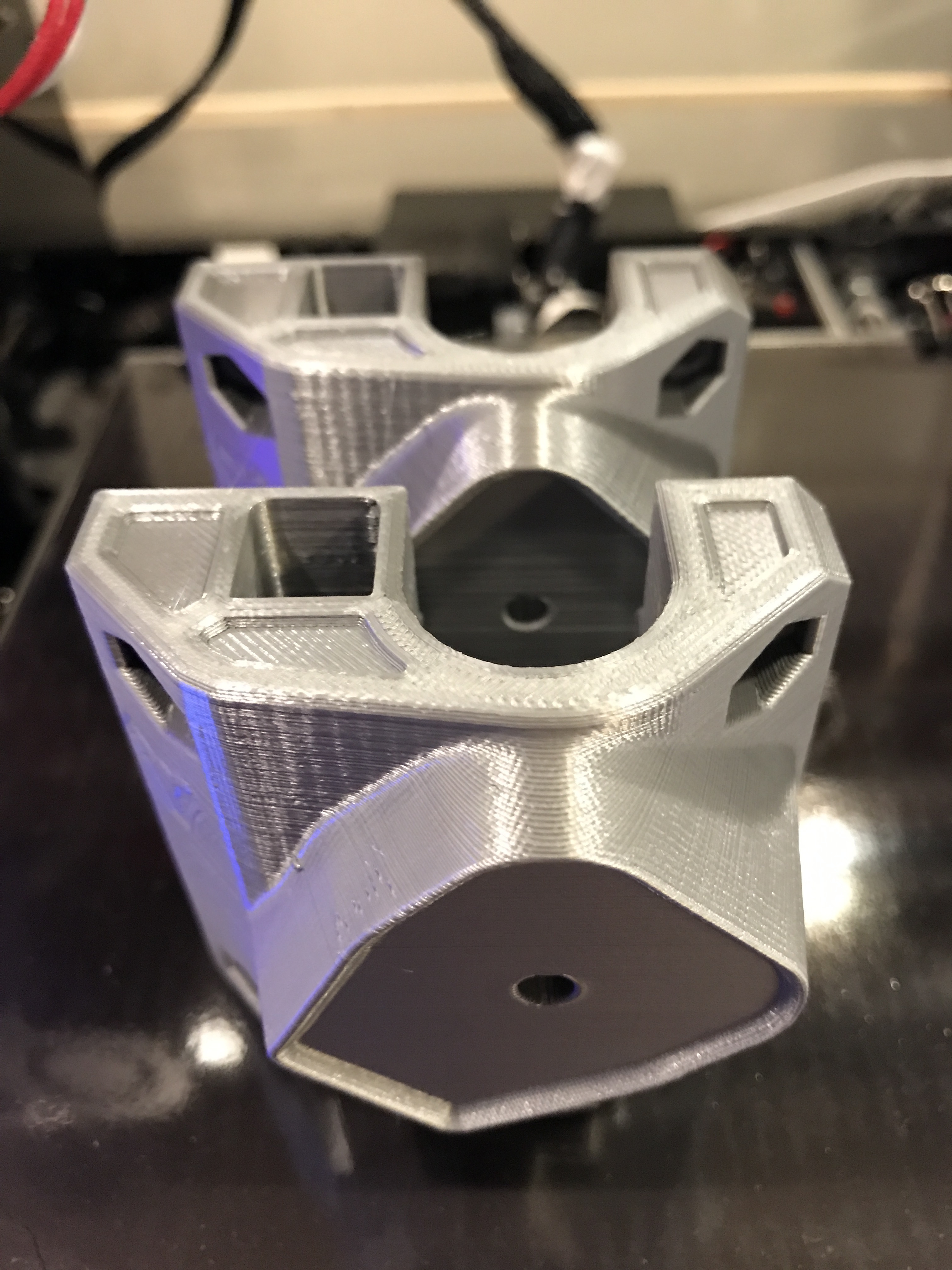

I seem to be going much slower than others…but slow and steady and eventually the Primo will be ready. All of the color A (White) parts are now printed. Now I can move on to the Color B Parts. I’ll be using a carbon fiber PLA for Color B.
The first Color B parts came out nice. Can’t wait to hit print on the core in the Carbon Fiber PLA. I’ve got a lot of work ahead of me but it gets cold here in Minnesota so I plan to spend a lot of time indoors playing with the Primo this winter.
Well, There has been a setback: The thermistor on the ANET had a loose wire that failed while printing the core, I thought it was just something to do with the height of the print. the Core came out (mostly OK) so I just adjusted the print temperature and tried printing some other parts. They failed miserably…so I replace all of the hot end parts and soldered the thermistor wire back together. Sadly though I no longer have enough Carbon Fiber PLA so I’ve had to switch color B to silver.
