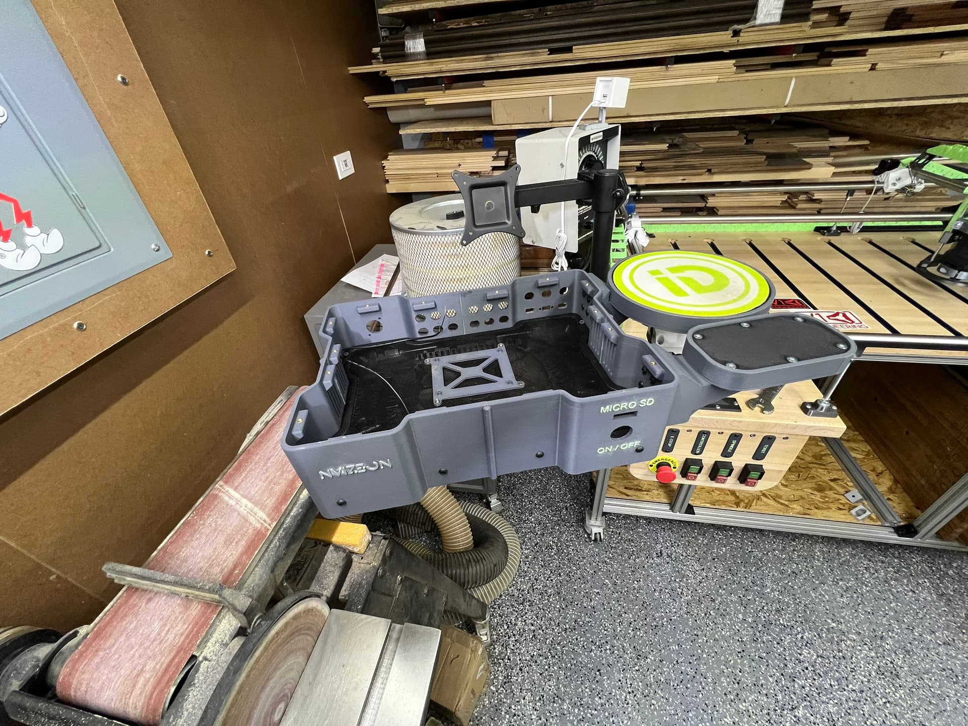

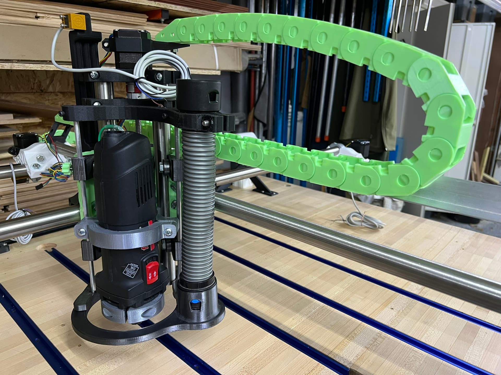

Here are some Build Progress Photos: 95% of the mechanical build is completed, now on to the wiring.

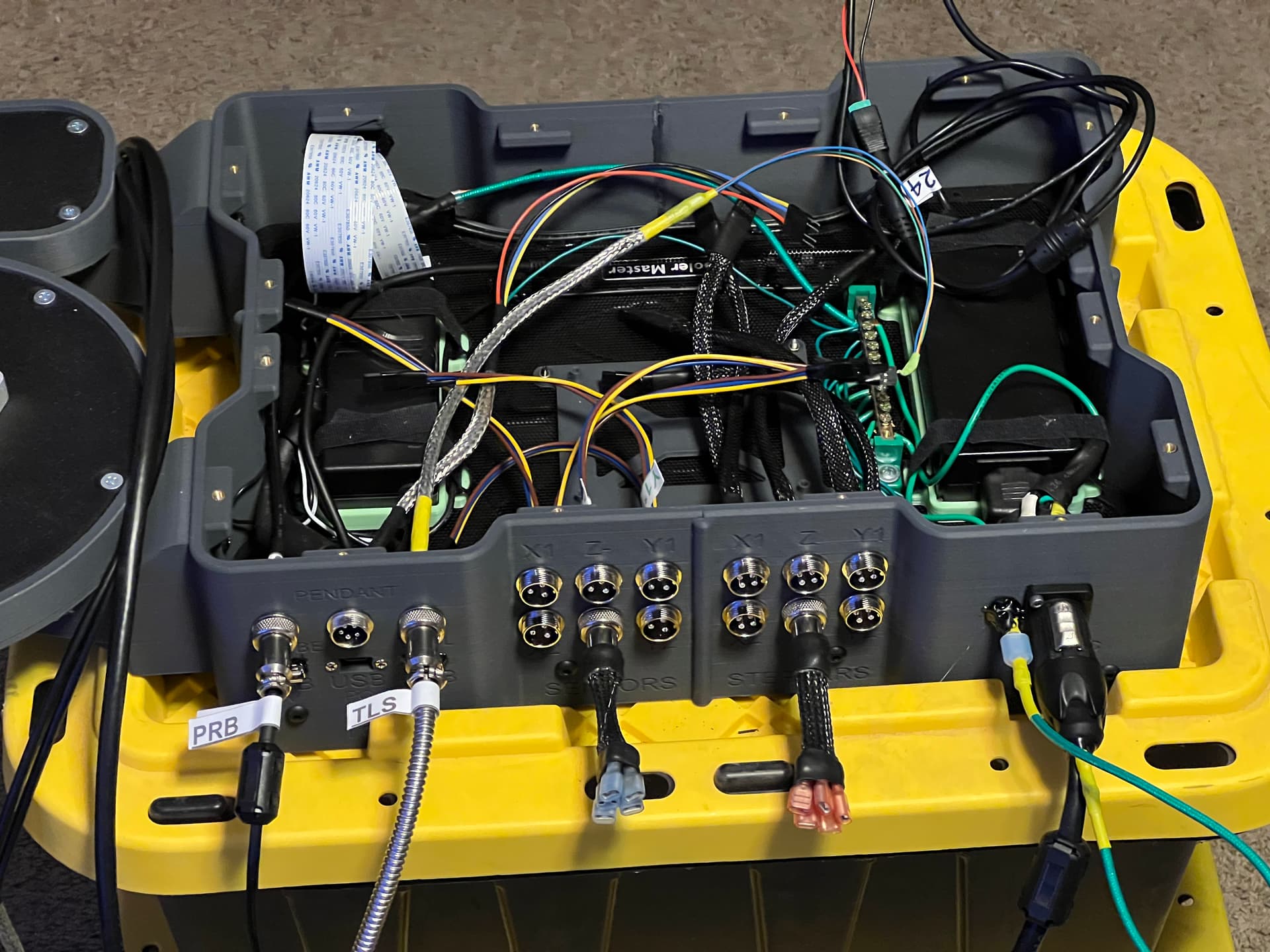

All the stepper motor wiring and proximity limit switch wiring are completed now.
the control panel is mostly wired now too. The next step is to install the Jackpot board, plug in all the connectors, and see if my wiring was correct …or not!

One time everything is working fine and I go about adjusting steps / mm to get the movement distances dialed in. Jogging works fine but then next time Jogging gets skewed and the gantry rails start to bind at the trucks X1 and X2 get way out of sync. same with y1 and y2 one side just seems to be moving at a different pace than the other causing racking.
I’ve upped the amps of the stepperrs thinking that with the larger machine the torque needs to be upped. then it works fine…then next time the racking comes back. Its very frustrating.

After the “racking” occurs and I turn off power you can see the gantry “self adjust” back to it’s relaxed position. So the steppers are moving at different rates or the trucks are so far out of wack that each mm of movement is amplifying the mis-alignment such that after 100 mm the trucks are binding and the steppers don’t have the power to overcome the binding and lose steps.
does anyone have some suggestions where to look for (construction) or mechanical issues?
Are the trucks too tight?
Do I need to re-check square of the x and y gantry rails ( I thought dual endstops) would accommodate a bit of mis-alignment!
I’ve double checked the squareness of x and y and the end stops are perfectly equal distance from the corner blocks on each side so before turning on the machine I manually (square) by using the x and y up against the end stops.
