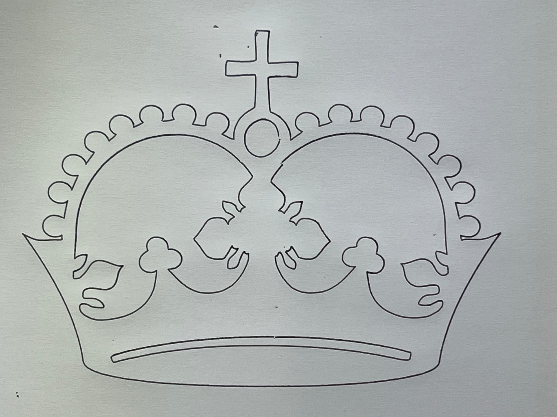

Well, Eventually when you take two steps forward and one step back you have taken enough steps forward to make progress:
Here is the results of the first squaring run, Jogged 1200 (x+),600 (y+),1200 (x-),600 (y-)
Then I went for it and made the Crown:

Today the racking issue is back and nothing I’ve done in the past has made it go away. It’s odd. First thing in the morning I fired it up and it was working.
I tested loading a file on the SD card and running the job from the pendant. again working fine
Then this afternoon while getting ready to test it out one more time before sending an actual job…bam… the racking issue is back again.
So I re-loaded the config.yaml file (has worked in the past), not today
I re-installed the firmware only (has worked in the past), not today
I completely reinstalled everything and reloaded V1 stock config.yaml file (nope)
I back loaded fluidnc 3.8.3 thinking the latest 3.9.1 has bugs (nope)
I switched the physical tmc 2209 driver in x1 slot with the one on the x2 slot (same behavior) IE: the x1 stepper is moving much farther and faster than the x2 stepper. causing racking.
I’m about ready to throw in the towel and install the skr pro 1.2 and switch to marlin.
At least that route could confirm if it’s a hardware or wiring issue and eliminate the software and controller if the same behavior happens on the skr…however if the skr pro works flawlessly and is consistent and reliable then the issue had to be in the jackpot and/or fluidnc etc.
—or— there is the sledge hammer method which won’t “fix” anything but would be satisfying for a few brief moments.
