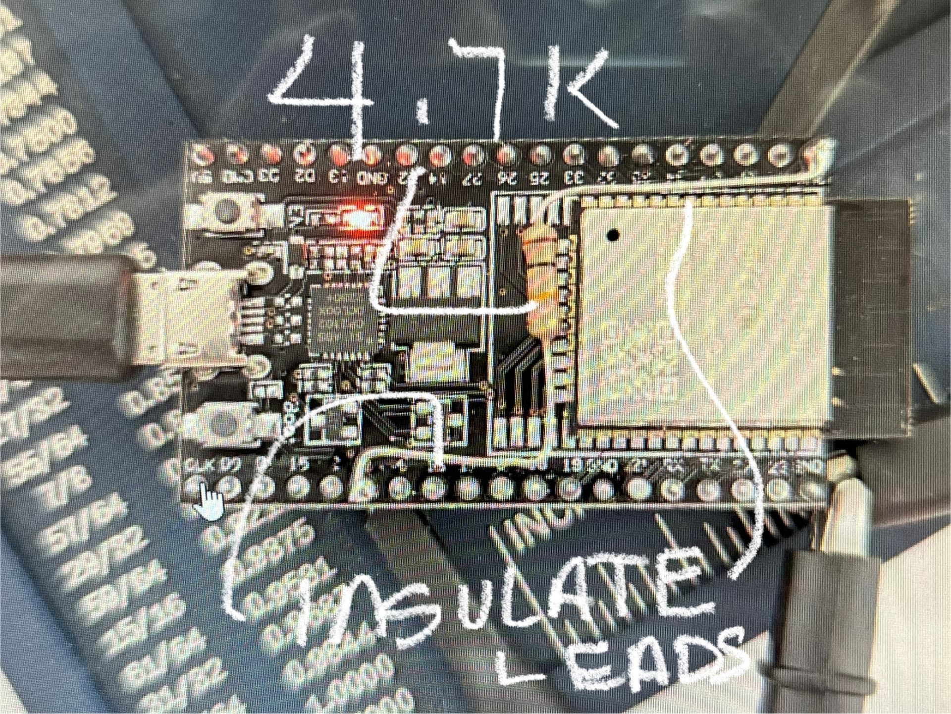

on some boot-ups the gpio 2 green light comes on and on others the gpio 2 light is off
What are the differences in $SS output between when GPIO 2 comes on and when it doesn’t?
Did you define something in your config.yaml for that MOSFET?
Pictures of your wired board would really help troubleshooting.
no i did not define anythin in config.yaml for gpio2
i plan to use gpio 16 for a tool length sensor but debugging this has prvented me from getting to testing the tool length sensor or changing the yaml file to add it at all

My recommendations for troubleshooting-
Cap/stow the wiring for your tool length sesnor and power up with that removed. Any change?
If that doesn’t fix things, we may need to add a pull-up resistor either to your ESP-32 or to the jakpot board itself.

You have an early jackpot.
From an earlier thread, you need to install a 4.7K pullup resistor as shown below (Insulate the leads, this is actually a scary picture!). Any value from 1K up to 4.7K will fix it.
The other thing I see in your build is you have wiring in close proximity to the ESP-32 WiFi antenna. That’s a no-no as well. Move all the wiring to stay well clear of the antenna. Imagine a 3" pvc pipe centered on that anteanna and going straight up and out of the enclosure. That’s your stay out zone for wiring.
I’d recommend adding the resistor to the Jackpot itself. Then you don’t have to worry about it if you later change the ESP32.
Also, if your current ESP32 is the same one that came with the Jackpot, you shouldn’t need it. I didn’t run into this issue until I changed my ESP32.
To answer a previous question disconnecting the Tool Length sensor wires from gpio 16 and vmot on the mosfet did not make the driver error go away
The 4.7 k resistor I get but are the leads you are wanting insulated the wires exiting both sides of the resitor as I have marked here?

Exactly right. I stripped the jacket off of some 22 AWG teflon jacketed wire when I did mine.

True, if one wants to disassemble everything then putting the resistor on the back side of the board is more like the later jackpots where the resistor is built in.
Pay careful attention to the pin layout if you do this.
