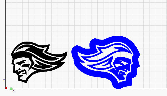

The visual communication is also not what I expected.
In lightburn if you set a profile as fill it turns solid - I expected the same visual reference in millmage for pocketing.
For other operations I’m also used to seeing the width of the toolpath reflect the tool used. So I can see immediately if it’s a 1/4 or a 1/8 bit by the width of the line.

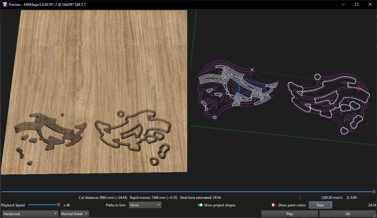

The preview keeps defaulting to the wood grain - even if you change it to something easier to see.
There was something else funky about selecting operations and layers but I’d need to check again.

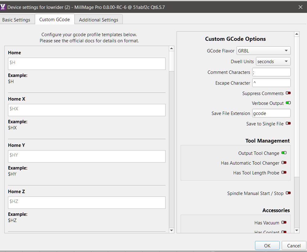

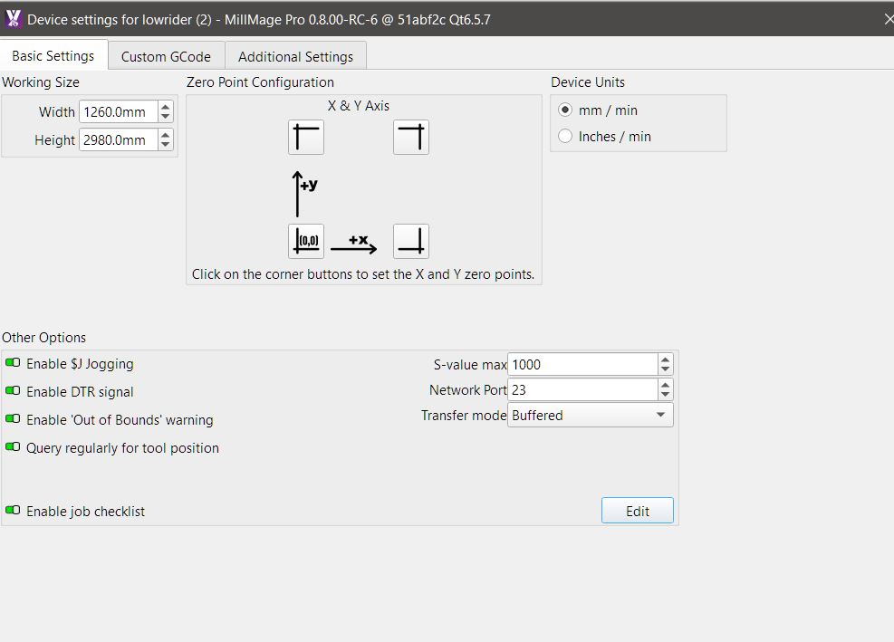

ive been using MM since RC3, here’s some of the things I’ve worked out
i find enable job checklist handy , you can edit it to what ever you want, it pops up, when you hit the start button saved my ass a few times.
in custom G codes
on report ;
$report/interval=200

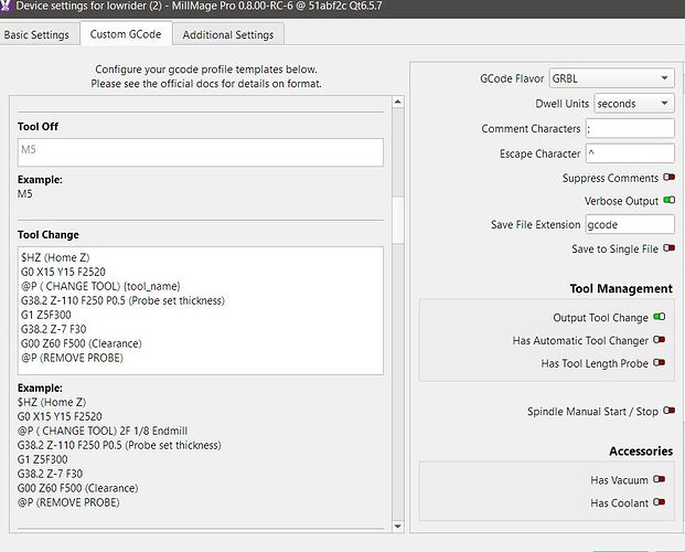

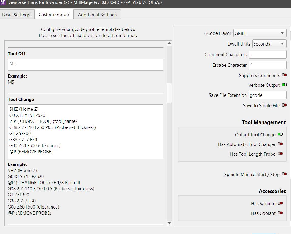

when tool change happens, pop up appears telling you which tool you have assigned to next path
(change tool) can be what ever you want ,
Remove probe - a pop up with continue or abort , not remove probe on screen.
User end script:
$HZ
G0 X600 Y300
or where ever you want it to position at end of job.
need the @ as it doesn’t understand the M0 pause command used for estlcam. Have tried few other custom codes ,they either fight each other and nothing works or it repeats its self mid job
eg i used operation end to start with instead of end script and every time it cut and object it would return to end script coordinates haha

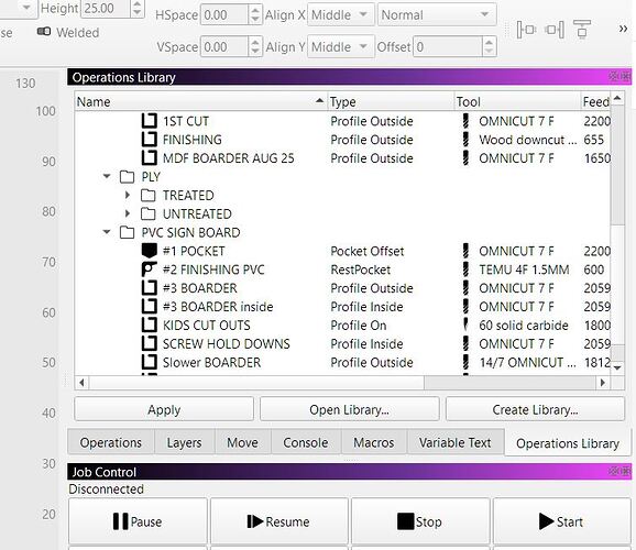

when creating new operations , if you use same material/tools regularly once operation created , right click operation and save to operation library, next time you to need run similar job go to operation library, choose your saved operation and hit apply , it saves a lot of time
the one thing which im not sure why, but if i hit stop during job Z axis dives into work piece , it never did this in fluid Nc web ui
if i hit pause Z holds position , than i can hit stop after and it holds position, have created topic in MM forum regarding this
i don’t use MM probe wizard ,always just click ignore and it reads the code set in custom Gcodes

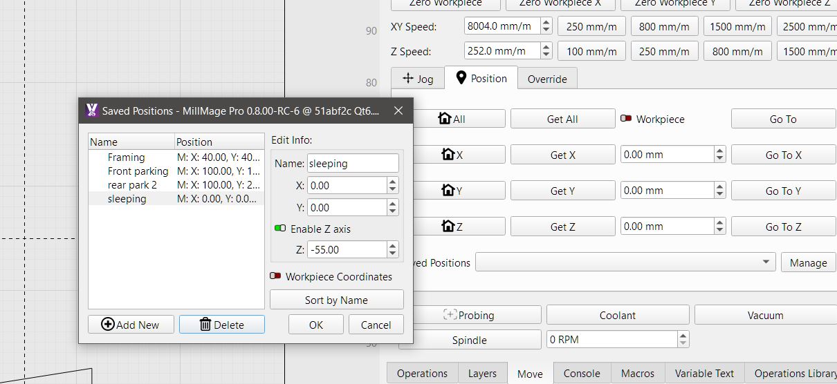

I find the saved positions really handy
once you set them up 2 clicks, and send it where you want
i have a 3m bed so takes ages if i click home or continuous jog, at the speed i have it travelling front parking is 100mm off end stops. i use my framing position all the time , don’t have manually lower z to bring it close to work piece to see where its going to frame . there is currently a bug re using center origin so don’t use that at present.
when using pocket operation it used to cut out line at your feed rate, they changed it for some reason outline now cuts at ramp or plunge feed :(, which is very daunting , they have had lots of comments about it and will be changing it back to your federate.
when setting rest pocket operation, make sure you check clearing tool diameter box, doesn’t always match what your pocket tool is and in preview areas are uncut.
i wondered that and asked the question a while back
if i remember, the reason being, the same layer colour can have various tool paths assigned to it where laser is only 1 and that’s why only visible in preview, took bit getting used to , im used to it now
The visual communication in lightburn is if everything is the same colour it’s got the same settings (fill/power/speed).
If you’re not doing the same in millmage then it makes the idea of layers irrelevant.
Estlcam visually communicates the difference between a slotting and pocketing toolpath very well you can see a pocket as ‘filled’ - and uses colours to delimit different toolpath depths.
No preview necessary.
