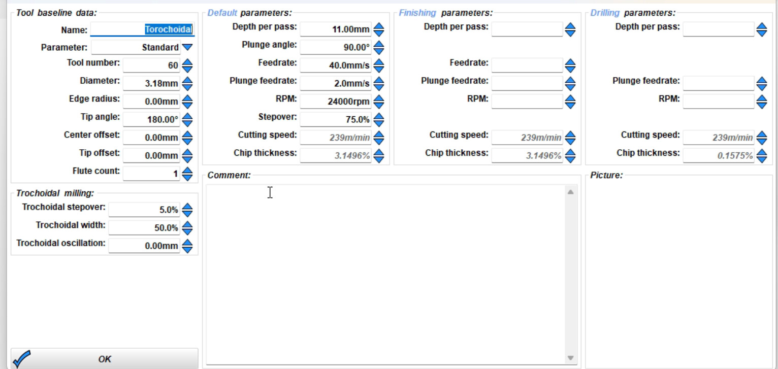

Hey guys, I have a lowrider v4 with a Makita 701 and a 1/8in single flute endmill. What estlcam settings would you recommend for milling a 6061 aluminum plate? Thanks in advance!
These are the settings I used on my LR3 to cut 10mm Aluminium
How thick, how big of a cut, etc.?
Thin aluminum (3mm or less) you could probably get away with non-trochoidal. I’ve cut 3/8" (9 mm) using trochoidal milling in a single pass, but it was pushing the limits (mostly due to poor chip evacuation). 1/4" (6mm) aluminum in a single pass worked very well with trochoidal milling.
You may want to consider an air/mist cooling system (using Isopropyl Alcohol aka IPA) to prevent chips welding to the router bit.
I used 1950 mm/min with 17500 rpm, or 2250 mm/min with 20000 rpm, both at full DOC using trochoidal and air mist cooling. Trochoidal settings were 8% trochoidal stopover, and 35% trochoidal width.
Others may have different recommended feeds and speeds, and YMMV, depending on your machine.
Its a 1.5mm thick sheet. Great idea to use coolant, would wd40 work?
1.5 mm should be relatively simple to cut, trochoidal probably not necessary. WD40 may gum things up, a spray bottle of 99% IPA (if you don’t want to go through the setup headaches of an air mist system) would probably be better. But at 1.5 mm, that may not be necessary either.
