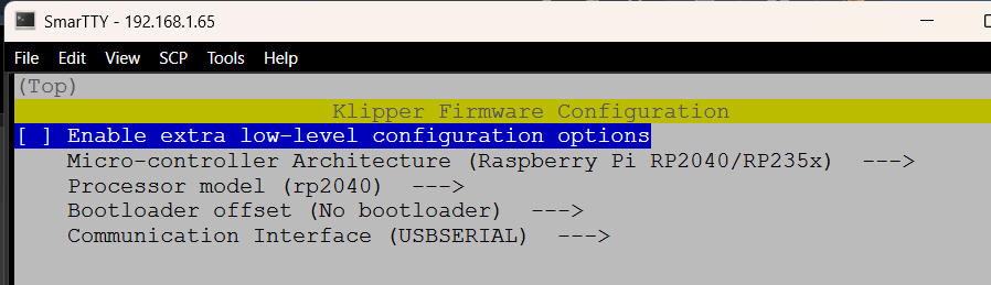

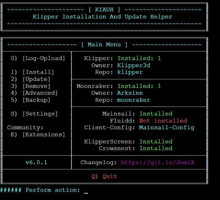

You can go into the klipper advanced tools and set the gpio pin you want low at start to be liw. I was using the tft tx pin. It will require a firmware rewrite, but if you use kiauh, it is pretty easy to do:
  1. option 4: Advanced
  2. option 1: Build
option N for new config if presented with the option
  1. enable extra low-level config
press space to enable and an extra menu item at the bottom will appear
step through each option and select stm32 processor F407
8 MHz, 28 kb bootloader, USB comm

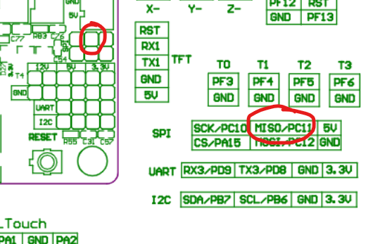

If your brake was attached to the SPI bus MISO pin shown here:
open the GPIO pins to set at micro-controller startup
In the extra field, enter ā€œ!PC11ā€ if you want it low
then build and flash like you did when you originally set it up… find the klipper.bin file and rename to firmware.bin and make sure it changes to firmware.cur
