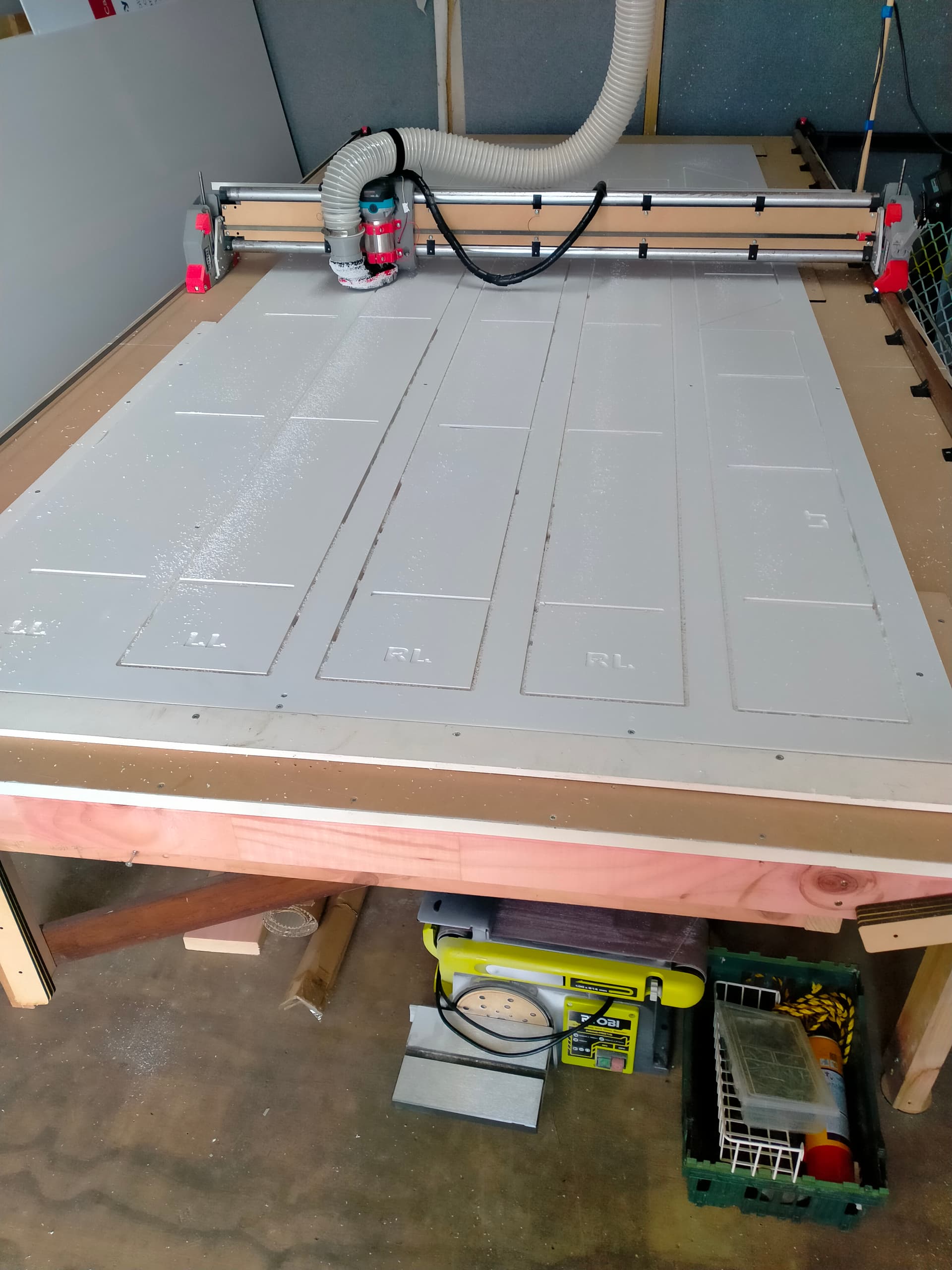

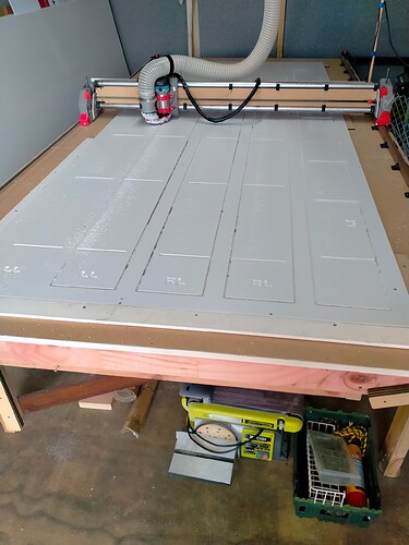

I build my lr4 end of last year complete newbie to cnc, my table has cut area of 1260 x 3000, added the extra length so i could surface any slabs also when needed,
I found building the lr4 fairly easy , even while dealing with major concussion issues , its been really well designed

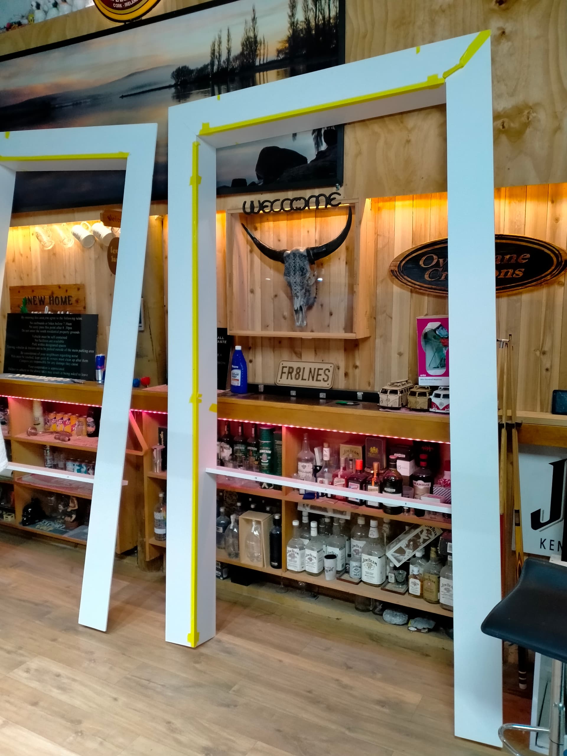

recently did a job cutting 3m sheets of 10mm pvc signboard in to strips 190mm wide for big door frames , they cut well within the 1mm tolerance at 3m , only cutting at 2800mm/min due to my crappy router
