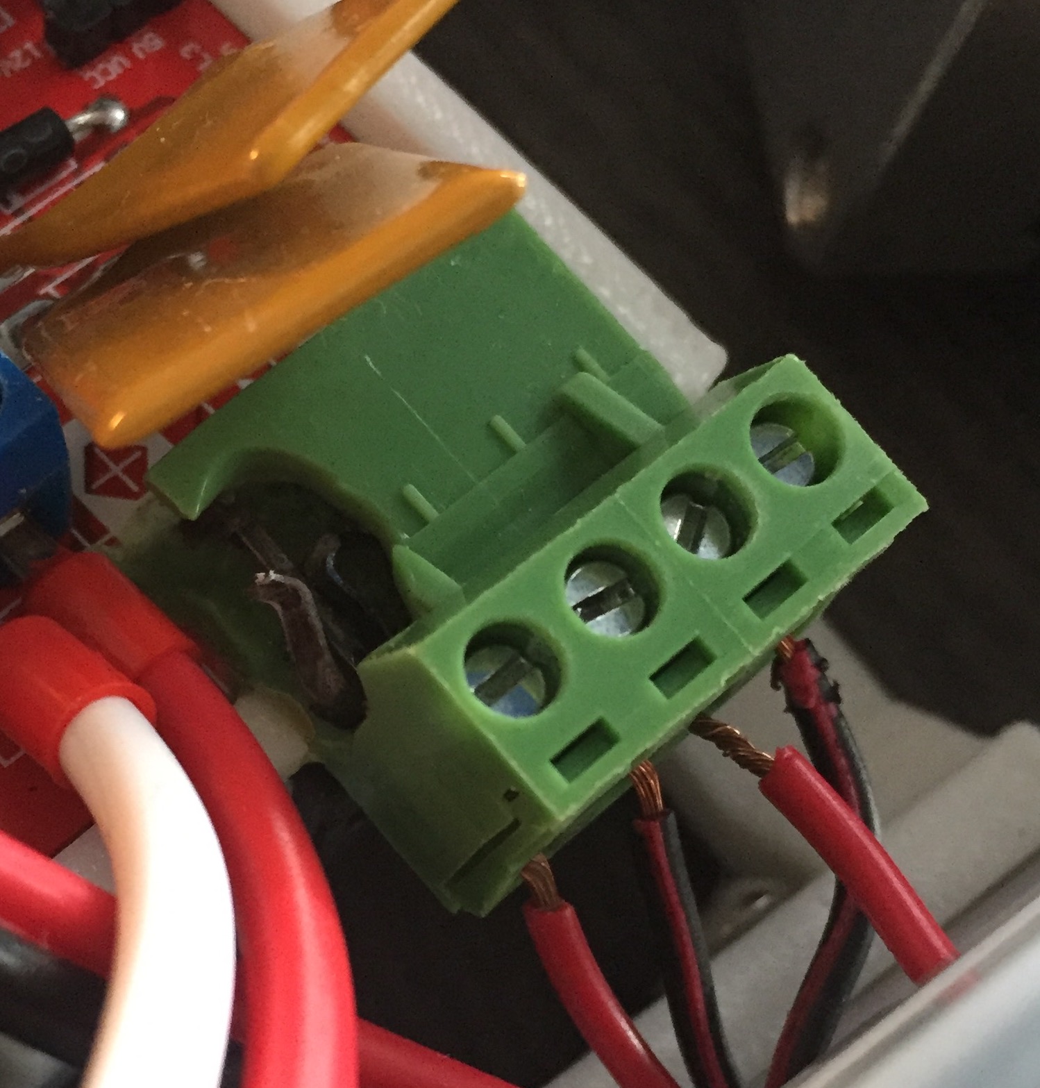

Got two of these, they seem to be within spec! 13.5A, 400V, 1.5mm2 wire.
Sorry forgot to answer that question. Those will do fine. On my board I just replace by similar connectors to those blue ones. The wire hole is not that big but any thing is better than those sliding green ones.
This is a similar example of what happened in my board.
Damn, weird they still use those connectors knowing theyre so bad…
