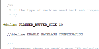

Trying with #define PLANNER_BUFFER_SIZE 30
Clean compine (the third time, as always)

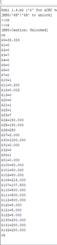

current settings

here is where i put it (starting to think i just added a comment but what it refers to isnt in uCNC yet hahah and thats what you mean by will modify it)

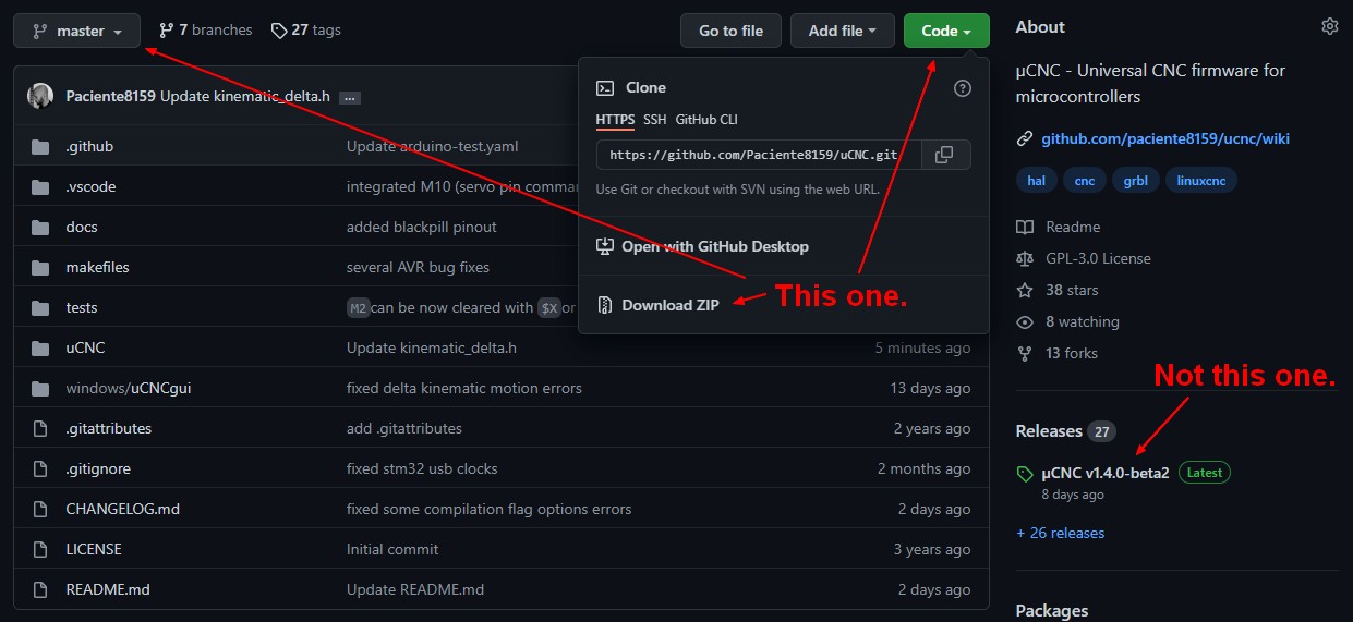

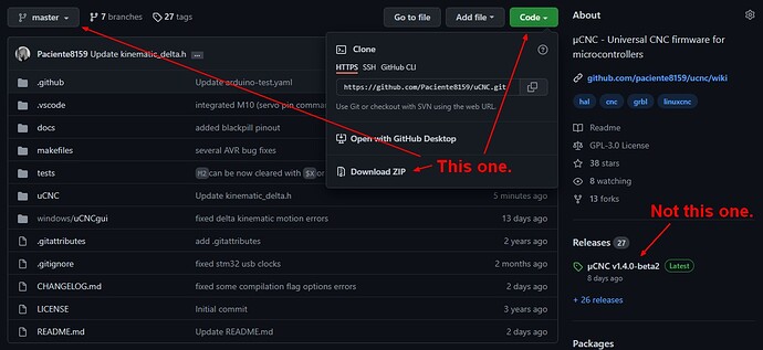

Now you can use the master branch (not beta2). The master as in it’s current state:
Or use the bastardazzo branch.
I’ve applied a couple of patches to this one including the one I mentioned above.

If you use the master branch the #define PLANNER_BUFFER_SIZE 30 is no longer needed.
If you use the bastardazzo branch keep it there anywhere inside the cnc_config file. You can increase it to 40. It won’t do harm and you have enough RAM.

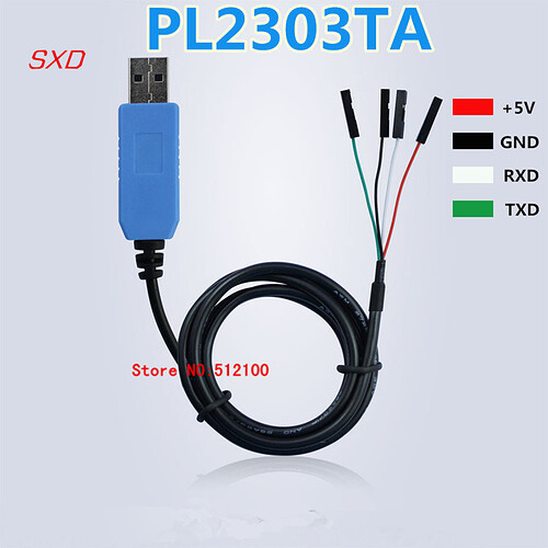

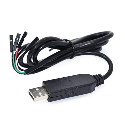

About the cable, this one would work right? The price is outrageous in comparison to what you sent but this way ill be able to work on it over the weekend!
Yup that will do the trick. But it doesn’t have to be that cable. ANY USB to RS232 converter will do (if you have one laying around give it a go). A CH340 chip or any other dedicated chip will do the trick. For example my Arduino UNO clone comes with a CH340 and it works just fine.
Wait, cant figure out if there is some chip inside that usb housing or if the RS232 only refers to the endings being duponts instead of a USB B for example, cause if there is no chip/extra component in there and its just a open ended serial cable i can make it myself. If not ill have to buy one as I dont have any
It’s there:
  • A genuine PL2303TA chip module is housed in USB 2.0 type A male terminal for wider compatibility and supports reliable data transfer rates

This one would work correct? Chip seems to be the same etc
Yes I believe it will. The difference in that one (HX) is that the chip has been discontinued and the TA is the new one but they are the same. Has I said I think any dedicated USB-Rs232 chip Will do the trick.

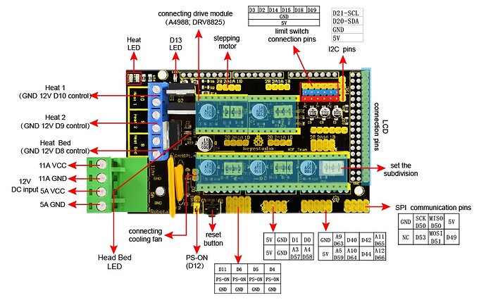

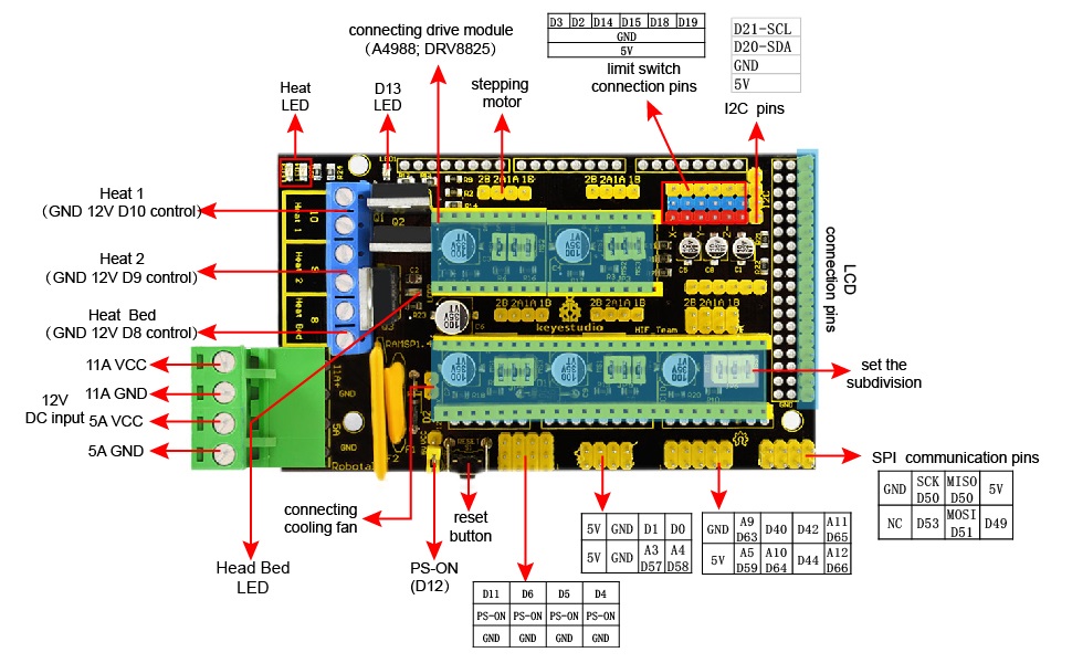

Im trying to find how to exactly wire the PL2023 cable on the boards but im a bit confused, cant find colour coded pinouts.
Also cant tell if I have adapter resistors in series for certain. Ive located the pins , but on the Mega I cant access them, a but confused.
