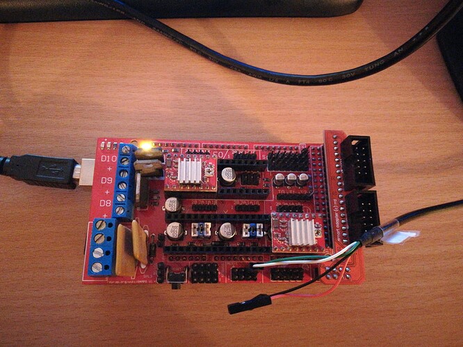

Do this. Your USB-RS232 cable (I’m guessing) has 4 wires (red-black-green-white???)
Usually black is ground and red is 5V. If you have a multimeter you can confirm this. Of course the cable manufacturer might have chosen a different wire scheme but that would be misleading.
Your left with white and green.
Plug any of them to AUX 1 Pin D0 on your RAMPS14 (it will be configured has an input). Send a G0Z1. If the printer moves that is your cable TX. If not try the other one and resend the Gcode. If it moves you found it. plug the other wire on D1.
By the way if you connect both USB cables (the one on the mega and the USB-RS232) to your PC you can leave the USB-RS232 GND and 5V pins disconnected that it will work just the same since the board is connected to the same GND ref via the Mega USB cable.

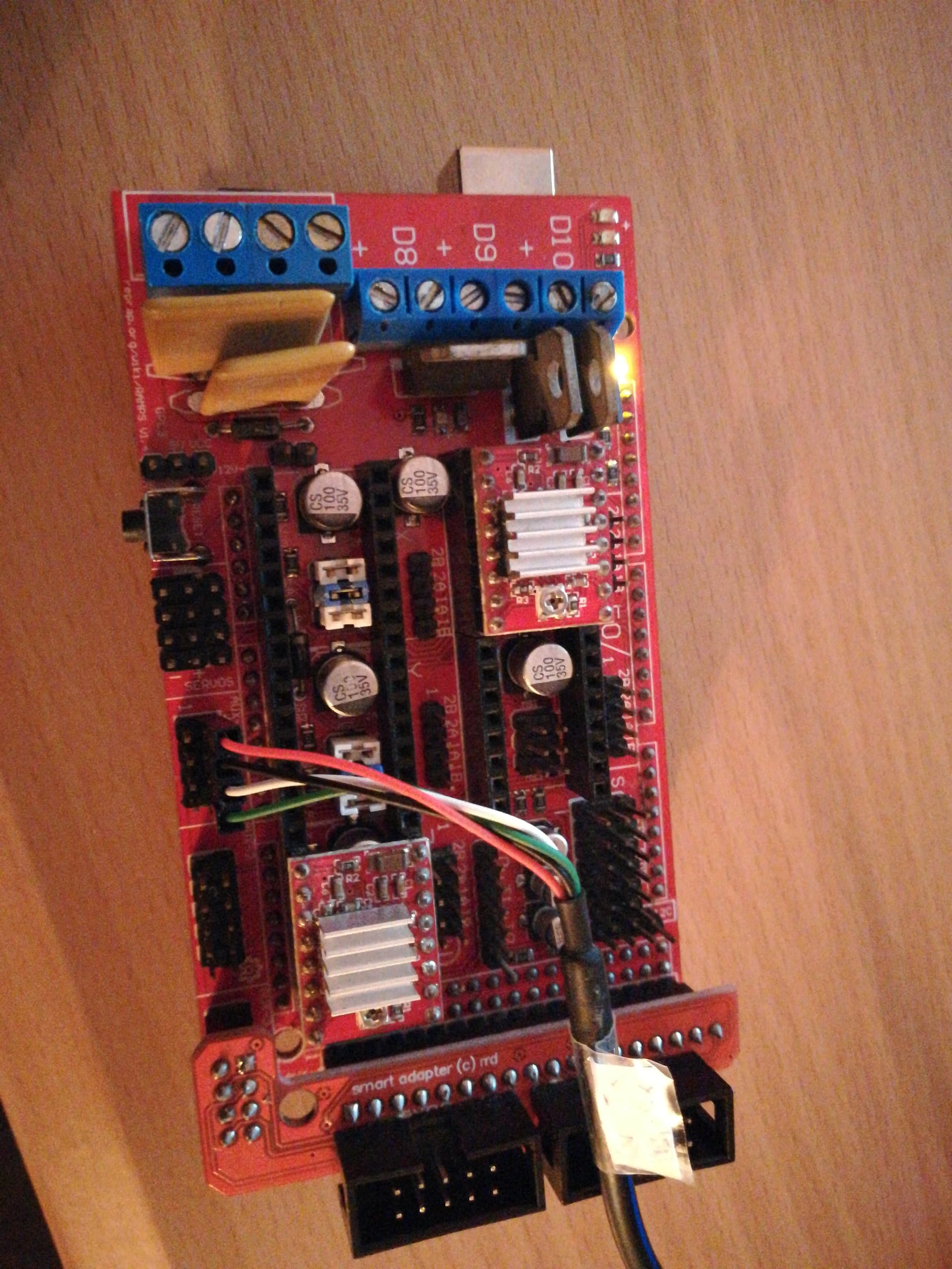

Here is a picture of mine
In my case:
USB-RS232 green is the cable TX → connected to RAMPS RX Pin D0
USB-RS232 green is the cable RX → connected to RAMPS TX Pin D1
Or in alternative using only the USB-Rs232 cable like this.

I tried connection all 4 of the RS232 cables but apparently im missing drivers for it.
Tried the single pin check on D0 but both green and white excecuted movements i sent. :thinking:

The printer accepted moves because you probably sent the commands via the main usb port of the Mega (my guess). You should select the new available Com port when you connect the new usb converter on the open Pilot settings.

Yeah the thing is when I go into Device manager, and check the port it says im missing drivers, by itself it wont find anything, is this what im looking for maybe?
Exactly. If the driver is not recognized it won’t be listed. I’m doing the last touches on the code for the final release version 1.4.

Actually for the PL2303HX to work you have to install an older driver like explained in this video
Here is the link for it
I tested on a PL2303HX I have and worked. Plug it to RAMPS and it was running OpenCNCPilot fine with a poll of 100ms.
My other cable actually has a CH340 that comes with the Arduino clones.
EDIT Summited patch 162 with the new kinematics boundaries check. To enable it soft limits must be enabled. As explained for the Delta it will check motion within a cylindrical work volume. All other kinematics were also improved with this concept of workable volume.
Plugin installed and the cable works!
