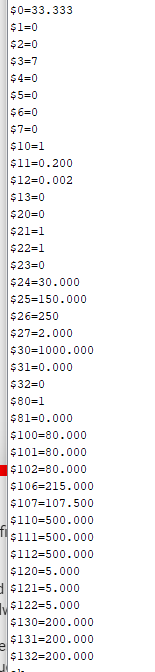

soft reset, made sure on the $$ that the value was the one i tested each time
dont remember but ill find out
The forum i asked for the $106 and $107 told me to measure each arm because the printers from Flsun are relatively low quality and there might be some discrepancy between them. someone else suggested that on Marlin this doesnt matter, told them its not my case but they mentioned G33, delta calibration, which is what i was talking about earlier saying how it homes and then calibrates the bed and knows where it is in space. Well aparently this also fine tunes the values $106 and $107 based on the machine itself. Dont know if this can be implemented in Gbrl but it seemed interesting as an idea

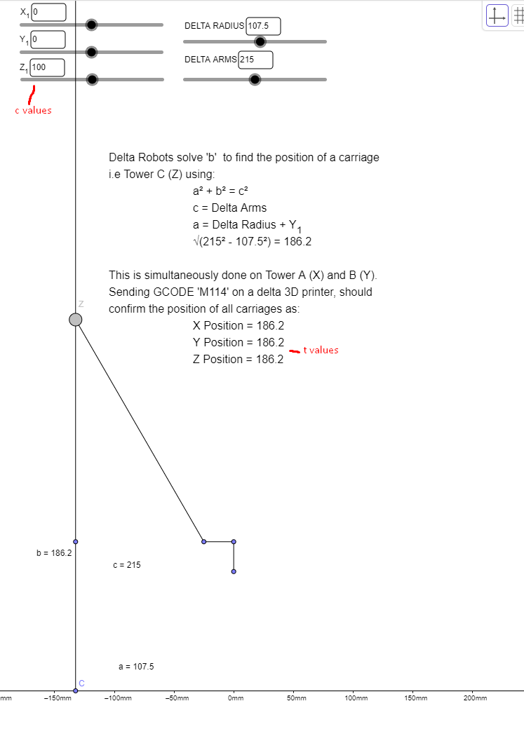

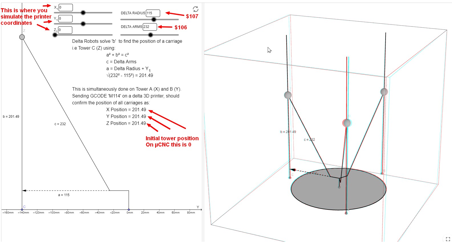

EDIT: I think I’ve fixed the geogebra simulator. I barely know how to operate the geogebra app but I’ve manage to fix the error. Here is the link. I’ll recheck my previous results now.
EDIT2: This will be a bit long but I’ll try to keep it short.
The results seem to be correct. You can test it your self.
Just to make sure the towers are moving the expected distance please run this test.
  • Insert the same values for $106 and $107 on the simulator and on your printer.
  • On the simulator take note of the towers initial position (they match for all 3 towers) - lets call this Hini.
  • On your printer do a home motion then send the efector down to gain some headroom. Mark the position of all 3 motors (they should all be at the same height).
  • Do a G0X40 on the printer. Now measure the traveled distance by each motor (positive if above starting point and negative if below).
  • Do the same in the simulator. Again calculate the traveled distance for each axis by subtracting Hini from the current position that was calculated by the sim.
See If they match. This will at least tell you if any step skipping is happening. If not my guess is that parameters $106 and $107 are incorrect.

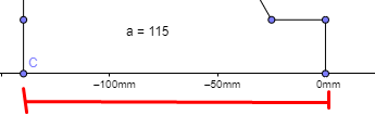

Check the previous post. $106 is the longer radius subtracted by the smaller.
It’s distance a in the simulator

1- input the same 106 and 107 values on the printer and the sim: ok
2- Hini marked at 186.2 for each tower
3- moved the printer down with G0Z100 and positioned the sim at +100, the sim measures from the bottom where as the printer from the top atm. this might look weird in the calculations, not sure, ill see.
Xc Yc Zc - “cartesian coordinates” of the nozzle - what we input in Grbl
Xt Yt Zt - “towers coordinates” where the motors (more like the carriage of each tower) find themselves
this would be Xt Yt Zt, which if i move the effector down with a G0Z100 i know they are all 100mm.
i thought id have to measure with a ruler but “??” bring up an Ov:100,100,100 which seems to be the t position of each tower - i can measure both i guess, although it probably not necessary
the sim does not change the position of the tX tY tZ values regardless of where Zc is if Xc and Yc are 0.
i guess i can still measure the difference but should the Zc be the same as Zt? and not 100 vs 186.2

4- G0X40 sent through - seems like the effector lifted off the plane, anyways values are measured by hand because i cant bring up the Ov values with the ?? as i mentioned before
on the printer the values are: Xt: 115 (down by 15) Yt:74 (up by 26) Zt:96 (up by 4) - measured by hand
on the sim the values are: Xt:201.29 (up by 15.09) Yt: 160.07 (down by 26.13) Zt: 181.85 (down by 4.35)

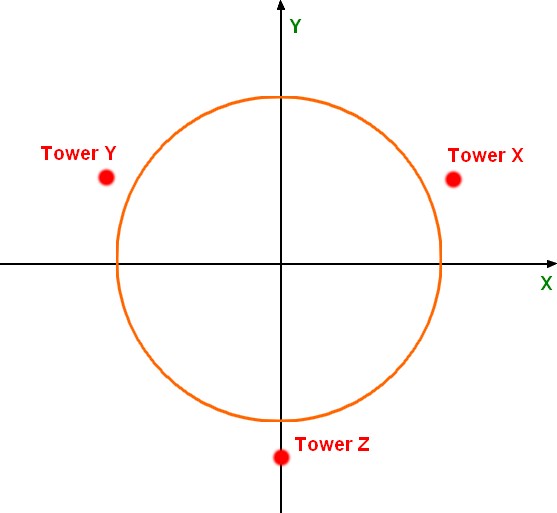

the numbers are reverse either because there is a difference of the effector direction between printer and sim, G0X40 on my printer send the carriage in the inverse direction of the G0X40 in the sim.
btw i believe the current rotation of the overall steppers is almost inline with the stock configuration, X+ and X- face the correct way, but Y+ and Y- are opposed

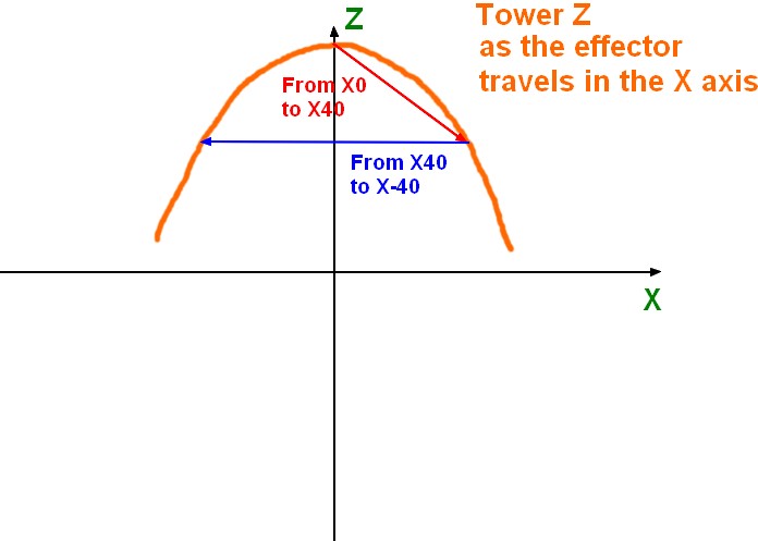

btw when going from G0X40 to G0X-40 the effector moves down and then up again - curved bottom as we said

in both cases printer Xt and sim Yt as well as printer Yt and sim Xt are inverted, its the Zt values that are in the wong direction.
If I input a G0X40 on the printer and a G0X-40 on the sim the Xt’s and Yt’s match, and in the inverted scenario too
I didnt catch this at first (bc the printer and sim values are inverted and it was confusing me but:
I saw it from the sim the Zt (compared to the ground surface) went down in both G0X40 and G0X-40, where as on my printer the Zt (compared to the ground surface) it went up (compared to the ground surface) this meant that there is about 4+4mm difference on the Z axis and I believe that mispositioning my effector -

changed the masks, they were 0 for both $3 aand $23, now theyre both 7.
saved to eeprom, restarted it, unlocked and homed. all motors go up towards the switches, homes nicely. I tried a G0Z-10 and the X axis moved up and hit the end stop…weird
i close the serial monitor, reopen it, unlock and home, G0Y-10 and again same thing, X axis goes up, hits the switch…
Tried it again with a G0X-10 and again X axis up and hit the switch. Tried other values, positive, negative, different axis, only X went up.

is that when i had the effector about half way down, I did some G0X0 to G0X40 to G0X-40 movements.
G0X0 to G0X40 lifts off of the plane about 2mm, much less than the 8mm we saw before. G0X40 to G0X-40 ends up at the same height which is good, but during the travel the effector, as is travelling past the G0X0 position, drops below the G0X0 for about 4mm, so about 6mm down and then up again… and if i go from G0X-40 to G0X0 again its only a 2mm drop
this also happens with G0Y movements

What are the values of $106 and $107 you’re using now?
$2 is to invert the logic on the step pulse pins because some drivers step the motor on high-to-low transition and others the other way around and the dir pin may not be updated correctly. I believe in the case of Grbl and µCNC this is irrelevant for most drivers (don’t know of any particular case). Most cases keep this at 0.
If you want to invert the dir of a stepper always use $3. Each motor is a bit of this number.
Bit 0 is related to STEPPER0 that in your case is related to AXIS X and so on.
Translating into simple terms it’s a bit mask like in this table
|BIT  |       7      |      6       |5|4|3|2|1|0|
|AXIS |Z2 or Y2 or X2|Z2 or Y2 or X2|C|B|A|Z|Y|X|
To invert X, Y and Z you set bits 0, 1 and 2 to 1. That yelds the binary mask 00000111 that is equivalent to 7 (like the config I told you to use)
|BIT VALUE|       0      |      0       |0|0|0|1|1|1|
If you want to revert back only the X axis set bit0 to 0 again (00000110=6)
This works this way for all the other settings that use a bit mask (like limit switches, homing direction and even invert step pulse)

Steps 1-7 completed, only different is the $3=7 mask is the correct one in this case
Everything moved fine, no issues, no crashing and $24=30 and $25=150 seem to work well for these tests, ill check for repeatability and fine tuning later!
Unfortunately i get the same issue as before where after setting $3=7 and home the machine, any movement after that will result in only the X axis moving up and hitting the switch.
So if I set the $3=0 which doesnt result in the X axis bug, i also have to set $23=0.
at $3=0 and $23=0 the homing works fine, X- and X+ are in the correct direction based on stock config, Y axis is flipped.

Tried with $106=245 and $107=106 and the same happened.

If you look to your printer from above you will have something like this:
Your tower Z is inline with the Y axis so lets take that one has an example. If we rotate that view 90º and stare directly to the Z tower we will see this:
The orange line is the relative height of the Z tower to the effector as the effector travels parallel to the X axis. The tower will be at the highest point when X is 0 and than the curve describe a non rectilinear movement (I have not made the math but I believe the curve described is either a sin or a x^2 kind of curve).
Currently when you start from X0 and do a G0X40 the firmware makes a linear motion from X0 to X40 (red line) as you can see that represents a distortion in the ideal travel curve. It will make to it’s destination but in a straight line (this will result in a non rectilinear motion of the effector).
Worst when you do a G0X-40 from X40 the calculated height for the Z tower is the same. So the Z tower will stand still, when in reality it should go up and then down with a non linear speed.
This will cause the effector to move in a non rectilinear way although we ordered it to travel in a straight line.
One way It comes to my mind to fix this is by treating linear motions in the delta the same way it is done with arc commands…breaking down into shorter line segments. The penalty of this is that more calculation loops have to be done and this will impact on the speed of the printer.

I’ve done the exercise of converting the coordinates from 3D points to Z tower height several times and they do seem to match. But sometimes the calculated steps go completely wild. After moving the machine a bit G0X0Y0Z0 should match stepper position (0,0,0) and it doesn’t. I’m trying to track down that problem in particular. And I’ll let you know on that. I think this is related to the calculation of the forward kinematic that is figuring the incorrect position back (I’m getting these results in the negative coordinate regions)
There may be a 3th problem that is the parameters are not correct and are causing also distortions (curves in the motion). But first I have to rule the other 2 first.
I have the felling I’m trying to re-invent the wheel here but all the papers I found only explained the kinematic computations and I don’t recall ever reading a part about these motion details.
