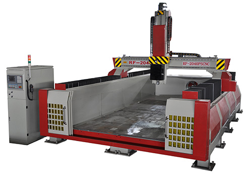

This is one of those “with enough money” things. But you would be happier with buying a machine with the range you need. To modify the LR would require not just the machine, but the control board, the control software, the design software…
If you’re just thinking a gantry with a longer z, you can go more or less as deep as you want, but you will want to build a different machine. It will be much less frustrating, there’s a bunch of designs out there.

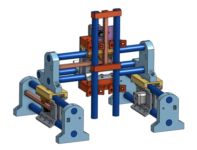

Wouldn’t David’s MPR&P work for milling eps foam? Is 96" too long for this machine? @Eli_Grinfeld have you looked at the thread for it?
I have not. Can you send me a link
This is exactly what I was envisioning. I think I can still keep the yz assembly of the original LR4 but add @dkj4linux https://forum.v1e.com/u/dkj4linux gantry assembly.

Eli,
My MPR&P machine is a junk-box build, an unproven work-in-progress, and in no way intended to compete with, replace, or modify any existing V1 design. I’ve presented it as a simple, conventional, 3-axis platform using early MPCNC-inspired, plastic and conduit, skate-bearing style of construction… coupled with R&P drive on all axis. It is, for me, a “laboratory curiosity”… and simply a way to occupy time and satisfy my curiosity. Nothing more.
– David
I am not suggesting it should complete with anyone. I am just like you curious if I can solve my problem by using your design but instead of using R&P drive, use the MPCNC set screw drive that has been tested.
No, an LR4 is designed the way it is for the use case it’s intended for.
The MPR&P is a very interesting experiment into what might be possible for a mostly printed machine- and in fact I’m building one to play with- but it’s not what I would consider a production- ready machine.
No, you don’t just need a different set screw. (Lead screw)
The LR4 is a flying gantry with the Z steppers on each Y axis end lifting the gantry up and down. It uses auto-leveling to square the machine, including lifting the gantry from those locations.
Something like an MPR&P might be able to give substantially more Z axis travel than a stock LR4, but this is a use case well outside of a simple mod. MPR&P and LR4 are not legos and do not simply interchange. Same with MPCNC.
