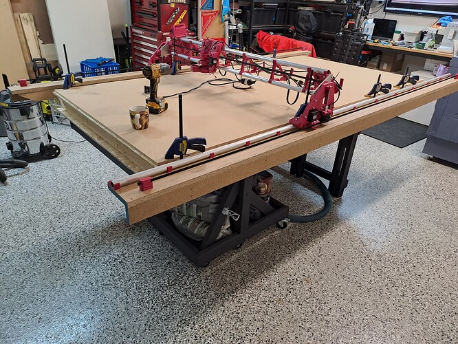

Magenta Dreams 😁
Looking good!! Thanks for posting pics and keeping us updated.

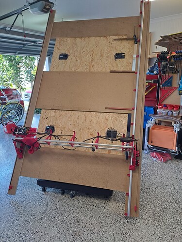

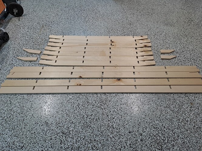

All cut and cleaned up. Ready for assembly. Hopefully tomorrow see what it brings.
The pics dont show any “running boards” for the sides. My latest cut files included those. My earliest ones may have. I see you have the little chamfered bits that help support them. Do you have those boards in mind that the LowRider wheels will actually ride on?

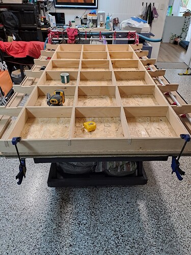

Hi Doug, I did see those running boards in the file when I was researching but I was more keen on having them as 1 piece so I used structural flooring boards that come in 3600mm x 800mm here. So the running boards are 1 continual piece and I have been using them since from the start. The side boards have been cut and are just waiting in the wings. Once the torsion box is built i will need to reposition the tube and Y Belts.
Ah, that’s great.

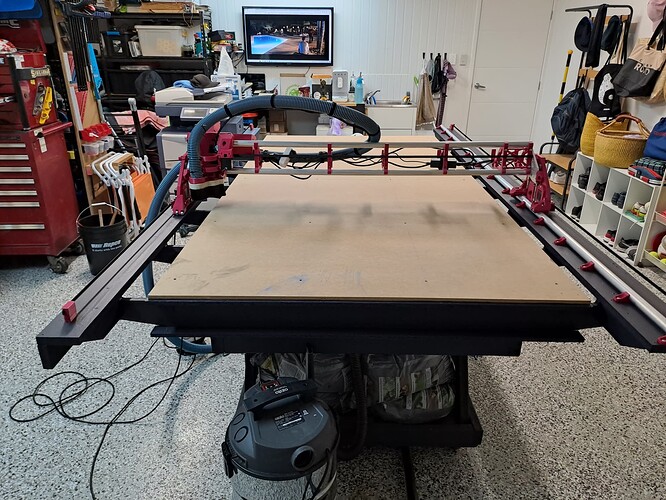

Progress update
Looks great! :smiley:
Nice work.
Looks awesome! Congrats on getting the table done!
Excellent!
Congrats on the table and machine!
Thanks for the comments people! Git a bit distracted with painting today. Also got the LR3 all squared up. Looking to get the trim router mounted and the Level the Z and then will surface finish the MDF Spoil board ready for projects.
