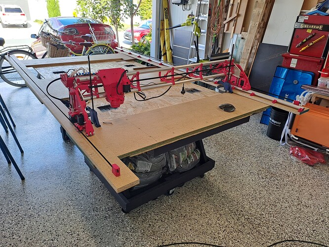

Got a bit done today. Gantry put together with temporary struts and mounted the rail and the Y belts. In my eagerness I forgot to take progress pics but the days results are on show below. Next its checking firmware, homing process and more reading up on the next steps.
Nice use of the clamps!
That looks awesome!!!
Looking great!
Thanks guys! Excited to power it up and get the firmware all sorted and start giving commands. While I’m waiting for the gargae to be free again I am looking at strut designs.
^^^ Watch this space
I didn’t want to take the y belts off just yet and wasn’t keen on having it hang there over night. I am thinking that once the torision box is made and the Magenta Dreams is a Megenta Reality I will make a cover that foldup and supports the gantry while in the tilted up storage position and the folds down over the edge when is operating position.

So working through the V1 documentation pages and moved onto the crown. I may have had the marker too close but the movements look to be good. I cant load the video at the moment from my mobile for some reason. Will work that out after the school run. Between work, kids and adulting, finding time to read up on this and apply is frustrating :slightly_smiling_face::upside_down_face::slightly_smiling_face::upside_down_face::woozy_face:
I was on the milling basics page and trying to determine what I should have as the coding for the before and after pages in Estlcam. The screen shot and the coding don’t seem to match up and so I will try each to see what happens. I have been watching your vid @vicious1 on the workflow and the coding that I am running with just seems to want to Z dive straight away once I hit print rather than ask to touchplate. I home all axis, move to where I want to start the job, I am basing that point will be the Zero in Estlcam that I nominated. Anyway more reading up tonight and will have another search through the forums.

Now that I have cleared that up. Todays progress…
Getting closer to having a flat table top. Working on cuting out the torsion box design @DougJoseph has. I have had a couple of sharp learning curves so its been a bit of a start and stop with some trial and error also. Happy with the progress and getting my head arround using Estlcam.
More progress tomorrow with hopefully a new torsion box assembly :crossed_fingers:
