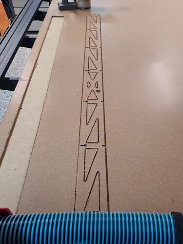

Well the second attempt of the strut brace had by far better results. The torsion box design was a god sent. Thank you so very much @DougJoseph. After taking a number of measurements I abandoned the idea of surfacing the spoil board. Even thought it was cut out on a very uneven bench, once constructed very flat. I am investigating ideas and designs for holding materials in place other than screwing the stcok to the spoil board. Now to cut the next 2 strut braces and sadly, they will not have the Hello Kitty design. I am not confident enough for engraving just yet. Ill get the orignal brace design cut, painted and installed and then work on making the LR3 workhorse a piece of art
You are welcome, and thanks for the kind words, and for posting updates, and for including pics! Exciting to see it come to life!
I have many many hours on my machine and still haven’t surfaced the spoil board. Sure I cut a little deeper into the spoil board when cutting out a part sometimes, but meh that’s what it’s there for.
When you want to do fancy engraving and mm matter, then maybe it is worth revisiting. Even the occasionally engrave has come out fine and hasn’t made me think about it yet.

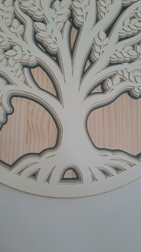

So it has been a while since I have posted. Have made a few things but always too eager to get it done and forget to record or take pics. I have been interested in the 3D stecil/stacked wall art. I spent some time getting my head arround inkscape and working with svg file. I then chose a tree of life design for a wall haning piece. I cut the 4 layers out of 3mm MDF. Was fiarly clean finish to teh cutting with the 1/8" 30 degree v bit and with a light sanding took the edges off. but when I tried to spray prime for paint with 2k its furred up hugely. Spent way more time snading and prepping than I wanted to. So i finished it offf with 4 colours of the wifes chosing and then cut out a backing board for wall mounting out of FJ pine slab. After mounting it I was straight onto the fourm to find out all i could about lasers!!

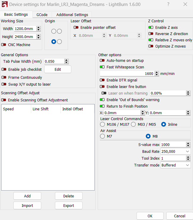

So, I set up my device as a Marlin, shown below. I exported the gcode after following the comments from the above thread. Commands are “Inline” and I made the S factor 1000 and Fast Whitespace Scan to 1600mm/min. Gcode script to include M3 I at the start.

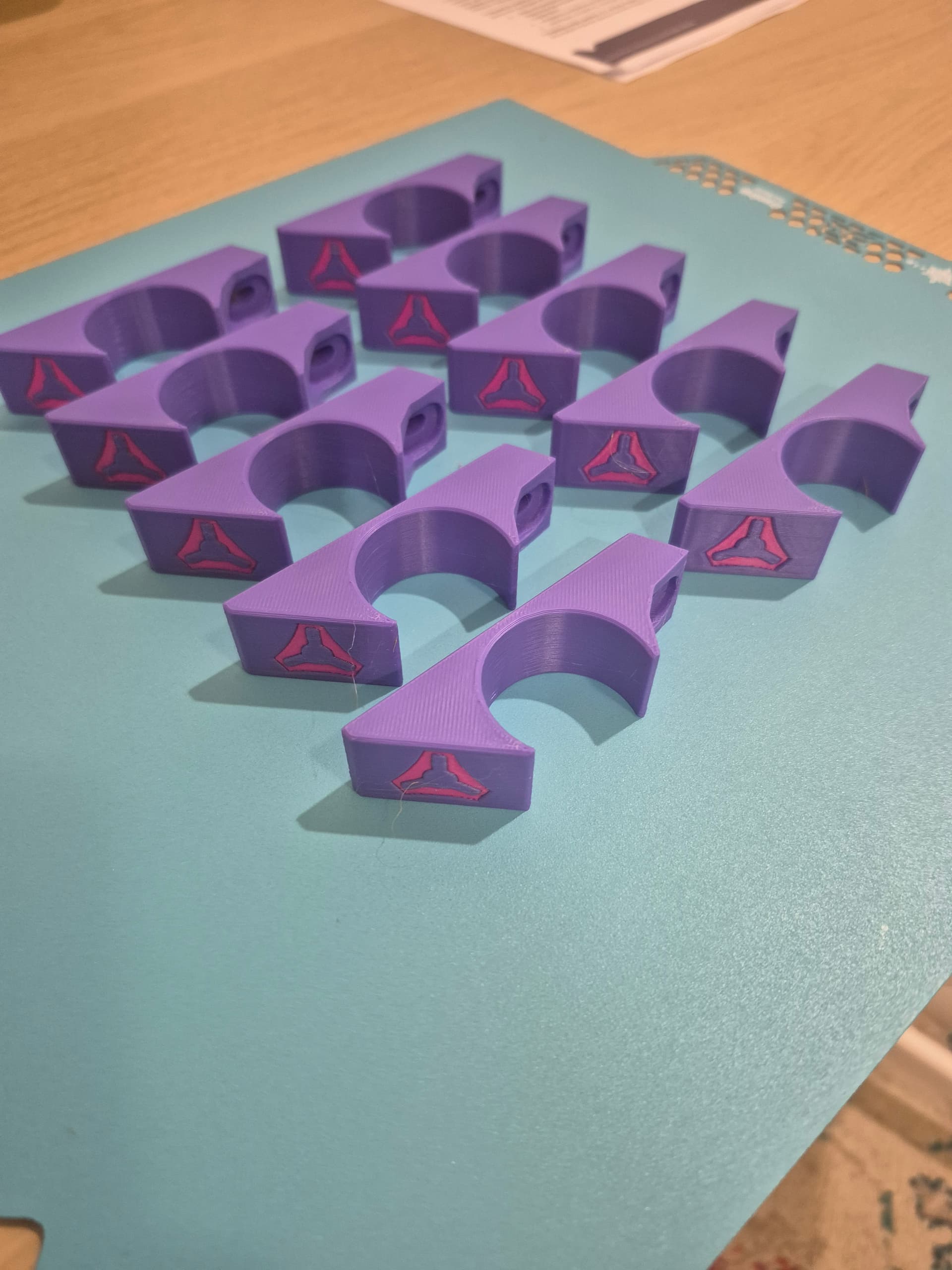

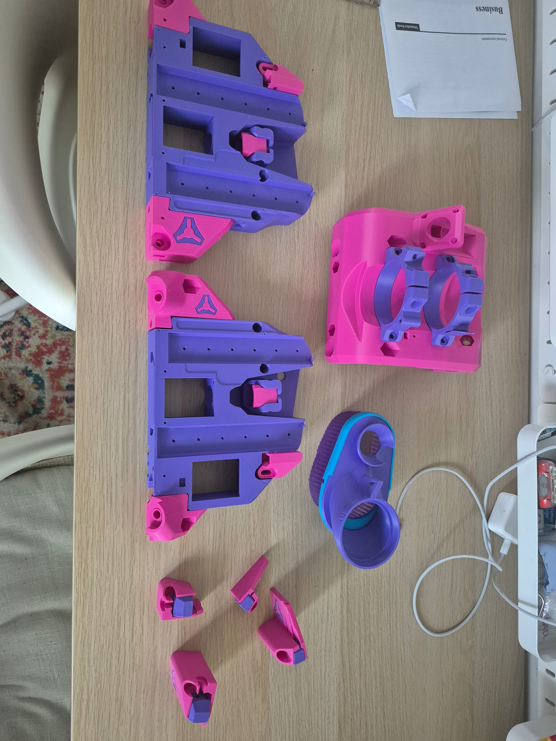

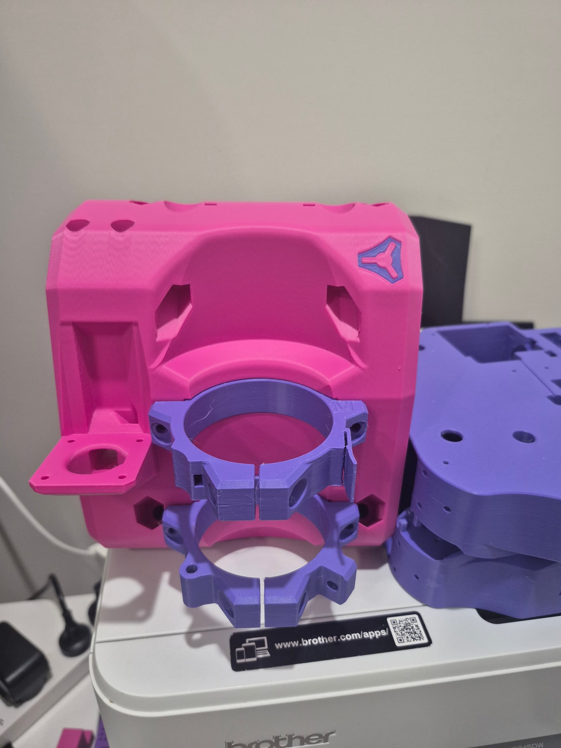

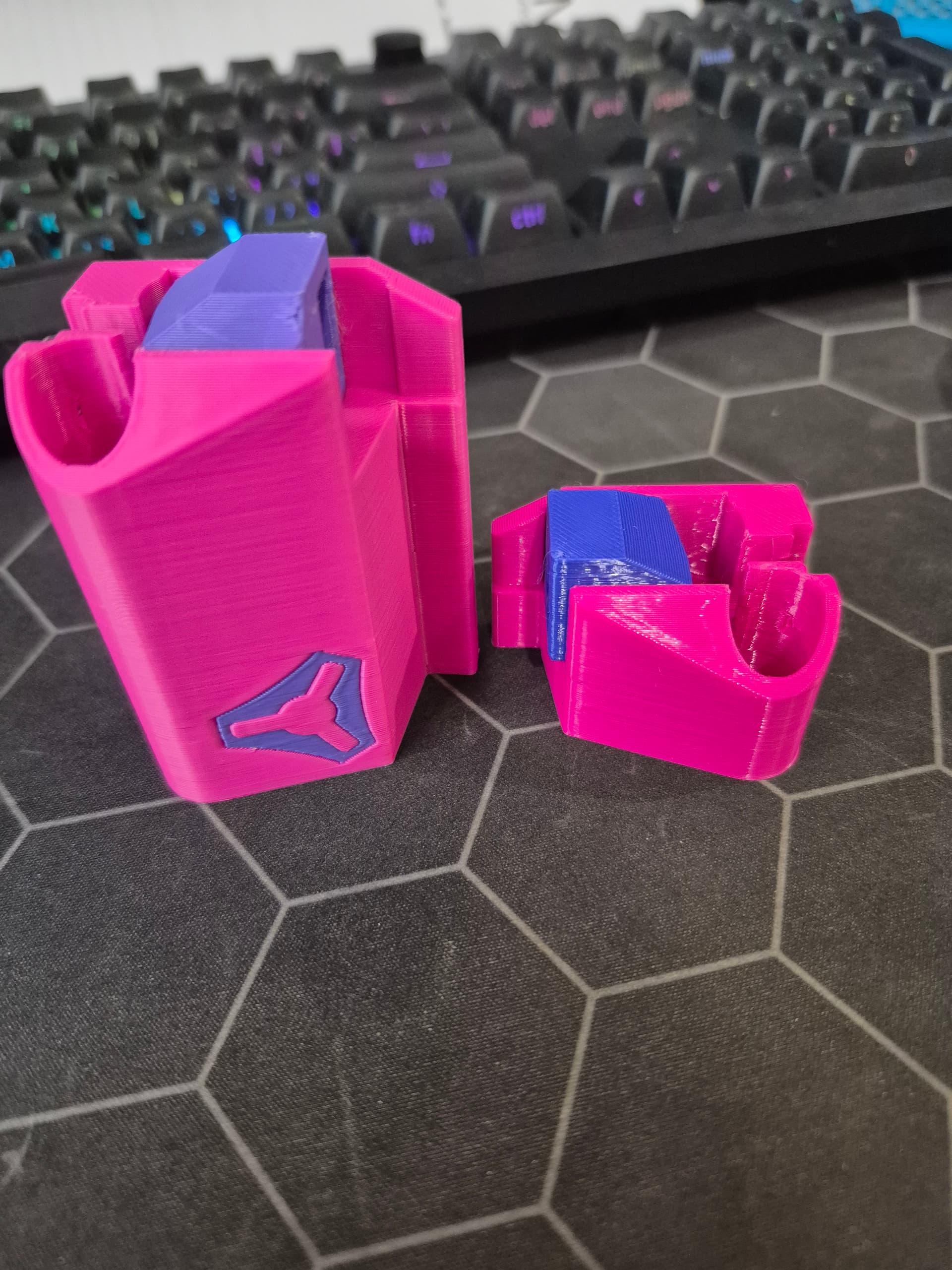

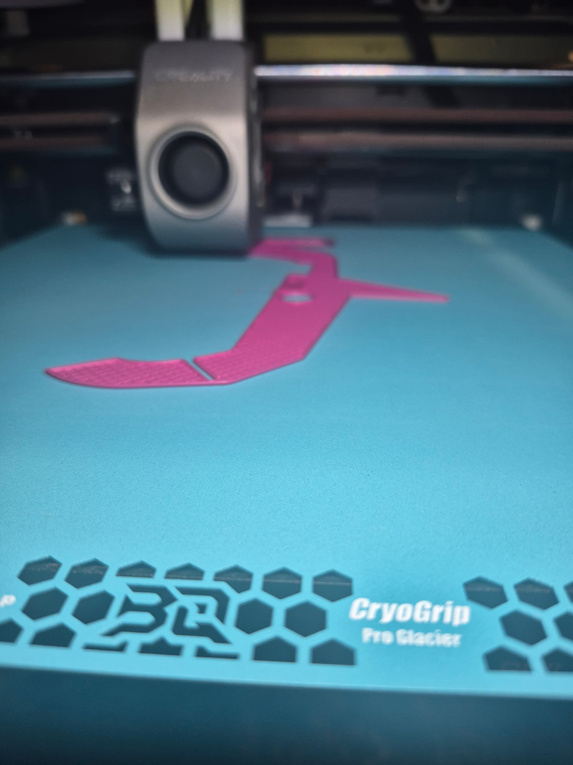

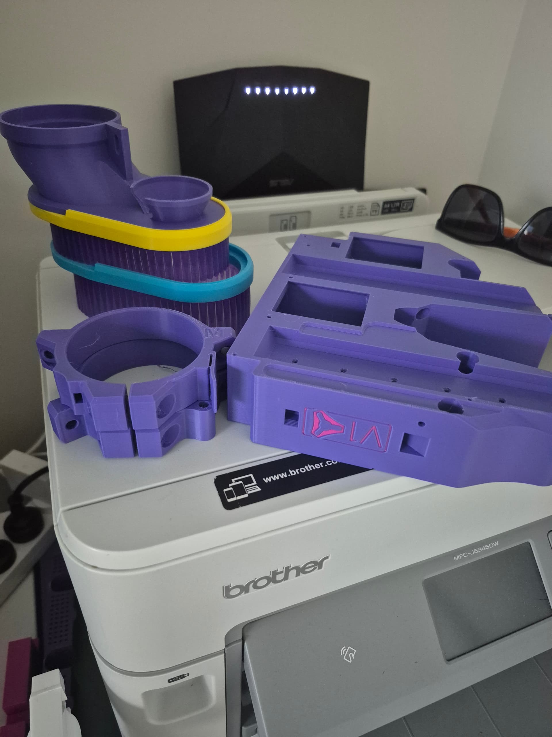

Ok, so i have just finished printing most of the part, only have the gantry struts and y clips left.
But, as mentioned by @Dreyfus there is more lilac than i wanted but my intention was to cover most of it with magenta peter plates. But as my wife and daughters pointed out, it reminded them of the tricycles they had as kids.
They thanked me for the trip down memory lane. I said thanks, now im looking for different filament
