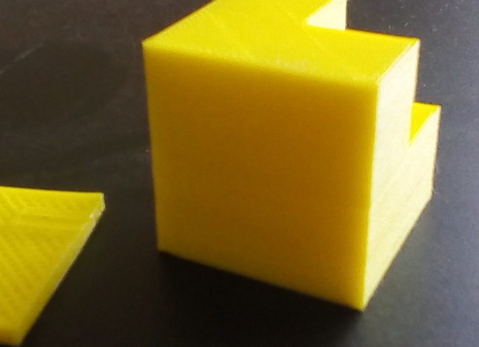

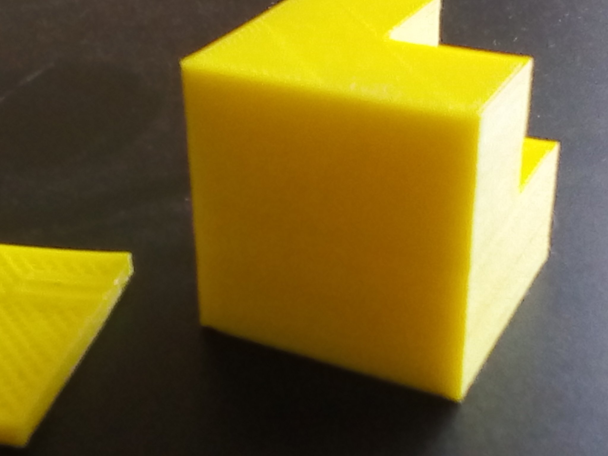

So here is the first “fail” and next to it the first success which was the very next print.
[attachment file=56460]
The fist print lifted a corner off the bed so I stopped and tried again - with more glue stick.
The dimensions were pretty darn good, the hole is round and the inset is dimensionally equal so for now the “steps per millimeter” settings seem to be OK.
But what REALLY pleased me was the smoothness of the finish and the lack of “Z axis artifacts”!

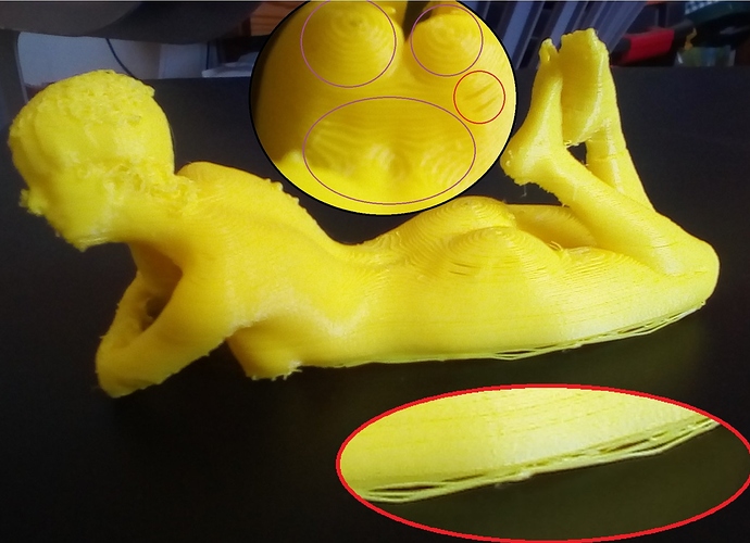

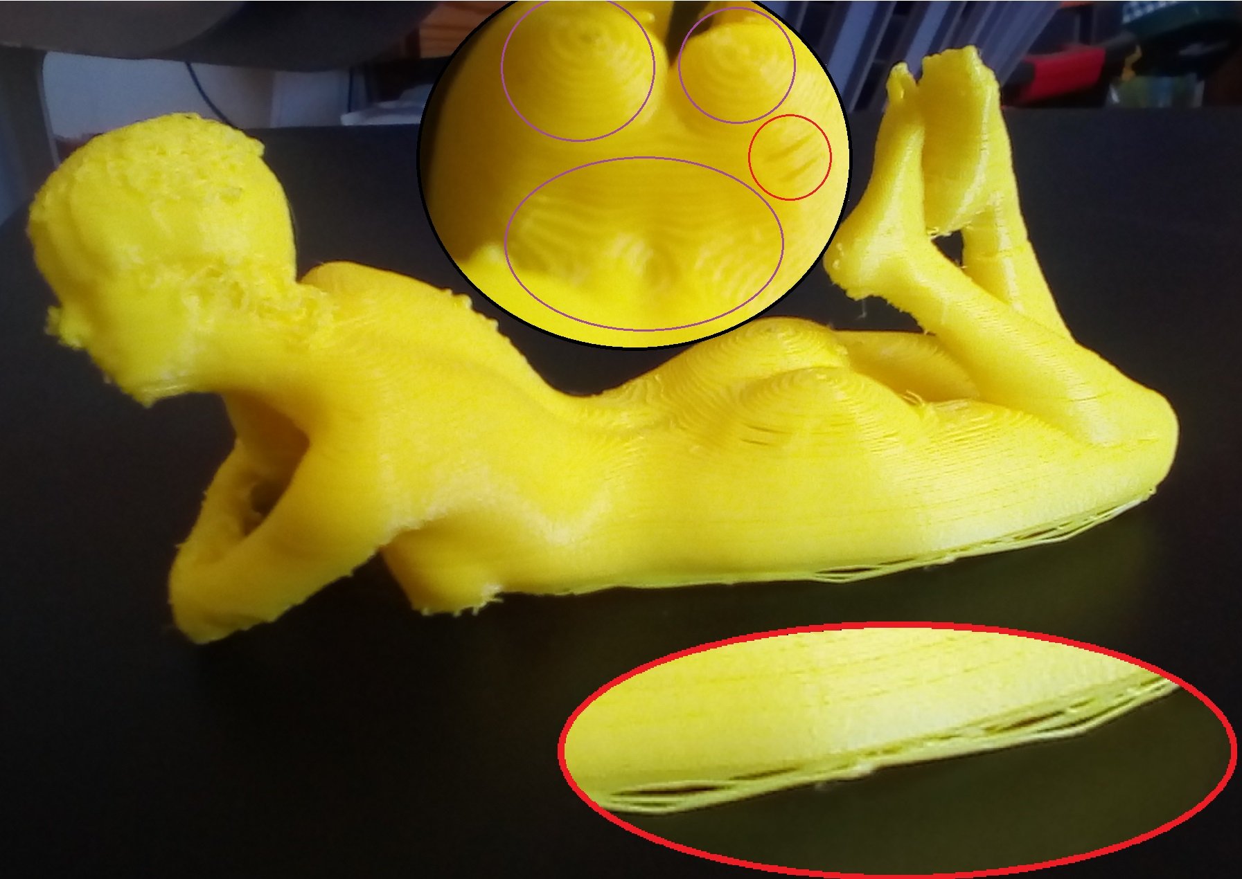

MEET “ALISON”
[attachment file=56461]
Sexy little wench isn’t she?
Yes, there are definitely still a bunch of issues to be sorted out but without cooling? I would say that it came out pretty good.
On the top of the buttock it looks like the same sort of delamination type issue that you get on the bow of the Benchie and there are layer lines on her bum and thighs but those are slice thickness issues.
The carbuncles on her shoulder-blades are probably ooze wipe-off happening when the nozzle moves from the leg to the torso - a retraction issue I think.
And at the bottom is remnants of the blocked/partially blocked nozzle issue that seemed to clear when I got a bit forceful with the filament.
Other than that, except for the groove around her one leg in the vicinity of the ankle she is not too bad to my newbie eye as far as finish goes.
The overhang support structures that Slic3r puts in seem to be adhering a little bit more than is desired but that is also probably settings related.
And she has even got all 10 toes!!! AND 5 fingers on the hand that is fully view-able…
So even though technically this is a failed print, I am considering it a big success simply for the reason that it shows that with all the adjustments and setup that I made to her, Alison is more than capable of producing a good print with a good finish when she does not have extruder indigestion.
Judging from the marks on the actual extruder nozzle I am probably the first one to use an actual spanner on it - there are all sorts of jaw marks and rounded edges on it - the orifice is probably not round anymore either - think I must hunt down a new one…

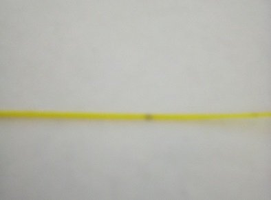

{Quick addition to the post}
I have just gone and made some tea for myself and as I was waiting for the kettle I decided to do another print using the saved settings to see what happens.
After everything warmed up I gave the extruder a purge and all it did was make a rats nest at the nozzle - so I did an "assisted purge.
This is what I got coming out the extruder! (sorry but my phone is no good at close-ups)
[attachment file=56462]
I can actually feel it with my finger!!!
That means that either the filament, which is in a re-branded box (from a supplier that has proven themselves to be shysters) is cr@p (the reel says “ZEN” but it is probable that it is fake)
OR there is carbonized plastic hiding away in the nozzle and that is randomly being extruded!
So - Off I go to hunt down a new, better nozzle.

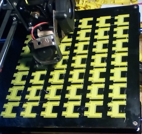

And on the bed I’m printing cable chain pieces - the first row all lifted (which accounts for all the spaghetti).
[attachment file=56551]
I have already printed the shroud for her new parts cooling fan.
After I get 2 new fans I will print up a nice extruder cooling duct for her.

Update:
“Space Invaders” are attacking Alison!
[attachment file=56556]
Actually the links for a wire management chain that I promised her ;>}
And this is probably the first time the print area is TOTALLY full.
The last batch was “only” about 24 - and unfortunately a bunch of them sort of came loose - which had me sitting there for about 4 hours with a long nose pliers fishing out spaghetti so that it didn’t mess up the ones that were still sticking.
And if my calculations are correct I will have to print up another batch…
I have bumped the feed rate up to 125% and everything still looks OK and Alison is jiving away quite contentedly - so we will see.
Why didn’t someone tell me that printing takes so long? ;>}

Those cable chains work a little better if you print some in each direction, so any small errors are canceled with the next link.
Printing on the whole bed is a pretty good indicator that you’re doing something right.
Hey Jeff,
That print took FOREVER to finish and all components were usable I’m glad to say.
