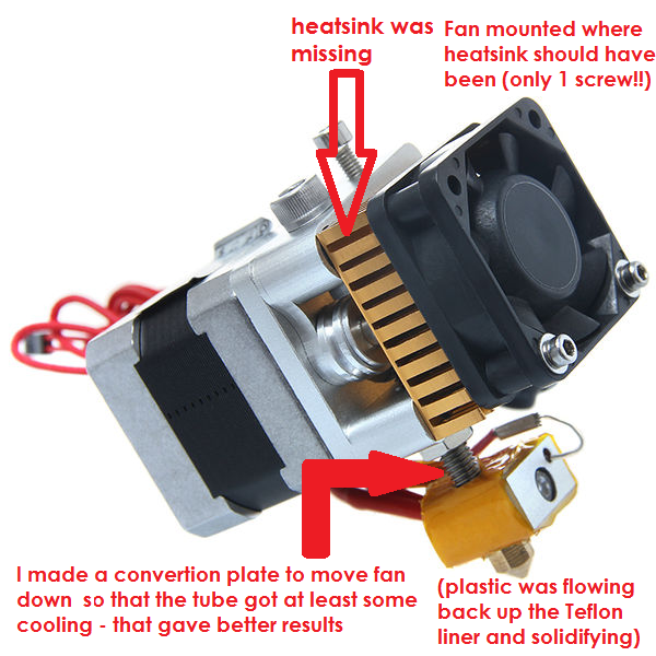

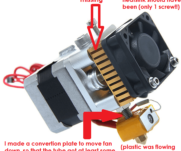

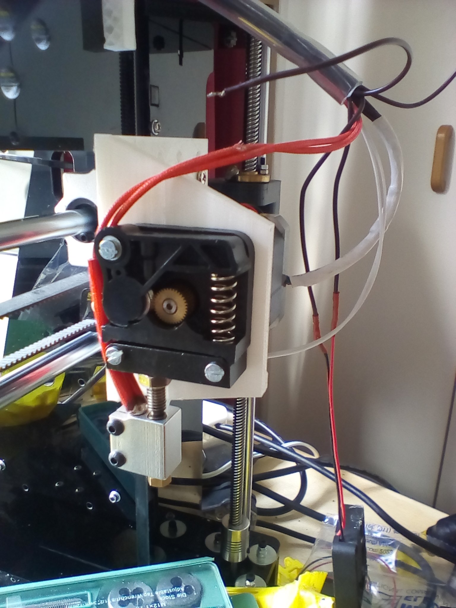

Hi Bill
The heat-sink was not even there when I got her!!!
One of the first things I bought was 1 meter of Teflon - I have less than 500mm left !!!
[attachment file=57060]
The fan was bolted (only 1 bolt) onto where the heat-sink should have been.
After a bunch of tube blockages (and associated Teflon tube destruction’s) I made an adapter plate to move the fan down so that at least some air was cooling the tube.
That made a big improvement…
What I have got now is this:
[attachment file=57061]
It is still pretty incomplete in the photo but I am getting there.
I went for the “Volcano” style setup because at some point I will be prototyping the works that are going to be run on the MPCNC (in miniature) to check dimensional aesthetics etc and that will probably be done using a 0.5mm or thicker layer height - for those I will not be too concerned about “smoothness” ;>}
And of course there are no 0.4mm nozzles of either style available in Cape Town - so I got 0.6 , 0.8 , and 1.0mm nozzles and for the time being I will use the 0.6 nozzle - it “should” work for printing the components.
You will also notice in the pic that the carrier is now white PLA.
This is a prototype and I had to do much Dremel work to get it working…

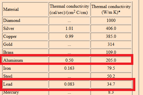

In my previous post I mentioned that I have changed to the “Volcano” style nozzle design to get a larger “melt zone” but when I got the new heater block it was aluminium !! ??
So after thinking a bit I came up with the following:
Lead being far more dense than aluminium will store far more heat.
So why use aluminium? And found this - (don’t ask me about what the units of measure are all about, just know that the higher the figure, the faster heat moves through the material)
[attachment file=57066]
So, heat moves through aluminium far quicker than it does through lead.
That means that in lead it takes longer for the thermistor to switch off being the other side of the “melt chamber” in both designs.
BUT the temperature around the heater in the lead unit will of course be much higher than on the aluminium one because the heat moves faster in aluminium than in lead.
BUT because lead is also much denser the amount of heat is far greater and this heat then travels to the melt chamber and keeps on heating the plastic.
The result is that the melt is overheated!!! Which leads to all sorts of problems.
Now with the aluminium heater block the following happens:
  • The thermistor switches off far quicker because the heat gets there faster.
  • There is far less latent heat in the aluminium block (lower density) so the upwards "thermal spike" created by this excess heat being pumped into the block while waiting for the thermistor to be triggered will not be as severe.
  • Because the "melt chamber" volume is far greater, the melt temperature should not spike above acceptable levels and therefor it won't burn or carbonize.
  • When filament is processed thereby reducing the heat in the system the thermistor will turn on again far quicker (aluminium = faster heat/cold traveling through it)
  • And when the heater gets turned back on, the heat will get to the melt chamber far quicker thereby stopping the downward "thermal spike".
The result should be better and tighter control over the temperature of the material being extruded which can only lead to better results.

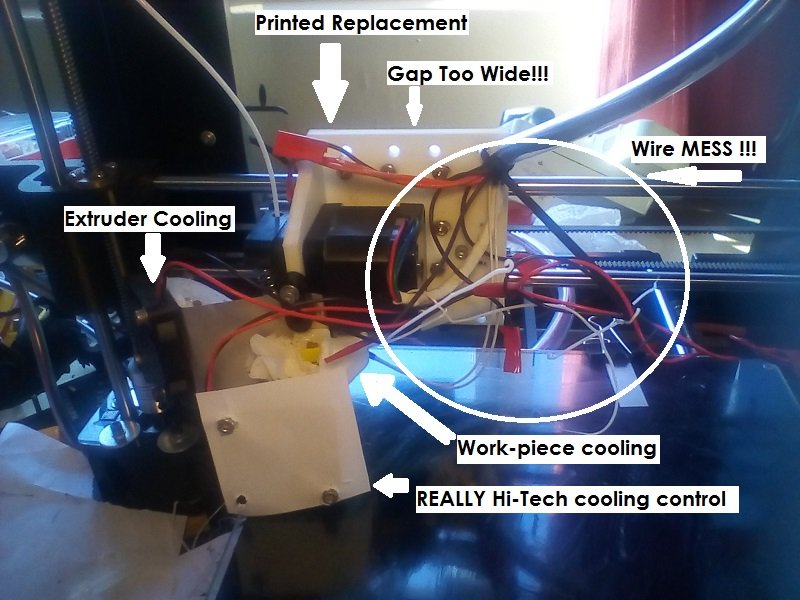

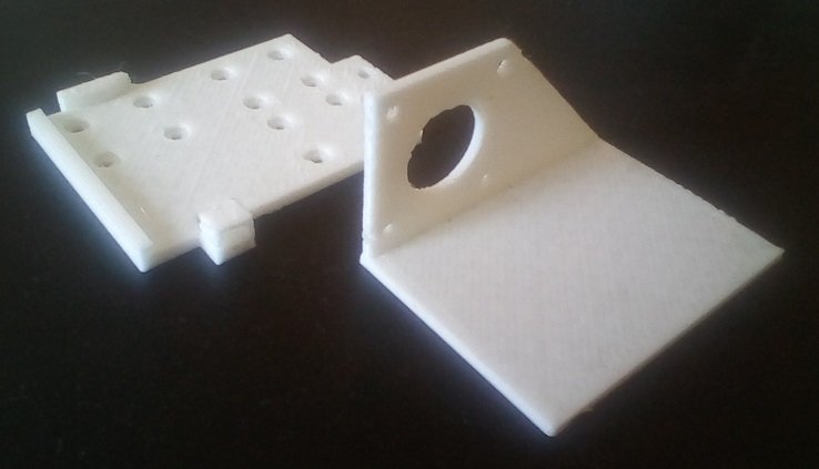

Hi all - and no, I have not run away…
It is just that “life” has decided to make things “interesting” for me - and my ADSL provider… well, lets just leave it there.
I figured out that the aluminium j-bracket that the extruder mounts on is bent so I printed a new one - my first imperfect design on modern CAD.
The only problem is that the space between the 2 top bearing blocks I made bigger thinking that the further apart they were the better control there would be - but guess what!!! Now Alison has a usable width (left to right as viewed from above) which is significantly less that the 200mm she used to have - dhaaa!!! My bad. Not thinking things through properly…
I fixed up some temporary fans and ducting to cool the extruder tube (which work maybe a little bit too well - she battles to hold 180 degrees even when set to 200 degrees in the software) and the work-piece (possibly the same over-cooling issue!)
Now don’t laugh but this is what the “Christmas Tree” looks like right now.
[attachment file=58453]
The cooling “system”… A TOTAL MESS! But I was sitting without an internet connection so I had to make do with what I had - being a drawing for a cooler duct which I had downloaded just to see.
So I printed one - which melted on the bed - next print I used a hairdryer on a shoe-box next to the printer to give some cooling and although still a disaster, it was more or less usable - so I printed another one.
Mounted the fans to the ducts and hung them on the best I could just so that there was positive cooling going on.
This involved a lot of Dremel, odd bits of plastic, even a piece cut out of a soft drink can - but now the heater tube and the work-piece were getting cooling even though it looks like something the cat dragged in - it works!
MAYBE a bit too well!!!
The extruder simply would not get to 180 even when set to 205 - so for startup I put a piece of paper over the fans to “choke” them and give the element a fighting chance.
“Why not simply switch them off in the software?” I hear you ask…
Well, for some reason or other the fan control no longer operates so I had to wire them directly into the power supply.
OK. Now she was able to get the heater block up to 180 degrees and extrude plastic - well sort of anyway…

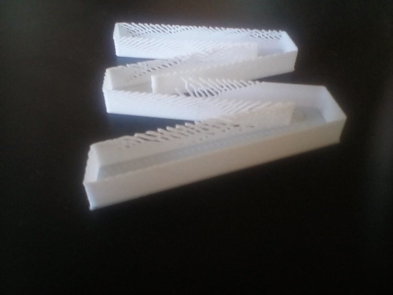

So the first “job” with the new cooling setup was these 2 parts - DISASTER!!!
[attachment file=58454]
The basic idea I feel is good but the quality of the print is terrible!!!
So I started changing the settings - and after 2 attempts decided to get a test model that was a lot lighter on filament and time.

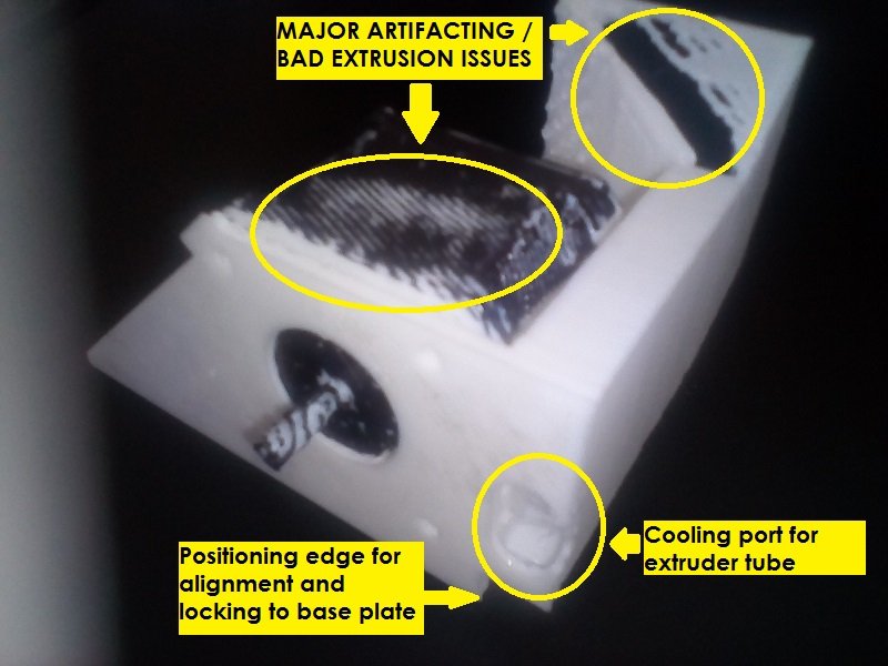

Chose a hollow, open on 1 side, letter “W”. Only a few grams and it has enough surface area to write the settings and notes on - trying to keep track of things.
And by the way, I was now using a piece of glass as the print surface because the heated bed was bowing up to a millimeter depending on the temperature - at least she now has a stable, flat print area.
I sort of eventually figured out that there is now too much cooling going on.
This is the kind of artifact issues I am getting:
[attachment file=58455]
In my opinion definitely related to temperature in some way - either filament too low or part too cool.

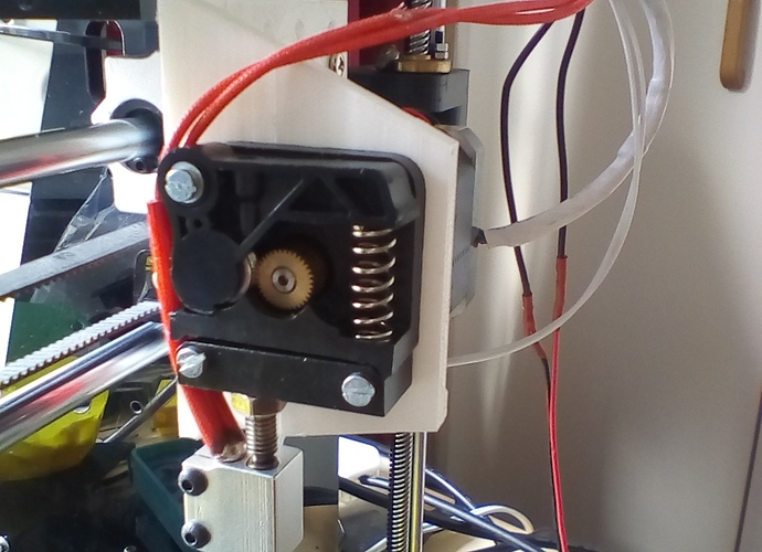

While waiting for these prints I did an updated extruder mount plate that incorporated a fan with duct to cook the extruder tube.
So just before I hit Alison with a hammer I decided to print my updated design - just to see…
[attachment file=58456]
This is the 2nd attempt - the first one was even worse!
I has downloaded a NEMA17 model from somewhere and I printed that so that I could see if the clearances were all OK and it is a good thing I did because it would not fit so I modified the design again and printed the one in the picture.
It came out pretty bad, better than the first one though and the motor now had enough clearance and there is enough place to mount almost any configuration of part cooling fan ducts.
