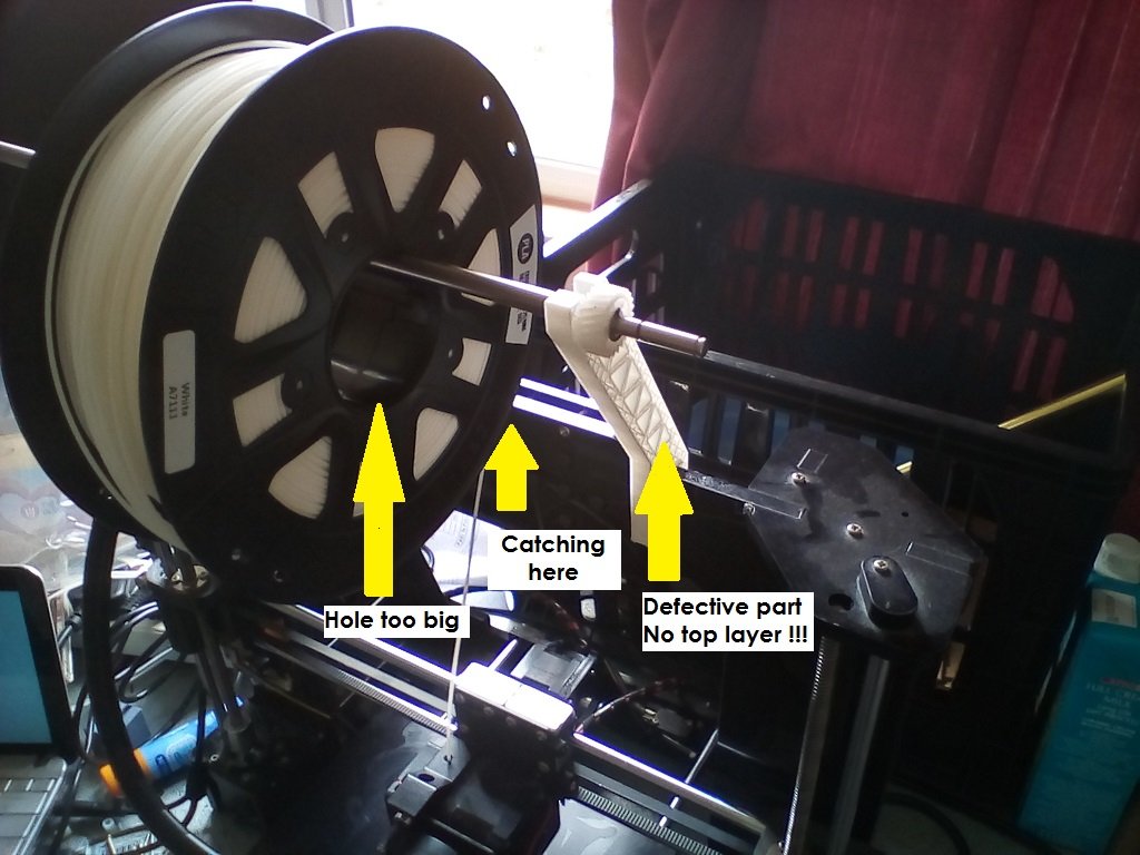

The first part print was a disaster!!! Filament was not feeding off the spool so it started printing air.
I hunted down a simple clip over spool holder that would fit my machine, sliced it and began setting the machine up.
I suspect that the heated bed may be warped as the adjuster at home position needs to be loosened more than it can be (the nut is no longer in contact with the surface).
Eventually got it more or less set up.
Then the filament started to grind - cleaned it all out.
Then I noticed that the extruder fan would not switch on - the other blower did…
Unwound the spiral cable holder - THE DARN THING WAS NOT EVEN CONNECTED!!!
To make matters worse all the places to plug wires in are used - NOW WHAT?
So I doubled up on the switchable fan connector. evidently the extruder fan runs when the machine is powered up but this is better than nothing!!!
Then I noticed that the positive side of the power supply cable pair was loose - It had just been stripped and twisted - out with the soldering iron and tinned the wires - heated bed power wires too.
Put everything back together - Evidently the board was changed at some point BUT its a crappy design, no space and mounted right up against the frame (the side with all the wires - USB port on the other side so can’t turn it over - last resort was to mount it with 2 screws but moving the right hand holes to where the left hand holes should be and wrapped everything up again.
And the little display on the machine frame does not work - needs to be updated (firmware) I had been told.

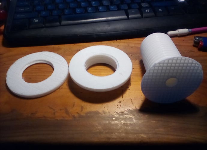

Started the spool holder print - forgot to replace the silicon extruder heat shield and the workpiece cooling shroud but let it go on.
So far so good - THEN just before it was about to do the closing on the top layer it lost communications…
Hope THIS is not going to become an issue!!!

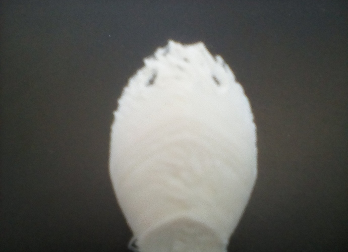

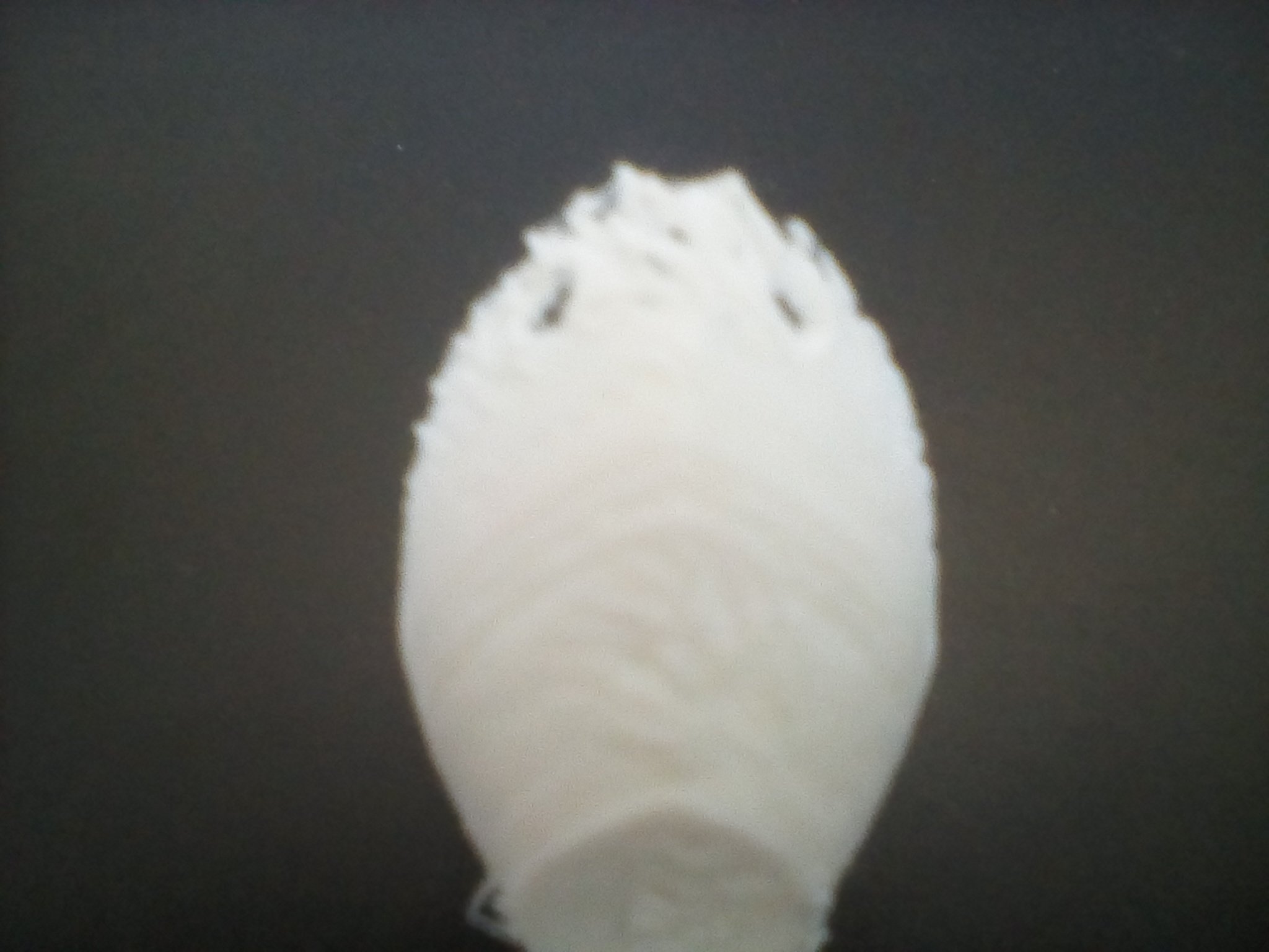

So the first port is a dud - but its usable…

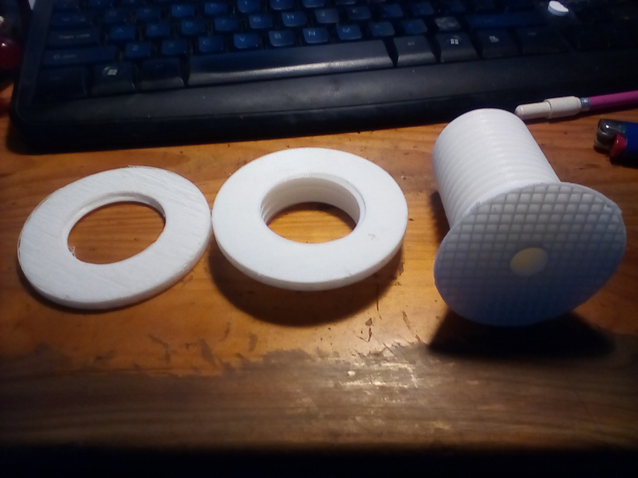

Put all the missing pieces back, cleaned the bed, rubbed Pritt (glue stick) all over it again and started on the 2nd one.
Then remembered that I had not checked the bed levels again…
Oh well, too late - but the bottom layer looked OK so I let her run.
It has just started to close the holes and when its done its sack time…
While I was typing this it finished - top layer too this time.
It does not look too bad but I think that just maybe I’m not pushing out enough material as you can see the boundary lines between the passes - little creases but not holes or drop-aways so I must remember that.
BED - NOW - Goodnight…

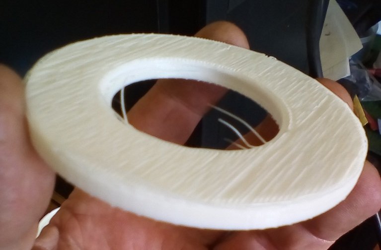

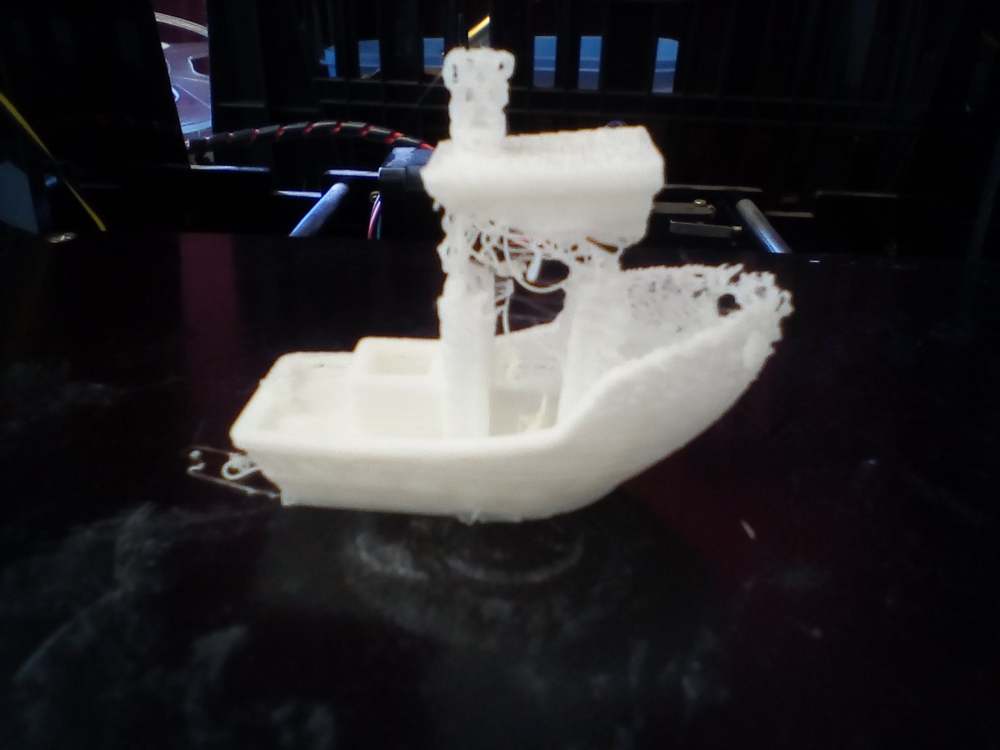

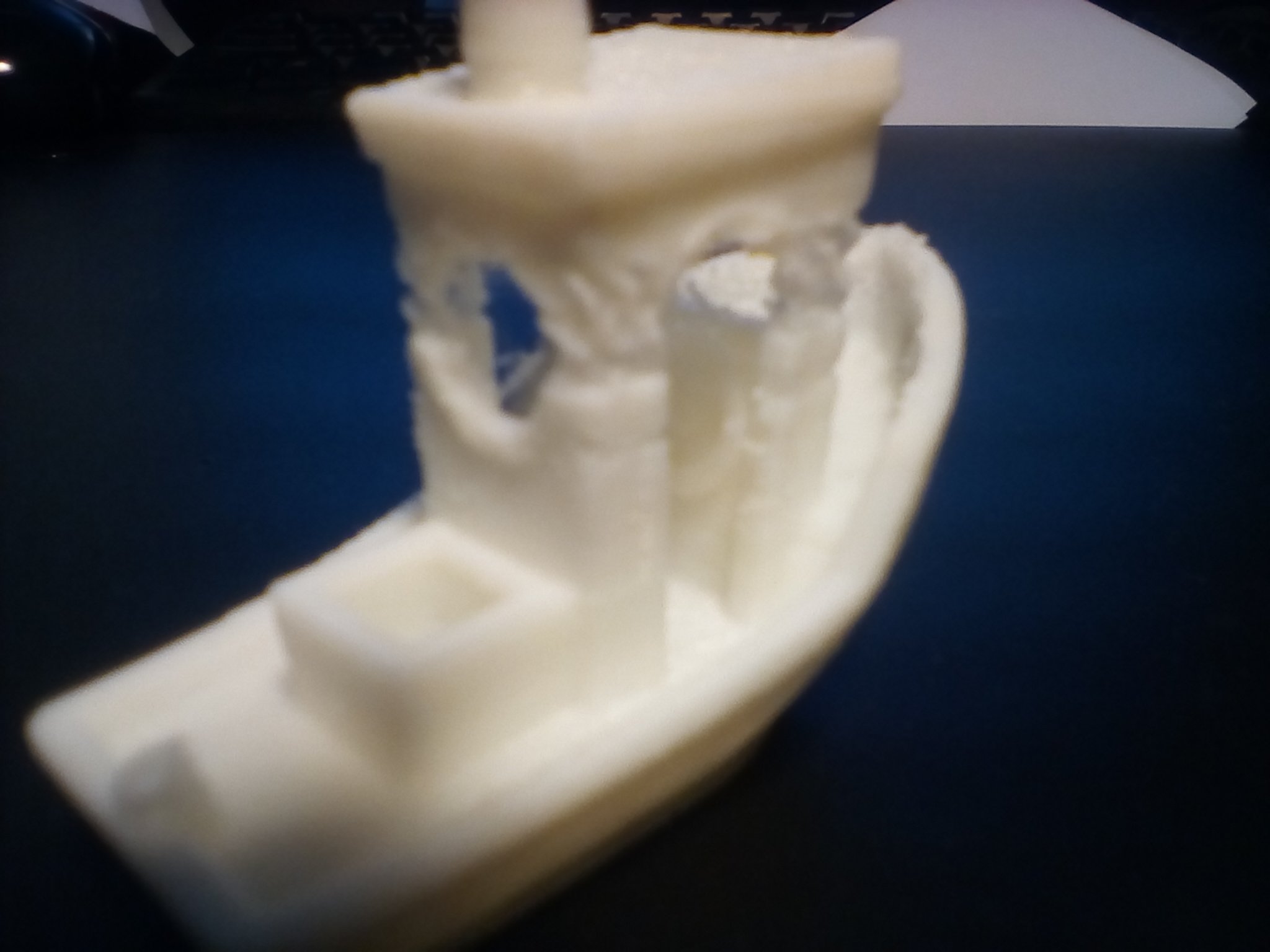

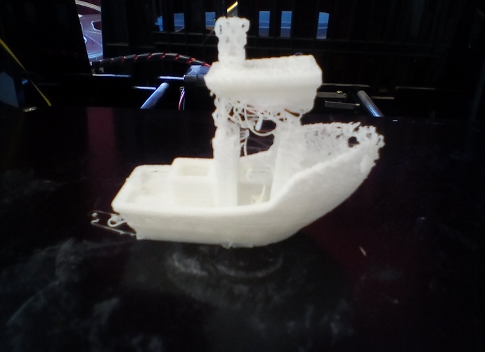

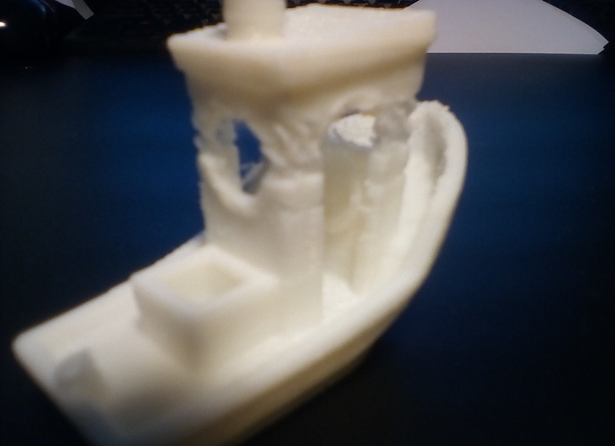

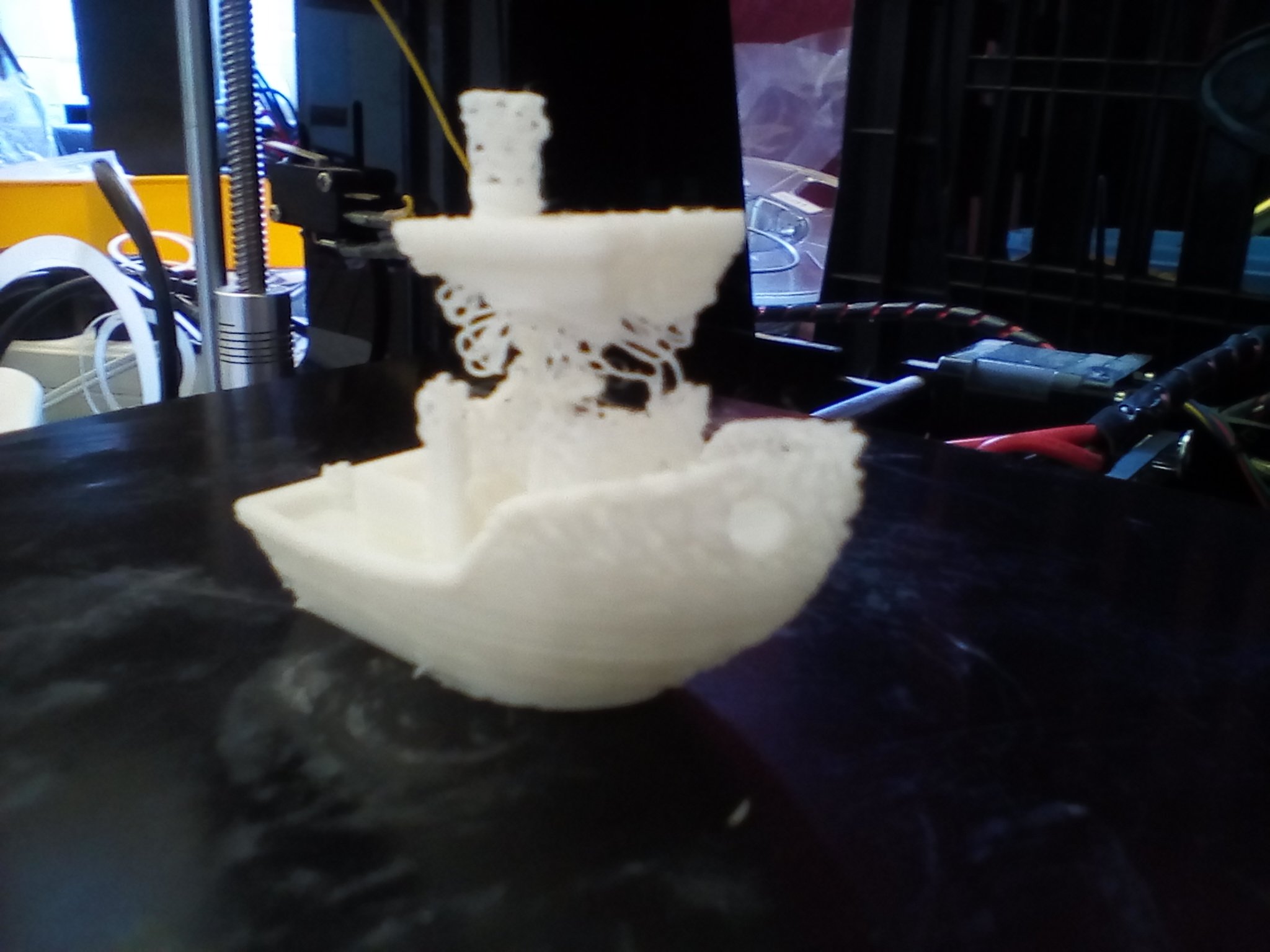

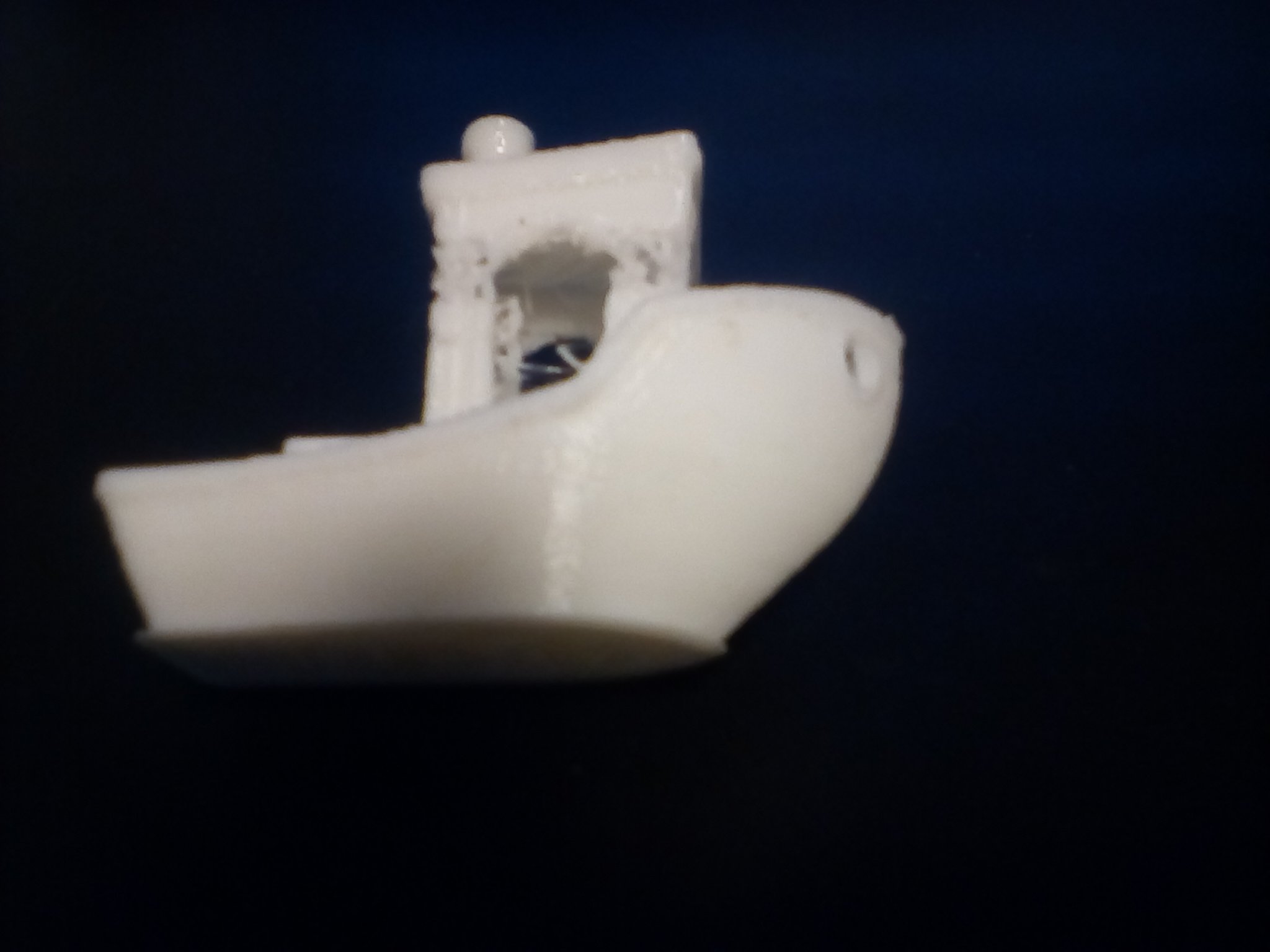

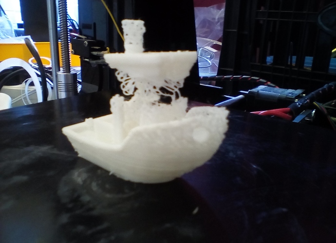

Just when I thought it was safe to “go back in the water” I discover that the 57 mm hole in the spool allows the spool to drop on the axle which allows contact between the rim of the spool and the machine frame.
I also show the “failed side arm print” in the photo - the infill sure looks “nice” ;>}
So off to Thingiverse and I found THIS
A bit “adventurous” for a newbie?
You bet!!!
But that is how you learn!!!

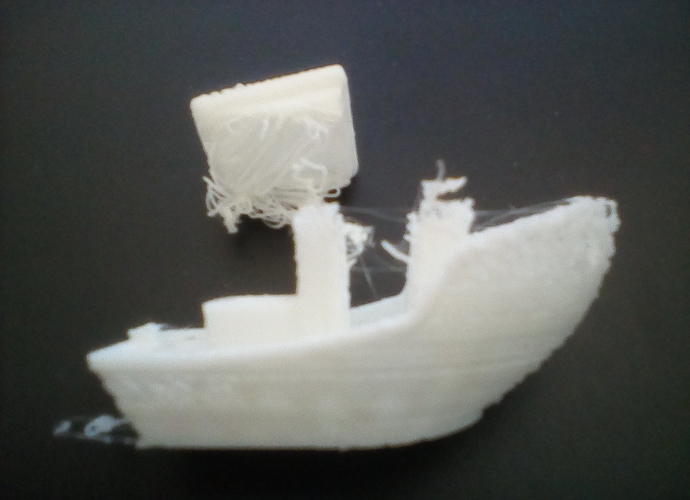

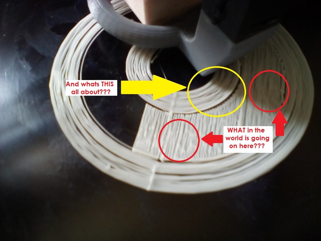

First print: unmitigated DISASTER !!!
The piece around the edge didn’t even bother to adhere.
So it was started again and while it was in the final warm-up stage I hit the bed with the Pritt stick in a VERY liberal fashion.
Well, the bit around the edge stuck OK.
HOWEVER the first layer was all over the place.
The individual lines were not lying flat and parallel to each other, there was gaps all over the place - it was a mess!!
And in the center it looked like the wall of the hole was drooping off to the side - NOT GOOD!
Almost aborted the print when I had a brainflash: IDIOT!!! There is a thread in the middle of this thing and that is the start of it!!! (Carefully removed the cursor from the “Abort” button)
So I increased the flow rate to 106% (sounded like a nice enough number) and on the 2nd layer things started to look better, everything was smoother so I let it run and had breakfast.
Thinking about the crappy first layer I came to the conclusion that something was definitely out so I sat eating and thinking (sometimes I multi-task - what can I say!)
Then it hit me: The problem is with my setup procedure!!!
I home the machine, lift the Z a few millimeters, Go X0 Y0, home Z again and use a piece of paper as a feeler gauge to adjust and repeat on the other extremities and do this a few times.
BUT THE BED IS THE THICKNESS OF THE PAPER BELOW MACHINE X0 !!!
So the first layer is not being extruded “into” the bed but rather above it!!!
That means bad adhesion and 1 layer’s worth of material having to try to take up the volume of its own layer PLUS the layer represented by the thickness of the paper !!!

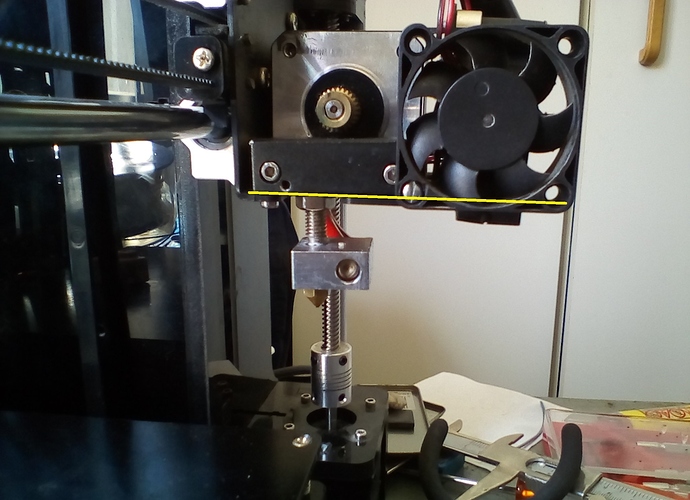

I have come to the conclusion that I bought someone else’s pile of spares!!!
A spare frame, spare bits and pieces - got it all working sort of - and sold it to me.
Why do I say this?
Well, there is not a single washer on the Alison (thats her name now - she can be a b1tc# but if you treat her well she works…) and there are an assortment of miss-matched cap slotted and cap screws all over the place.
And I’m not going to even talk about the wiring…

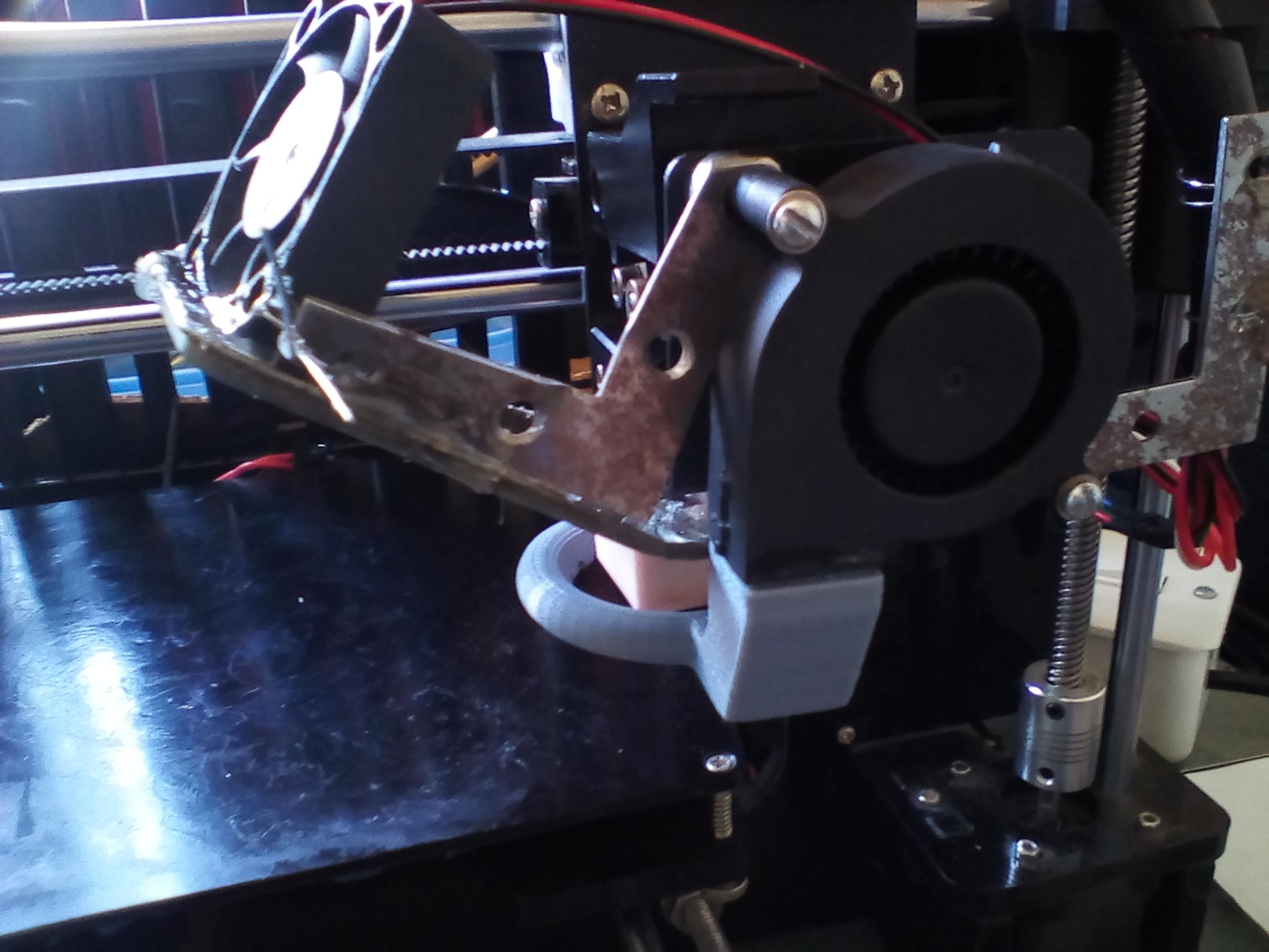

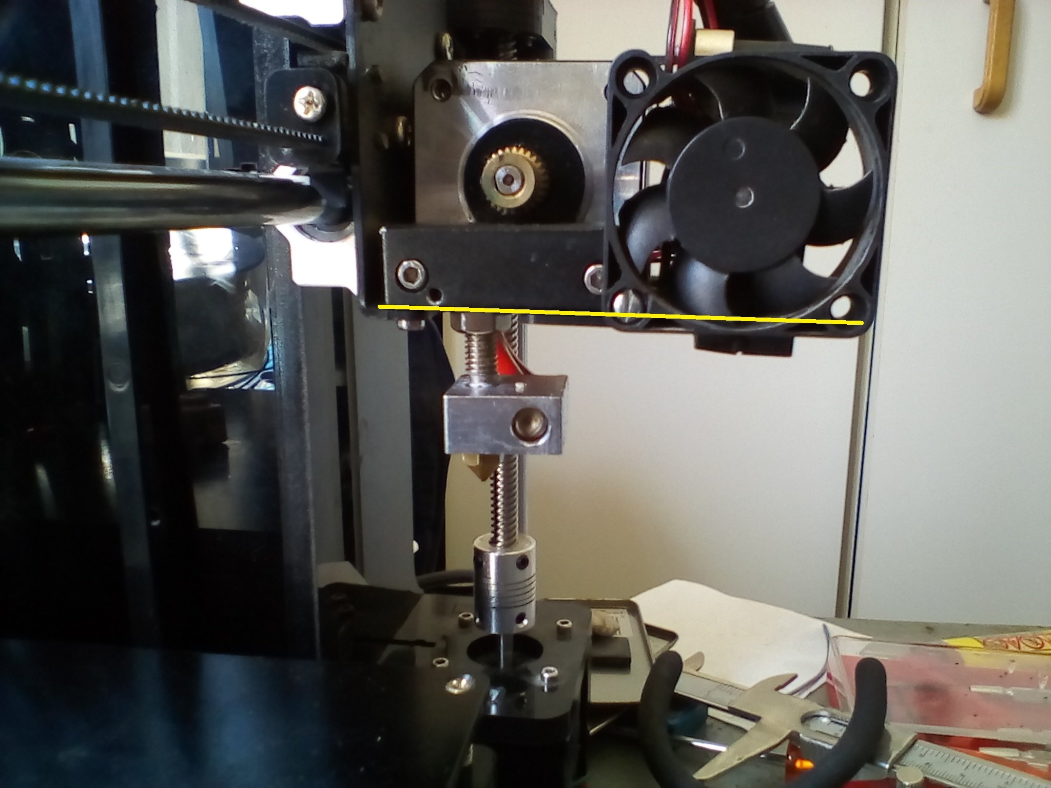

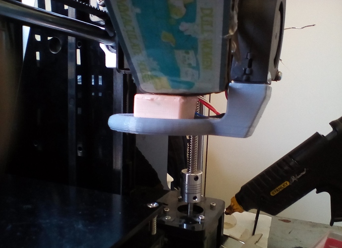

Another big thing that I noticed is that the fan was in the wrong place!!!
In the photo I have mounted the motor to the right of where it was and drawn a line to show that it was cooling the extruder gear and the stepper motor but nothing was getting to the cold end (?) because the bottom of the extruder assembly was blocking any air movement to that destination.
[attachment file=53429]
So the Stainless Steel “melt chamber” was getting hot and the “cold end” was too which supports what Ryan said earlier about frying the PTFE liner.

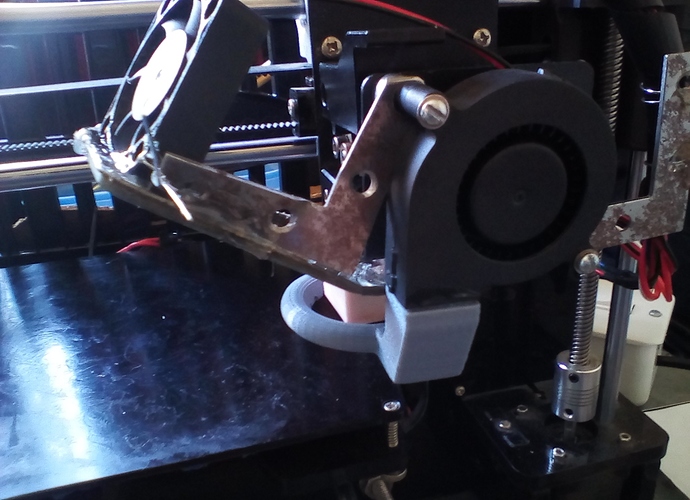

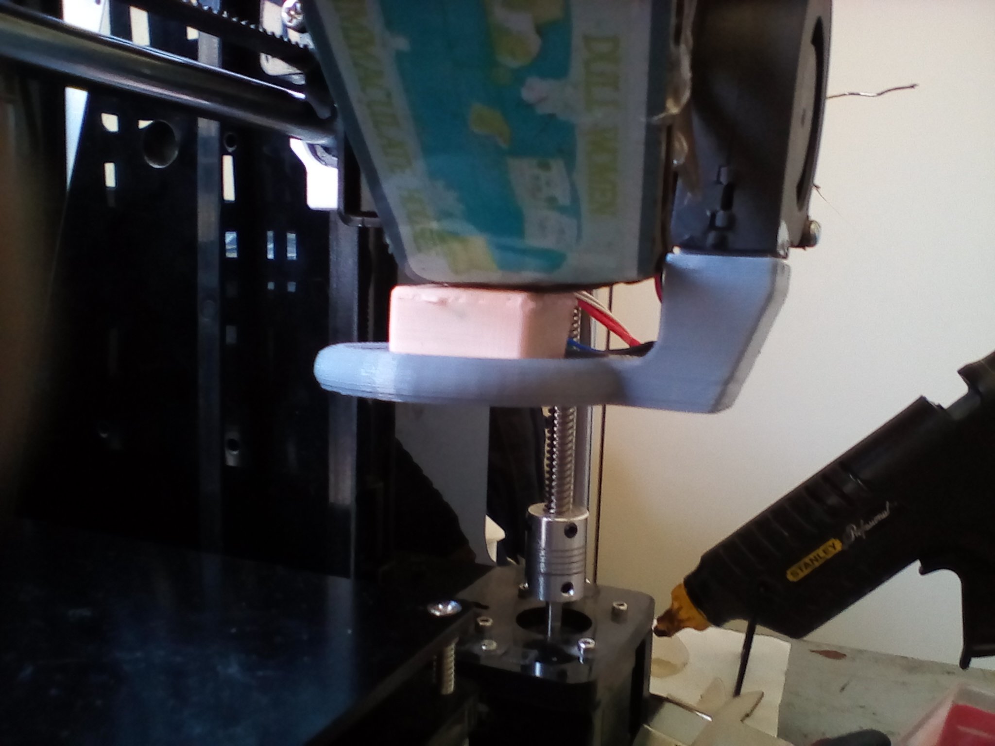

But the show must go on - I need to get my spool holder printed so that I can carry on with the MPCNC parts but it looks like I have to find a cooling shroud for the “melt chamber” to print first - and maybe some harness clamps to control the rats nest of wires rubbing all over the place and bending where maybe they should not be bending…
But in the meantime I cobbled together a bit of a Heath Robinson contraption to get the air from the fan to where it is needed.
Here it is - its NOT pretty!!!
[attachment file=53430]
And a view from below…
[attachment file=53431]

So I set up the job (using a modified setup procedure that seems to have gotten rid of the first layer problem) and printed the nut part again.
That came out pretty nice in my inexperienced view - seems that the nozzle is sort of smearing or smoothing out the line if material as it is laying it down which begs the question “Is that a good thing?”
I think that maybe it is because it is forcing the new layer into hard contact with the previous layer which probably means good layer adhesion.
Or maybe it is NOT!!!
I started the “bolt” part of the assembly and made what is probably a rookie mistake - I didn’t flip it over so that the large part was at the bottom.
Which means that I started printing the narrowest (43mm) part and the widest (80mm) part would be at the top.
Well, something happened - the nozzle somehow climbed sideways off of the piece, the steppers skipped a whole bunch of steps and proceeded to print in mid air…
Fortunately enough of the part had already been printed so that it would at least be functional!!!

On the left is the first failed nut, center is the “good” one and on the right is the the “failed but usable” bolt piece.
I’m using Repetier-Host with the extruder set to 190 degrees, the bed set to 50 degrees and I’m using glue stick. Even though there was a collision between the piece and the nozzle, nothing broke free from the bed.

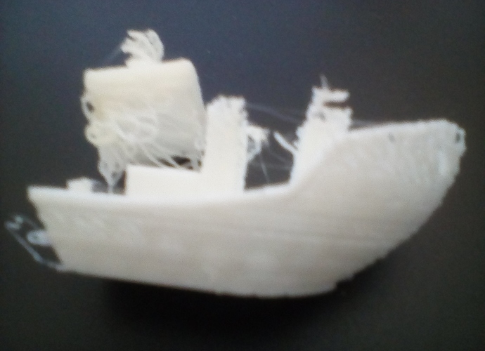

Oh my Giddy Aunt Mary!!!
I printed the little boat test model and it is an unmitigated disaster!!!
And to make matters worse, I don’t have a CLUE where to begin sorting it out!!!
I have seen this test model looking “not so good” but maybe I have set a new standard of “LOUSY” …
HELP !!!
That looks like severe under-extrusion and/or a partial clog resulting in not enough and intermittent plastic actually making it out of the nozzle!
Yea, I agree with Vincent, under extruding. Usually the filament has suggested temp range on the spool. I usually print 10 degrees hotter than the lower temp.
Hi Vincent.
I have basically spent the whole day printing benchies - most of them big failures and the last one, although a failure, is definitely getting in the right direction.
And what you say is starting to make sense.
A number of failures happened when it just stopped extruding plastic. To get it going again I had to remove the filament and cut of a bit because the front 10 or 15mm was noticebly thicker than the “virgin” filament.
Eventually I bumped the extruder up to 210 degrees and the “Flow Rate” up to 110% AND turned off the retract function and the material cooling fan just for luck.

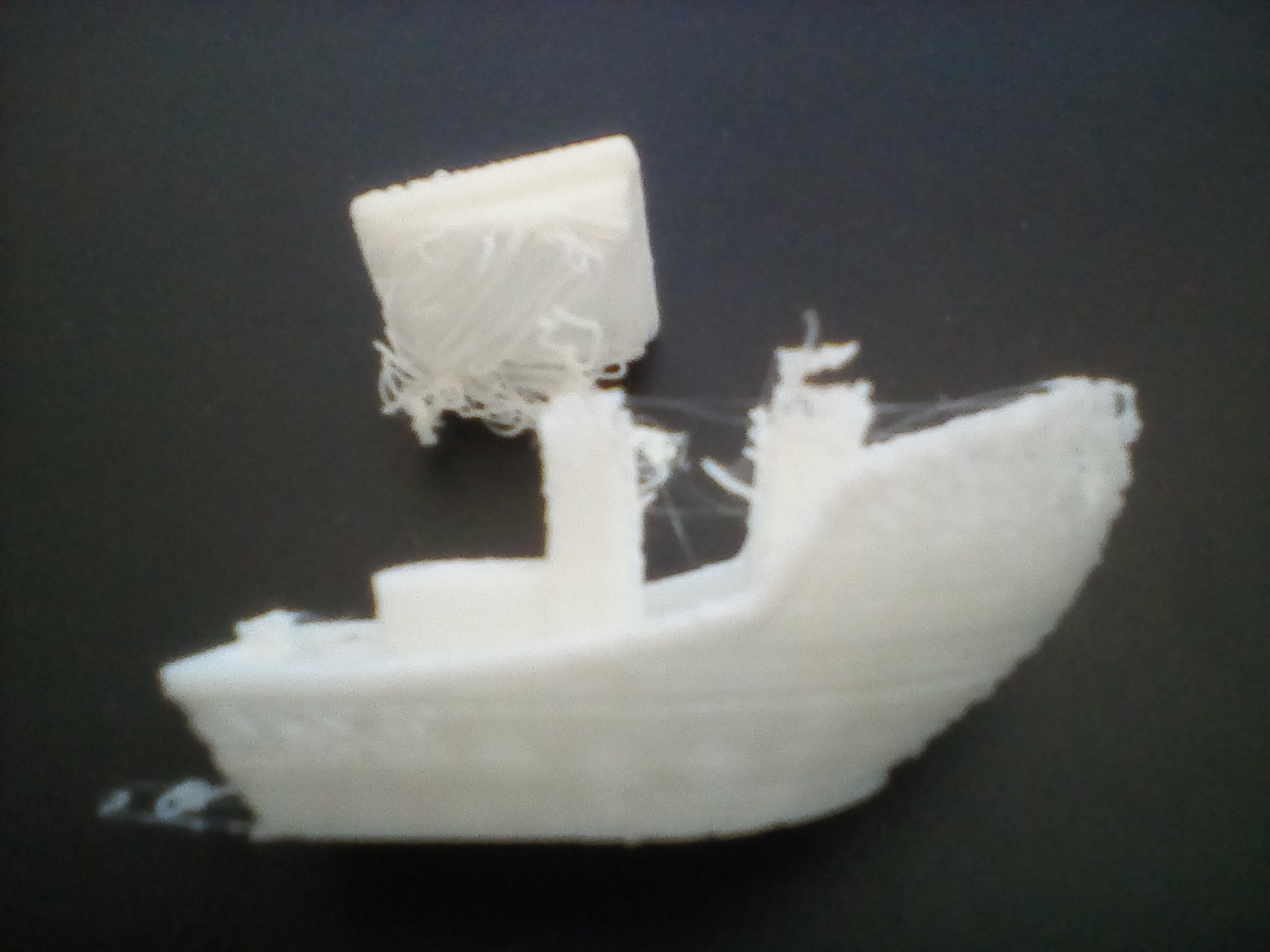

I got this:
[attachment file=53484]
As it was printing I was very pleased to see that the bow was looking pretty darn good and small details like the anchor chain ports, the ?exhaust? hole in the stern and ?fish pole holder? above it were not looking too shabby at all.
But then it came to the cabin section!
[attachment file=53485]
But here is the thing: The nonsense only starts when the nozzle has to move many and far distances without extruding - thats when the stringing starts and once it gets to the upper portion where extrusion happens at a more or less continuous and constant rate things start looking a heck of a lot better again.
And at least with the retract turned off it was not clogging.
So I think that I have either got a “made up of parts” extruder here which is not working very well or like I mentioned in a previous post, that “gear” (which is showing more than a little wear and tear) is not up to the task any more.
The cheapest option is to replace the gear and see how much difference it makes and thats what I’m doing tomorrow.
Dialing in a printer that is an unknown quantity can really be a pain and is an exercise in patience and creativity. From what I can tell from the pictures, it does look like you had a vast improvement, until it came to the point where there would have been a lot or retracts and non-print moves. I know you said you turned retraction off, but it really does look like it was retracting and then not priming sufficiently before beginning the next extrusion. In Repetier there is a setting to add a slight additional advance when it finishes the retraction move to combat this. With retraction all the way off, I would expect to see extra filament from oozing in the form of strings and little zits where it moved over a previous layer while continuing to ooze.
That said, your extruder does sound like a piece of work! For one, it is critical that you have adequate cooling on the cold end above the heat break. When the nozzle is at temperature, you should be able to touch above the heat break and feel no heat. Should be cool to the touch. If not, you need better cooling up there. Also, in a previous post you mentioned that the PTFE liner was probably cooked. Rather than decreasing friction, a bad liner will increase it and make your filament more prone to jams, especially during retract moves.
As for overall extrusion, did you accurately measure your filament diameter in several places and then input into your filament profile? That can make fine-tuning difficult or require extra multipliers to get right otherwise. Also could be an issue with steps/mm in the firmware, since this is a cobbled together printer and may not be using a standard drive gear. Optimally you should have perfect extrusion with the multiplier at 1.0 (100%). Anything else is an indicator of something not being set right.
Once you overcome the inconsistent extrusion issue, they rest should be a matter of dialing in settings.
