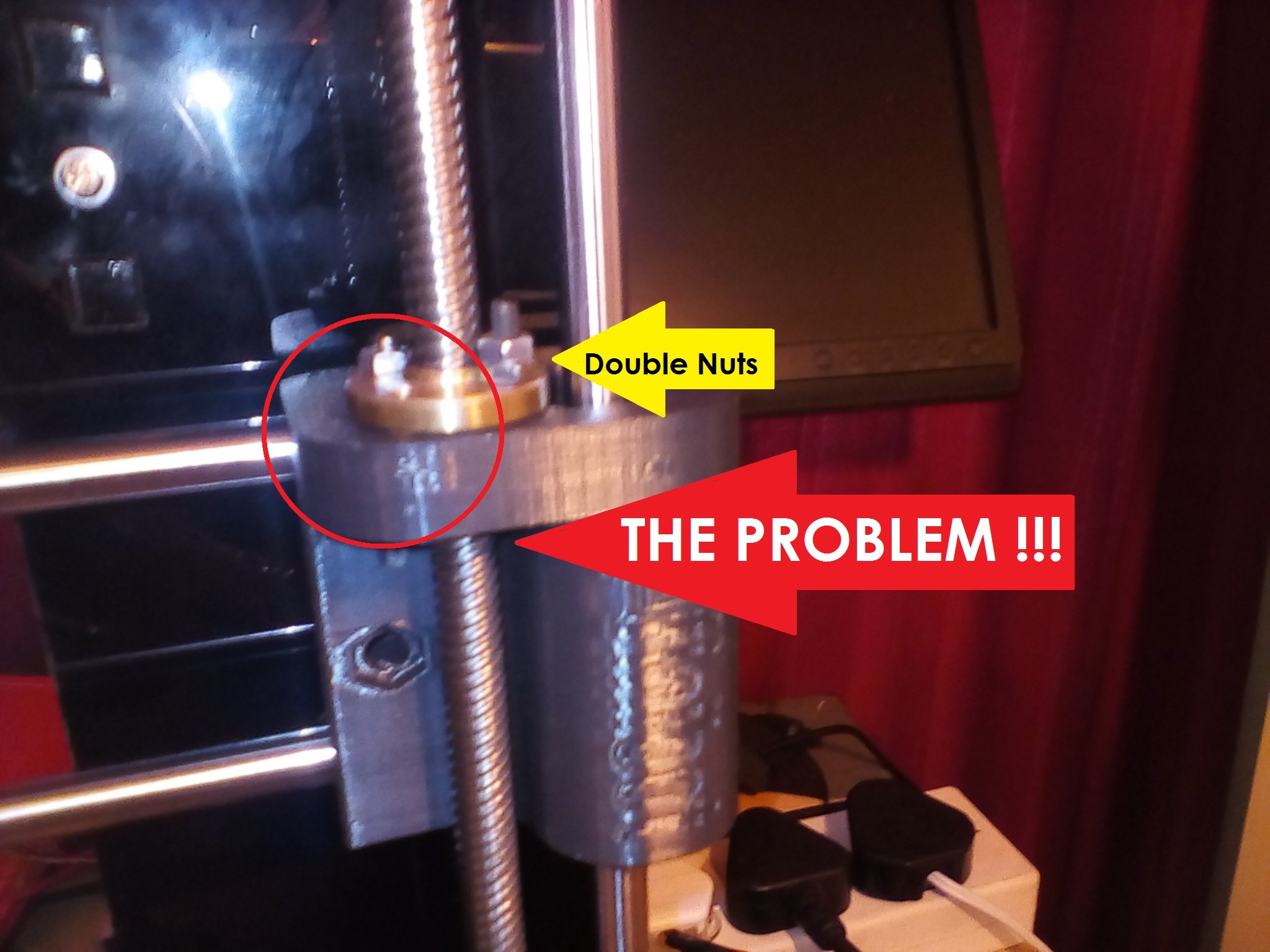

Update:

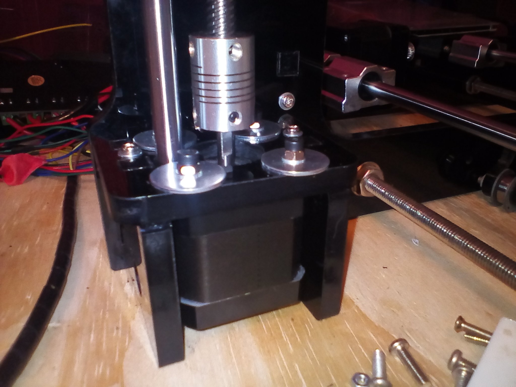

It is DEFINITELY NOT PRETTY!!! But it allows for the adjustment that is required!
[attachment file=54785]
I carved out the motor mount plate to allow almost 2mm of adjustment on the motor positioning and with some fender washers, mounted the motor.
Of course the original cap screws were not long enough to get through a washer, a fender washer, the mount plate and then thread deep enough into the motor casing.
All I had was cap screws that were WAY too long - so a couple of nuts as extra spacers had to do.
Then I ran out of nuts AND washers - go figure!!!
I test fitted the Z axis guide shafts - did the “roll on a table” test - they as well as the lead screws were also nice and straight.
So I got the left side all sorted out but on the right side I had to relieve the motor mount plate even more… Which I did.

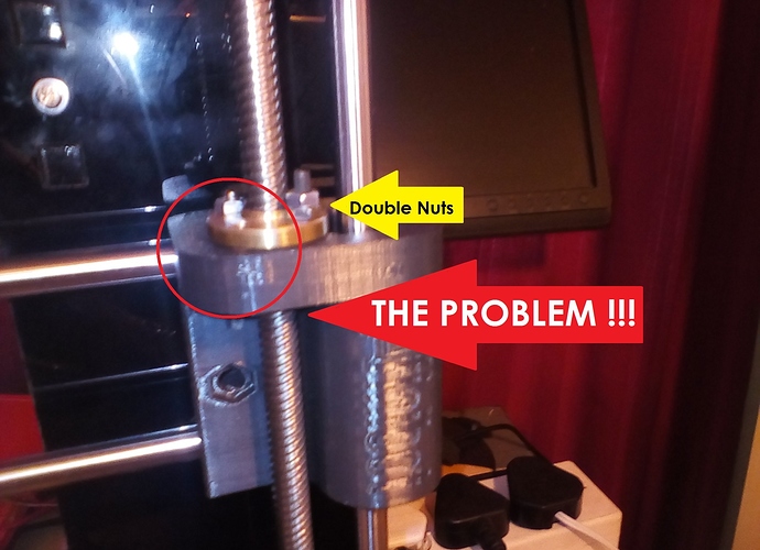

After making a cup of tea, as I walked back into the room I noticed from the angle I was looking at the machine that the lead screw was NO WHERE NEAR PARALLEL to the guide shaft!!!
While I had been sitting “up close and personal” working on her I had not noticed this.
Then when I loosened the first screw holding the nut to the printed part I noticed the nut lift ever so slightly away from the printed piece.
Grabbed a small straight-edge and had a look see and found that the area where the outer most mounting screw for the lead nut is was dropping away.
Now this surface is the one that is on the bed when the part was printed and “should” be perfectly flat and at 90 degrees to the axis of the guide shaft.
Obviously what must have happened is that this area had lost adhesion to the bed and lifted slightly which under other conditions would not have been too serious but in this case caused a major alignment issue because as you tighten down the lead screw nut, it gets forced out of alignment causing the issues being experienced.
So what to do about it?
[attachment file=54786]
Eventually I decided to NOT screw the nut tight onto the carrier but to leave a small gap and lock the nut with another nut so that nothing comes loose.
I repeated the process on the side with the fall-off, making sure that the lead screw was now parallel to the guide rod when the force was up the lead screw as it would be during operation.
And guess what? Now everything fitted nicely at the motor end of the lead screw as well.
(I remember correctly this is where I found the piece of match stick jammed in so “someone” had found this previously and done a “quick fix” which had not worked.)
The long and the short of it is that Alison is probably going to be printing herself a pair of new Z guide brackets in the near future - along with a good couple of other “bling” items like cable chains and other wire management goodies.
So basically I am stuck until I get some more cap screws of the right length. The only place you can get them from on a Sunday is RIDICULOUSLY expensive!!!
On my shopping spree last week I got a 100 meter roll of 1,5mm wire and a boatload of plugs so today its me and wired - heaven help us all…
Thanks for reading - and any advice would be appreciated.
Haha. I was going to suggest shimming it. Also grease up those screws a little. Are they moving smoothly up and down?

You can tell just by twisting it by hand. In my experience the problem with this nuts not being perpendicular is that they really stick. If you cant turn them by hand, then thats a problem.

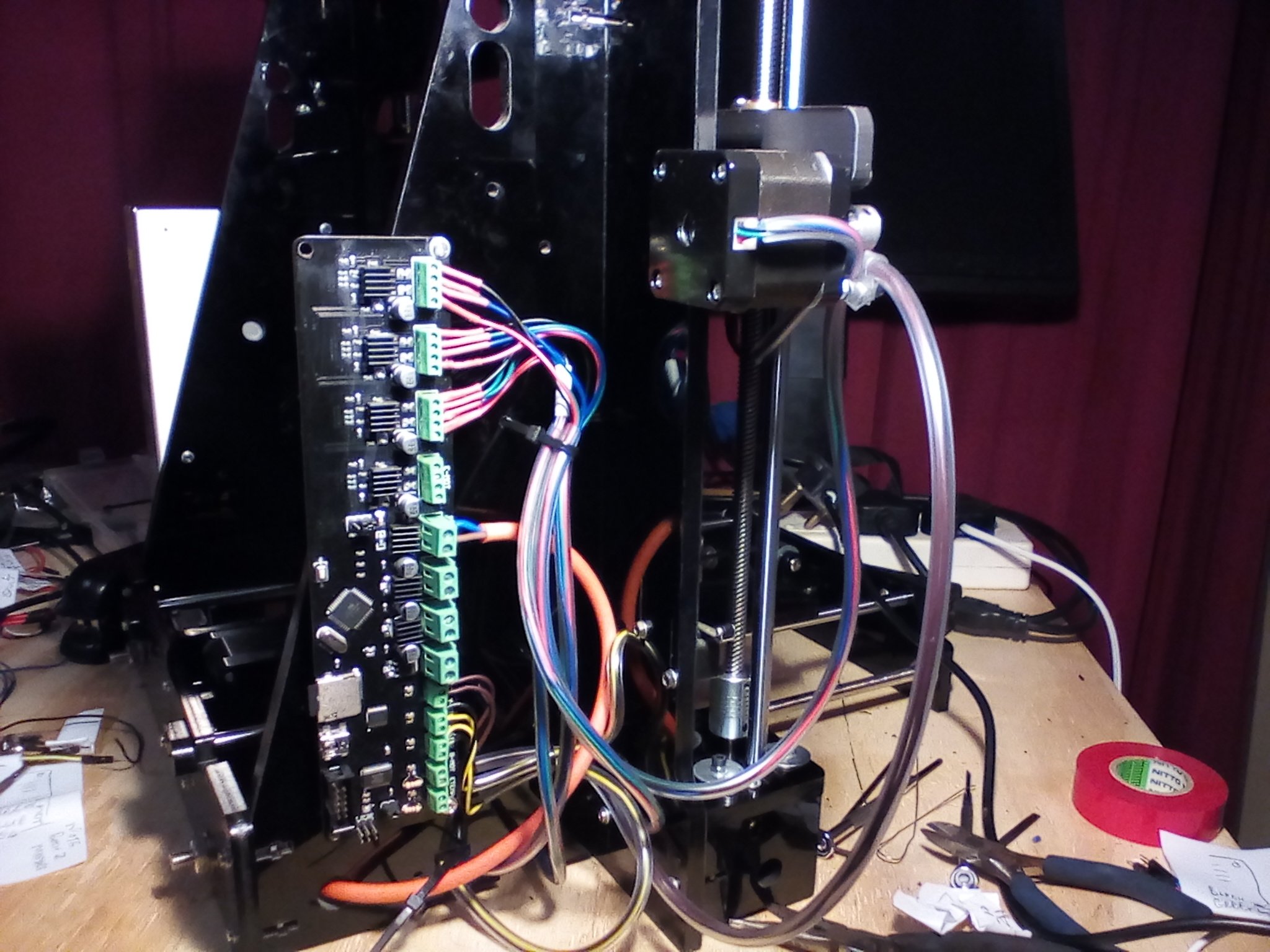

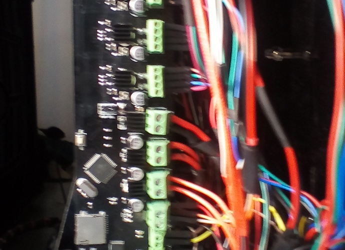

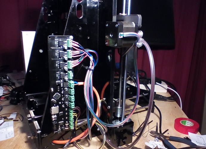

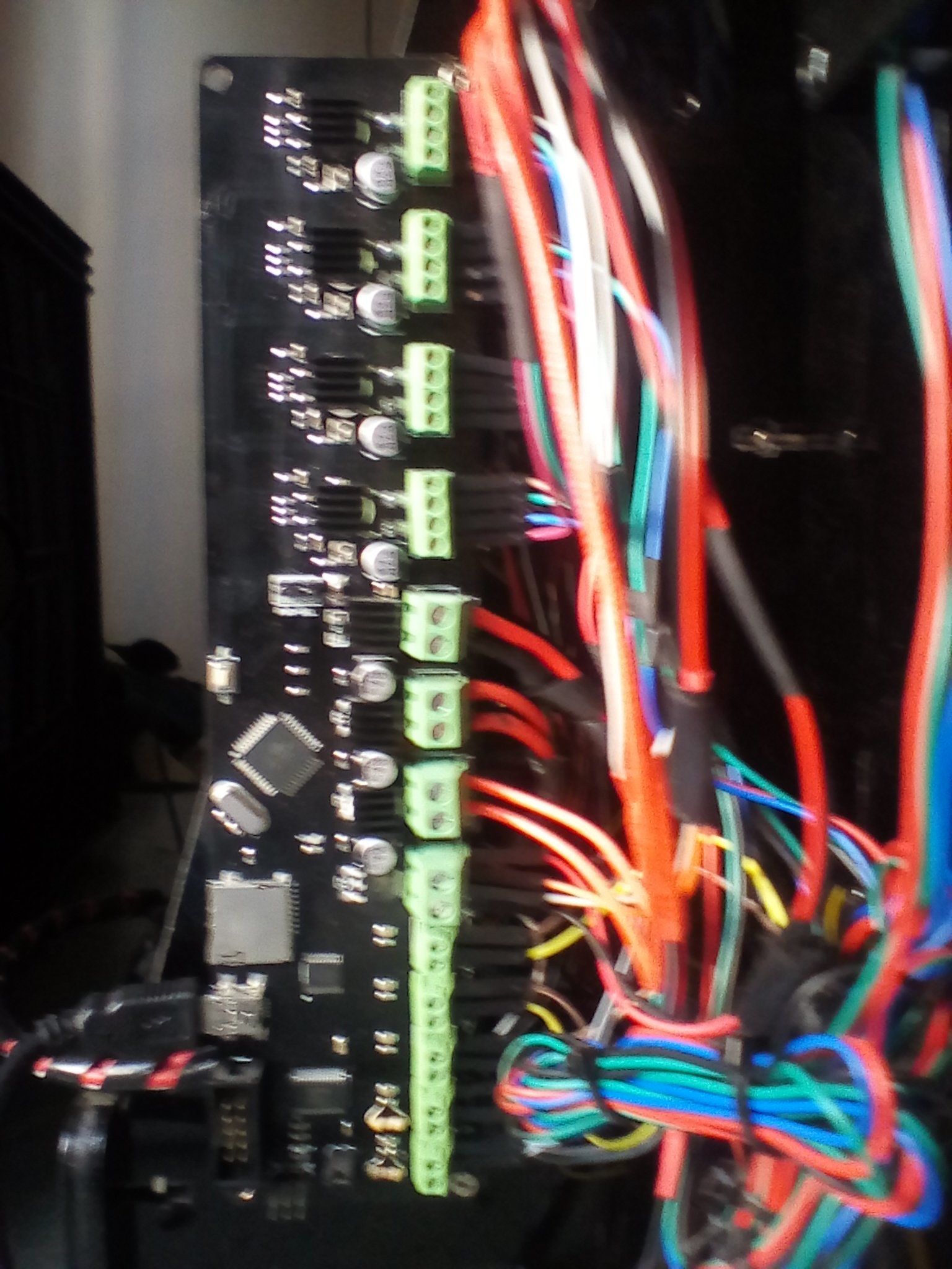

Update:
Hi All - been one of “those” weeks!!!
But Alison is together except for the extruder/slide assembly and the heated bed.
Here is a “before” of the rats nest of wires
[attachment file=55354]
And here is the “after”
[attachment file=55355]
It was a total mess - the loom had been hacked, a black wire goes into the spiral wrap that someone used to hide the bad choices in assemble and a dark purple one comes out.
The one Z axis motor has a green going in and it came out as red, the red came out as green.
What a mess.
Long story short, all my photos and wiring diagrams made before the tear down were…USELESS!!!
So all sorts of looking up on the site and here we are.
11pm local so I’m calling it a day - tomorrow she must move under her own power and then we start the final dial-in - think I should go through the software settings as well, set everything back to default and start from there.
Later everyone.
