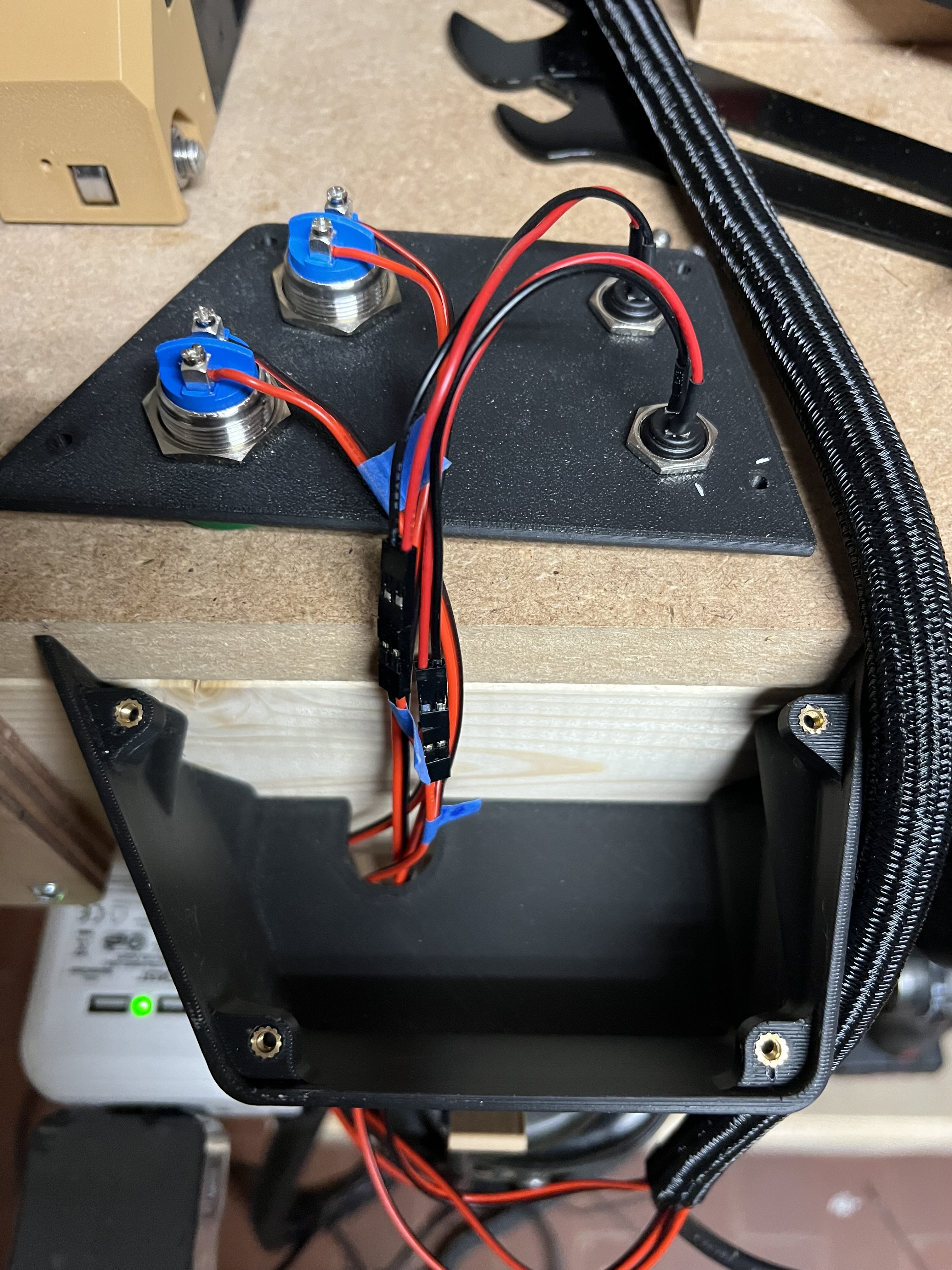

That said, I added a 4 input I/O module to the spare slot of the Jackpot Board, and modified the config file:
The macros are wrote directly inside the Config, no external .txt (pay attention, this create conflicts with V1E’s standards Macro).

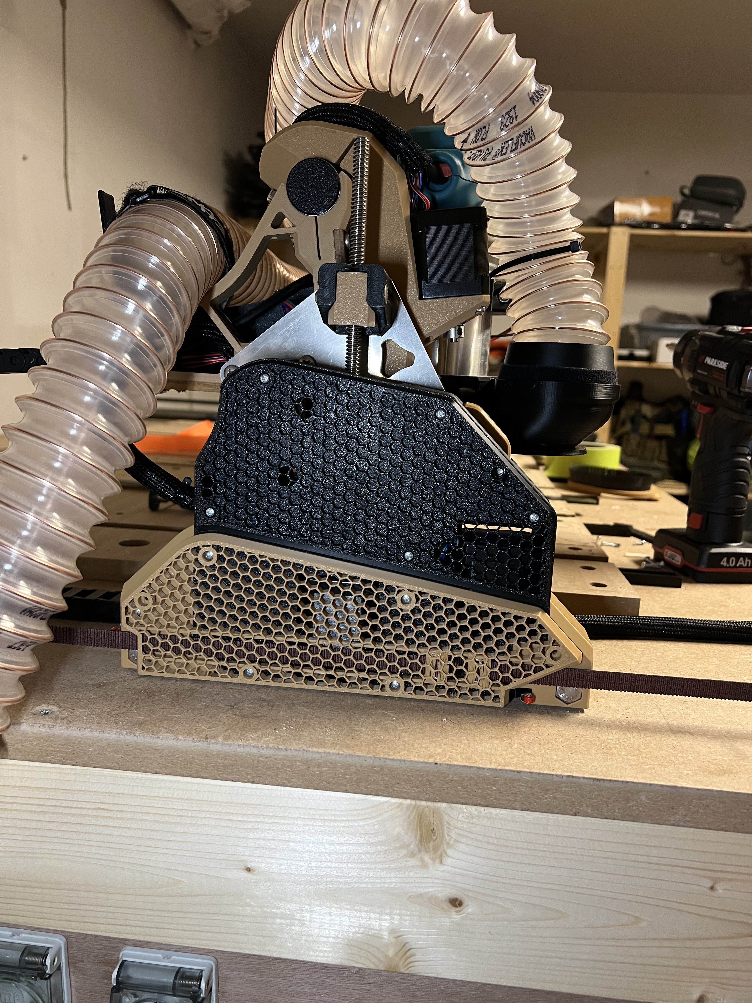

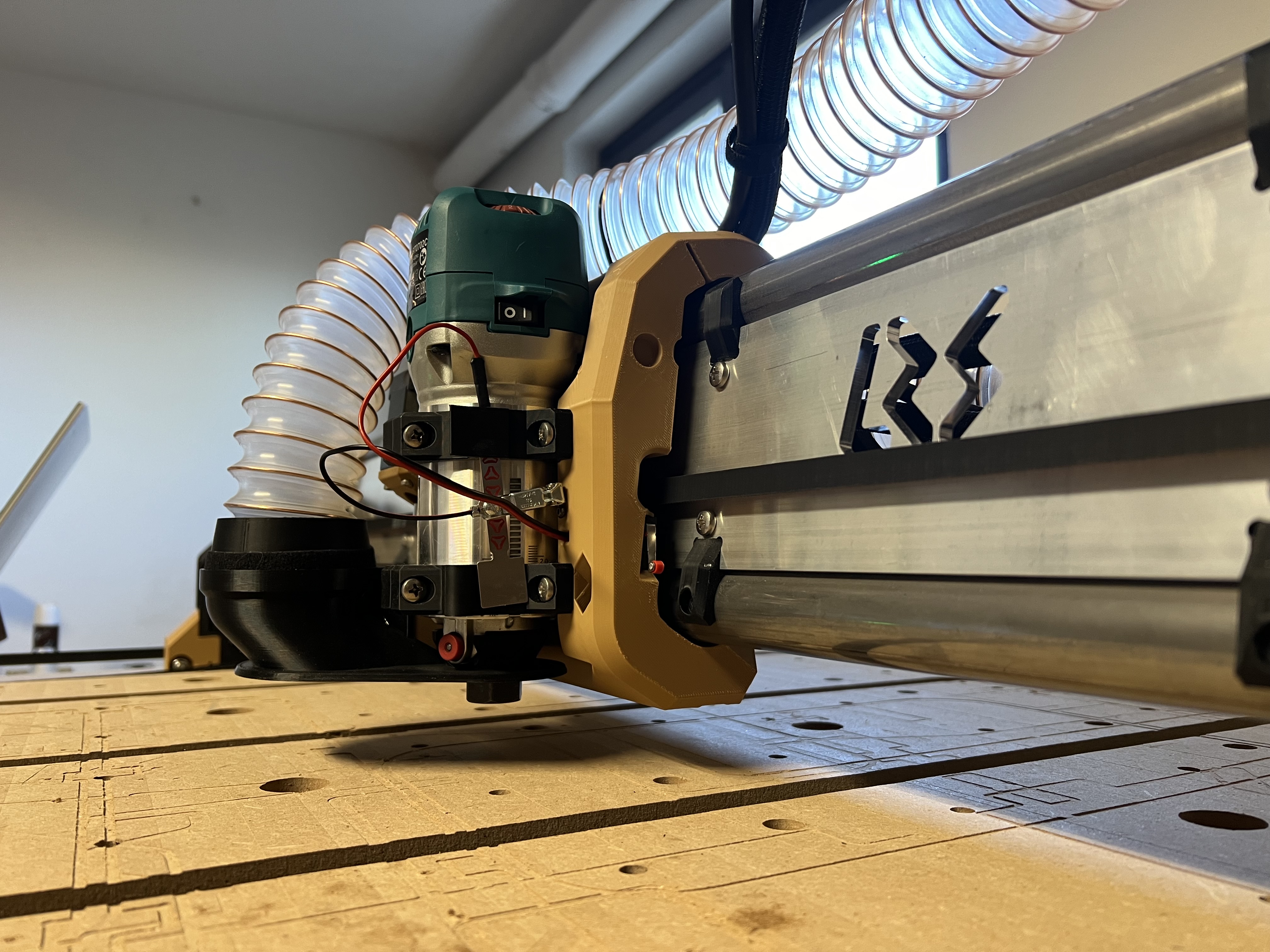

And this is the result:

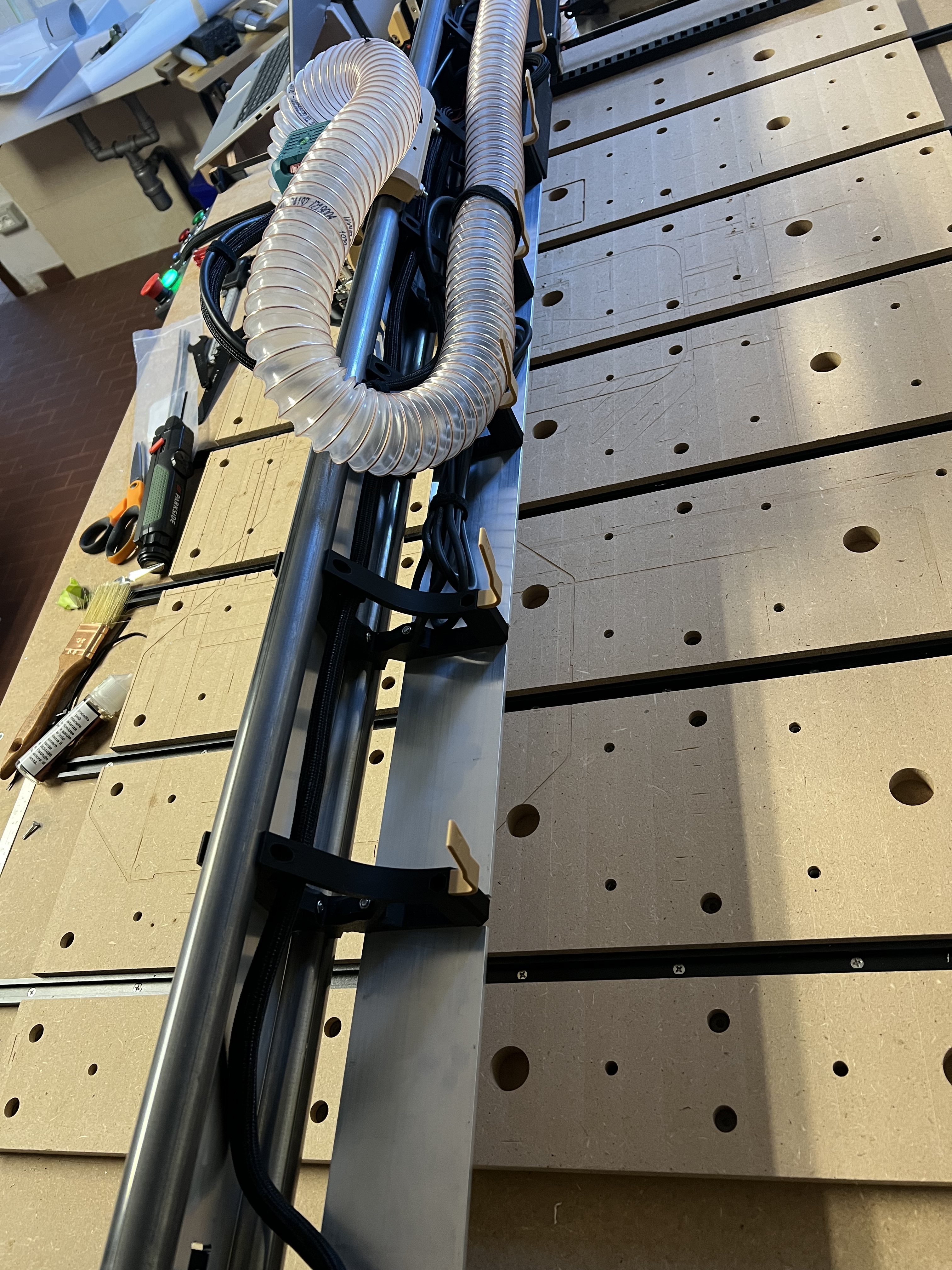

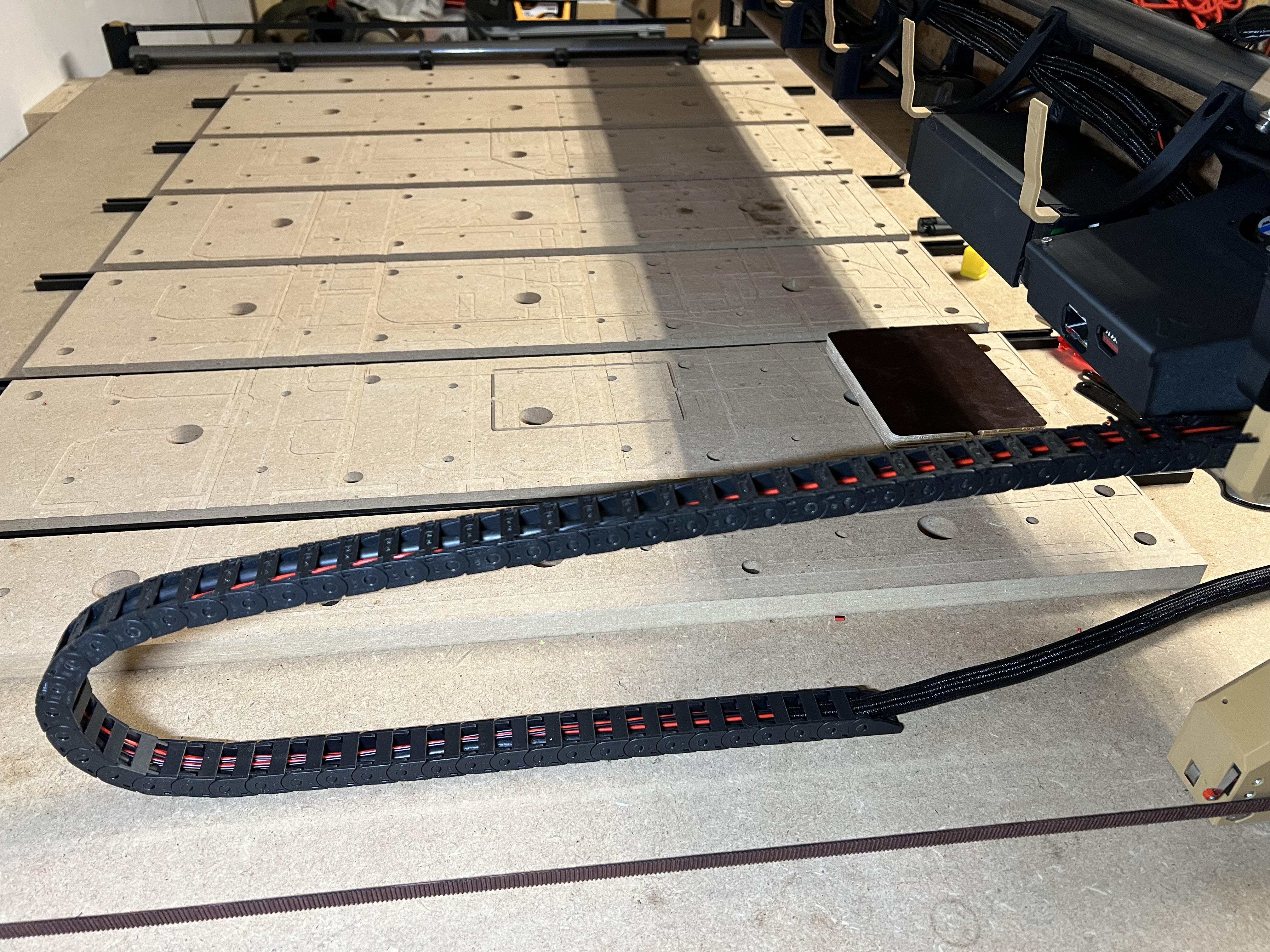

I think, except for the colors, all the builds are more or less the same, but cable management not, so this is the way I’ve done it:
