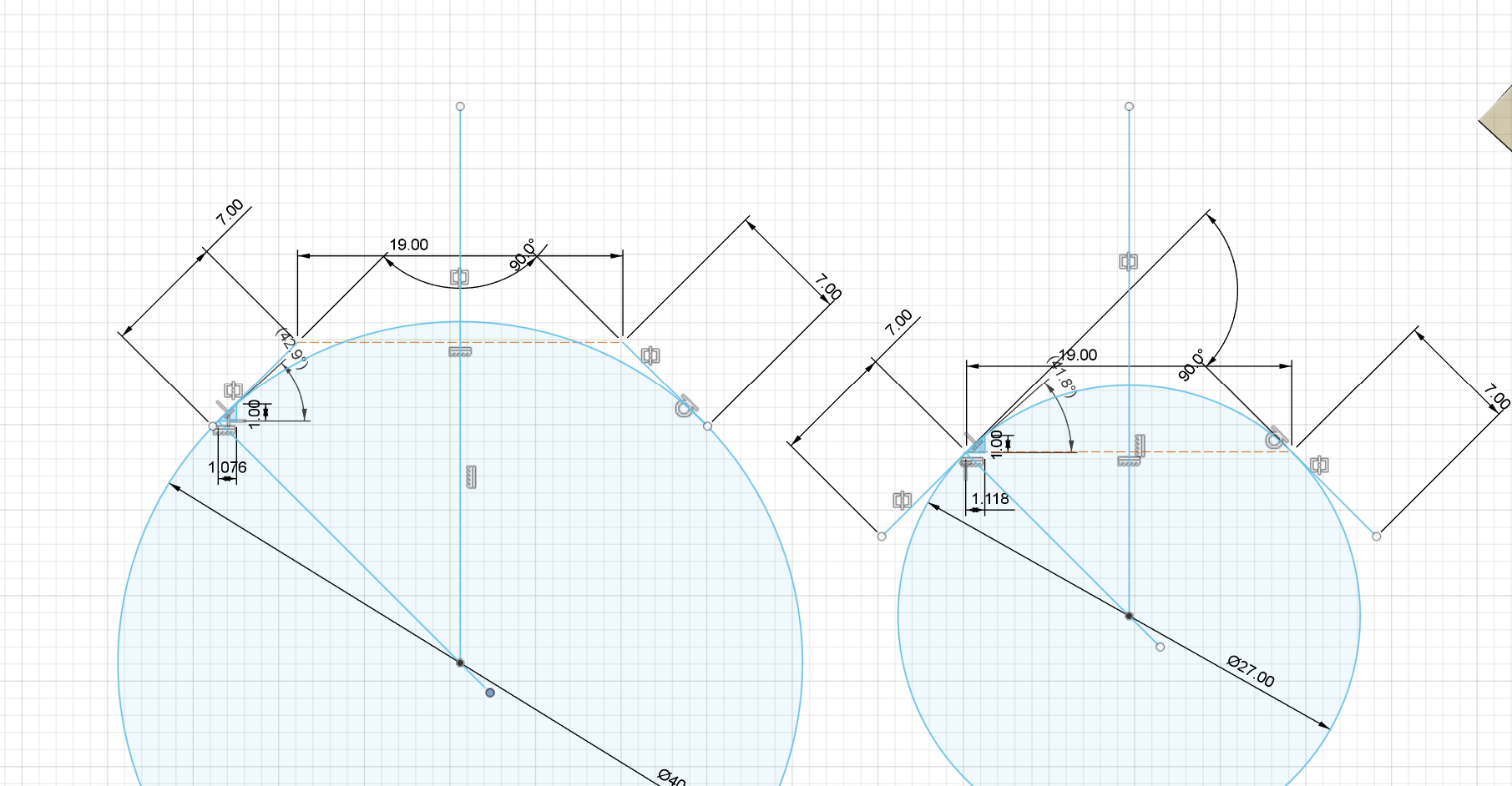

Further to my above thoughts on the y rail. I am considering going to a smaller y rail so the bearings get more leverage. Currently using 31.8mm Y rail - I suspect a 27 or 25mm Y rail would resist rotation quite a bit better.
But because of my other uses cases for this table I might just skip that mod and go the other path I’m thinking, which compromises geometry a but I think(hope?) I can make up for that by boosting rigidity significantly.

There is no rotation.

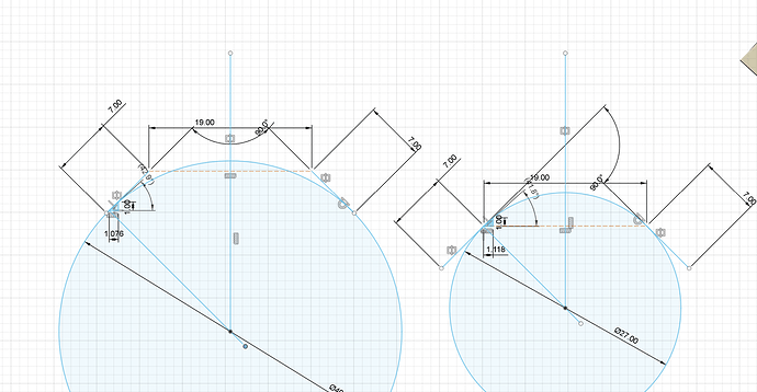

yeah so I double checked my work on this. I was aware that because the bearing angle is 90 degrees the contact point tangent is parallel to the bearing surface - so the position remains perpendicular to a line that runs through the centre of the tube. Relative angle is the same
Where I was thinking about this wrong is that under in induced torque that causes the bearing to climb up the tube - I had thought that the angle of attack for it to climb say 1mm up the tube was significantly higher with a 27.5mm tube than with a 31.8mm tube. But my intuition was wrong.
Makes sense. Thanks
here is me checking my thoughts. I was wrong :slight_smile:
good to be wrong because it means I don’t benefit from changing my tube between now more major changes I’m considering(changes that make it in to something that is no longer a nice low budget well balanced lowrider, only lowrider in lineage)

I don’t think they are actually 90, this is another place I squeezed every last bit out of it and was still able to hold the Y rail.
Doesn’t change the outcome though.
