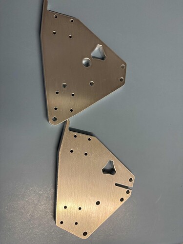

I finished my other CNC recently and was able to cut my plates out of 10mm aluminium plate. they turned out really well.
The other CNC can cut steel and aluminium with a build area of around 450x650.

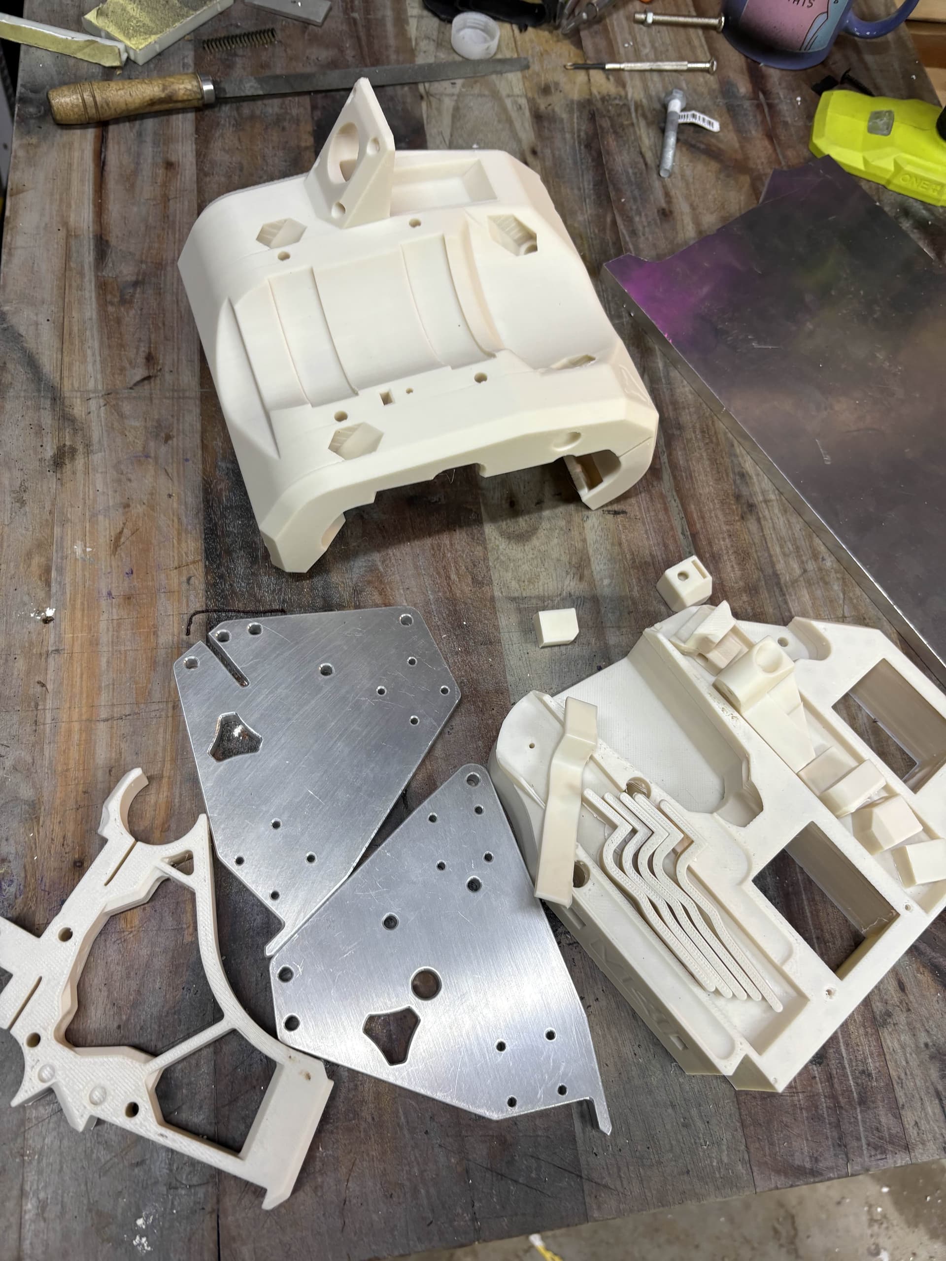

Greetings from the Sunny Coast! I love the colour as the pic shows it - is it some sort of Vanilla Off White?
Hey Peter. Great another Queenslander! It’s Overture Natural ASA ![]()
Natural ASA is pretty much my favourite filament. I know ASA is not recommended for lowrider - but I’m happy to take a chance here…
It’s got kind of a bone finish.
My experience with this specific filament is it’s very stiff and strong. Great for 3d printer parts, functional parts around the workshop etc.
Plus it’s what had on hand.
I think that is all parts printed. Temporary strut plates cut.not a lot to do before I can start building!
You should add a touch of caramel. ![]()
The build continues ![]()
it is the caramel backdrop in the photo. Nice!

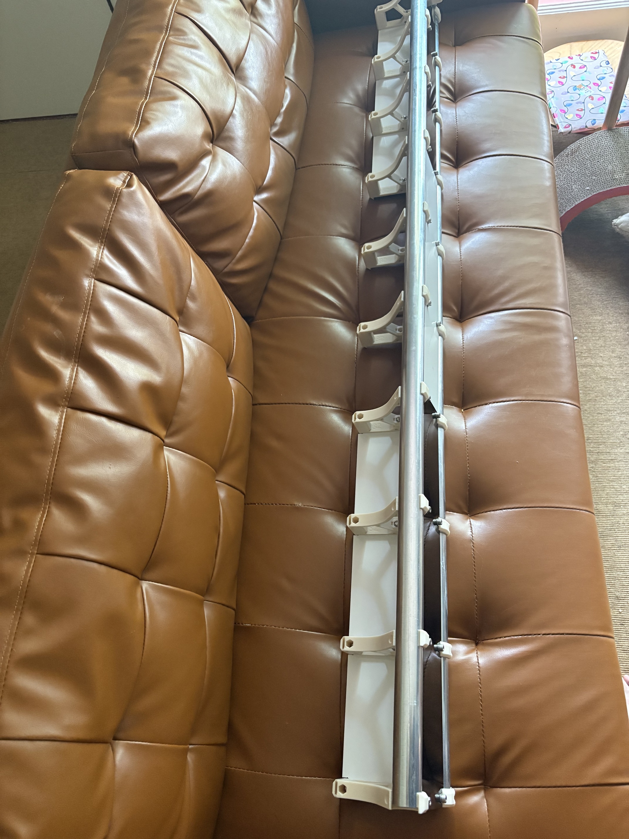

Rail length is 1500, gives me a cutting area of 1334 on x. I will be putting a VFD spindle on here long term, as I have cloned rapidchange ATC(not for sharing, I don’t want to take away from the creators by doing that). This gives me space at the side to fit the rapidchange and a full sheet.
It probably looks bigger than it is however, as I have added extra strut braces. As beam stiffness is proportional to the cube of length, and a lot of the stiffness in this design comes from the strut plates and braces, I figured extra may help compensate for the loss in stiffness from the extra length. Long term I would like to cut or reinforce the strut plates with 5mm aluminium sheet. Also I could only source 1.2mm thick tubes so every bit of extra support helps
Quite keen to see how it performs at this size ![]()
Oh and I extended z 50mm. Mainly because those were the parts the parts bin provided and modding the endstop position was easy - and in this design there is no mechanical disadvantage to having extra z - it’s only a disadvantage to cut with extra z
