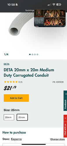

That is interesting, I really like that. What are you using for the wire tube/hose?
P.S. Make sure those two hoses are attached to the top of your core in some fashion, that will really help keep super accurate Z position.
I see Ryan asked the question i have as well. Is that plastic corrugated conduit used in homes for low voltage network cables? Good idea. It looks rigid enough to support its own weight.
Some is, some isn’t. It depends on wall thickness. Some is hard as a rock and quite rigid, others are soft and limp as wet noodles.
I used a lot of that stuff at work (fibre optic installations). Wider diameters tend to be stiffer.
It’s this product specifically https://www.bunnings.com.au/deta-20mm-x-10m-medium-duty-corrugated-conduit-20mm_p4330837
I used it in place of cable chain on my other cnc design because I was being cheap :smiley:
It is rigid fastened with some cable ties at the core, essentially to the vacuum hose which is fairly solidly in place.
I’ve been trying to think of a good spot to put a strain relief mod at the top attached to the core. Hopefully that’s good enough as is but if not so far the best idea I have is to design a piece that mounts off the same bolt as dust shoe that acts as strain relief and a guide for both pipes.
I split it down the centre with a Stanley knife, however it’s still super stiff - getting cables in and out via the split is really hard, it’s easier to just pull them through.
I think it’s the 25mm version of the product linked fyi.
