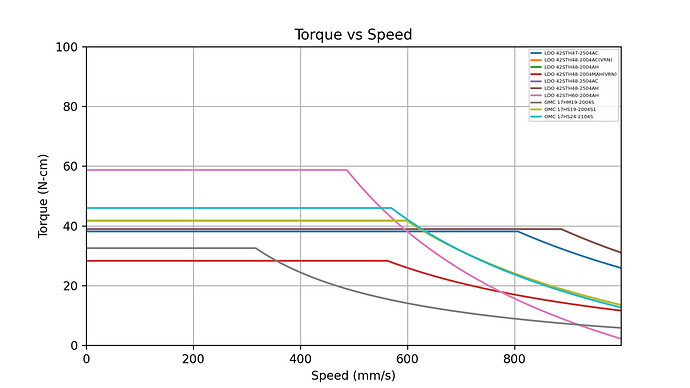

so as you can see the motors really start to get in to the less useful part of the torque curve at around 450rpm in general.
Lowrider specifies 16T pulleys, 2mm pitch - 16 * 2 * 450rpm = 14400mm/min. The system is large and heavy so with loss and reasonable accelerations I found that was more like 11000mm/min on my machine which is 183mm/s - right in line with what you were saying :slight_smile:
I have dropped my top speed to 60mm/s for(hopefully… lets test!) tradeoff of higher DOC and/or potentially better handling of wider bits.
I certainly would not suggest this for cutting thin MDF/acrylic/ACM. Nor would this be good for a plasma cutter or laser cutter. But I if you want to use larger bits or go deeper in thicker material, or do things like slab flattening with larger bits, or do a little more aluminum work I suspect the tradeoff will be worth it, especially with a higher powered spindle.
But lets take the thought process to the conclusion - if I need more speed I can
  1. reduce the reduction from 2.5:1 to 2:1 by going to a 20t pulley on the reduction gear - that gets me to about 92mm/s (11000/2=5500, 5500/60= 91.6mm.s)
  2. go to 48v - expensive option as I need the drivers(already have the supply) but looking at the graphs it hits about the same torque as it would @450rpm@24v at about 880rpm.
    So roughly: my 11000mm/min real world performance and divide by 450RPM(24v voltage useful torque), times that by 880RPM(48v voltage useful torque)=21500mm/min. with 2.5:1 reduction that’s 8600mm/min or 143mm/s - quite respectable. 2.5x the torque at 78% of the top speed.
  3. do both 48v and 2:1 reduction 21500/2 is 10750mm/min or 179mm/s - 2x the torque at just under the same top speed.

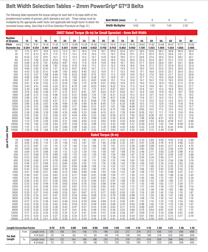

Regarding gearing and MPCNC - I think that would make sense. Smaller pulleys handle less torque - the gates manuals have some super useful tables that I have used for belt/pulley/motor matching previously. Let me track them down and will post here.

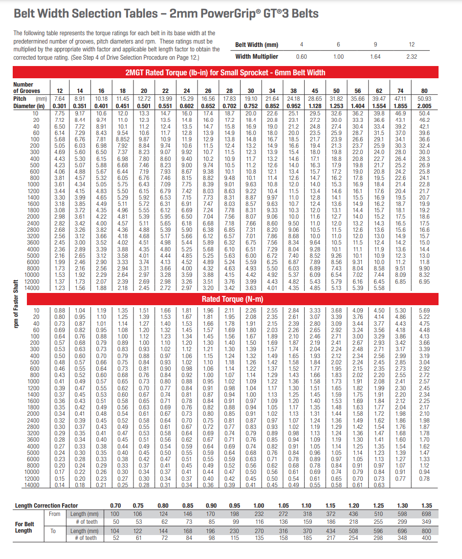

Here is the GT3 manual. GT3 belt has a lot higher torque handling than GT2 so I will need to find the right manual. Note that its an expensive option, but GT3 is one way to get more torque handling with the smaller pulleys on the MPCNC if you did have to do 12T. But the smaller pulley size is still a big loss. Probably better/cheaper to use reduction and GT2 belts - especially given how cheap some of the reduction sets are on aliexpress. It would add quite a lot to the BOM in the way of extra bearings, shafts and pulleys. Could be a good optional mod.
relevant page is page 18
this lays out the relationship between belt loop length down the bottom - length correction factor is not super relevant to open belts - or I don’t know the appropriate way to use it, so applying a safety factor for that is a good idea.
But also has the width, pulley size and RPM on torque handling.
Because stepper motors have most of their talk down low I only really look at the top line of 10RPM, though for appropriate safety factor it doesn’t hurt to do it at 500rpm where the torque drops off on the stepper motors.
This table also explains why I am happy using 6mm belts on the reduction gear, because as you can see the larger pulley can handle the torque even at smaller belt sizes.
Will find the GT2 table and post.
Really struggling to find the GT2 manual that includes 2mm pitch… I wonder if they have taken them down? I should have kept a copy.
I’m at a loss. eh regardless, the GT3 table is a useful guideline and importantly demonstrates the relationship between these factors.
Yeah it seems to have disappeared a long while ago.

1st data point is back. Mate in NZ - he is running a 3:1 variant of the above reduction(20t pulley motor side to a 60t pulley)
He is running the LDO 2504 motors at 1.8A - expensive very high speed motors(see tables above). They are running cool, unsurprising since they are designed for 1.8A RMS/2.5A peak in an enclosed printer - so they handle this in open air very well.
He is getting rapids comfortably running at 10kmm/min and just tested 10mm DOC with a 4mm compression bit at 3200mm/min in MDF on X with the 3:1 reduction - a significant improvement in viable DOC over his machine without the gear reduction.
These motors are an exceptionally good match for this setup with the reduction. In the spirit of lowriders budget approach, I don’t know, but they do show what can be done.

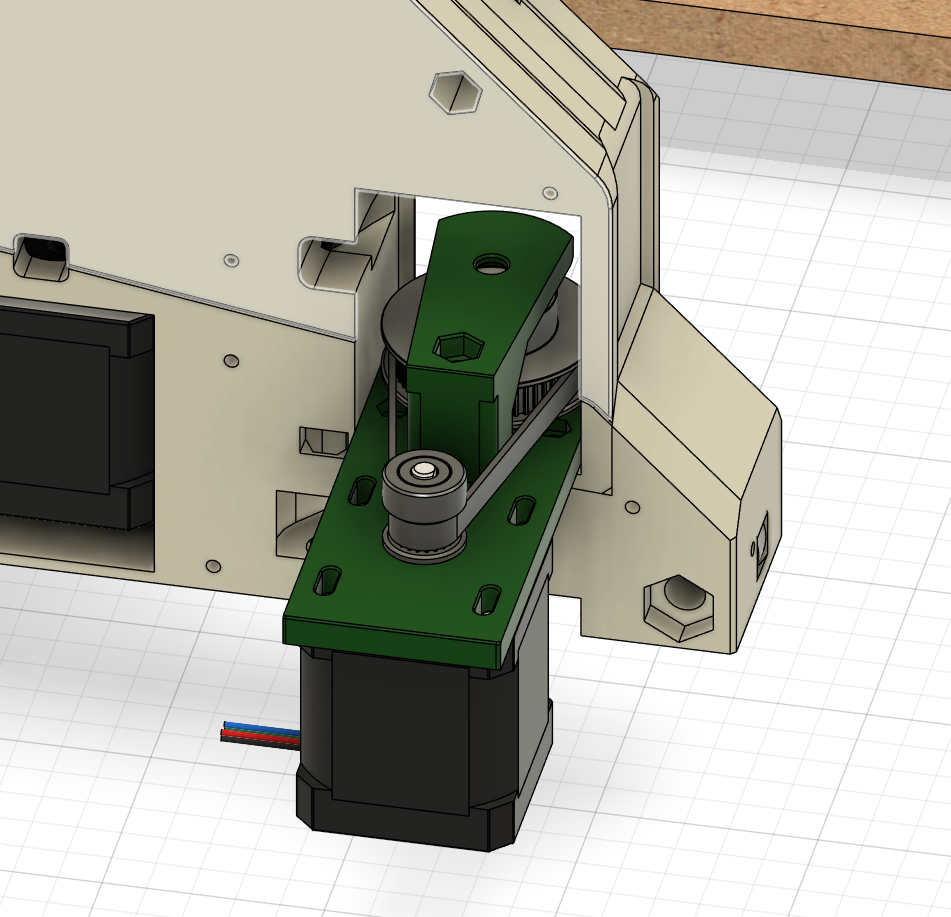

Also I started on the Y reduction CAD last night. Just didn’t have a lot of time so didn’t get it finished.
