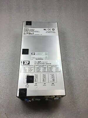

I will not be the person to suggest cheap amazing power supplies because I don’t want that on my head. I’ll be using a second hand flex power x7(industrial grade brand and model, modular supplies 5v,12v,2x 24v and 148v rails through discrete modules) got off eBay US and was cheaper for me to get two of those shipped than two meanwell 48v domestically. Not a recommendation as these are big and I’ll have to get creative with mounting to put it on the gantry. But they go for about $30US today.
So whole 2 axis upgrade for drivers, power supply and gear reduction could be had for $80usd - if you already had decent stepper motors. Not cheap enough to go in the lowrider BOM. But if we see consistent gains on multiple machines, may be a viable upgrade for those wanting to eek a bit more out of their machines
