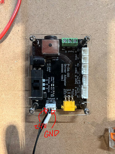

For anyone installing a Lasertree laser and using this driver board below, you can tap directly off the board for 24V to power the Jackpot etc.
No need to sling around a second power brick, it comes with plenty of overhead. Just make sure the switch is set at “EXT”.
Does it?
What are the specs on the Lasertree power supply, and what are the ratings of the driver board for output current?
I had to use a little of deduction to ensure everything is suitable.
It comes with a 24V 10A power brick, so 240W to play with. Figuring out the max input voltage on the laser is near impossible to find, but safe to say since it’s a diode laser probably a multiple of 2 to be safe at max output, so 120W input power.
The P-DA-20 also controls the 20W laser modules and can be controlled from the JST connector output A. JST 2.54mm connectors with 22g wire control 3d print heater beds to 40-60W. The driver adapter can also expect to run the air assist pump at ~23W max, which I am NOT using (more on that later).
The Jackpot 3 requires a minimum of 19W. Plenty of overhead to spare.

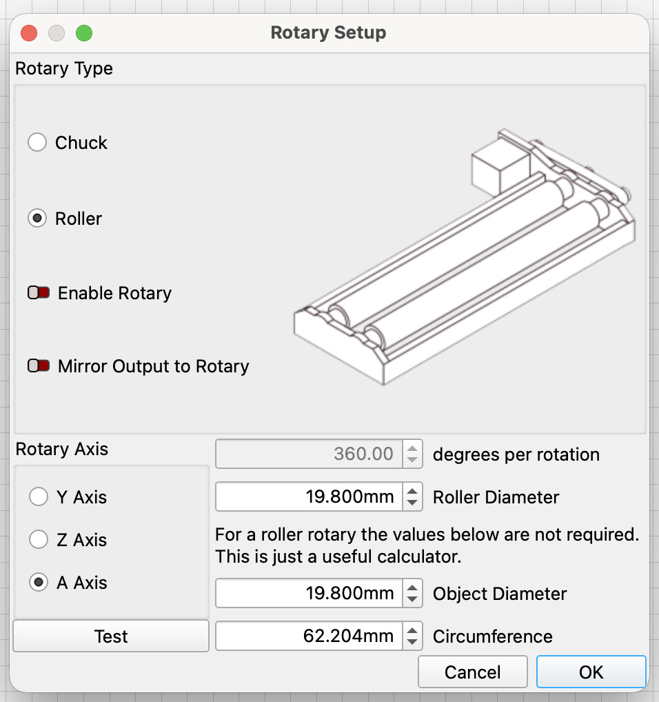

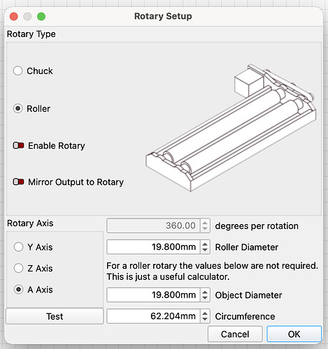

Edit 2 (Lightburn custom Gcode device):
  • Create custom G-Code device in Lightburn
    • Create new device → Create Manually → Custom GCode
    • Setup CNC as normal, rename with A Axis and Save
  • Edit Gcode commands
    • Open Device settings
    • Enable DTR mode per FluidNC
    • Edit startup and shutdown scripts from above and test
    • Edit Rapid Move and Cut Move, replace G0 [X]{x} → G0 [A]{x} ; [A]{rot} → [B]{rot} (to prevent code confusion)

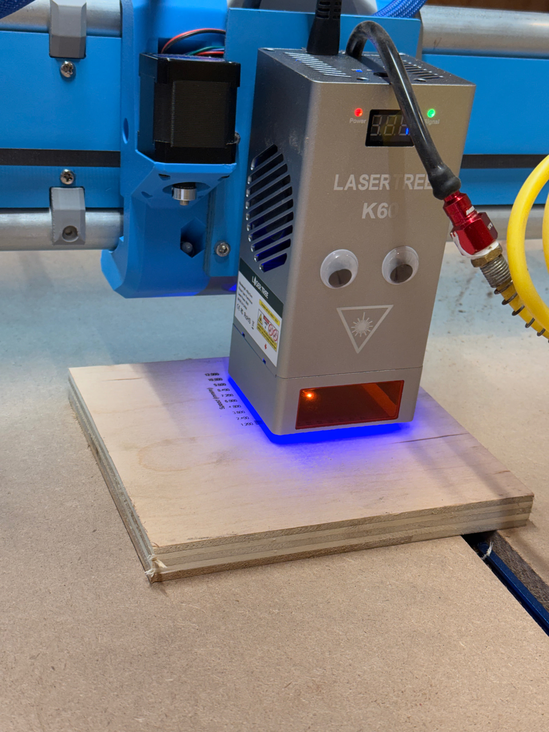

The Laser Cookie Cutter is alive!
Just finished a test engraving from Lightburn, my custom device setup worked flawlessly. After setting up the device profile I was at first skeptical because the tool movement still mapped to the X axis moving my spindle, but looking at a gcode output all X axis movements were reassigned to A.

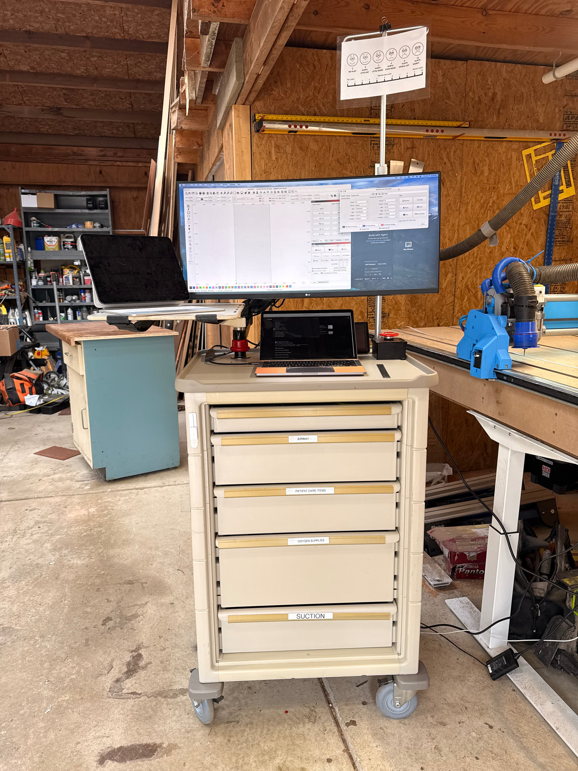

Also got this little command center from a hospital closing down the way earlier today:
Former crash carts make lovely COW’s for the table.
What started as a Cookie Monster has now turned into a 2-headed Hydra - may have to rechristen her.
Where does one buy something like that? Auctions?
I’m sure you can find medical or government auctions that have these carts. In this case, my wife works in the OR at the hospital where they built an addition to one of the hospitals and are closing and merging the other community hospital this weekend. They are getting rid of so many items for free or just telling the builders to throw it in the dumpster.

I was able to get it done using method 2 inside Lightburn. The [A]{x} substitution did the trick when it publishes out to gcode. The only hitch is the built in Lightburn controls do not remap so jogging is still X, but macros are a quick fix for that.

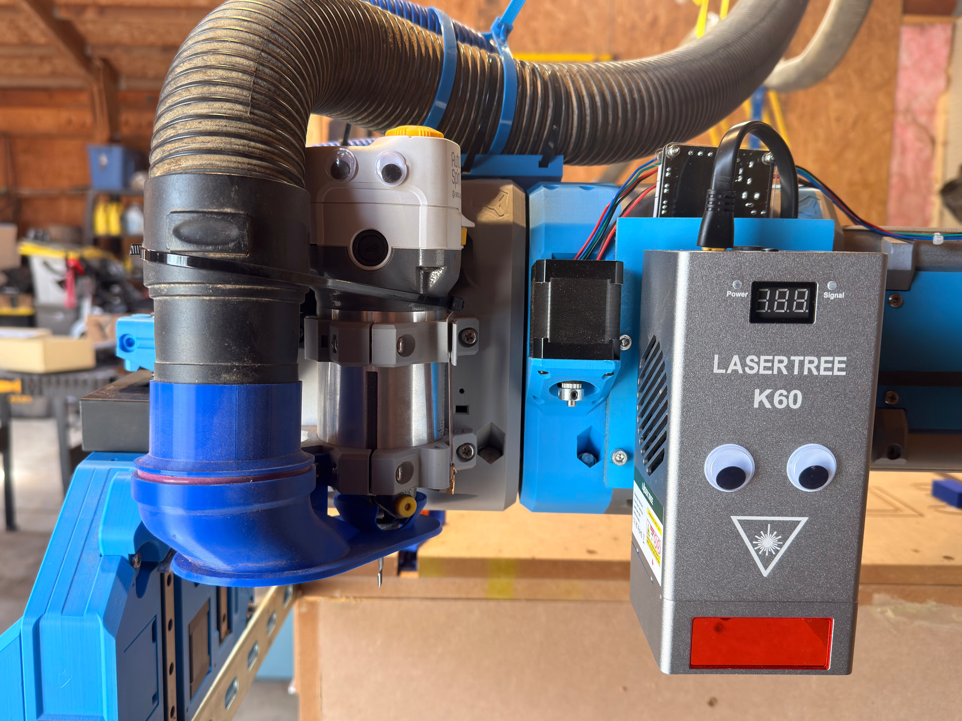

I think I am going to like this laser a lot, it’s a stout heavy thing!
Curious how you’re homing the second core, do you have X end stop on 2nd Core that touches off right side of 1st Core? Then set A axis’s (“X” equivalent) origin based on Core 1 width.
Does lightburn enable 2nd Core Jogging as easily as 1st Core? With virtual joystick like control, or do you end up with list of macros that jog A axis by some increment? [G0 A-10][G0 A-1], etc…
