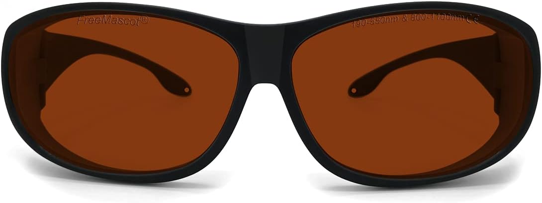

Curious what others are using since lasers can permanently damage eyesight really fast.
I couldn’t bring myself to spend $200 on certified ones so I landed here:

I went with the one LaserTree sells which look a lot like this one. Probably would be prudent to have 2 sets so I will always have a pair when I inevitably misplace one of them or have a second person in the room.

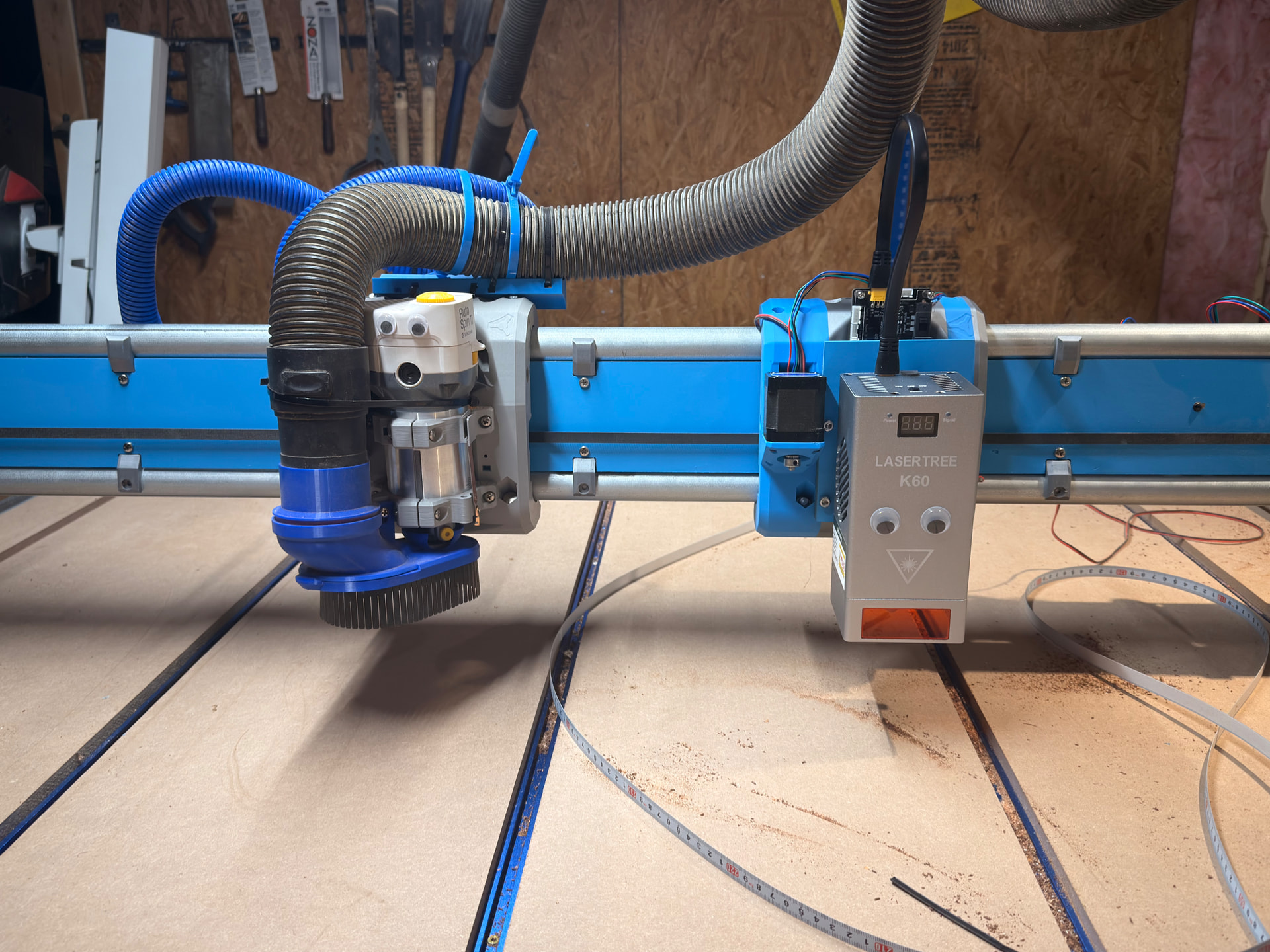

The “laser beam” has arrived and Core 2 is almost finished printing with my remnants of blue and silver, so it should have an interesting pattern….
Start doing a little assembly as hardware arrives this weekend, in between doing taxes (whoops!). Going to use @Jimbo123 board hotfix idea to mount the sliding dovetail mount, looks both sturdy and painless.
I think for now I am going to attempt a dual core setup since making an alternate table is going to take a bit of time. Plus, I am imagining the dual setup might be cool for laser engraving with router cutting. I also like the problem on figuring out this dual core setup in FluidNC/MillMage/Lightburn because I have no idea how it’s going to work yet.
Welcome the newest member of the family… now you two play nice together.
Have you decided how you’re going to home X1 and X2 now that they share a beam?
Geez, that thing is bigger than the router. Even the router is surprised.
That’s an interesting thought. You either home the laser core against the router core, or home router core at X min and the laser core at X max.
The answer is… I don’t know yet. Working on the hardware side first. I did put a limit switch on the x Max side so that is the direction I was thinking of taking.

You are correct on the axis, if I set both up on X then it will mirror each other like the ice machine carver build. I have started to write up the A axis based on the following assumptions:
Motor Driver C: uart_num: 1, addr: 3, direction_pin: I2SO.20, step_pin: I2SO.21, cs_pin: i2so.22, disable_pin: I2SO.23
Max X limit switch: GPIO 39
Max Travel: 1346mm - measured tip to tip of router (0) to laser
Soft limit minimum: 170mm
max_travel_mm: -1176 (subtracted 1346 from 170 to give max travel, negative to count down - is this right? Taking a guess here)

Can someone give me a sanity check on this before plugging in? Want to make sure I am on the right track.
Max travel needs to be a positive value.
Look at this for some more details.
I think you want to set:
  • axes/a/max_travel_mm ← total distance A can travel - this might be the 1346 but not sure I understand how you measured
  • axes/a/homing/mpos_mm ← this is the position to set to after homing, this should be max X/A value
  • axes/a/homing/positive_direction: true ← this needs set to true to home to the right instead of the left
Thanks for the help, I think I understand now.
So max_travel_mm is literally how far it can travel, and it smart enough to spool out in the direction of positive_direction notation. So my 1176mm number was correct, just remove the negative sign since it understands intent.
1346mm is the theoretical total distance of the gantry if there was only one core. My 1176mm number came from the total distance in mm the laser can travel from 1346mm before running into the spindle core. The 170mm difference is the space between laser and spindle when they are at their safe closest position.
I updated the code to remove the sign since I had mpos and positive_direction correct and uploaded. Tried to do a homing procedure with my hand hovering over the e-stop, but everything traveled the way it should first time - wasn’t even reversed. The positive X limit switch worked as intended and pulled off correctly. Now I can move motor (A) to manual coordinates without issue.
