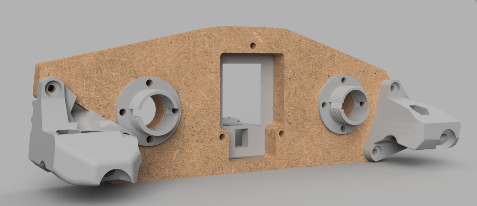

Okay, so here is another idea, what if I put a second core on gantry?
I built the gantry by just cutting a 10’ conduit in half so I have essentially 60” of total gantry, minus 6.5” for the core with the collet approximately in the middle of that. If I put a second core on the far side that would put me in the 46”-47” of actual cutting space by my fast calculations, right?
If that is the case, that would still give me the ability to cut full sheets minus ~1” which I could consider a border and I would deem an acceptable compromise. Has anyone done such a thing - is it preposterous?

I am starting to like the idea of a second core more and more, especially if I can use them independently using the additional motor connection and place a second x-min switch in to monitor. Would also be a good puzzle project to set up the config as well - one I have no idea of beyond a hypothetical concept that it should work.
I know step files are limited due to really good reasons, but is there one available for the core? The LaserTree has a mounting plate and all it would need is a flat front parallel to the z plane with the correct mounting holes.
Putting another “fixed z lowrider” on the same table is actually the option I’m leaning on right now

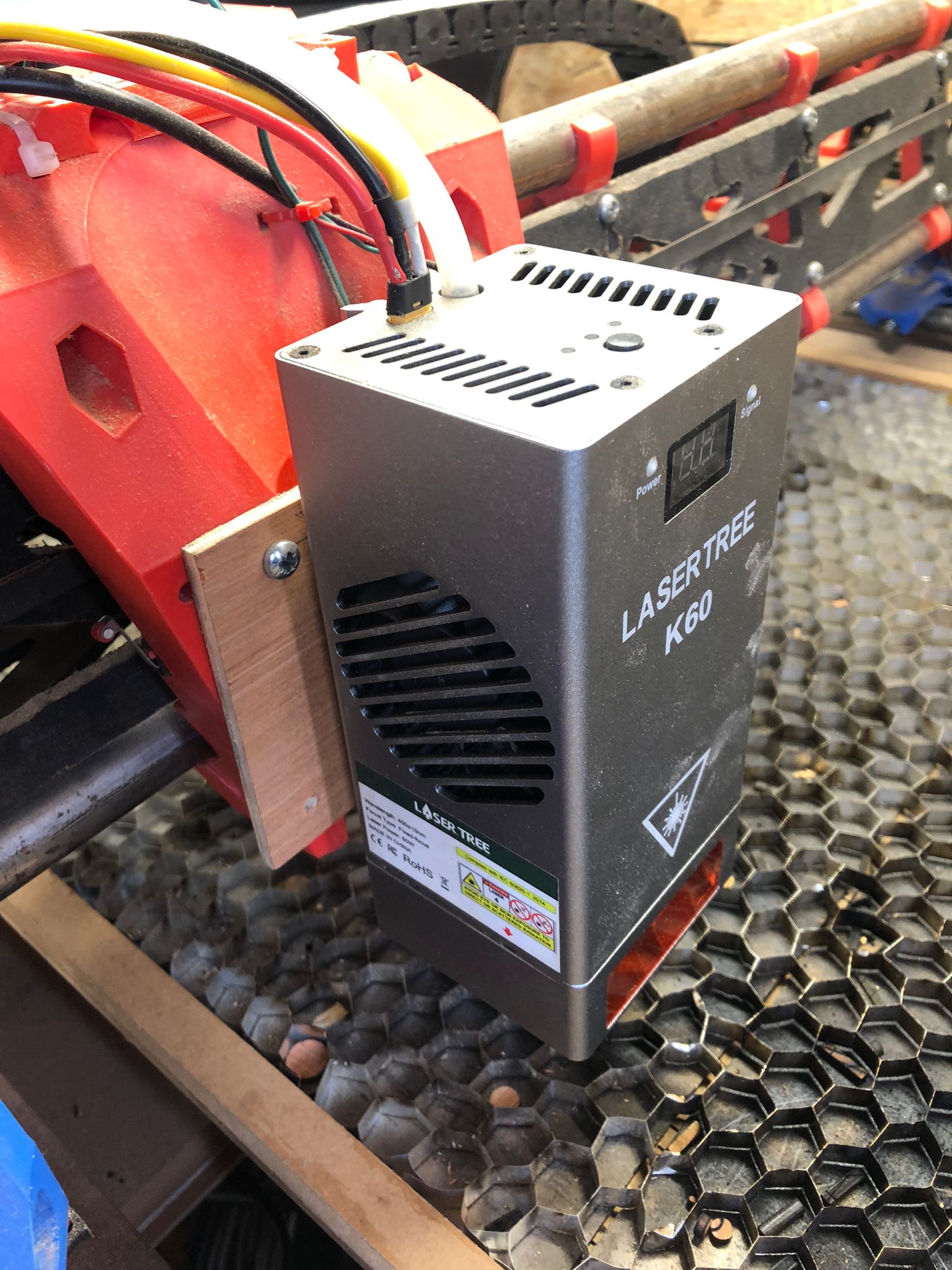

Hey Ty, I have a K60 mounted on an LR3. I laser cut a ply mount the with a K20 on the MPCNC before I retired it and built the LR4. So now I have a K60 mounted on a 2x4 LR3 and router on a 2x4 LR4. I briefly tried a 3d printed plate but found it too wobbly because of the weight of the module which was more to do with my rushing it but I think it could be done. But for me 6mm ply is fine but hardboard or MDF would’ve done. Just had to watch out for the weird shape of the core I think it has a notch in the bottom right; the plate is not entirely square. I got a hold of this sort of black plastic shower curtain type material to drop from the roof of my workshop as its not very high and have a wall mounted extractor inside the fabric booth that creates. I use glasses anyway so its just secondary. Smoke is not an issue. I hardly ever use it at 60w, almost always at 40w. I forgot to switch it back to 40w or 20w a few times and it scared the daylights out of me.
Thanks Jim, that is really interesting, how do you like the laser? Also, do you have any pictures of the mount? I imagine you would have just used the router bolt pattern to attach it, but having a hard time thinking exactly you did that.

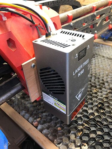

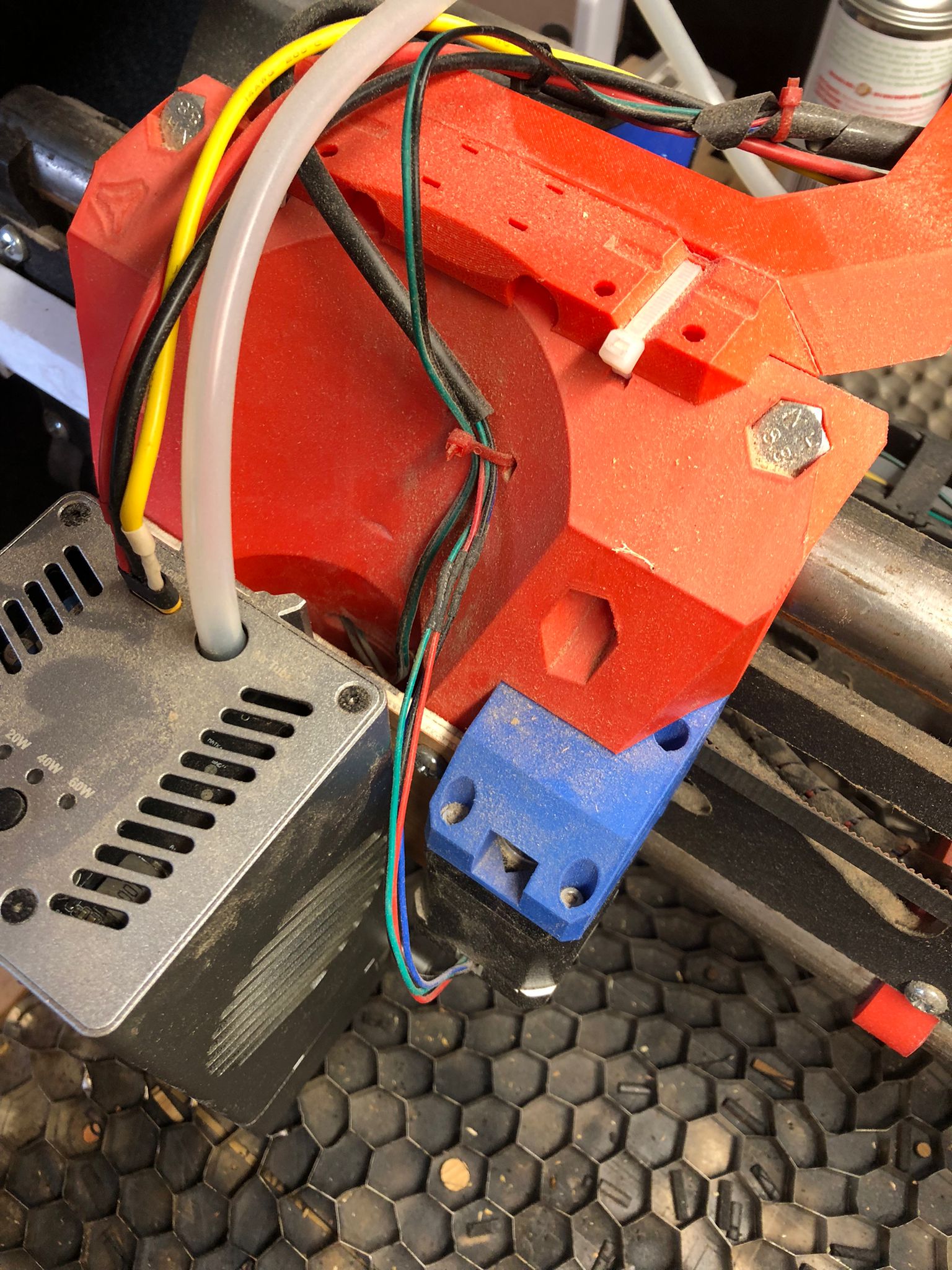

See photos re: mount Ive been though that many iterations I dont honestly fully remember but I must’ve cut it by hand after using and/or making digital rough versions. I slightly remember using the templates but where that led who knows. The notch to watch out for using this method is top right and therefore is not a square piece of wood.
As far as using the K60, Ive had great after sales (not that ive needed them much) with laser tree and moved up through the models through the years starting with a 5w laser on up to the k60. They’ve replaced lens that were damaged in transit and various other things. The one thing I would avoid is their Facebook channel the “fanboys” on there take things a little too seriously and wont see their good name shamed in anyway. Ive asked simple questions and got ridiculed and it could’ve been handled a little more sensitively lets say instead of always getting “its not the laser” answer. In use the K60 is a beast, Ive even seen it referred to as that elsewhere, the 60w Ive found frightening, especially when you are cutting something that only needs 20w or 40w and you forget to hit the button on top. That said I mistakenly had it set a 60w for a test at 40w on 9 or 12mm OSB and it laughed at the stuff, the cleanest cut and at reasonable speed as far as I remember.
And lastly something to watch out for; Im very lucky to have a K60 at all but make sure that when and if you extend the power cabling to the module that you are sensitive to the current needs of the module as I used the K20 cabling and upon first use the K60 drew too much current and burned through the cabling and Im lucky I hit the power off switch first and got it on time otherwise Id have been without K60. Ive heard a few folks making the same mistake and well it ending up worse for them. keep the questions coming, enjoy.
