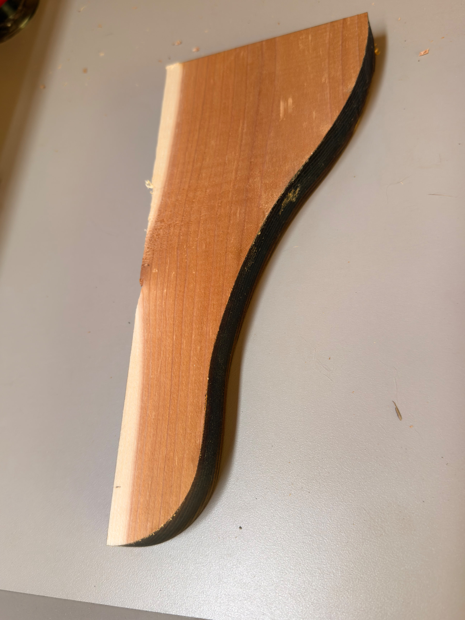

After getting frustrated with that, I went to the laser to make a birthday present this past weekend. So far engraving with the laser has been flawless so I wanted to try to cut with it. With some spare 3/4” cedar cutoffs I went for some trials, and it was getting fiddly to start the laser. Checked the PWM wire from GPIO 27, touched it while doing a pattern test and it fired right up, okay loose connection. Probed and locked everything down, same issue. Got it working one more time and it finished the project. Then same issue, now no amount of fuss would get the laser to light up.

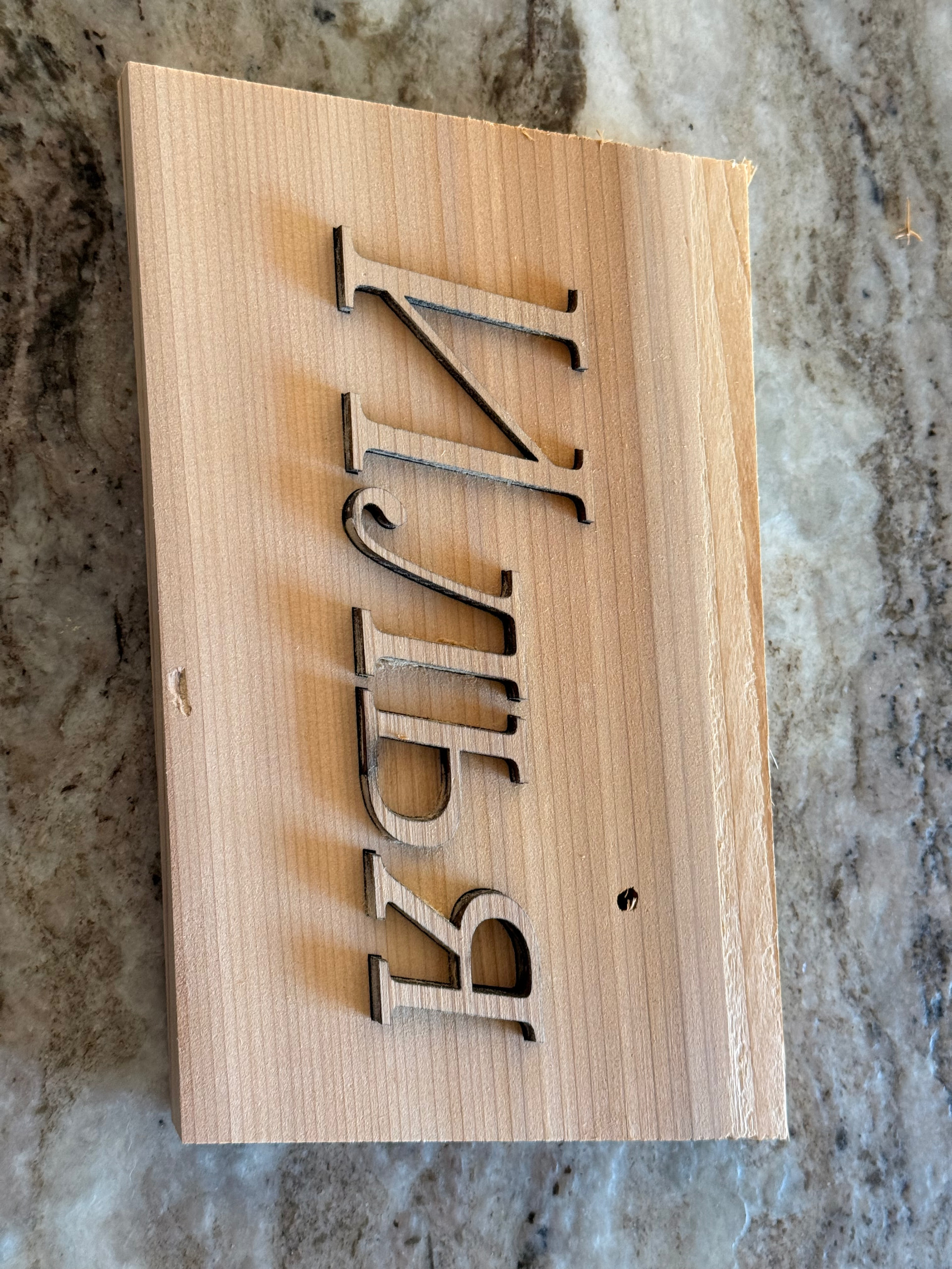

Moved to GPIO 26, and after getting the config straight it started working again. And boy does it cut cleanly through western red cedar:
Cut so cleanly I was able to pop the letters out and keep them there by friction alone, really opens up some possibilities. Single pass, 130mm/min, 50% power on 60w setting. Eyeballed the focal distance, used the bad of an old trailer for a honeycomb, clean cut, no back burn at all.
Today I tried again on a test piece from my Adirondack chair build. Getting the non-power issue. On the Lightburn settings I noticed the cutting settings didn’t have constant power mode on. Selected that, did a soft reboot and went right on. Cut at least as fast as the router would have (but again having issues cutting on that).
Straight off the table, no post processing/sanding/etc.

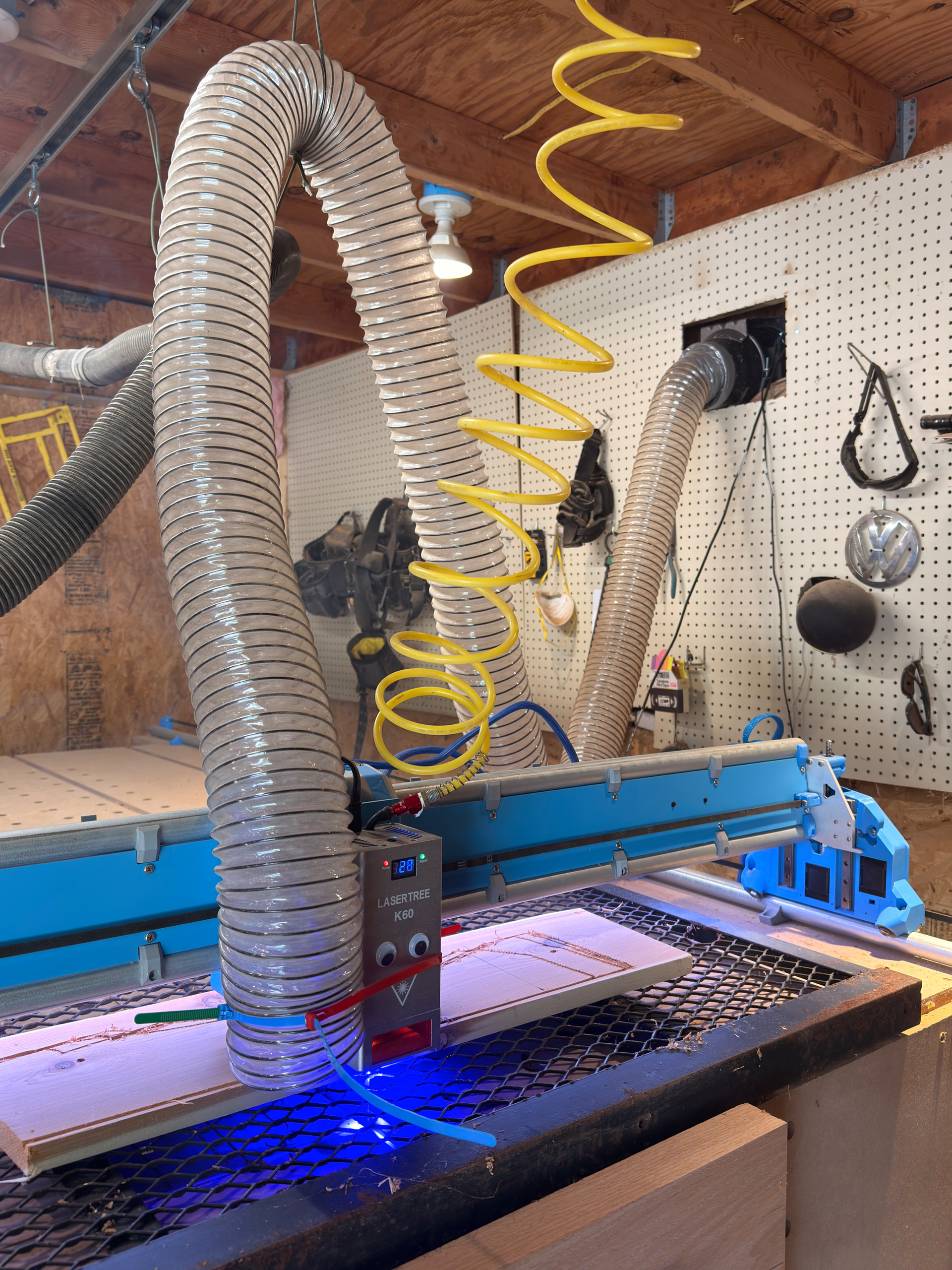

Trialing my smoke extraction prototype, first attempt got ~50-60% of the smoke out. Will have to 3d print a vacuum attachment that would wrap around the laser unit to get a higher extraction rate. Overall, in a large open bay with doors open it was acceptable but I think I can do better.
A too long 4” powertec hose “mounted” (duck-taped) to a 6” AC Infinity ducted fan to the outside. This haphazard setup has no right to cut this well.
I don’t know that i like this setup. I see so many things that should be different.
