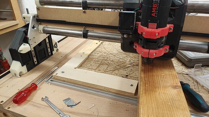

All steppers connected, gantry done. Next: zip ties and Y belt holders. :slightly_smiling_face:
I like the precision z spacer blocks.

O.k., O.k., I must have missed the thread where you explain your controller! Is that a bart Controller, or what?? Did you make your own? Is that an Esp and an Arduino together? Alot to process there.
Or and nice enclosure!
No, I am using the OpenCNCShield 2, a German controller where you can swap the control module (or even have two installed you can switch with a button), for instance I could be running Estlcam as a controller (and I really, really like Estlcam as the controller. The only drawback is that you can only square three motors, the OCS2 works around it with an ESP32 that does the squaring) and Fluid side by side and switch on the fly. But I really like Estlcam. :smiley: He now also has a smaller version that has the ESP32 included in the board itself and less in/outputs, but you don’t need all of them anyway, pretty dope.

~105mm clearance with flipped endstops. Pretty neat. :heart_eyes:
Build is done now, cables don’t look too nice but are out of the way:
