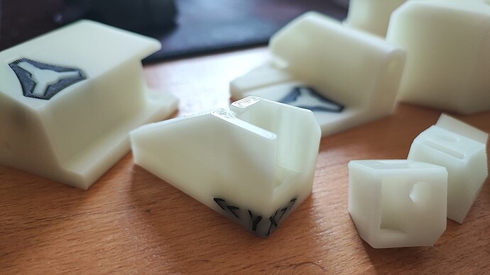

Those parts look awesome, I really like them.
Last brace also done, now I need some time for the aluminium… Hmpf.
You are switching filament manually? Or you have the MMU?
MMU. Those are 90 tool changes, not doing those manually. :sweat_smile:
If I am not mad at Prusa for still not officially supporting 0.6mm nozzles for the MK4 with the MMU, I am pretty happy with it still.

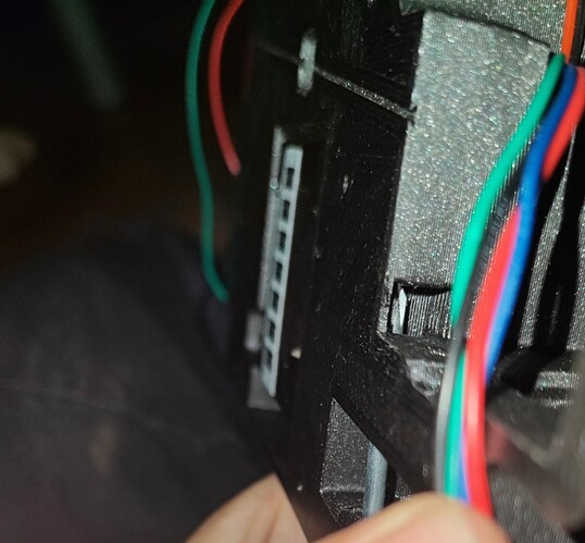

@azab2c This is my way of dealing with the nut. Slide it in, then stick a small screwdriver in the hole, lastly push the nut down with a flat screwdriver.

Plates done. The new Z endstops drove me crazy, but I am pretty sure that I am never going to do those again. :sweat_smile:

I may or may not have slightly chipped a front tooth biting on the brass nut in frustration, trying to make it fit… not going to tell my wife… :sweat_smile: Haven’t been at the dentist for at least ten years… Might go now. :smiley:
I am also still impressed that the tiny little Z-stub nut holder is holding the 10kgs the gantry has…
