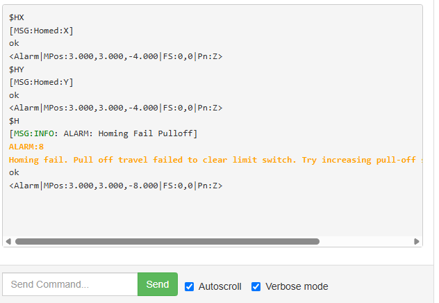

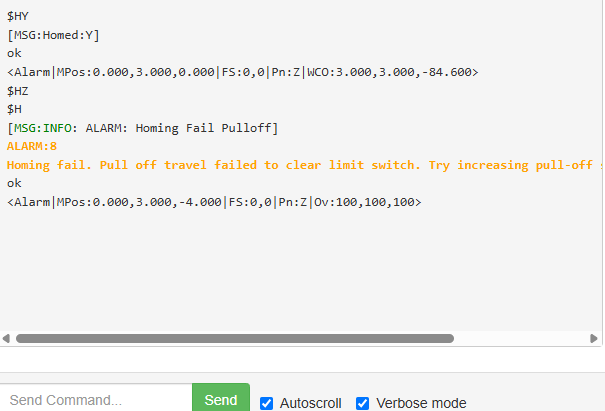

Have a slight Problem. Was trying to flatten my spoil board using the G-Code Test Pattern Generator. Was doing its second pass and started skipping. Which got it out of track. Think it got to big of a bite. So I canceled the Job. When I homed it, it
alerted me. I was able to home X and Y using separate buttons. When I home Z with separate home button it starts to run down towards the table about 2 inches then flags alarm. It should be going in the up direction. I will attach the msg’s. Iv tried restarting it several time to no help.
POwer down, make sure all endstops are clean and clean, move everything at least 2 inches from the trigger point of each endstop and try again.
Alright I’ll try that latter tonight. It was covered in mdf dust. I blew it off. So Maby there is some stuck in the switches. I’ll hit it with some contact cleaner. Thanks

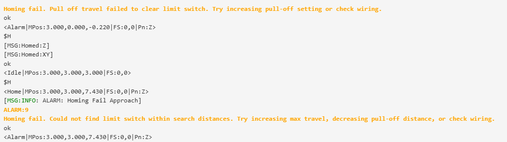

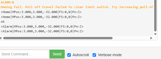

Cleaned all contacts. No help. Was able to get it go a couple times in the right direction. Only to have it revert back other times. Noticed the LH side would sometime die and dive to the table. Also noticed that the LH Z side does not come all the way up and hit the z stop. RH hand side does.

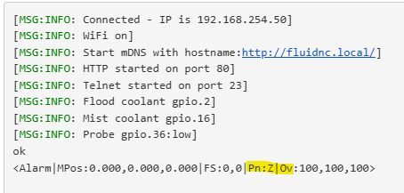

Should this have 0 volts?
Its weird some times it homes in the wrong direction and then other times i can get it to go right. But the LH side seams weak and wont take it all the way to the Z stop. Just barely stopping short. After word sometimes it will crash on the LH Z side like it looses pwr.
From your screenshots you are using an edited firmware (STA mode).
Please only use a fresh install with every one of my files unaltered.
There are infinite settings you could have changed, please wipe, reflash and try again.
