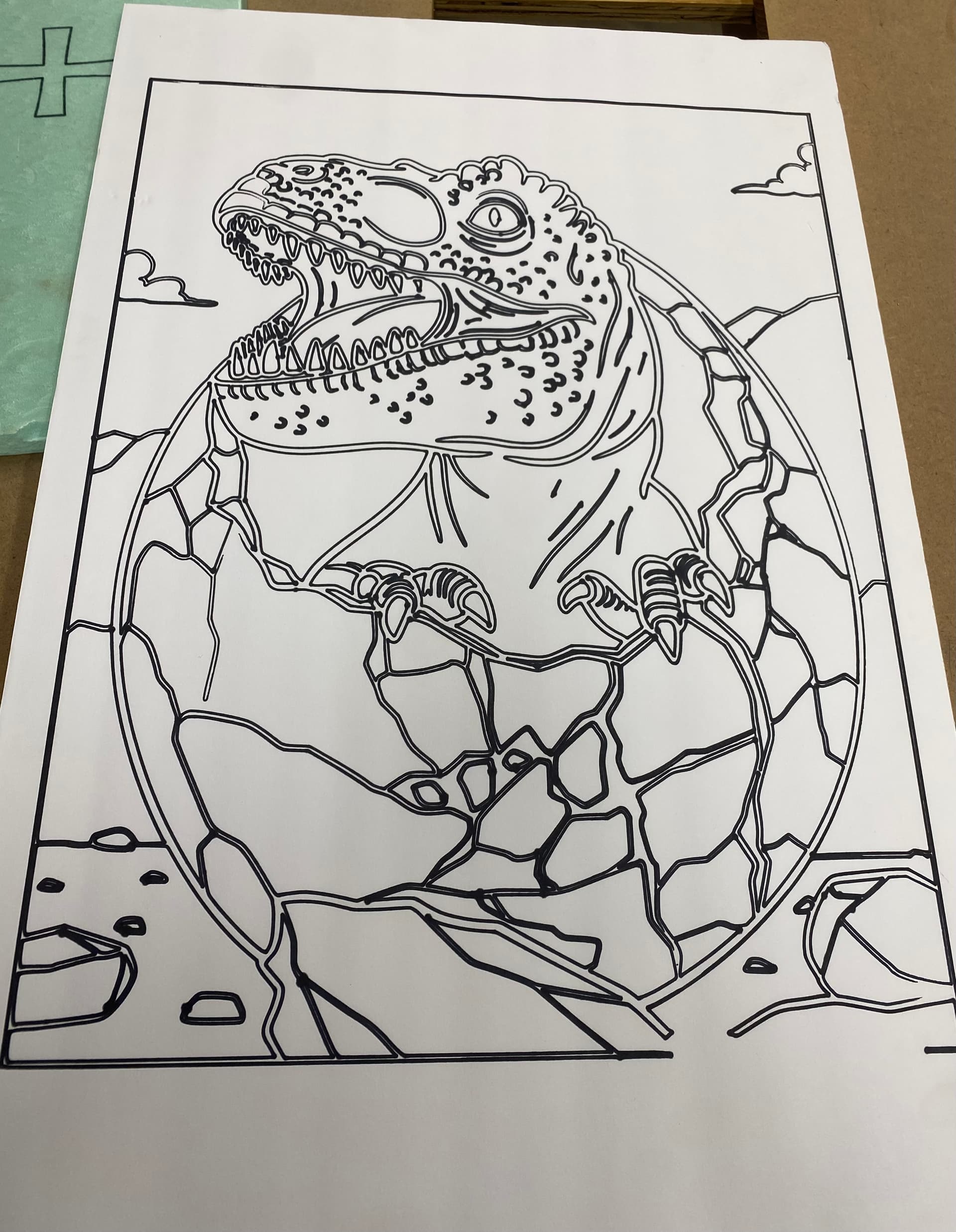

Was able to Practice Drawing today. Going to let the kids color it. Its on a 20" by 30" foam board.
