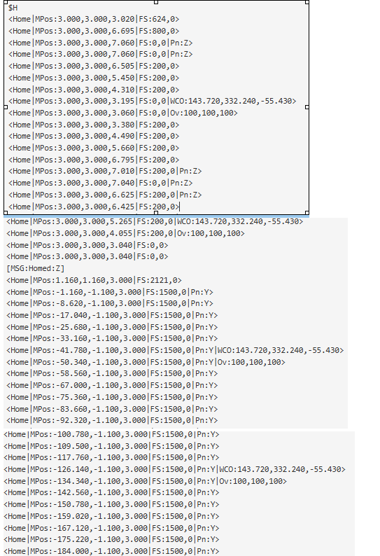

I went back out to practice drawing some more and ran into a big snag. The X axis started skipping steps in the middle of jogging it back to a work peice. Then I could not get it to respond with any controls. Wont even home anymore no movement at all. I swapped the X Axis motor with a Y axis motor thinking the motor was bad but it ran fine when using the Y control jog Function. Sorry for the length just tried to provide as much in fo as possible.

This is the code at machine startup
After Homing X It just runs until I pgysicaly hit the stop switch. The motor never moves. The alarm activates only after I hit the switch.
After I hit Home ALL It does fine Until it asks for X. Then I have to physicaly hit the stop switch. Thats when it alarms.

I added soft and hard limits to the X Y Z so i wouldnt hit the ends when jogging around when I first started messing with it. But when I started the crown test it flagged my soft limits so I just put then to False when I was Drawing the Crown. I idint save that setting so when I turn the machine on it would still have my old soft setting for jogging the machine. But the more I use it the more I find I dont need them. But for some reason now im not gettign any movement from the x axes.
Hard limits requires 2 limit switches placed at axis(- )and another at axis(+) if you touch any of them during movements fluidnc will halt, trow an alarm and prompt for a rehome
The way I understood it and how the machine functioned was that soft limits was max travel of the axis and the hard limit was min travel. Which I had set to 4.0mm (hard Limit min). On X i only have one stop switch which is on the left side min side. Y has 2 switches on the min side lh/rh rail, and Z has 2 switches on max side lh/rh up slide rails. So after I would home the machine it wouldn’t hit the Y,X,Z Stop switches again while Jogging. It worked fine like that. I only had to disable the Z Soft Limit which was the Z max because when I did the crown test It told me my Z max was not enough. Which Worked and ran Fine.
Its when I went out later to practice some more the X Axis Made some skipping sounds when Jogging it to a work piece to draw and now the X Axis wont move at all. Even when I home the machine it will do Y,Z but i have to physically hit the X Switch to finish the all Home Sequince because it wont move.
I swapped the Y motor wire with the X motor on the Jackpot Thinking it was a bad motor but X it moved fine when I ran it With the Y jog Button.
I am stumped. I appreciate all the help and advice hopefully you can see something wrong in the gcode I posted.
change wires back to its original position and just change the driver if it follows (x moving and y axis motor side not moving you have a bad driver)
That’s a good idea I’ll try that this evening. Do the drivers just pull off the jackpot?
Just pull them carefully, swap them and test
Copy that I’ll give it a go thanks
finally got a chance to swap drivers, problem didn’t follow. So driver is ok.
I would add a video of it trying to move but don’t know how. The motor seams to make a bad grinding sound and vibrates real bad no mater what driver I attach it to. Think it could be a bad motor?
Possibly but not the most likely - motors are simple and there’s not a lot to go wrong. The wiring is much more likely so check the connectors and visually confirm the wire colours are in the right order. Use a multimeter to test continuity the length of each wire. If you can, check the motor using a different cable with no extensions.
