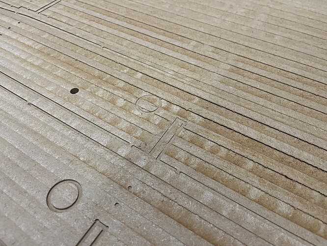

Tonight I ran my “rough surfacing pass” and I’m not sure if what I got was normal…I thought that this pass would be taking off up to 2mm at the worst spot but it turned out to be about 3mm. I was using a ½” dovetail running at 1000mm/min.
When surfacing at the highest DOC the cut traveling in the -Y direction was 1mm deeper than when traveling in the +Y direction.
  • Does this mean that the core need to be tightened up? (it doesn’t feel sloppy but I could be wrong)
  • My shims from doing the tramming (as described in the previous post) are getting compressed and allowing movement
  • I am being too aggressive and the LR4 is showing me its displeasure
  • Something else?
I was planning on doing a .5mm finish surfacing pass using Vector76’s single direction cut. But at this point some places will be getting a .5mm cut and some places will be getting a 1.5mm cut.
Congrats on progress, and thanks for updates! Sorry for issues, and hope you get them sorted. I don’t know for sure, but the difference in depth from going one direction versus the other, could be related to one way being “climb” milling versus “traditional” milling, combined with being amplified by perhaps one of the possibilities you mentioned. But I’m definitely not an expert on it. Table looks great despite the issues. Getting the spoil board surfaced could really make it totally usable.
