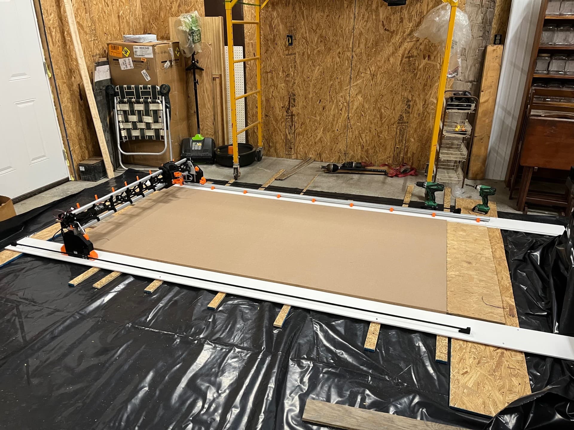

I, like many others, am jumping on the LR4 train… I built a 24” x 24” MPCNC back in 2020 with some of the free time I had. I always had my eye on the full sheet lowrider but I’ve been busy. Somehow the LR4 release caught me at the right time. I’m still busy as ever, but I do have a little extra time around the holidays. So… the gantry was assembled over Thanksgiving break.
I got a bootstrapped table laid out a week or so later. I knew it’d be on the ground for a few weeks so I laid some plastic down as a vapor barrier and lifted the spoilboard up of the ground on slats. All to prevent it from picking up too much moisture. I did a rough wiring job down on the floor and got it moving. Next I squared things up before cutting my strut plates.
My strut plates cut fine but the next test I ran, the Z height dropped on me. Z dropped to the point where the collet nut was rubbing on the workpiece. Following this failure I increased the Z axis run amps from .8 to .9 and I increased the Z-axis hold amps from .7 to .8. I have not had any issues with the Z plunging since making this change.

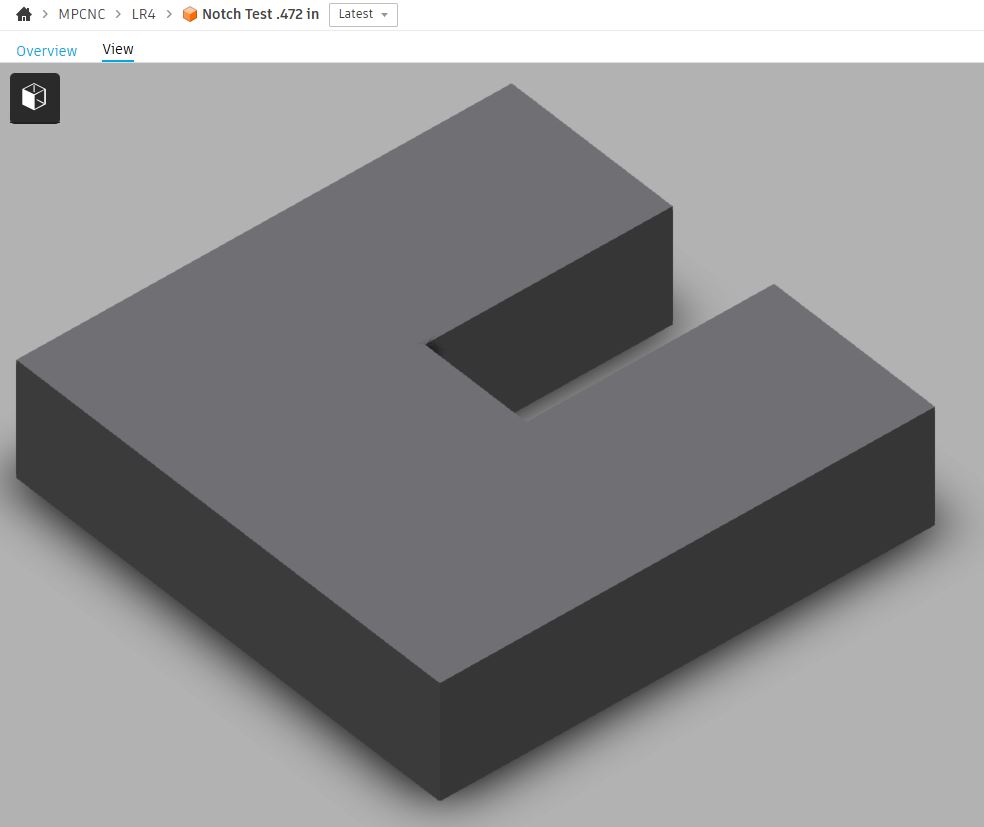

Before cutting my table I made a notch test to make sure that a .472” wide cut will indeed slot into another piece of plywood. This may be haunting me now. The samples did indeed slot together but were quite tight, needing a mallet. Slots measured about .455” which I attributed to some fuzz. Outside dims of the piece were about .011” oversized.

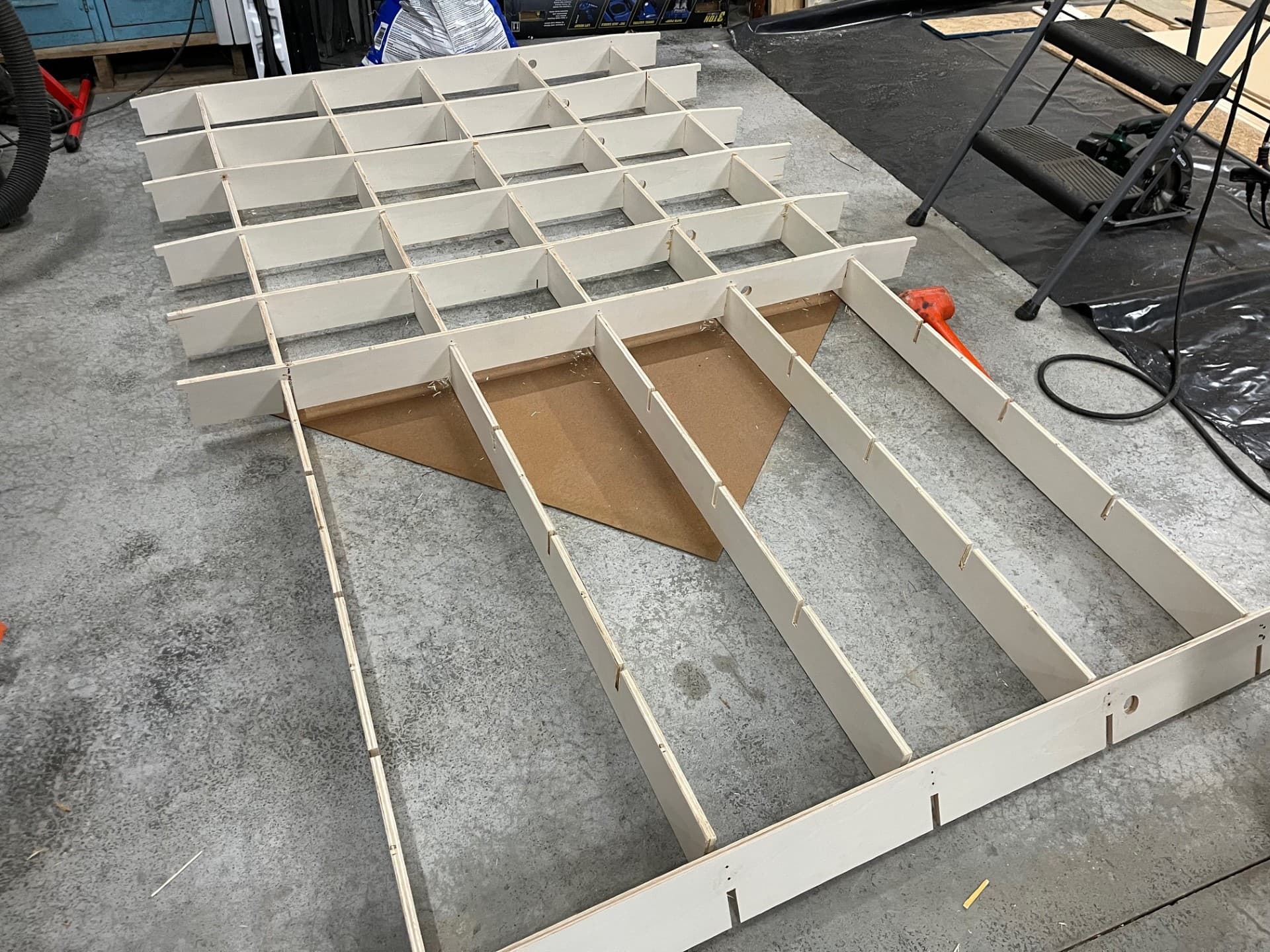

Now I’m in the process of cutting and assembling my torsen table. I took Doug’s file and modified it to closely match the official table. I changed Doug’s to 1/2 in ply, made it 4 in tall, I increased the number of X and Y members to 10 and 5 respectively. I also adjusted some internal table dimensions.
I added a hole in the X-rib for a pivot. I plan on building a cart that the table can pivot onto. Then it can be moved out of the way if I have other large projects in the shop. Inspired by “SATXDIY Sean White” on YouTube.
I am looking forward to getting the table built. I need to get this thing and up off the floor and get some dust collection on it. In a hurry, last night I had some time while the LR4 was cutting out the final X-ribs and I tried to start the table assembly. Well, my notches were pretty tight and now I need to cut 3 more X-ribs. I will take my time, chisel out some more clearance, and use a board over top of the rib to do my mallet beating on…

I made mine from 1/2" ply, broke many joints because of the mallet beating… it wasn’t until near the end I realized that the joints were tight but correct size and I only needed to use a cheap clamp to push them together flush… was so smooth I kick myself for ever picking up the mallet. I may even build another one just to press them all together without a single crack. :slight_smile:
Thank you! Running to get clamps from the garage now…
Edit: Oh that works Sooooo much better!

Yes, I just tried the clamp method and that is definitely the way to go. Thanks for that recommendation.
