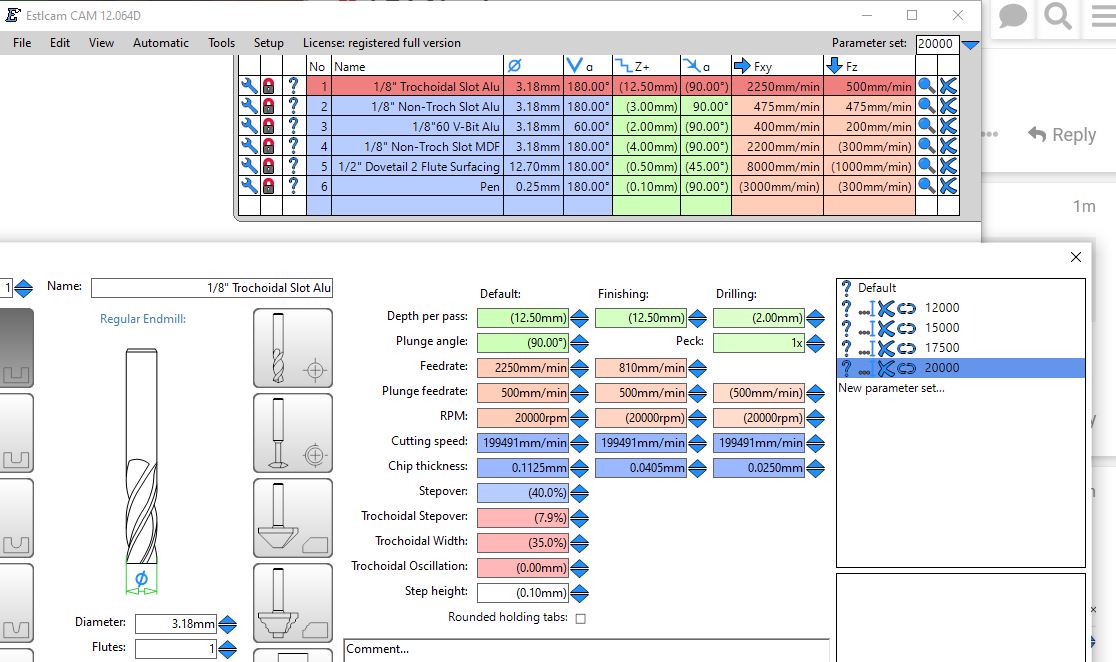

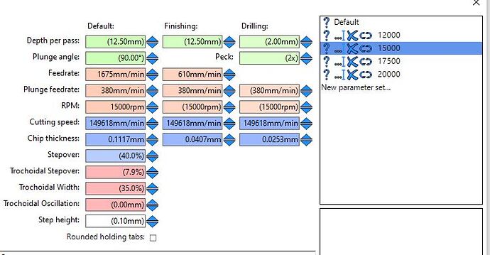

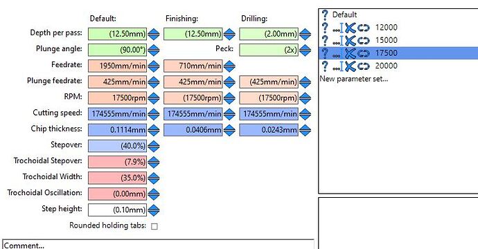

I wrote up everything I did to cut my MP3DP v5 plates here
Really just a summary of everything I learned from @Jonathjon and @vicious1 and probably @Tokoloshe as well
But it worked well for me. Everything went fine and I didn’t have any failures
I used Trochoidal for 3mm, 6mm and 9mm aluminum, and it worked great! Full depth slotting in a single pass.
I did have some issues when slotting the 9mm, as the chips had some difficulty evacuating from the slot. If I was to go that deep again, I would increase the Trochoidal width to give a wider path for the chips to clear.
I used an Air/Mist system. Possibly not needed for very shallow cuts, but aluminum can weld to the bit very quickly if your F&S aren’t perfect.

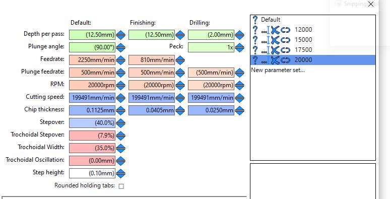

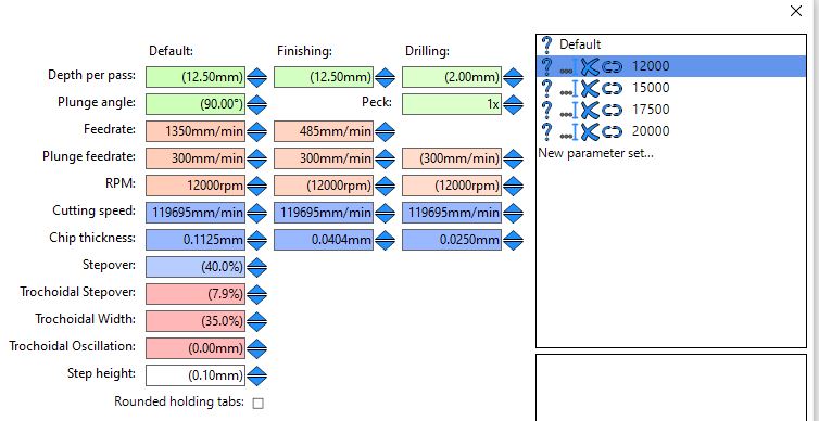

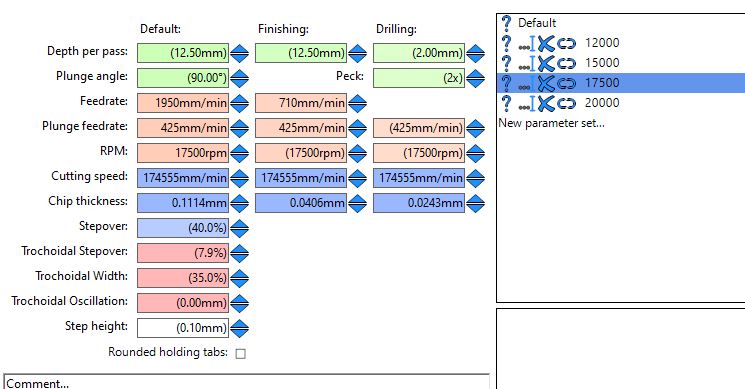

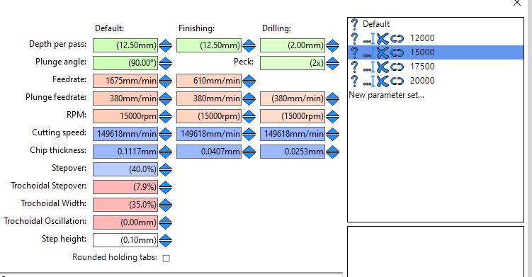

Here are my F&S for 10k, 12.5k, 15k, 17.5k and 20k RPM, using a 1/8" single flute carbide:
Trochoidal 10k
For cutting (not drilling) holes >4mm, I just let the bit rotate into the hole using trochoidal movement. For smaller holes, I used a v-bit to mark the center of the hole, and then used a drill press to complete the hole.
(Edit to clarify that holes >4mm are cut, not drilled)

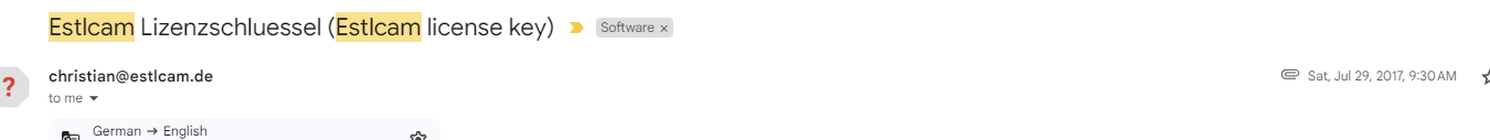

Is estlcam 12 stable now?
yes, it’s not Alpha version anymore
I’ve been using it for at least the last 8 months, and it seems very stable.
what version are you using bart? does not look like 11 or 12
crap nvm, you just did not show the left side, sorry!
12.064D
crap, I bought mine in Jan 2022, if it had been march I would have been good to go.
bummer
  • License keys bought since 1st March 2022 are already valid for version 12…
v11 still works great, and you don’t have to re-learn the workflow.
Note that v11 projects cannot be imported into v12, so if you want to use any existing projects, you will have to maintain v11 as well.

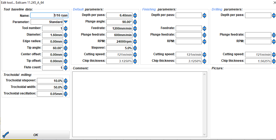

For trochoidal cutting, according to my ESTLcam file’s records, I did this:
Bit diameter: 3.18 mm
Step down: 7.0 mm
Angle of attack: 90.00 degrees
Feed rate: 38.8 mm/sec
Plunge rate: 1.8 mm/sec
Router speed: 12,000 RPM
Trochoidal Stepover: 5%
Trochoidal width: 50%
Trochoidal oscillation: 0.05mm
These are loosely based on earlier successes by other members, with some tweaks perhaps, but I cannot recall exactly what was tweaked.
