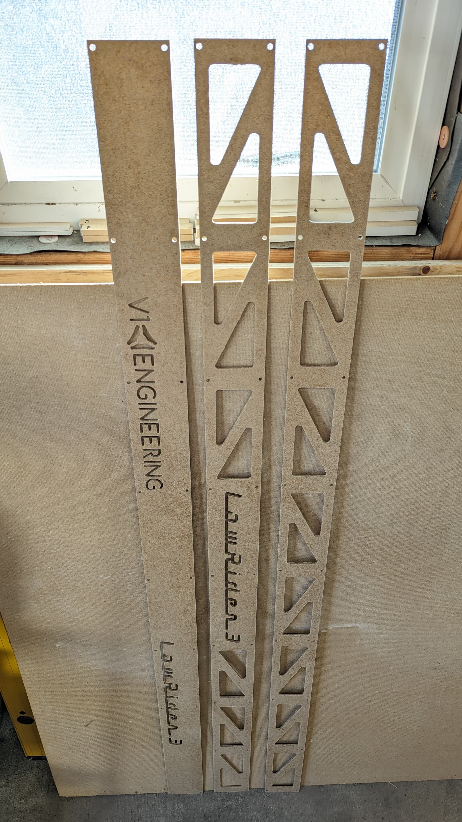

Struts are cut!
Lots of learning from this process, which is always a good thing, and I only had to re-cut one (the strut from the previous post snapped in half because of the scoring on the back side).
Looking forward to painting the struts (black). Not looking forward to taking the whole machine apart for final assembly. :rofl:
(Front, rear, bottom, in that order. Props to @DougJoseph whose design I used/modified!)

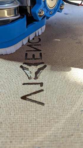

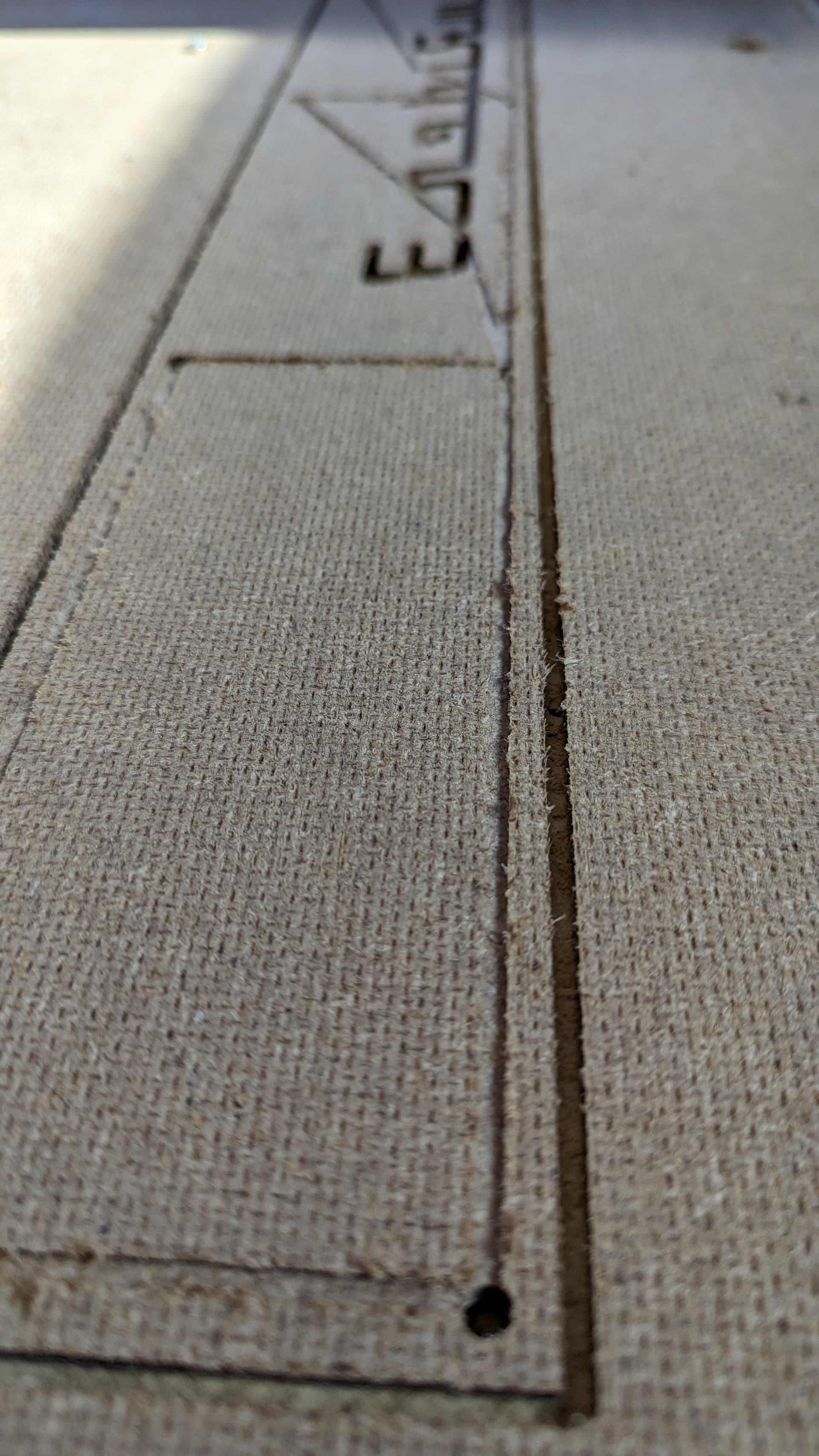

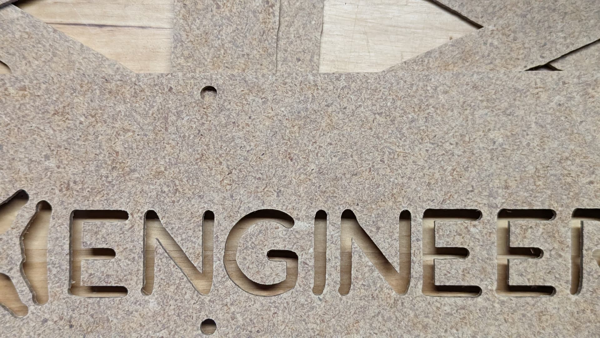

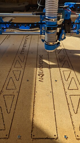

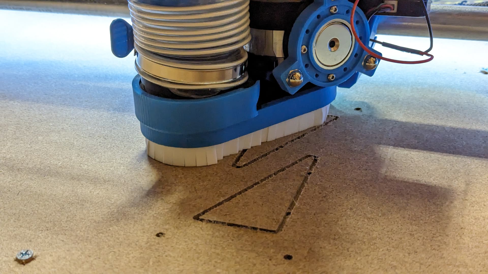

On closer inspection, some of the lettering is misshapen. I suspect this is from the bit dragging in the MDF spoil board. I did this cut on one pass, and depth was probably a little deeper than it needed to be. If I were to redo this, would I be better off reducing the total cutting depth, increasing RPMs, or both, or something else?
That was probably a pretty ambitious cut to make without struts. This is what I meant when I said you might not really be saving much time if you try to go full depth, instead of just taking the time hit on the first cut doing 1mm DOC or whatever.
If I were you, I would go ahead and put those struts on, then go about making new ones with a rigid machine. Once you fix all of your braces, etc. the struts are not that hard to replace.
