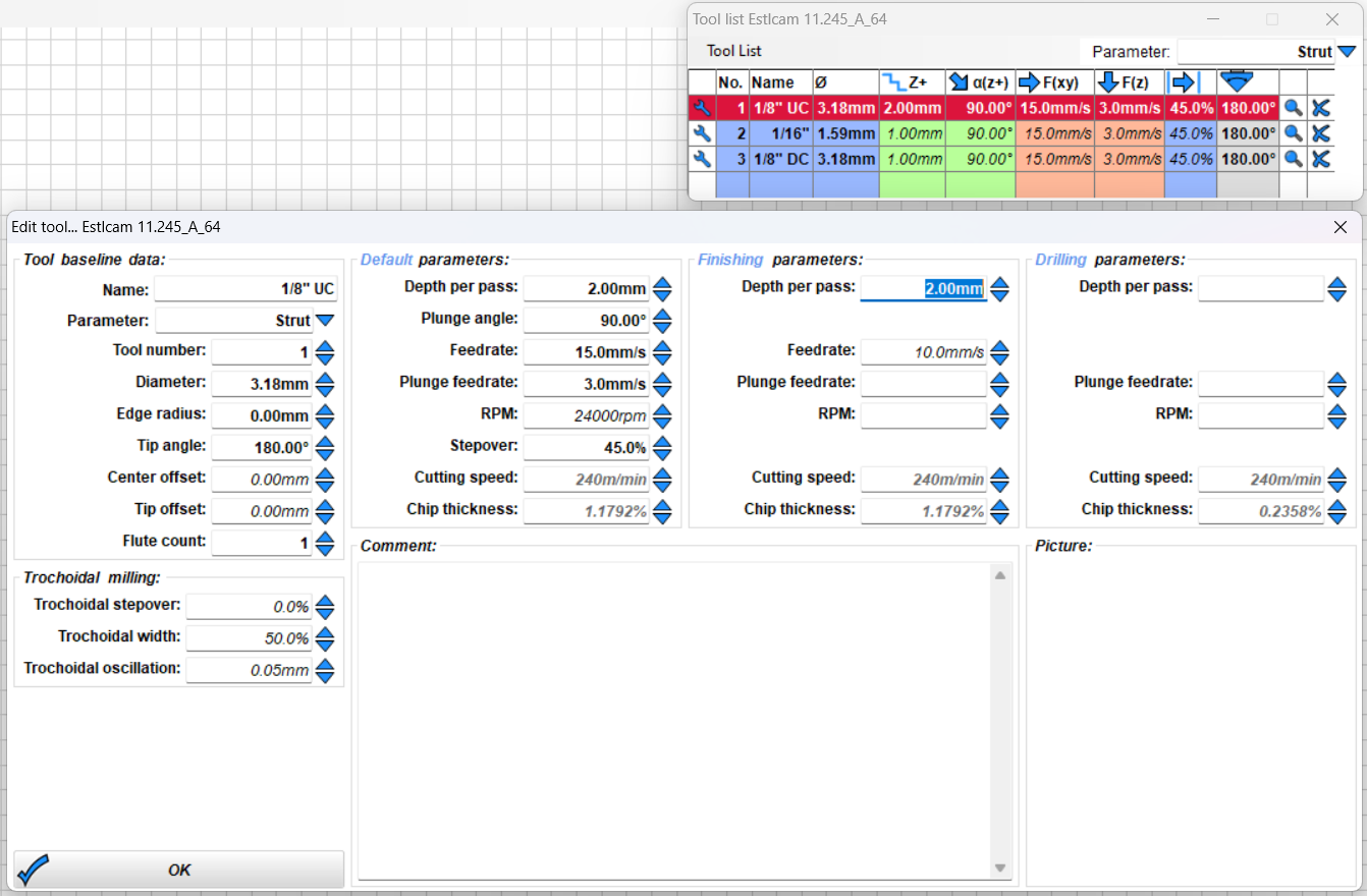

I re-cut one of my hardboard struts this evening, after triple-checking my toolpaths and tool settings in Estlcam because I wanted a total depth of 3.5mm and each pass to be 2mm deep. During the cut, I quickly grew suspicious that something was off, and it turns out that my machine was cutting to a depth of 7 mm below the cutting surface. Nothing I found in some forum searches seems to match what’s happening in my situation.
I have a couple hypotheses as to why this might be happening, but I assume there’s a 95%+ chance I did something wrong somewhere instead, so… let’s see if I can cover enough relevant information for troubleshooting:
I am running an SKR Pro 1.2, purchased from Amazon. I flashed the board with the V1CNC_SkrPro_DualLR_2209-2.1.1 V515 release firmware. 2209 stepper drivers, UART mode with no other jumpers.
I am using Estlcam 11.245_A_64. The following are as many settings as I can think of to capture. I tried to set everything up per the docs to start with, and have only changed the depth per pass.
1/8" upcut endmill:
All toolpaths look like this, I don’t specify toolpath depth right away. I am not using a finishing pass for the struts:

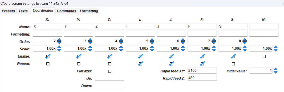

Rapids:
When saving the CNC program:

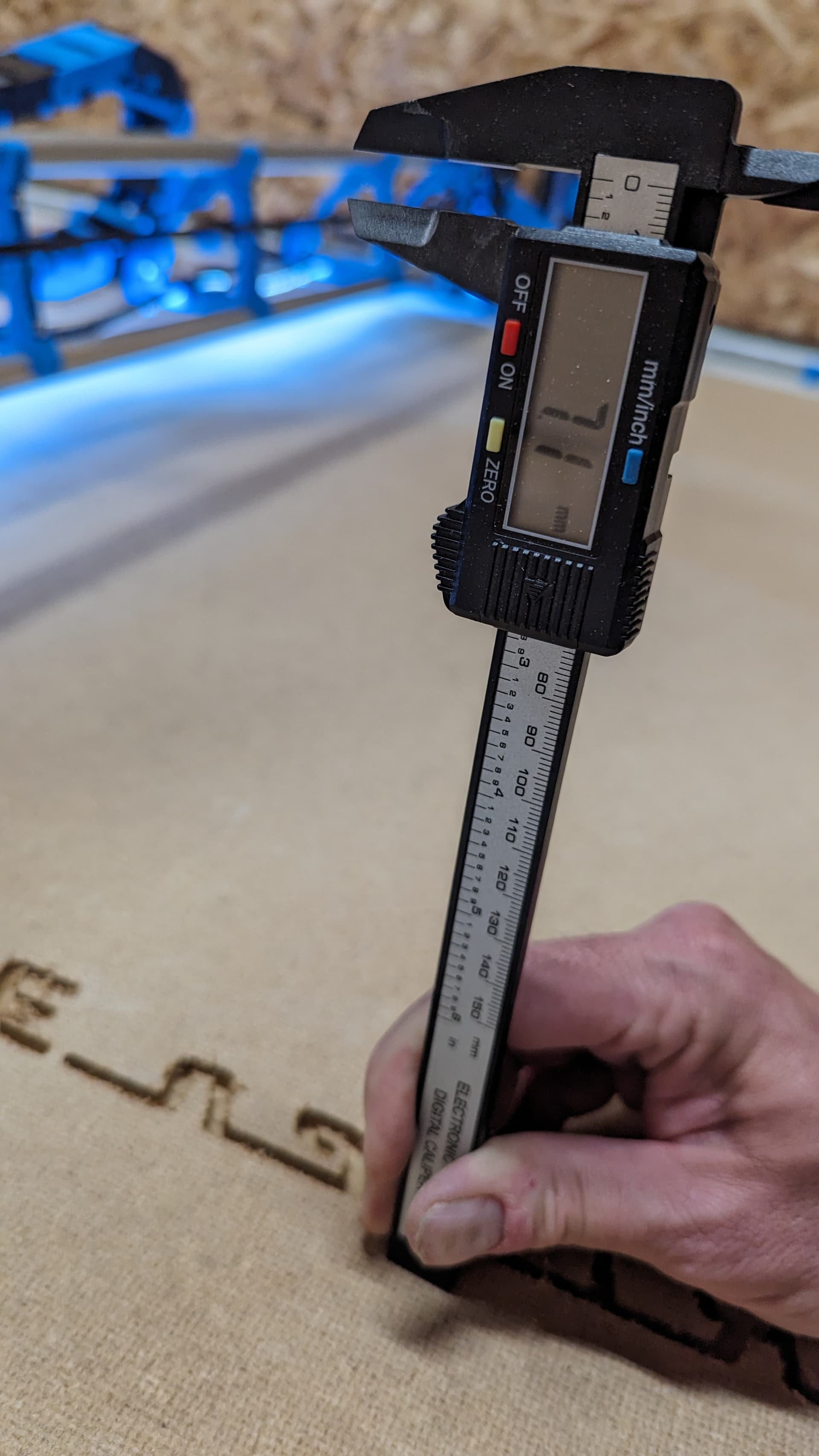

Measured cut depth (one example, it is within .1mm of 7mm across the entire cut):

One of my “don’t ask me how I know” moments was when I tried to do too much before installing the struts. When the bit dug into the material, it had enough downward force and enough flex in the gantry towards the middle that I was left without about a 10mm deep gouge in my spoilboard.
Other than that, I would check and make sure your Z movement test is accurate.
GCode looks ok, just cut roughly 3X deeper than you should have.
One thing you can do is run an air cut and check the height of the bit after it is done to see if it drifts down with no pulling force on the bit. Put the Z Probe on top of a piece of 3/4 board or something with enough clearance that -11mm won’t hit the table.
Just remove the last few lines from your GCode file so it stops with the bit in it’s lowest state.
If it goes through all that motion and ends up only -3.5mm from the start height, then that would lead me to believe the flex pulled it down like I saw on mine.
The good news if that is the case, is that you already got yourself a set of full length temporary struts to cut your next set with :slight_smile:

Also… lines 2964, 2965, 2966: there’s 7mm of downward movement in the gcode. What the?
Oh wait, those are absolute, not relative. I think. Unless they’re not absolute because there’s no G90 at the start of the code?
I would assume it’s still absolute, otherwise you’d be going deeper, and deeper, and deeper, and deeper…
Absolute is the default for Marlin, so unless you set G91 somewhere first, you don’t need to have a G90 at the beginning.

Notes from tests this evening:
The latest strut’s outside edge was 85mm from the edge of the spoilboard.
The Z axis moves 10mm when I dial a 10mm change on the display in Marlin mode.
Air cut test #1:
  • CNCjs
  • Put shims on top of the cutting surface and probed to the top of the shim stack, height above cutting surface was 21mm
  • Using the same gcode as yesterday with the recommended gcode removed (see below for the end of the file), the bit ended 17.5mm above the cutting surface at the end of the cut
Air cut test #2:
  • SD card in the SKR
  • Same shim stack on the cutting surface, probed to top of shim stack, height above cutting surface was 21mm
  • Same gcode file as air cut test #1
  • Same final Z depth, measured at 17.5mm above the cutting surface at the end of the cut

  • No appreciable difference in cut depth from the last live cut between the Y+ movements and Y- movements
  • I can definitely twist the gantry tubes by hand, which moves the bit by a few mm, but I’m only able to noticeably twist it clockwise when looking at the X min side (moves the bit toward the cutting surface). It strikes me that if the gantry is moving in the Y+ direction, pulling the router bit along with it and theoretically twisting it in the opposite direction, the Y+ cuts ought to be noticeably less deep than the Y- movements. This is not the case (see previous point)
  • The too-deep depth can also be measured in the bolt hole cuts, which would not seem to suggest any bit dragging
So… I’m still stumped. Any ideas out there in idea-land? Will 1/8" hardboard struts reduce the amount of potential twist in the gantry?
I can’t comment on twisting, but I know that once I had my mishap, while trying to figure out what happened, I was able to put 1 finger in the middle of the gantry and and see deflection with not much pressure.
It’s very solid with the struts in place.
It’s like putting drywall on studs or the backing on shelf. Even though those strips are thin, a huge amount of rigidity is gained with them in place.
In your position, since you have verified that the air cut works as expected, and the gcode looks correct, I would be inclined to chalk it up to cutting with and “not quite finished” machine.
I would be more interested to see if after installing the full temporary struts, does it still cut too deep?

This issue did resolve itself on my machine, but not by any one specific thing I can remember doing. Other than the struts, I think the next likeliest culprit was my Estlcam settings, which I went over very carefully.
