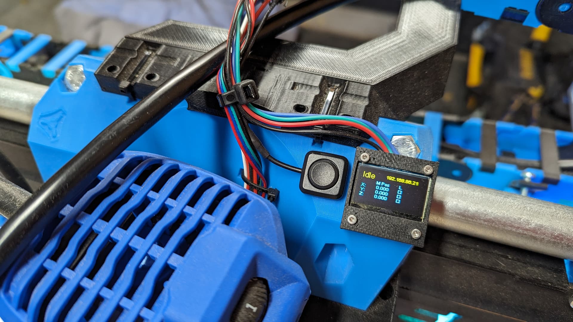

1.5" RGB OLED?
Ok I need some info for this…
This is what I bought:
https://www.amazon.com/dp/B0B7RPCZ4Z?psc=1&ref=ppx_yo2ov_dt_b_product_details
This is the reference to displays in the fluidnc docs:
http://wiki.fluidnc.com/en/config/displays
I was clicking around those docs, saw this, and had to at least try it out. My use case: the Jackpot is on my home network, it’s helpful to confirm its local IP in order to connect. Really easy to implement, assuming you have a couple gpio pins available.
I am probably mount it on the Core once I have a case for it.
i just so happen to have a few of those screens. And yes just to be able to verify IP and see position its very nice. I have mine set up static IP but every once in a while i have a brain fart and forget LOL
So what’s the thought process for this? Is it to have a screen for positioning when starting a job, fun analytical thing while cutting? (ip status I get), no hate just curious what the intended purpose is
Nerding out and adding complexity, mostly. (I know, Ryan, sorry.)
I’m also hoping that a quick glance at the status on the screen when doing tool changes will remind me to probe, since I’m a bonehead and forget sometimes (despite a change in LED colors and patterns :person_facepalming: ) which leads to failed cuts.
Love it, I’d be curious about mounting it to 0,0 on the table just to watch it change as it moves around. But that again add more complexity to it

Very useful use case. Just that feature is worth it (more than worth it, they only cost a few dollars from aliexpress).
I have a bunch of these and I use them in several projects. You can even use them with ESPHome. They do suffer from screen burn in (really more like burn out) after a few years (at least the oled black and white ones do). Just knowing that it connected to the wifi is a good enough signal thing to add.

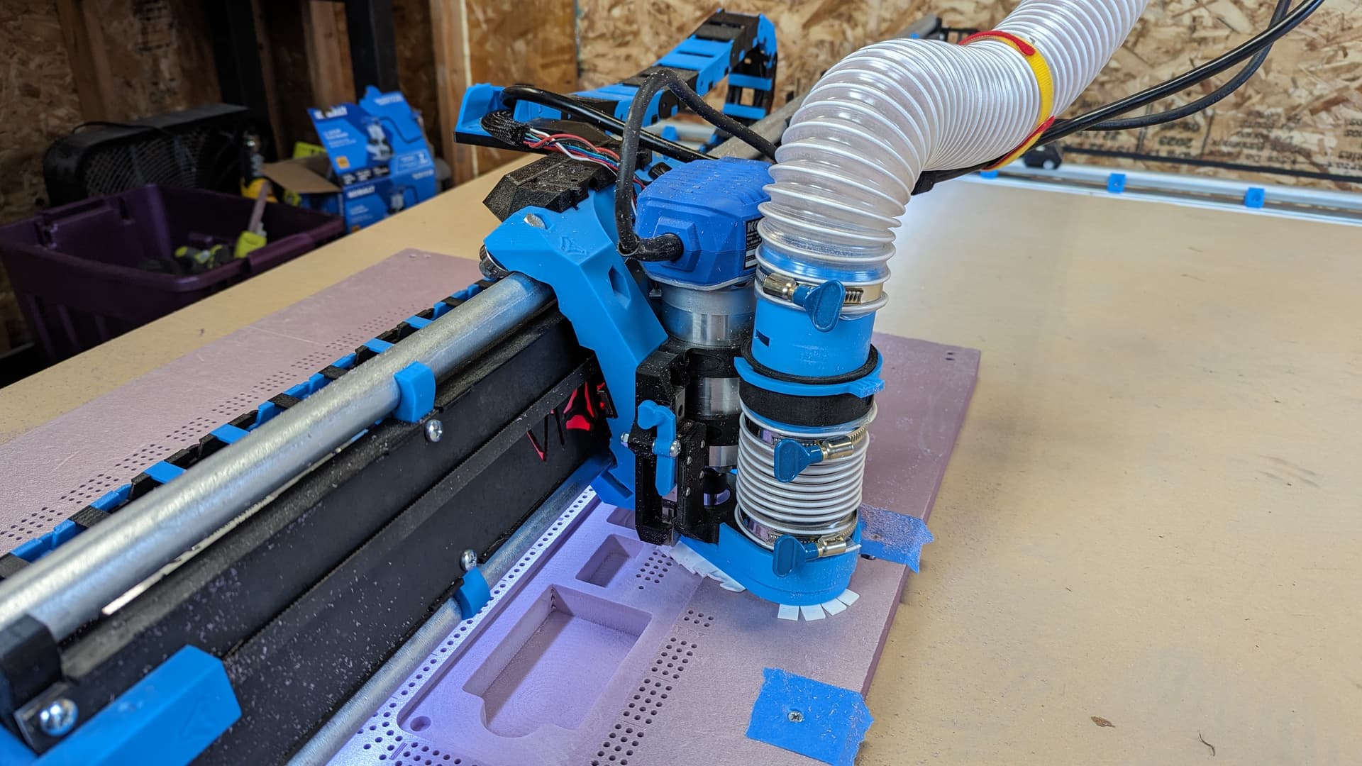

Finally done with my extra core mods!
Probably another day or two until it moves again, but getting close!

The gantry is finally all buttoned up for the time being. Time to play in foam to test all sorts of stuff for my first “real” project!
Way to go!
Very cool looking. What are you triggering with the button on the core?
I’d love to install one to unpause, rather than having to get back to the control screen. I’d also like one to execute a probe, especially if I could see the z value on the screen. Might be useful to get an idea of how much to take off in a leveling/planing process.
Resume, for exactly the same reason - not having to trigger it from a tablet/laptop, which is awkward when probing. All my probing is done via the start/toolchange scripts in Estlcam, so I don’t really feel the need for another button.
Also, I had to move the screen to be mounted on the rear strut. I guess the wiring was too long, I couldn’t get the screen to work consistently on the core. The good news is that it does what I need it to do. It also displays a progress bar while a job is running, so that’s pretty sweet too.
